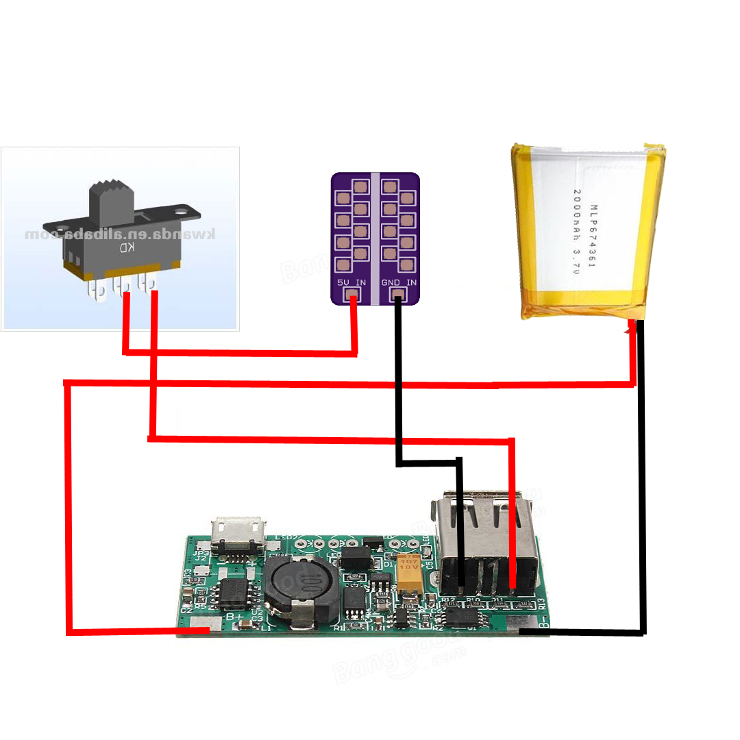

Here's a simple diagram showing how to hook up your Banggood power supply to the Switch, Battery, and Power Strip for your components.
This wiring should allow for charging with the power on or off as well as while playing. I have tested it myself.
This does not include safe shutdown switch etc. This is a basic design.

Thanks! How would the safe shutdown be hooked up? (ex. Camble's Banggood safe shutdown)

I haven't experimented with a safe shutdown switch yet so it would be tough for me to say exactly but I think if you go to his pre-order thread there should be a good explanation there about how to hook everything up as well as links to more information. When i get some time ill take a look as well and see what i can come up with.

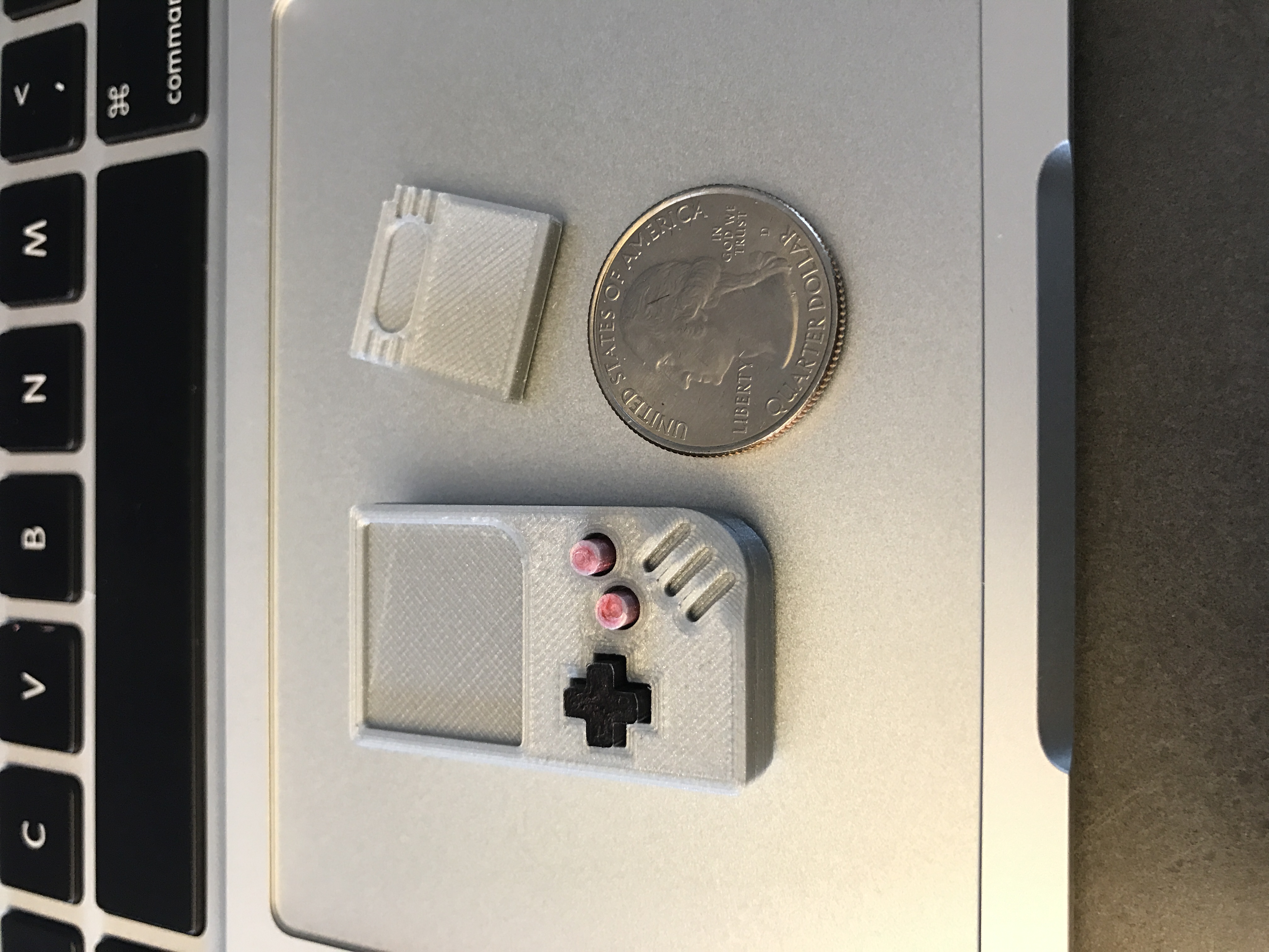

Slightly off-topic - I have to ask if that avatar is something you made or just a picture you found. :D

wermy wrote: Slightly off-topic - I have to ask if that avatar is something you made or just a picture you found. :D
Hey Wermy, it's a mini gameboy I test printed on my new Ultimaker 3 Extended. I also printed the mini NES, SNES and N64.
These are awesome mini consoles made by "Rabbit Engineering". You can find the STL's on thingiverse.

i wiring it like you but on my setup it will not work.
no led would bw shine but got some power (3.7V) on lipo out.
did i do something wrong?
Hard to say without seeing it. Can you upload a pic?
