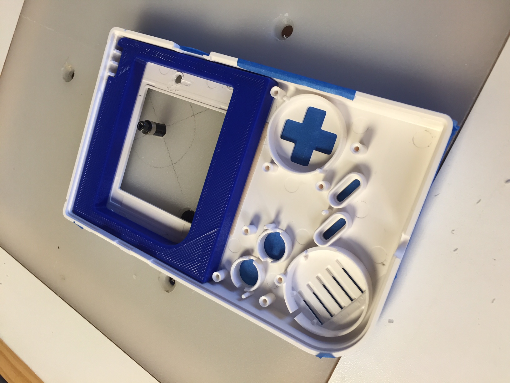

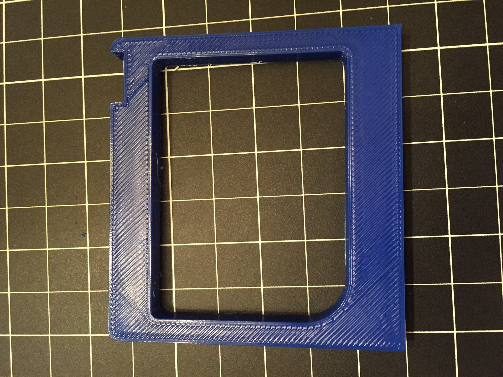

You first start by printing out this print.

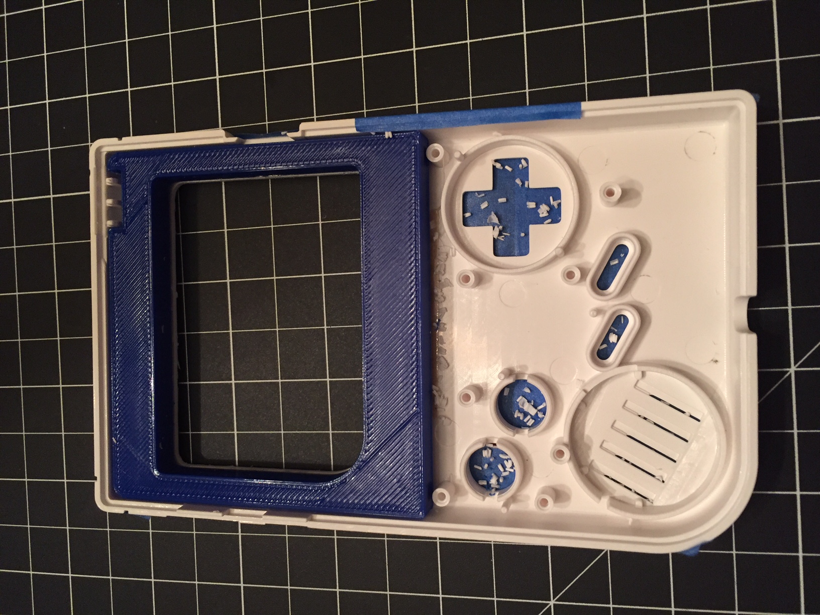

Use a table router with a 1/4 inch flush cutting bit. Make sure bit has a guide bearing like the ones used to trim laminate counter tops. Adjust the height of the bit so the bearing rides along the 3D template.
Then its just a matter of double sticking the template to the case and follow the pattern.

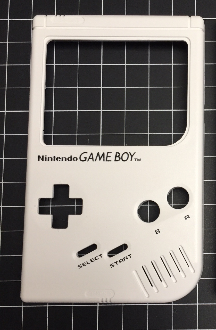

If all went well, then in literally, 5 seconds you should have this nice straight perfect cut.
Here are the files. I have included the router template for the screen opening and also a negative of that one which I didn't show in photos but if you print it and double stick it to a 1mm acrylic sheet, you can cut out screen protectors perfectly in a flash.

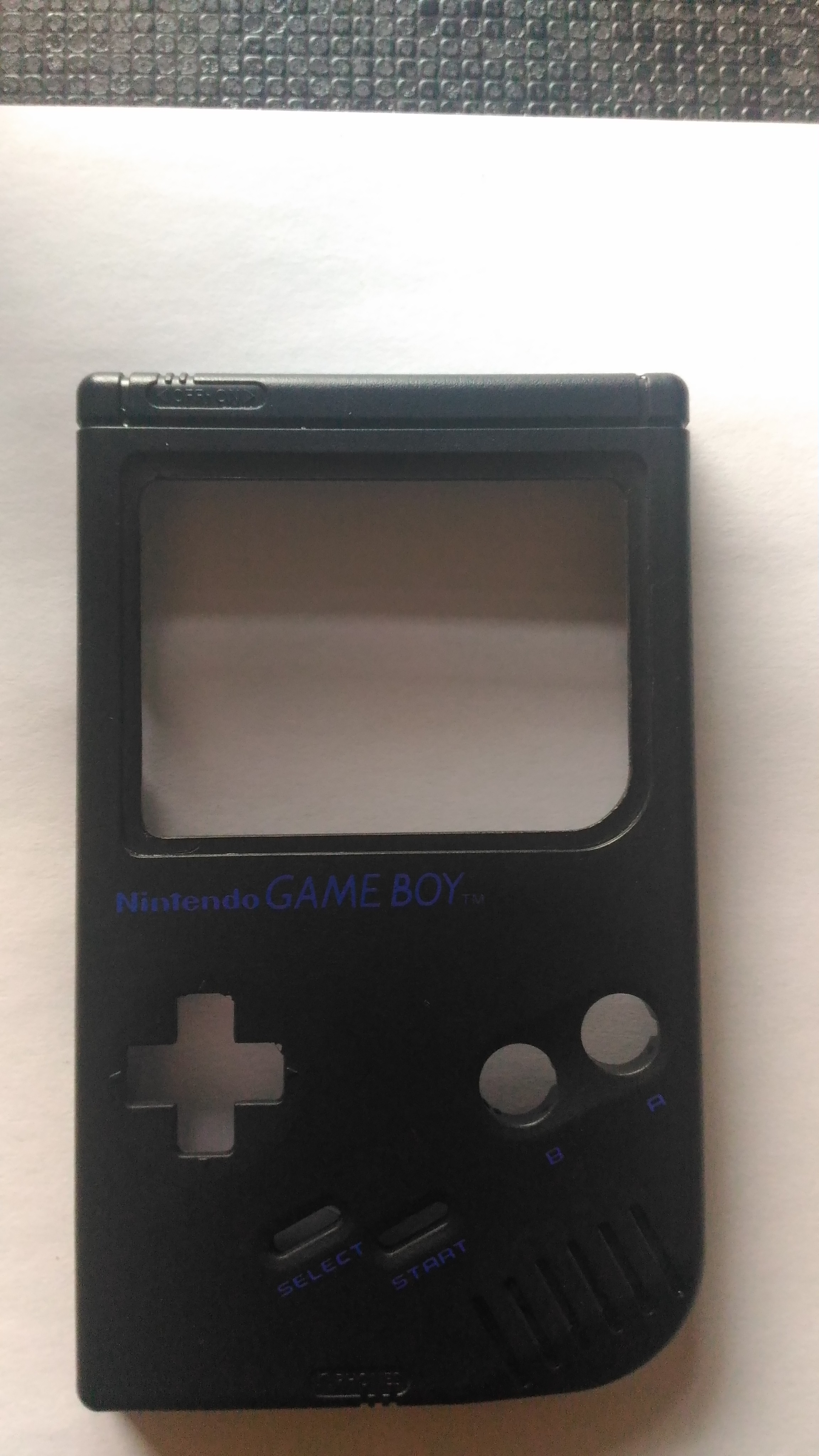

What about Laser Burner? :
There is still room for improvement, but for 1st cut I think it's not bad.
