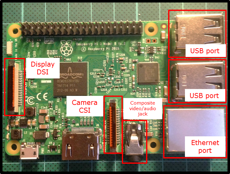

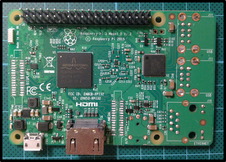

Raspberry Pi 3 model B and final resultShow
Here is the Raspberry Pi 3 model that I am going to use an example to strip off its components.
We aim at removing the following parts:
  • the two USB ports
  • the Ethernet port
  • the composite video/audio jack
  • the Display DSI and Camera CSI

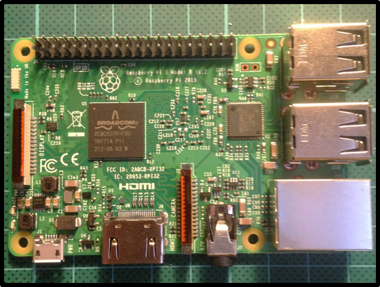

The final stripped Raspberry Pi 3 should look as follows:

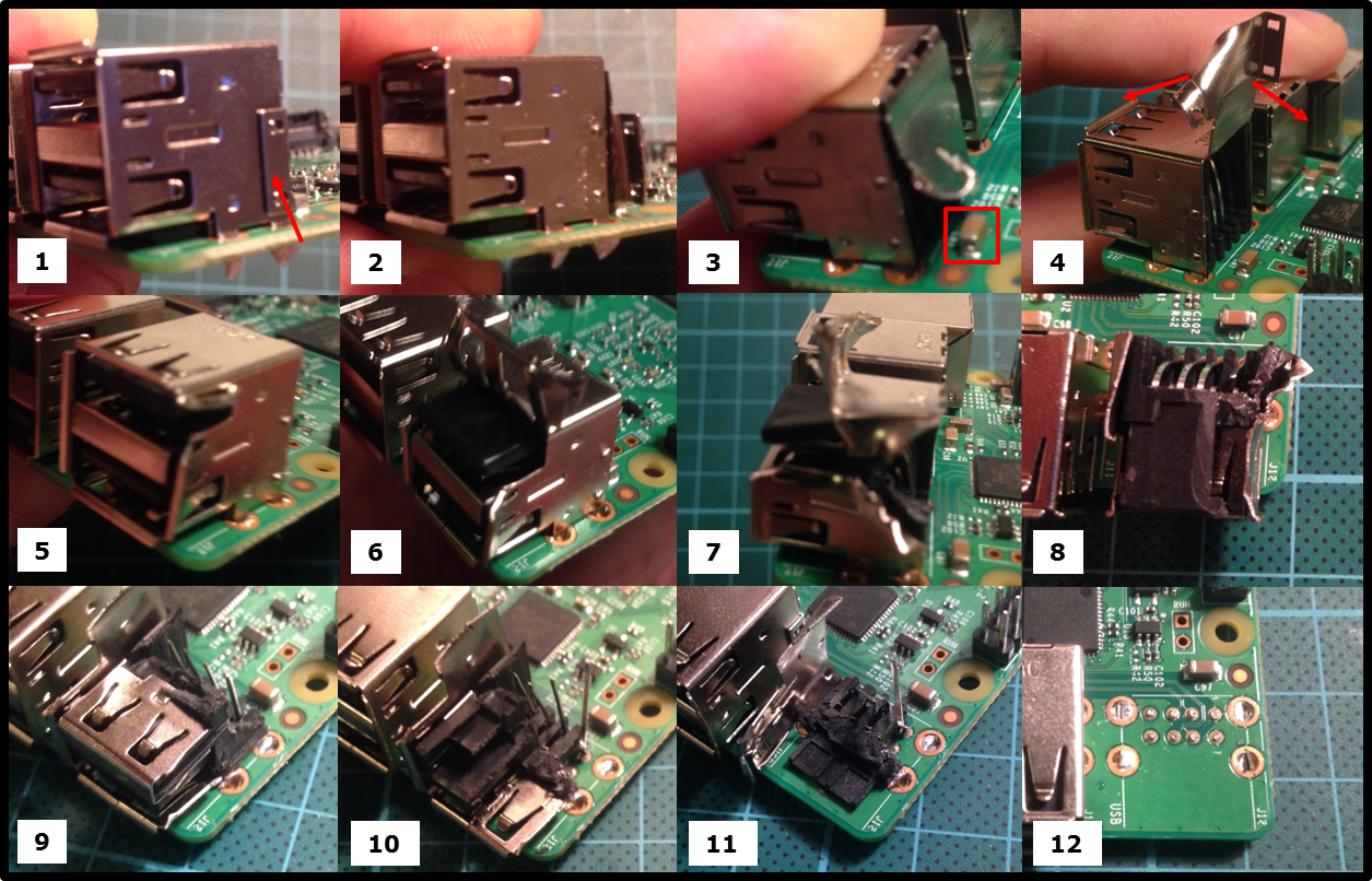

Removing the USB portsShow
1. To remove the metal case, identify the opening.
2. Flip it gently open with a blade.
3. Bend the metal in the corner ONLY to avoid damaging the nearby capacitor.
4. Lift the back side of the metal case. You can make it brake by bending it on the sides repetitively with your hands.
5. Make a small cut on the front of the USB port. Do it on both sides.
6. Open the metal case.
7. Make a clean cut with a cutting plier. Apply some strength.
8. Remove the top of the metal casing, again, by repetitively bending the metal on the side with your hands. It will break by itself.
9. Trim the plastic inside with the cutting plier. It is very soft plastic and will break easily.
10. Trim further the metal separator.
11. Remove gently any loose piece.
12. End result. Proceed to second USB port.

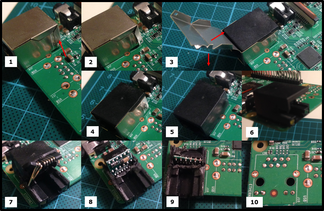

Removing the composite video/audio jackShow
1. Start by the side of the jack and identify the opening.
2. Gently apply a cut with a cutting plier.
3. Bend the metal piece open.
4. Trim the plastic inside gently.
5. Remaining metal piece can be removed by gently bending it to the side.
6. End result.

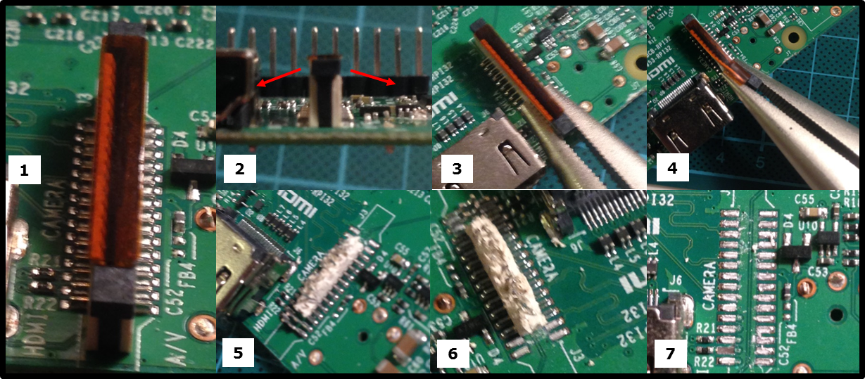

Removing the Display DSI and Camera CSIShow
1. Example is taken on the Camera CSI.
2. The is the frontal view because I want to insist on cutting the plastic by bending to the sides, left and right. VERY GENTLY, DO NOT RIP OFF.
3. Grab with a long nose plier.
4. Start bending it left and right. Do not apply any force until you have bent it 20 times on each side. No joke. You should feel that the plastic is getting looser.
5. The plastic now being loser, it can be trimmed. Gently. Be careful with the little metal pieces inside, if you rip it of you bring with you the whole wire inside the board.
6. VERY GENTLY break the metal pieces from the board.
7. End result.

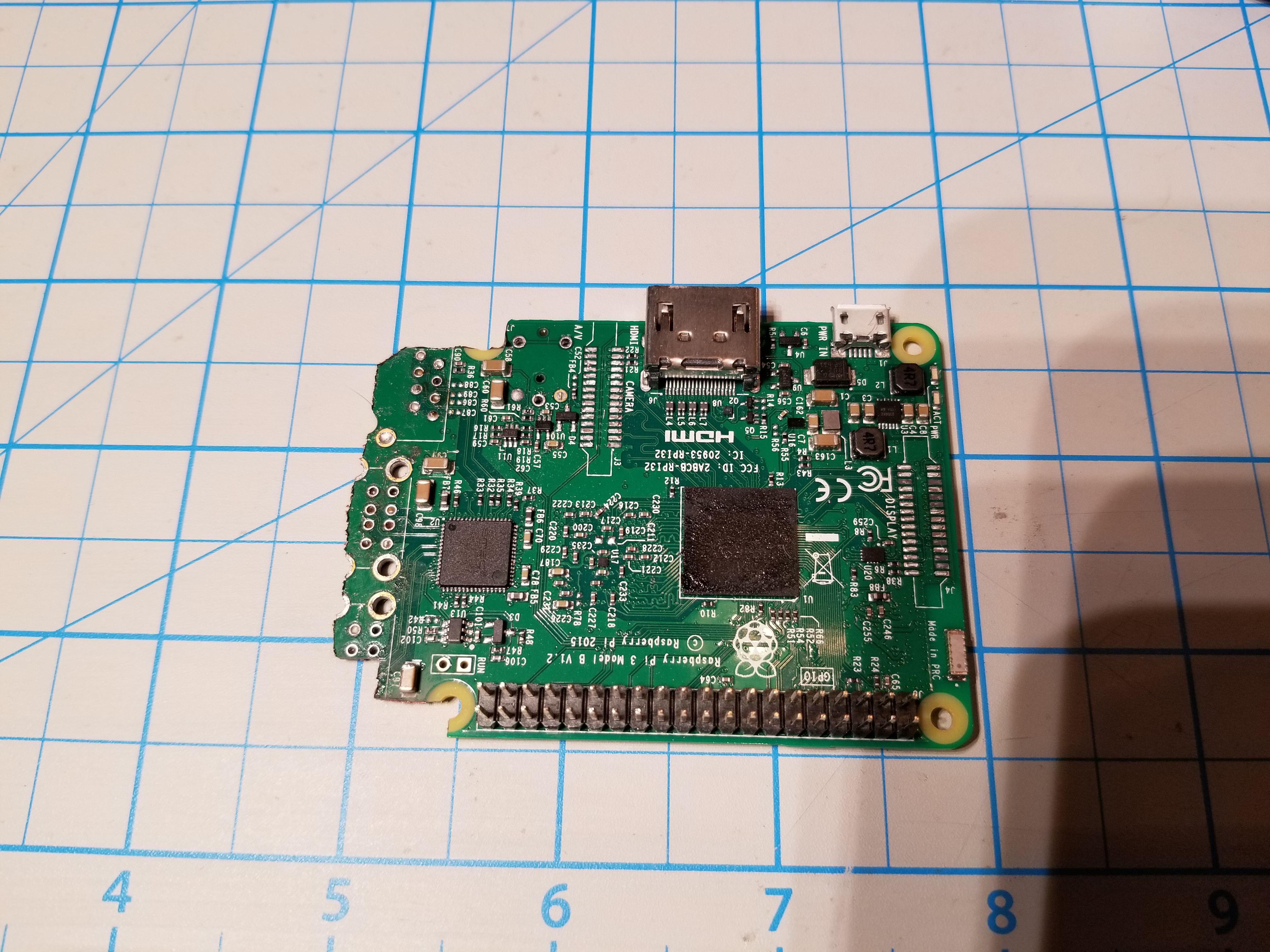

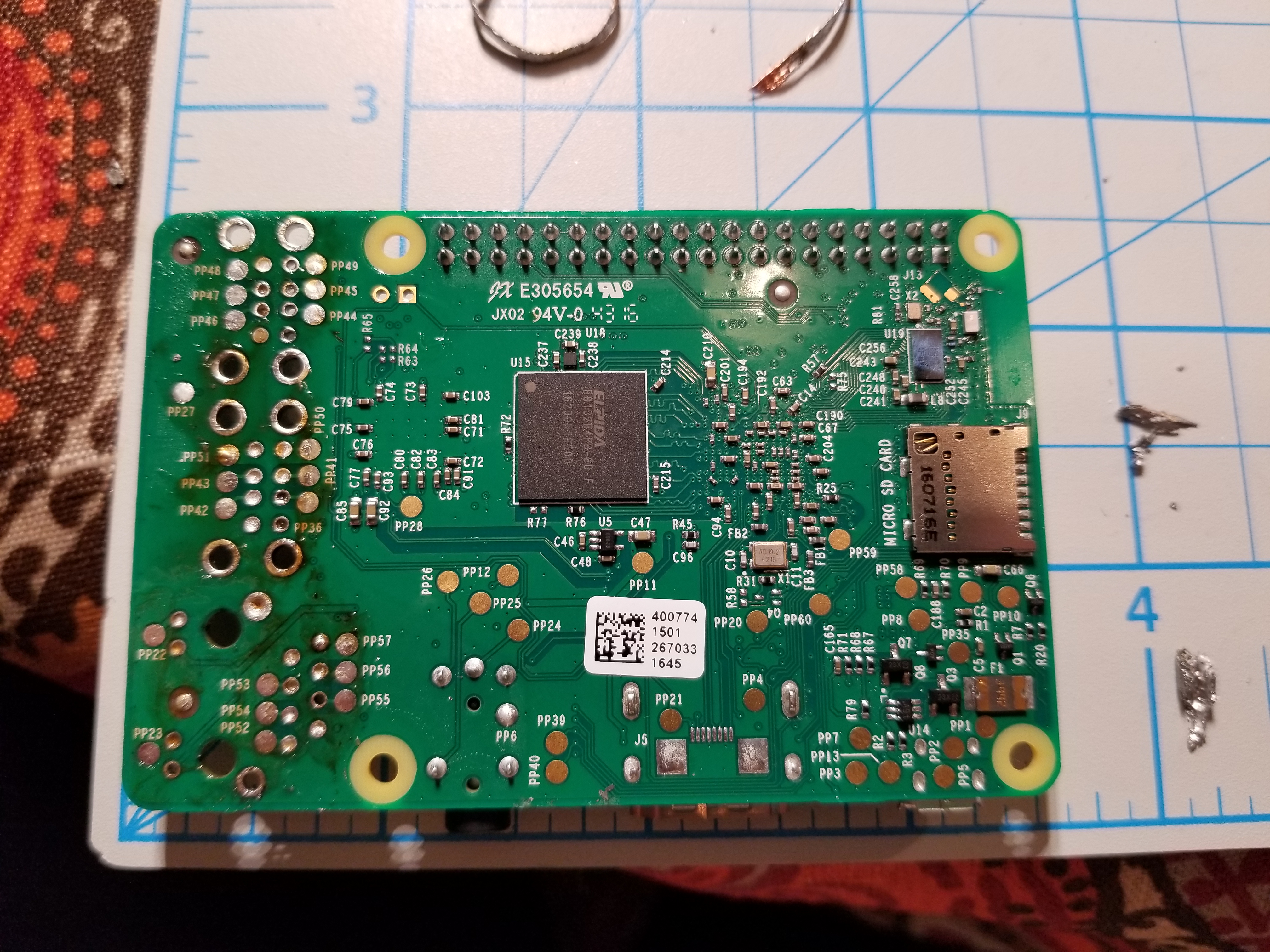

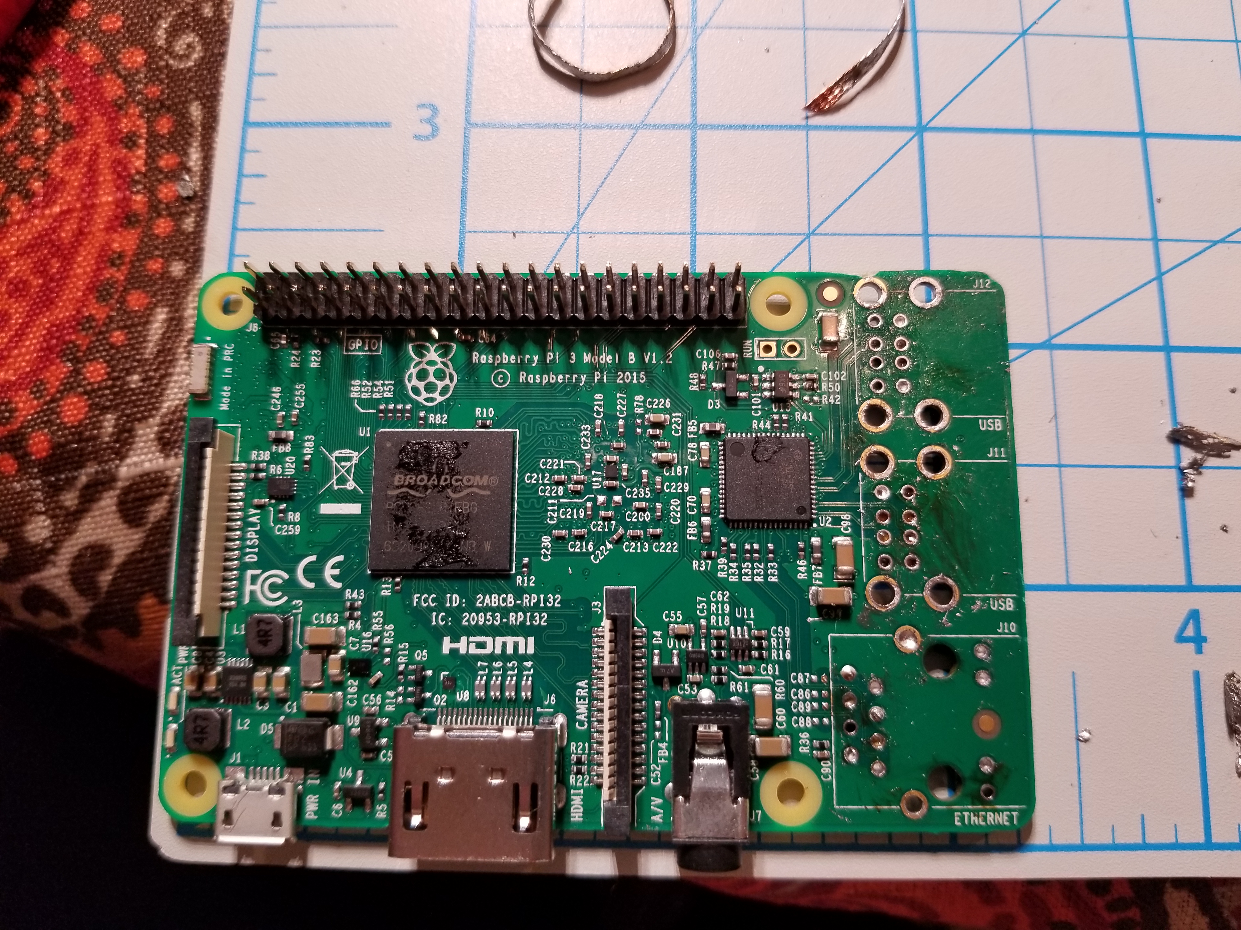

Post by dryja123 » Fri Aug 11, 2017 7:19 pm
Look what you made me do!
I used chipquik and the whole process literally took 3 minutes. I was inspired by your guide. :)

Oh, that looks super clean! Glad the guide helped. I was indeed struggling removing the solder from the USB ports but didn't bother to much since I wanted to cut most of it anyway. I will give it a try as well!
Re: [GUIDE] Stripping a Raspberry Pi3
Post by dryja123 » Sat Aug 19, 2017 3:07 pm
Echo, thanks for guiding me to the result that I wanted!

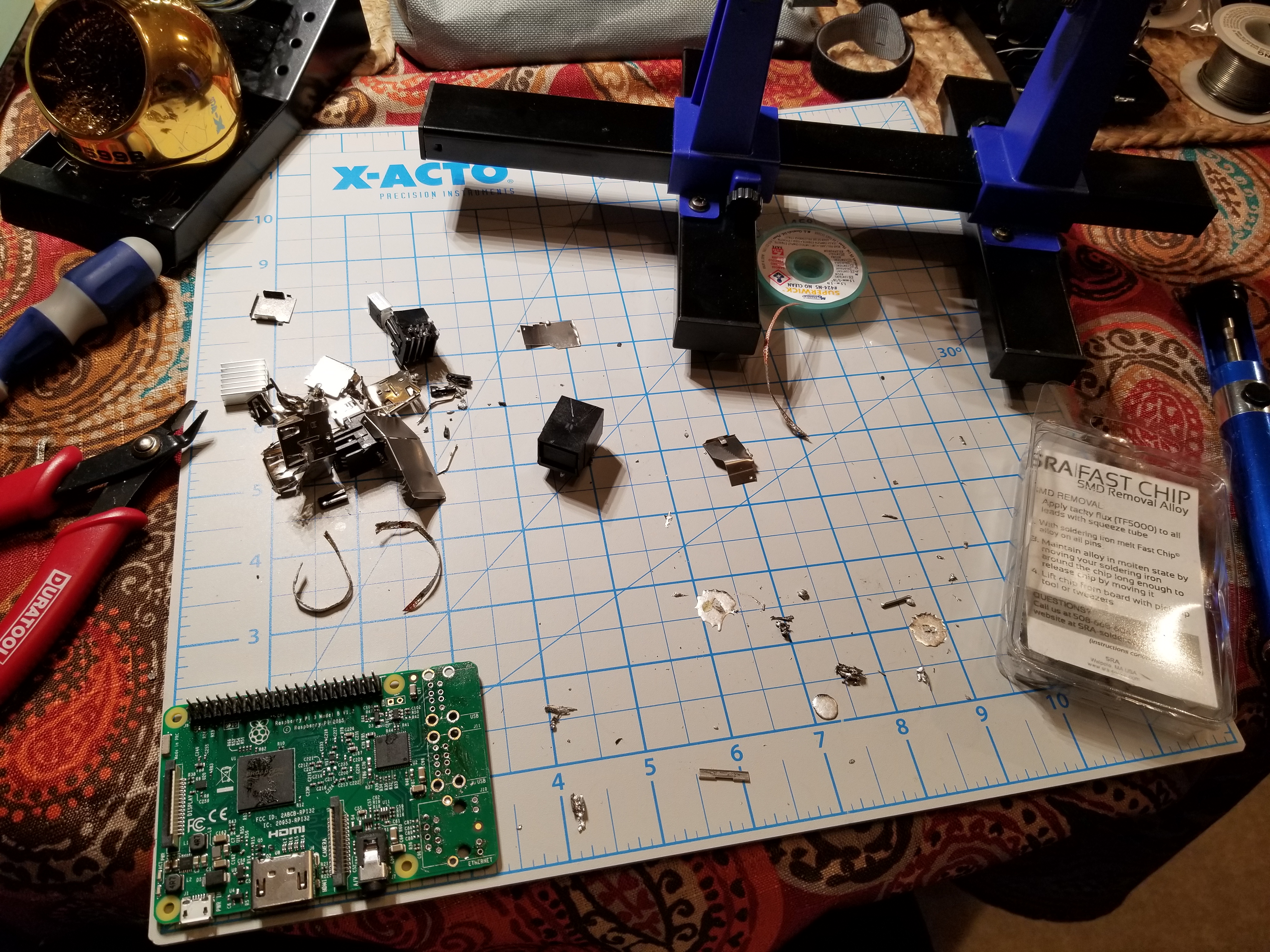

Post by firestw152 » Fri Sep 29, 2017 8:02 pm
I tried chipquik I put a bunch on made sure it was melted real good and nothing would budge still ended up ripping up a ton of traces. Not a big deal to me since im not gonna re-use theses ports but still I feel like I wasted money on the chipquick since it didn't work right.
What brand did you buy and how did you use it? I was hoping it would take 3 minute like you but here I am 1 hour in and still have to get rid of the USB ports. AHHHHHHHHHH

Post by dryja123 » Fri Sep 29, 2017 8:14 pm
It was a generic brand called SMD chipquik. Did you use copious amounts of the flux that it came with? The flux helps keep the alloy melted. A lot of flux, a little alloy, some heat and it should stay melted for like 10 seconds. Plenty of time to pull the parts loose.

Post by firestw152 » Fri Sep 29, 2017 9:07 pm
Guess that was the problem. Just used enough flux to cover the pins I did not put a lot of it on. Still tho when the Ethernet port was melted I tried with all my might to take it out but I still had to destroy it by cutting it out piece by piece.

Post by dryja123 » Fri Sep 29, 2017 9:25 pm
Rule #1: don't force anything.
When properly applied you can wiggle the component back and forth and it will come out. If it's giving you too much resistance it will break.
