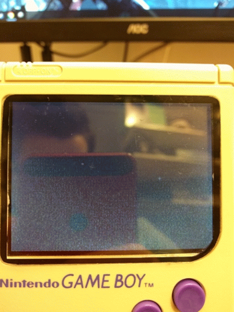

The problem:

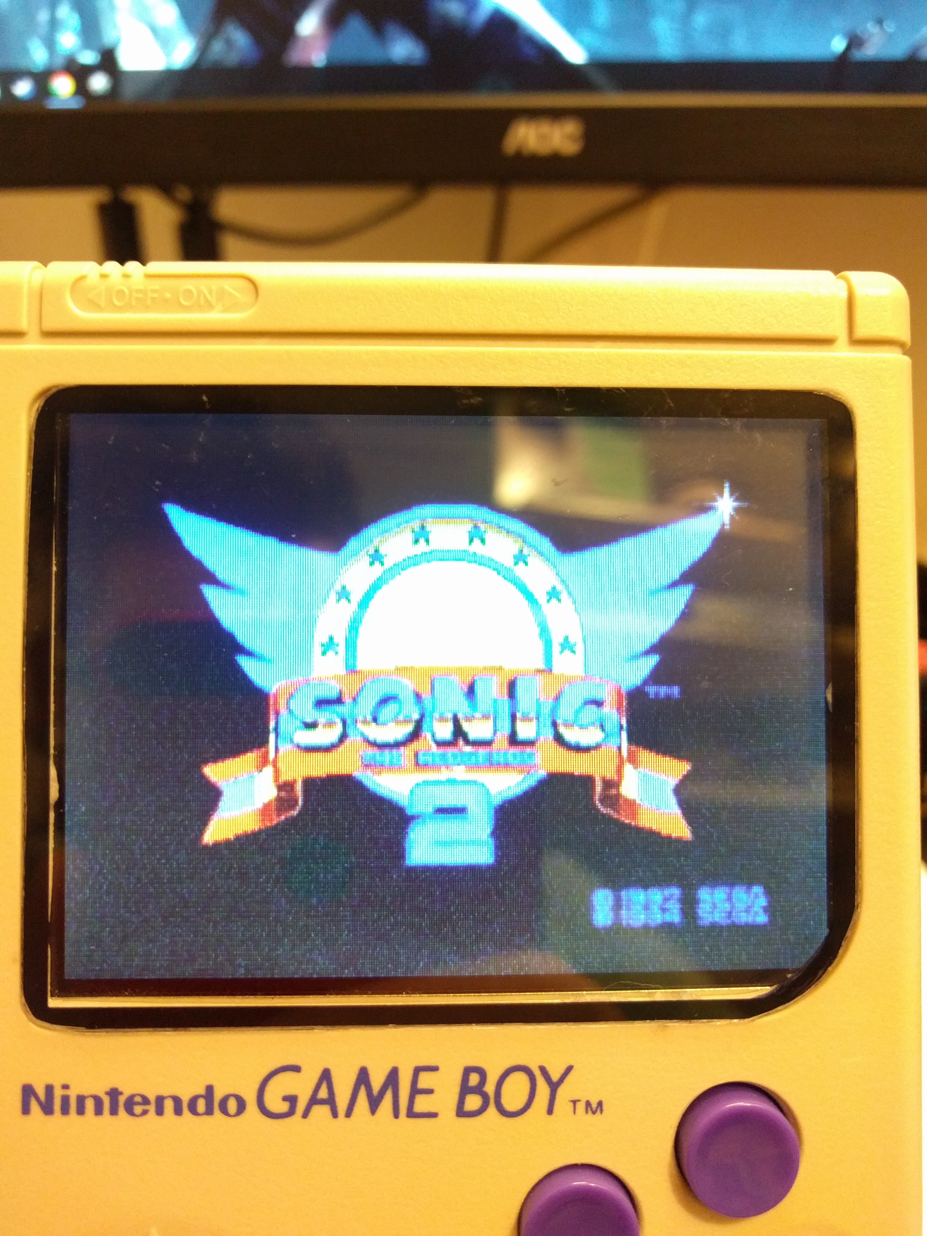

When I remove the PWM GPIO wires from my build, the static completely goes away - zero noise on screen. I've also removed the AIO board from the equation by going directly to the speaker and as soon as the PWM wires are connected I see the static again. I've swapped wires, isolated wires from the components, checked soldering points (I'm not new to soldering and have been doing it since 2003 when I worked with Xenium and Xecuter chips). My multimeter gives me a steady 5.15v from the Adafruit powerboost 1000c 5v line out. And finally, I do not see this issue via HDMI even with PWM audio forced. I have a spare crap screen from Amazon which exhibits the same static on screen ruling out the Adafruit screen as being defective or wired incorrectly for the 5v mod. This leads me to believe the combination of the composite screen and PWM Audio is the issue but outside of that general assumption, I can't seem to figure out how to fix it. I've search this forum and in general via Google but there doesn't seem to be anything exactly like this. Has anyone else seen this on their builds?
Just an FYI, I'm not new to the Rasp Pi, moding, soldering, small electronics scene. I've built a few different Raspberry Pi projects over the years using the Pi 1, Pi 2, Pi 3, and Pi Zero but this is a new one for me.
