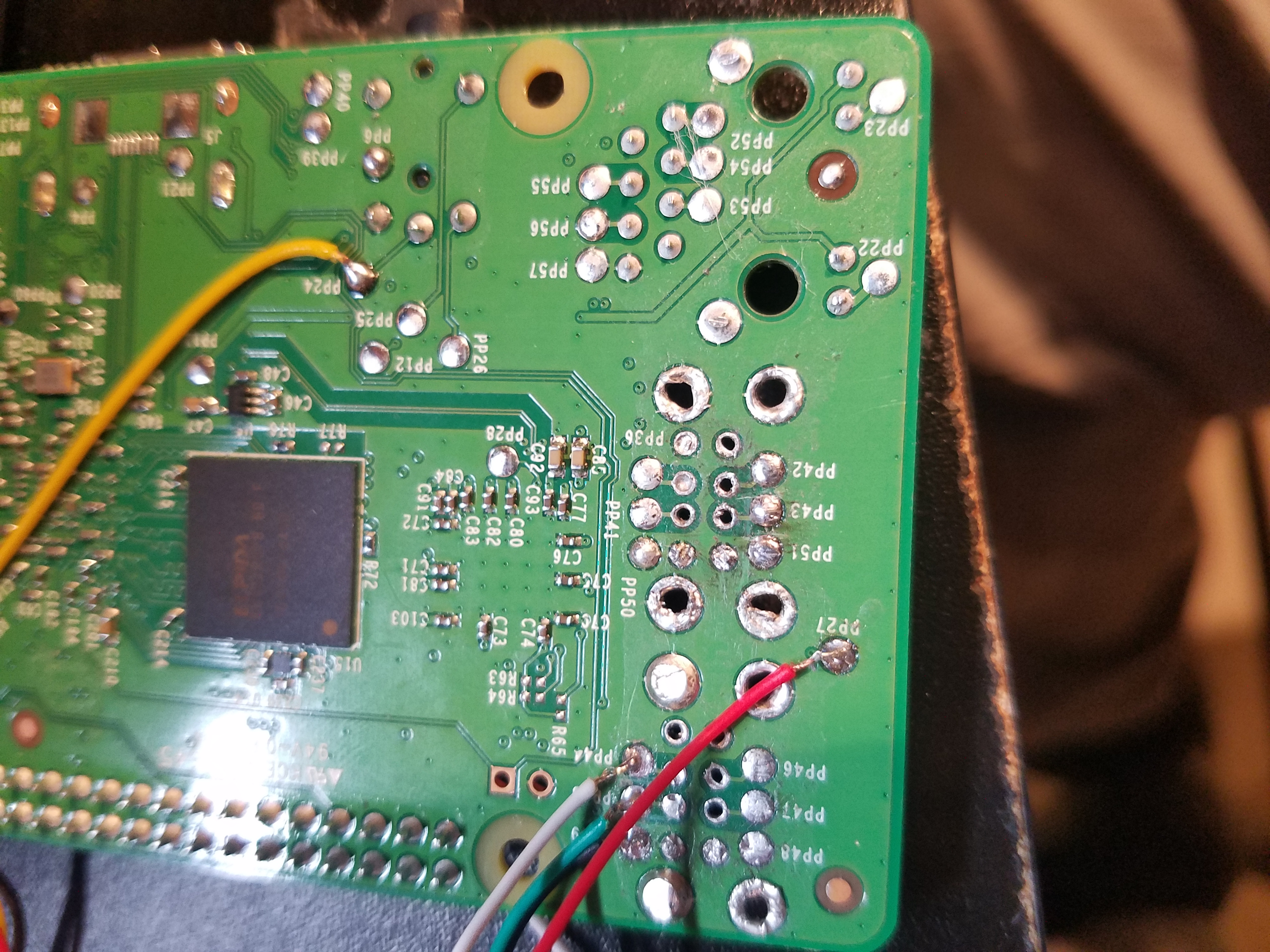

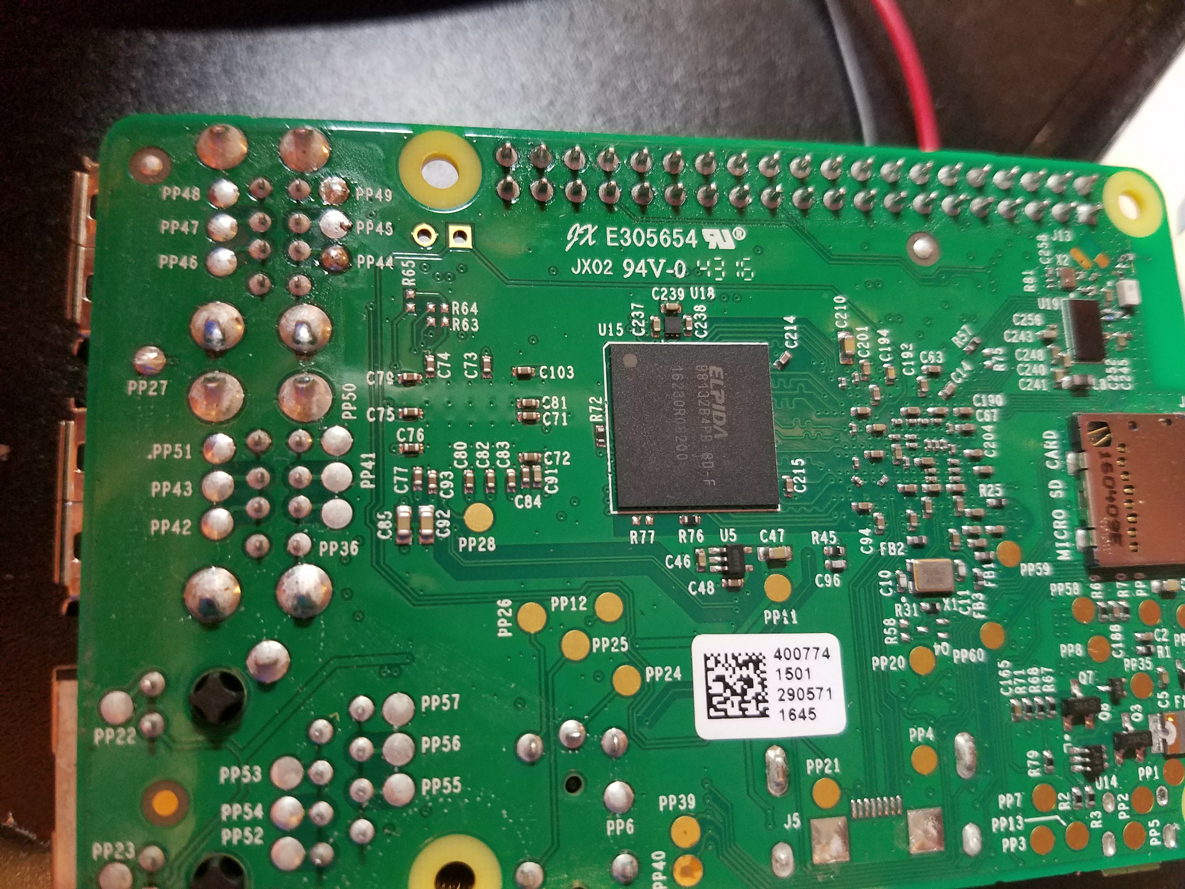

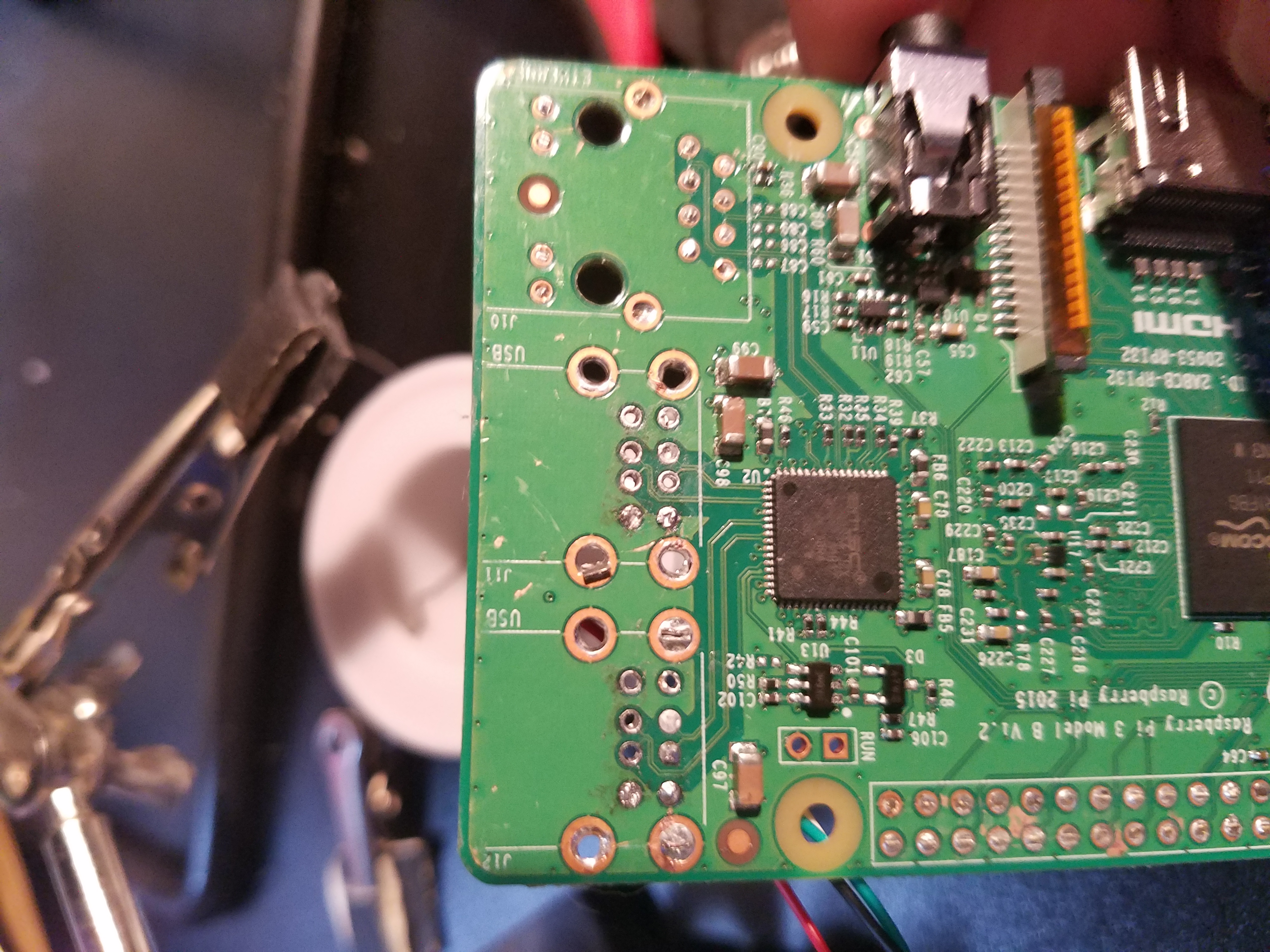

I Slimmed down my Raspberry pi 3, Took out the Ethernet and USB ports, now when soldering direct to the pads my USB does not function, I tried all four direct and test pads ( PP49 Ground, PP45 D+ , PP44 D- , PP27 VCC- USB ) I get no response with my keyboard or any other device, Not to mention I have a yellow lighting bolt at the top right corner of my display I don't know if that may be also causing my USB to not function? any help would be appreciated, I am planning on making a Gameboy Pi 3. Will post pictures of my pi 3 hopefully someone can tell me if I damaged anything based on pics, Thanks for looking.

Re: Raspberry pi 3 (Removed USB Ports) Broken?
Post by JujuPi » Thu Mar 23, 2017 4:04 am
Hey mate
If you were reading my thread - my pi 3 build I can tell you this happened to me as well.
What has happened is that the desoldering of the ports has most likely caused one of the pcb layers to short out - Therefore you do not have 5V coming out of the usb ports. Check this please.
If you are getting 5 V - check if your data lines are correct. If you see no change - it is definitely a shorted pcb layer. This happened to me using a 400* professional soldering pump. If you were tocut the pi 3 you can see that there is about 3-4 layers. If they short - they can kill the whole pcb. I lost my 5v to usb and it caused my pi 3 to die 2 h later because i back fed 5 v.
I would suggest checking with a microscope - or trying to remove as much solder as you can.
Post by JujuPi » Thu Mar 23, 2017 4:05 am
BTW that red wire is in the wrong place - 5V comes above that grey wire :)

JujuPi wrote:BTW that red wire is in the wrong place - 5V comes above that grey wire :)
Thank you very much, I took my volt meter and I'm not getting 5v, I think Its dead, I will try with another pi 3 but this time I am going to just trim solder to existing pads and not disolder anything, hope this works, thanks again for your reply.
