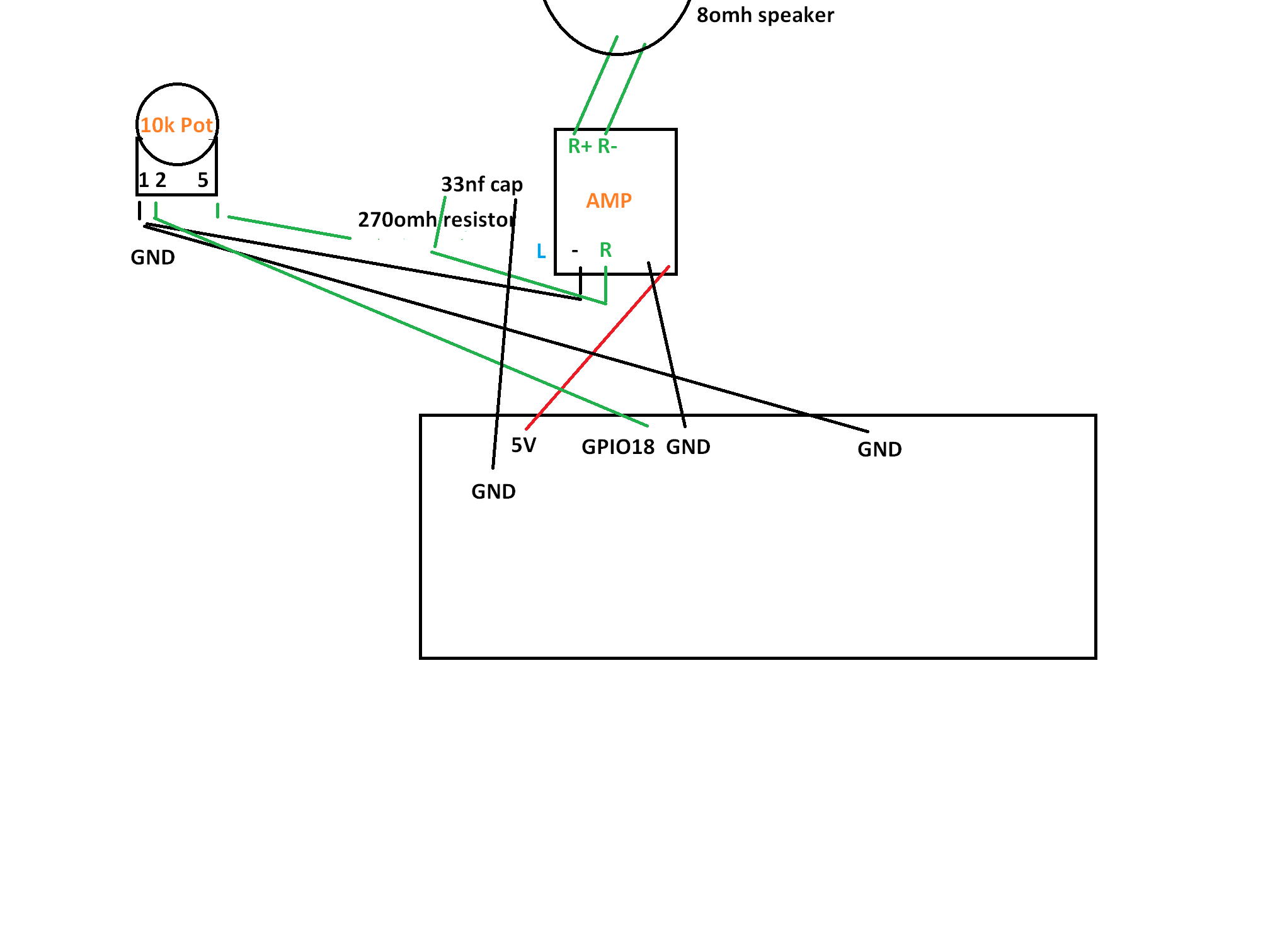

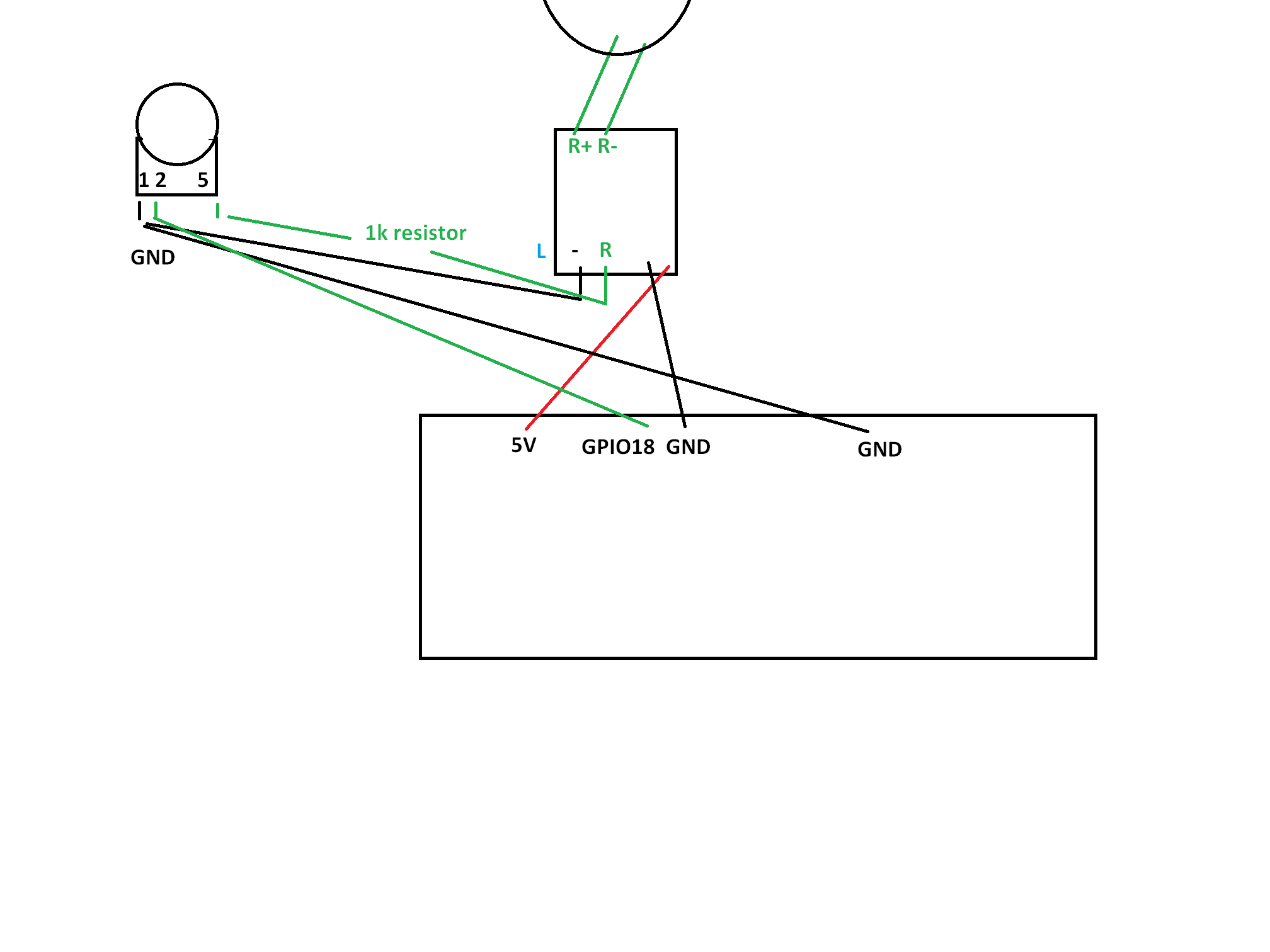

Below is my current wiring diagram. Be gentle, I spent 32 hours in MSPaint on it ;)
Audio Wiring.png (40.06 KiB) Viewed 14320 times

Are you using a filtering circuit on the PWM audio coming out of the Pi? That might help clean the audio a bit.

Another 15 hours in MSpaint and I present you the updated working diagram =) Thank you again
Audio Wiring.png (43.13 KiB) Viewed 14304 times
