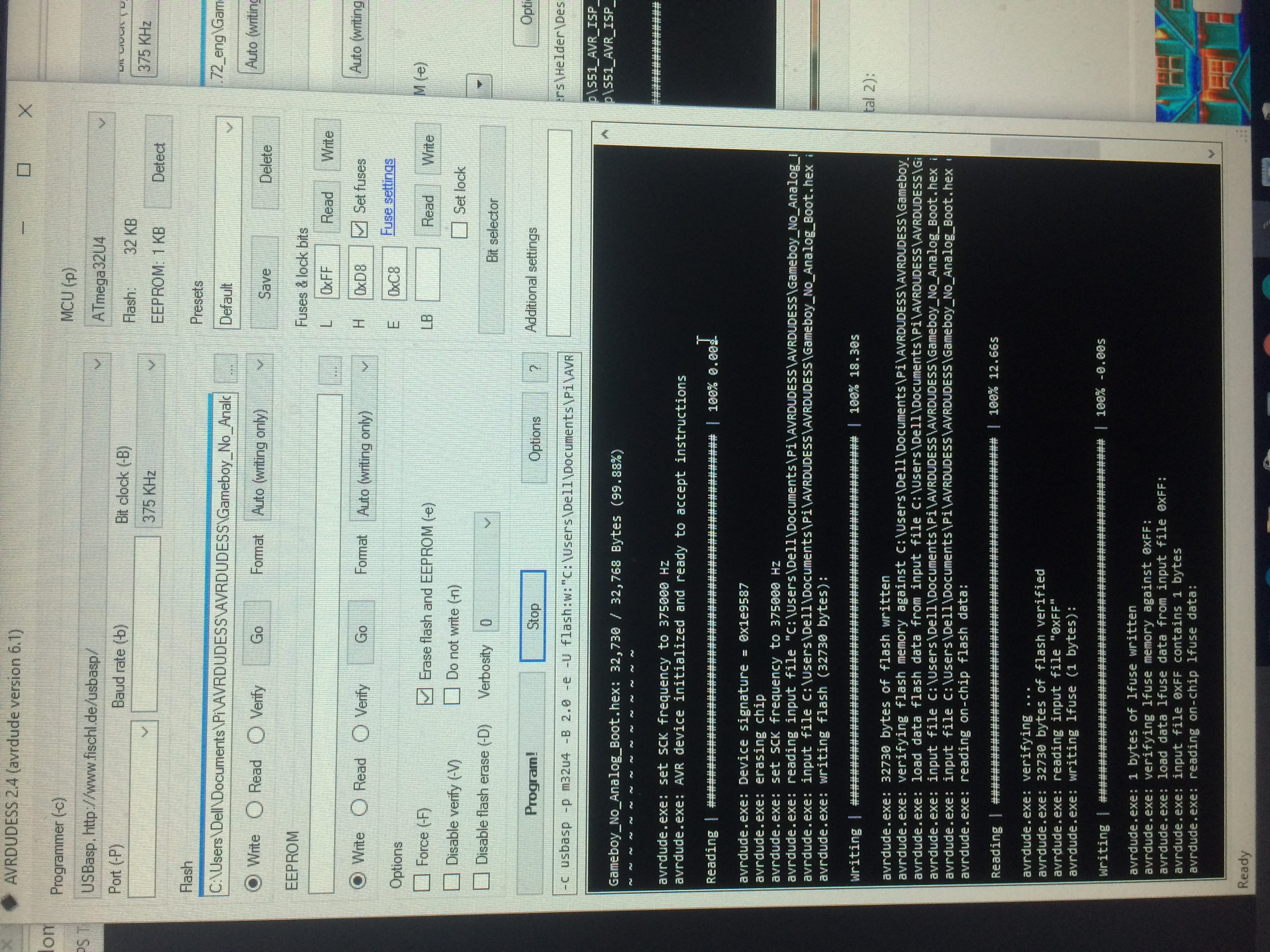

Post by SwingeyP » Fri Aug 12, 2016 8:39 am
Hello @Helder,
I have programmed the board with the USB guide and once I got the correct driver all seemed to go smoothly.
Programmed, verified and fuses set etc.
I still cant get EmulationStation to detect the controller :-(
I've tried everything I can think of now but still no joy.

Post by Helder » Fri Aug 12, 2016 1:44 pm
Plug it into a PC and like in the Arduino IDE tutorial and see if it's detected in the PC as a controller. You can also go into the Retropie config with a keyboard then configure the gamepad that way. The Retropie has to be configured for the controller with the controller so it doesn't magically just know it's the AIO and sets it up for you.
Test it on the PC first and we will go from there.

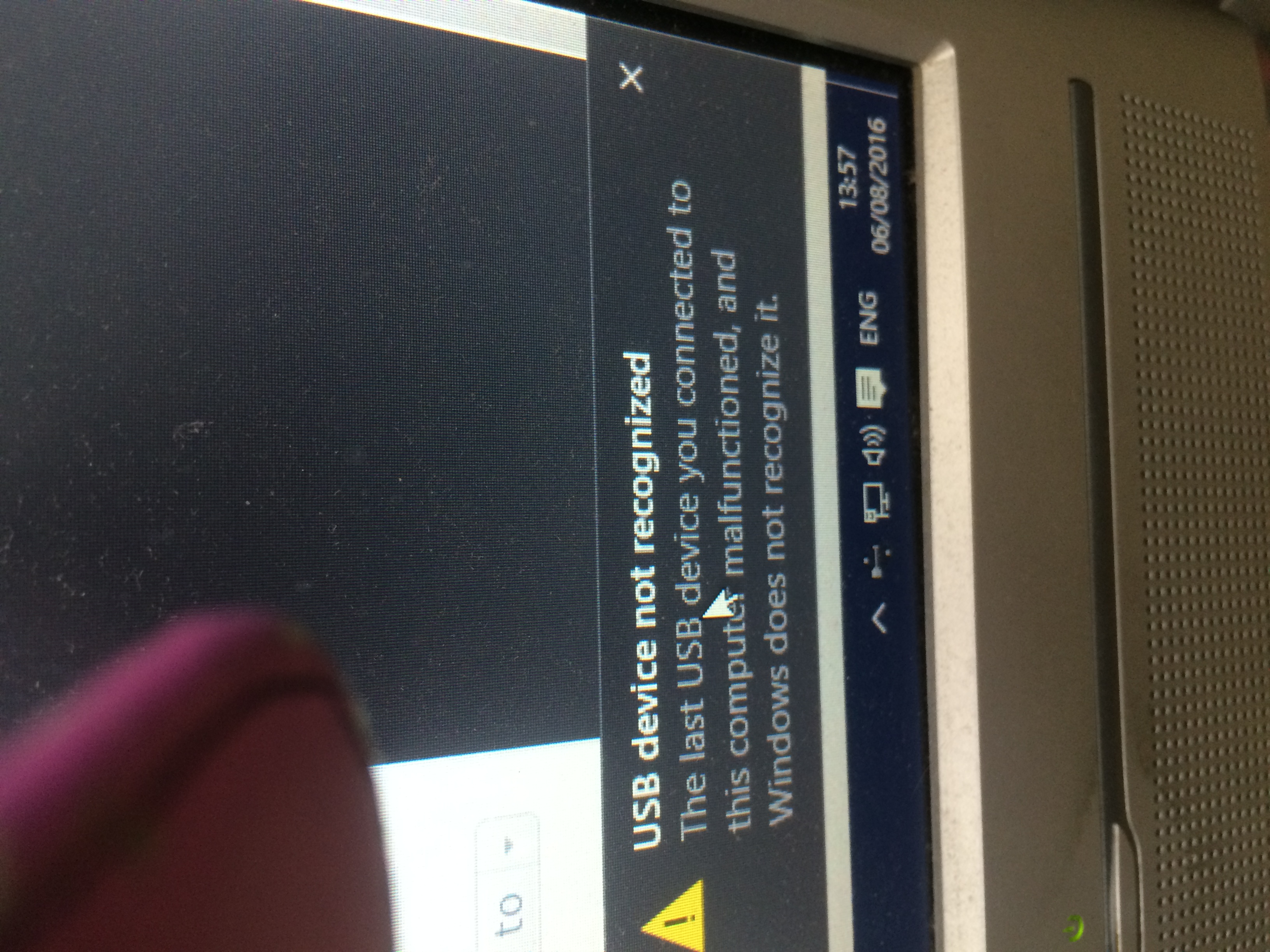

Hello @Helder,
Ok.
I reconnected the USB lead as I had originally and hooked it up to my Win10 PC.
All I see is the USB Not recognised error message popup and the device shown as :
'Unknown USB Device (Port Reset Failed)' in the Universal Serial Bus Controllers list.
I have tried swapping the white and green wires but when I do this nothing is detected at all (makes sense)
So, nothing detected by the Win10 PC.
[color=#8000BF][b][size=85]https://www. ... b][/color][/size][/size]
Re: How to Program Helder's All in One GBZ PCB with Arduino IDE
Post by Helder » Sat Aug 13, 2016 9:53 am
SwingeyP wrote:Hello @Helder,
Ok.
Do you happen to have another PC to try it on? I checked every board before shipping it so it's hard to believe that there could be a problem with it.
Before I replace it could you try another PC and also reflow the 12MHZ oscillator as if that somehow isn't properly soldered on then the USB part of the board will not function properly and give the errors you're getting.
