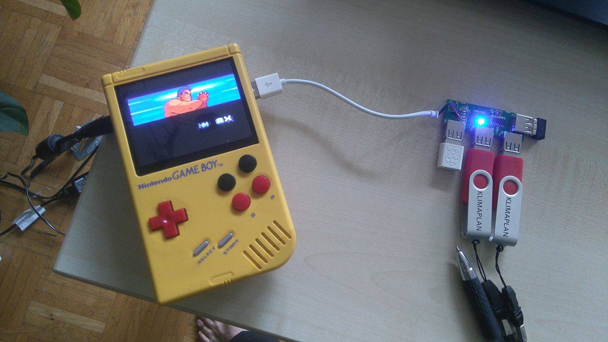

Hallo people :D

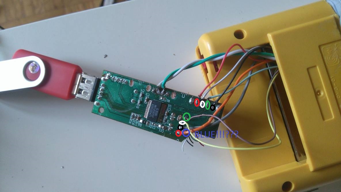

I really need Help with my Usb Hub, it is very extrange but my teensy works, and the other two ports seems to get power (but not enough for a keyboard!!) there is a blue wire that I dont know what it does...
gb0 0.jpg (118.04 KiB) Viewed 13605 times
The Teensy only works if I wire it to port 1, and port 2 only gets power enough for a usb stick (wich i already used to put games inside the system)

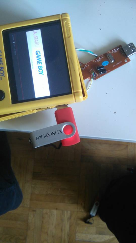

GB0 00.jpg (38.93 KiB) Viewed 13605 times
the port number 4 wich, only gets power to light the light of the usb stick but doesnt transfer the games...

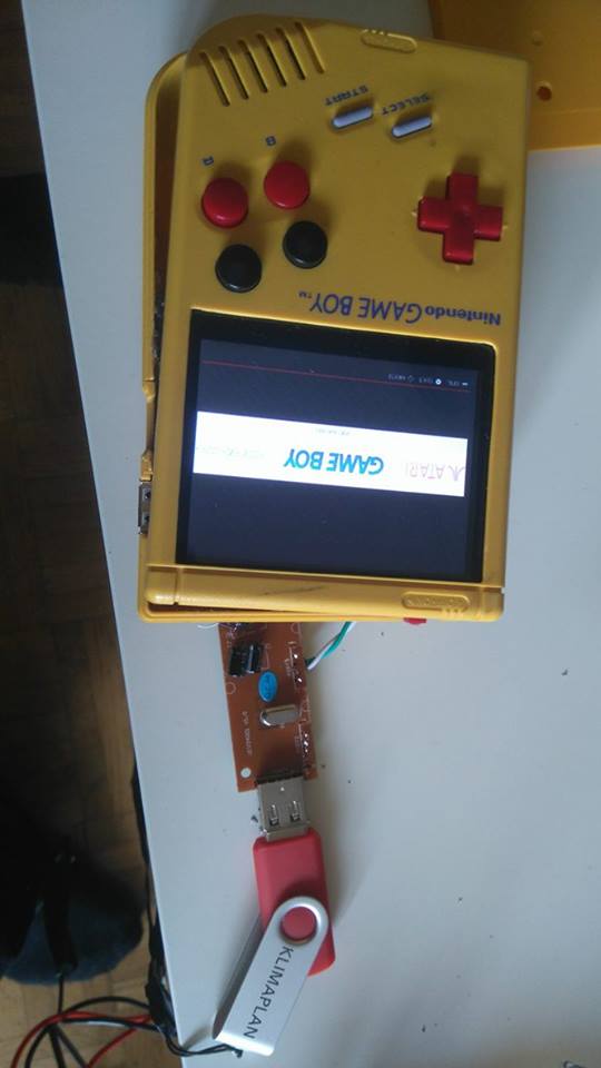

gb0 1.jpg (39.48 KiB) Viewed 13605 times

Not sure what you mean by the extra blue wire? All wires should have a purpose so maybe start fresh and rewire?
Lphillimore:
I actually dont have a clue what that blue wire on the input does... really no clue... the hubs seemed to get power though... when I put a stick it does turn the light on... the 3rd port works good (i can plug a wireless keyboard) but the fourth doesnt even take that...
