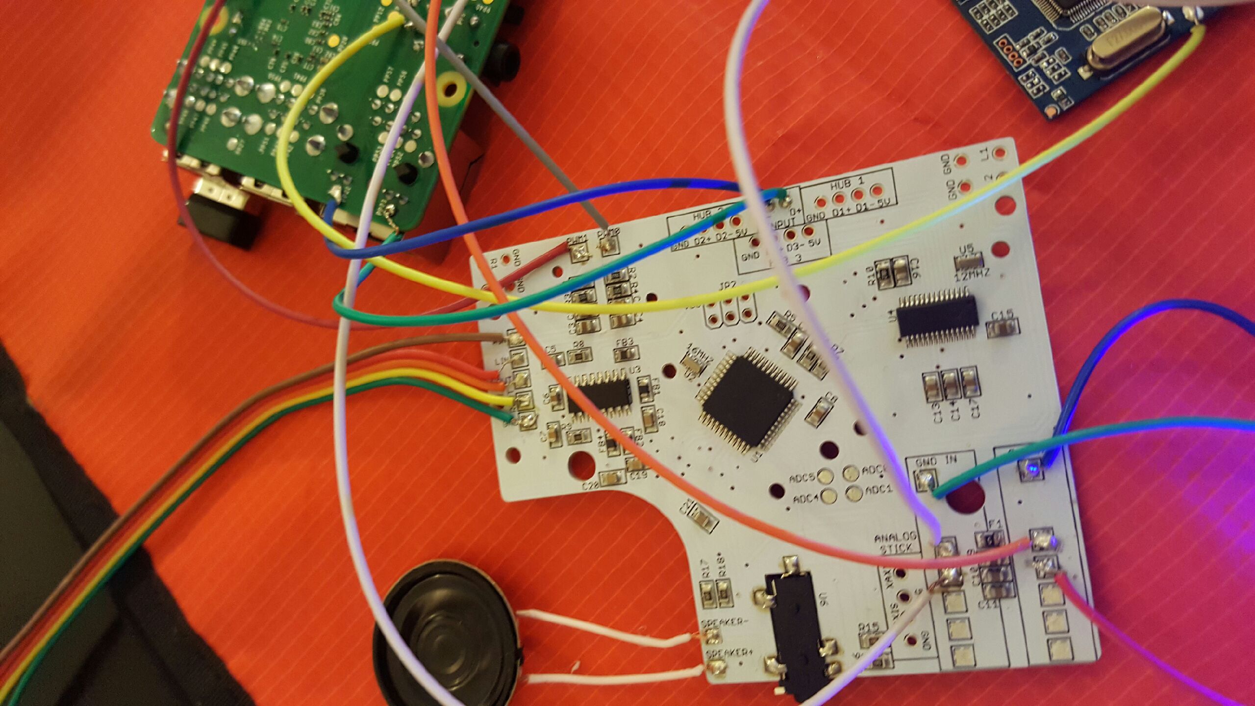

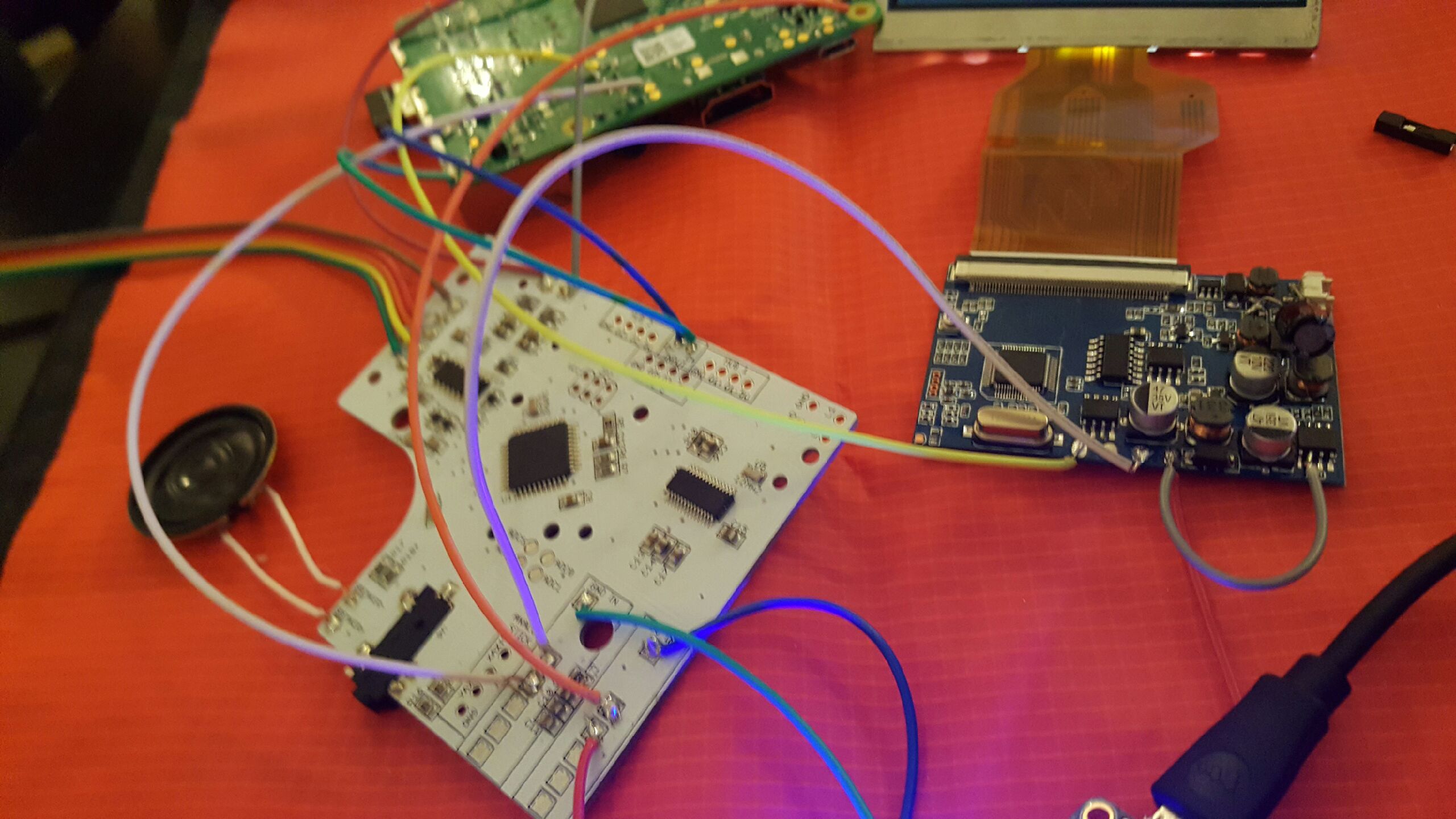

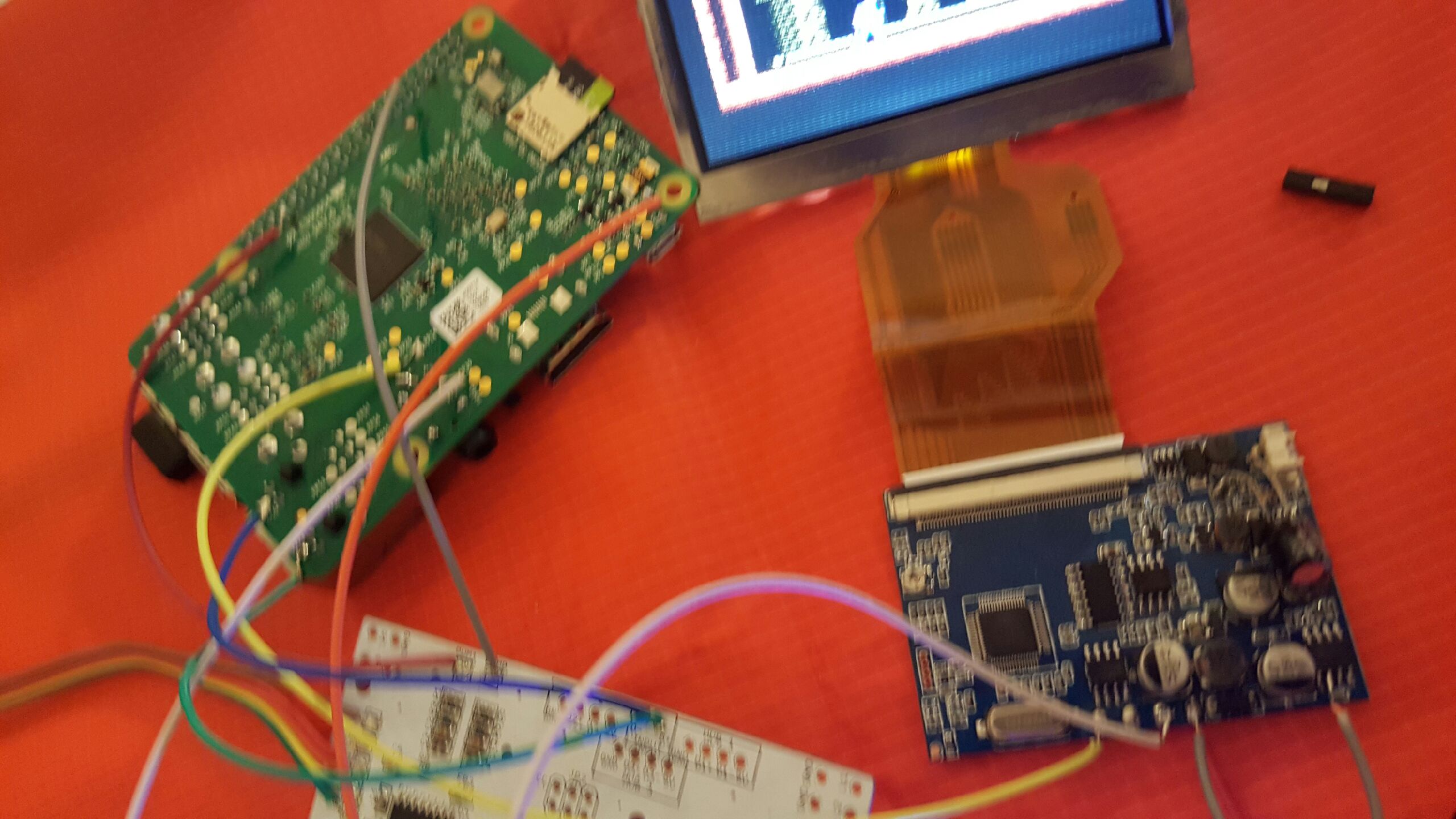

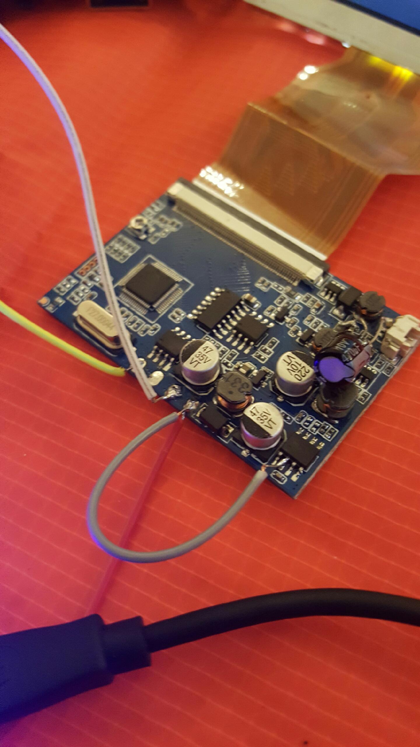

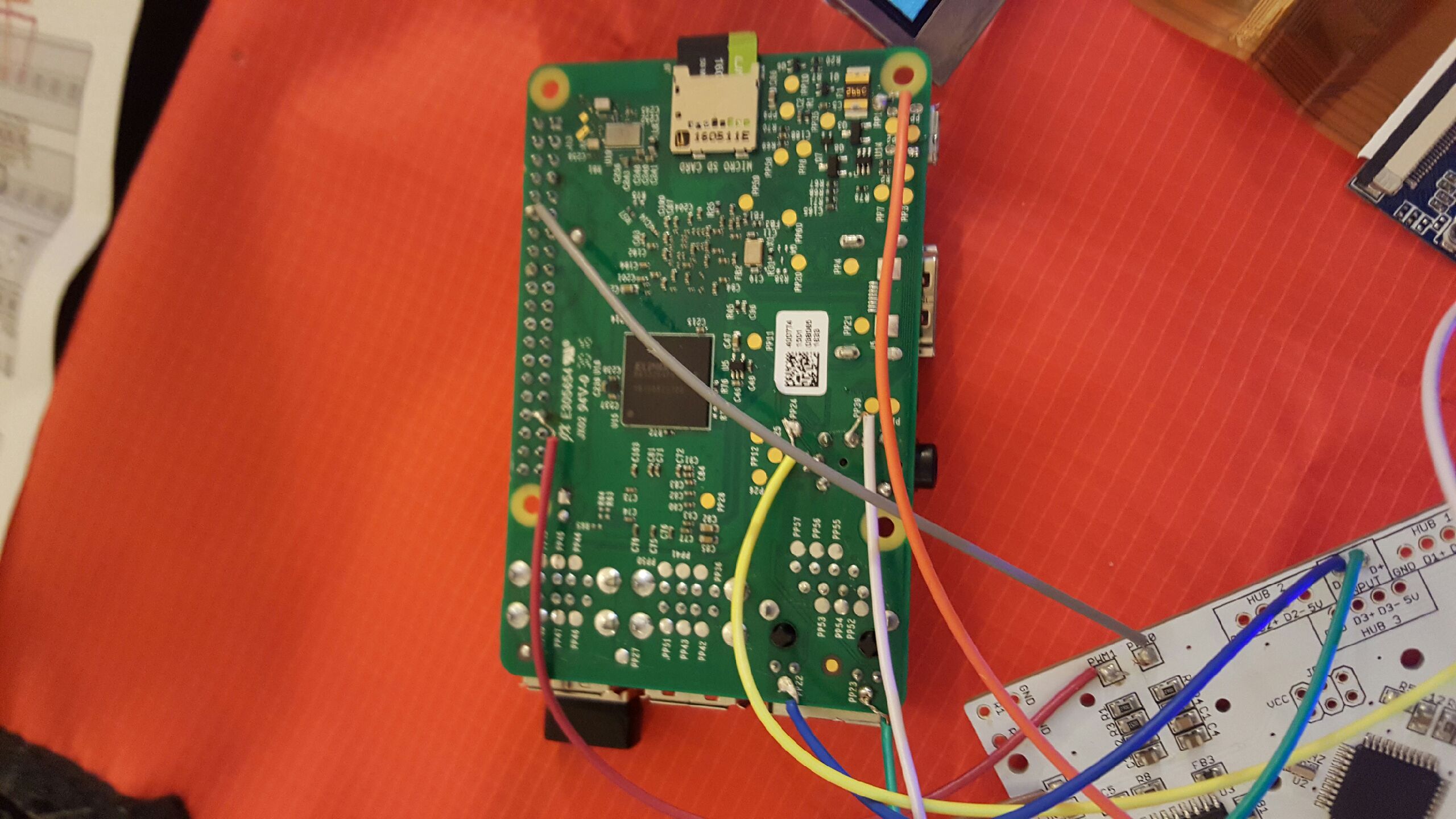

I have been trying to get my BW screen working with my raspberry pi 3 but there are artifacts on the screen that I can't identify the cause of. I see other people on the forum having no issues with their screen after the 5v mod. I think I did the 5v mod right but I can't be sure. If anyone has any insite on my problem please say something. Thank you!!
Wiring to screen from pi
wiring on the screen pcb
what the screen looks like when on
more wiring

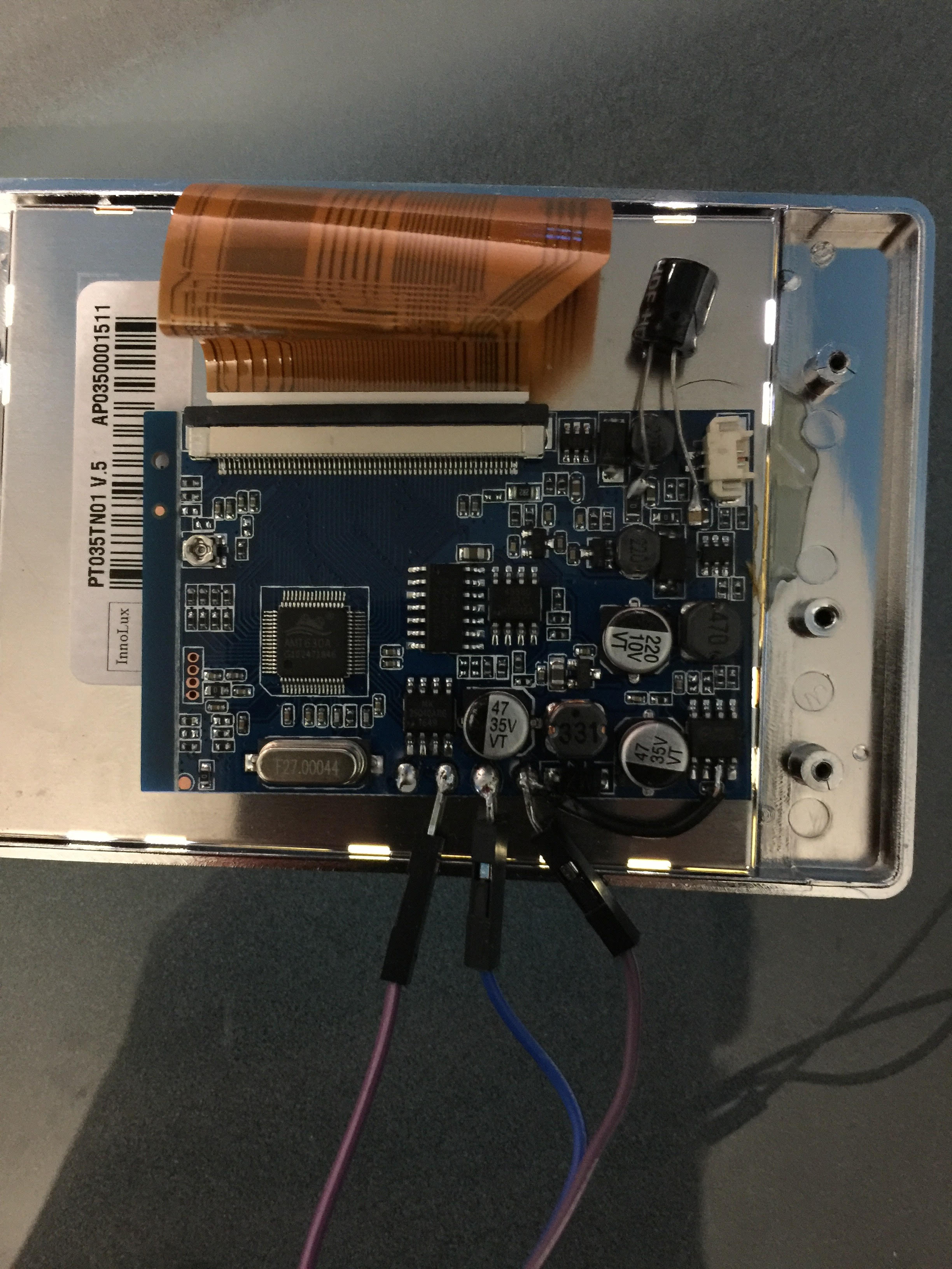

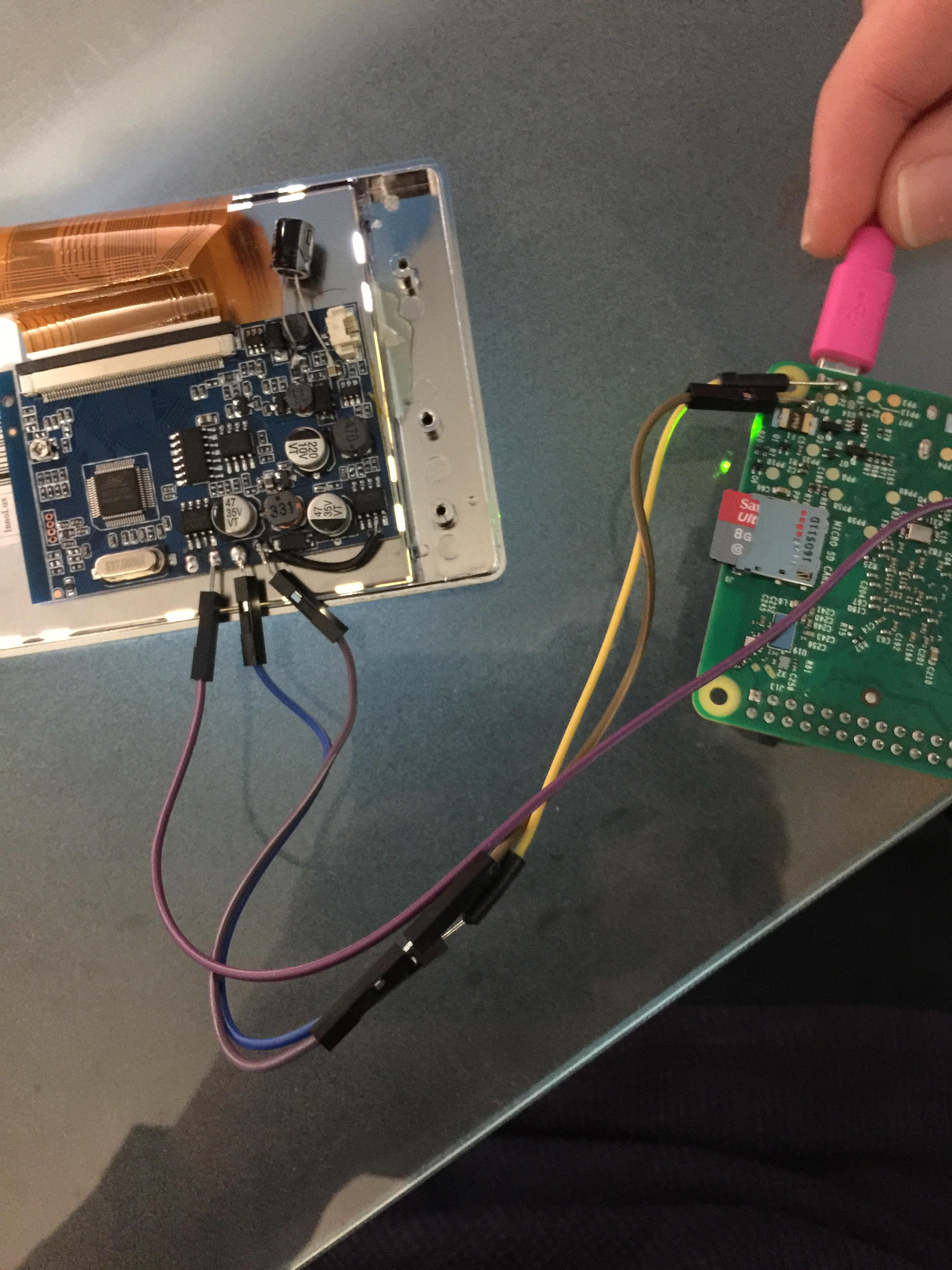

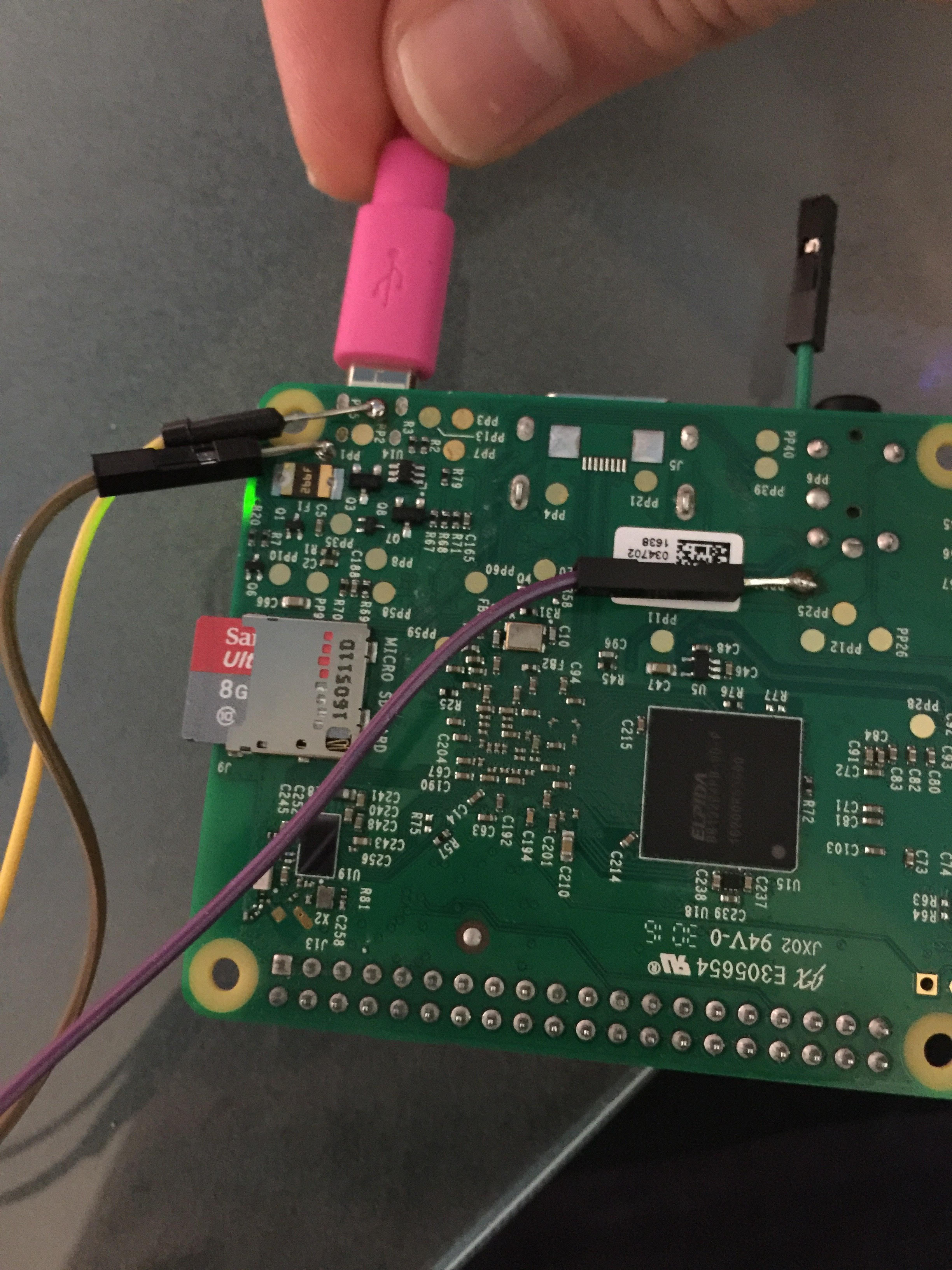

same issue but not as fuzzy check my wiring out it may help I know chaning the front could help and resolution

Your 5v mod is on the 3rd pin of that chip. Mine is on the second pin. Let me try switching the pins and I'll report back tomorrow. Thanks!

Monti55
Posts: 10
Joined: Tue Jan 31, 2017 6:09 am
Re: BW Screen Fuzziness Issue
Post by Monti55 » Mon Feb 27, 2017 4:47 pm
Brandonmel wrote:I hope it works ill be looking forward to your progress I found that its not 100 percent but maybe we can figure it out together
I just switched the wires and I go it to work. The visual problems are gone and it got rid of the hissing sounds that was also there. Thank you so much!
