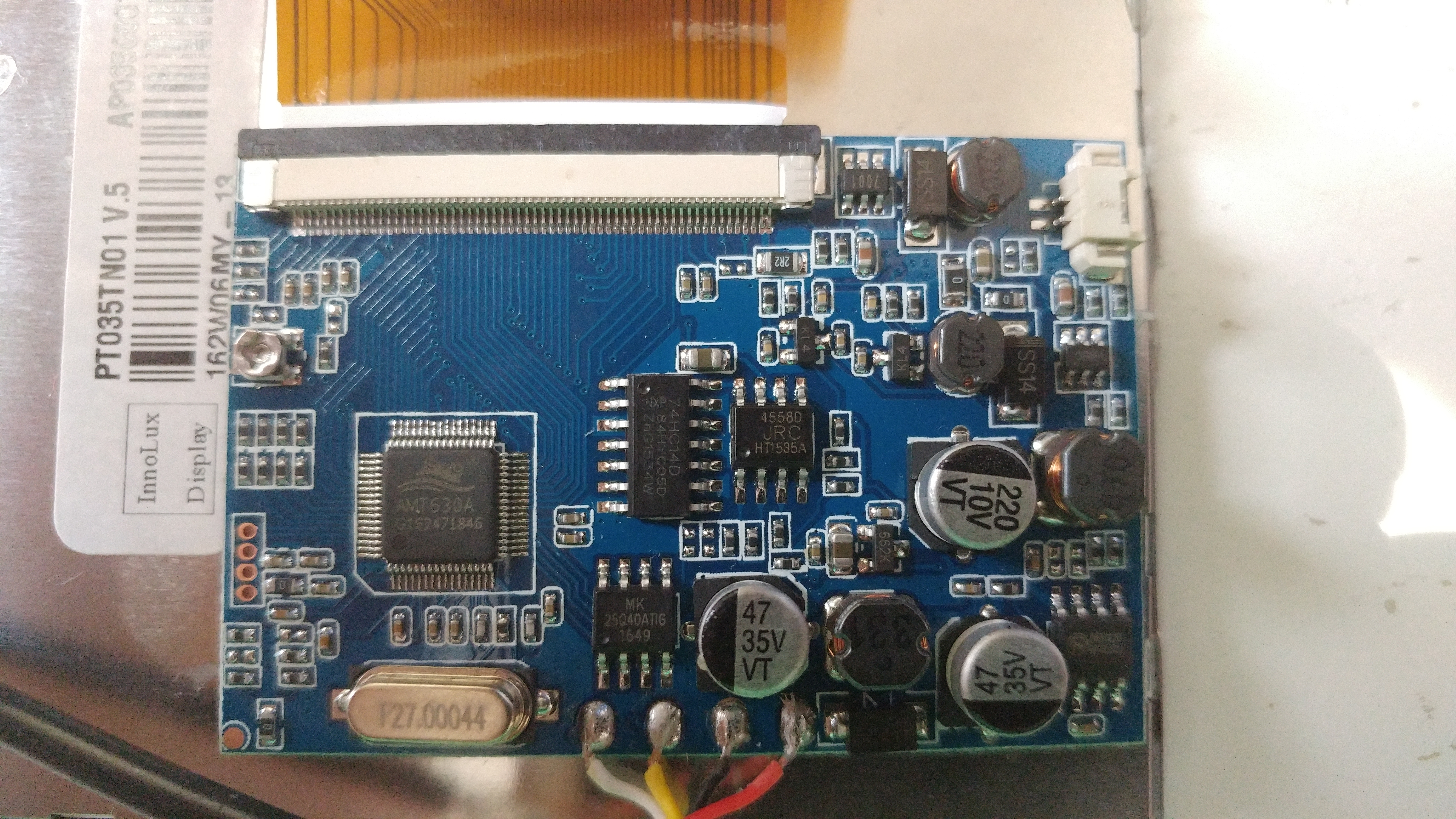

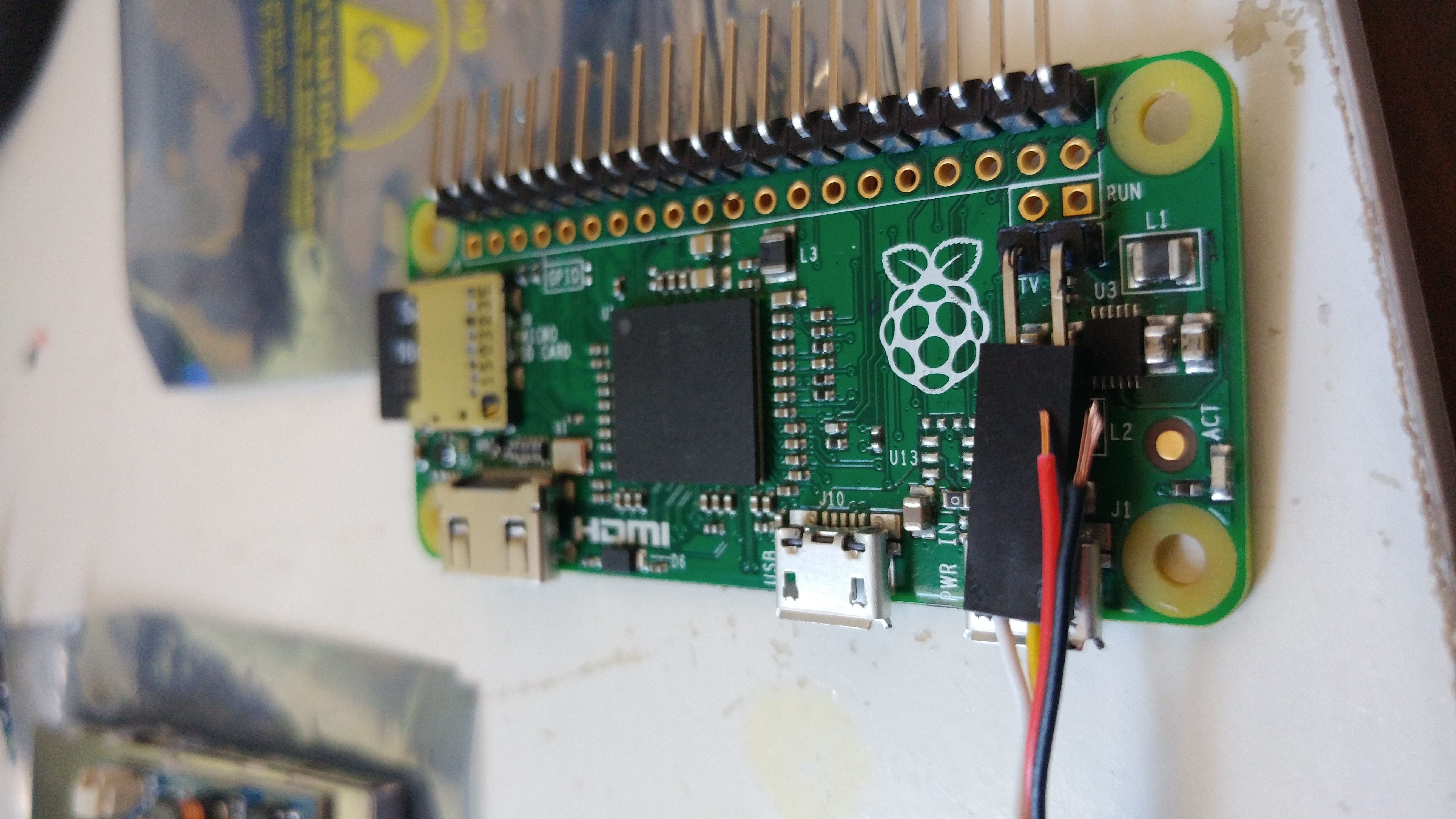

Trying to set up my display to the PI Zero and am having some trouble. My board has a trimpot on it, I wired it directly to the pi zero and am not getting a display. It was originally showing 1.6V on the display board, I have since raised it to 5V but still get no display. Do I need to mod this board to make it compatible? I looked at the GBZ Screen page but couldn't find any information on this board. Any help is greatly appreciated.
Thanks!
Here is some info
Screen I bought
Pixel: 480(W)*RGB*272(H)
Power: ≦3W
Power supply: DC 6V-36V
InnoLux Display(?)
PT035TN01 V.5
Board says
MT_MAIN630A_35D_S4_60PIN_V.2
Using a Pi Zero with RetroPi 4.1

Ok Why its not working is because you need to mod your screen from 12v to 5v. I already lookt on the Wiki. So please profide us with all the info.
1. What screen your using. Name and Serialname
2. What Raspbarry version
3. What Software and Verion.

I think you have video input wrong. White and yellow are Video 1 and 2 input, ground is black, like voltage ground is black too.
