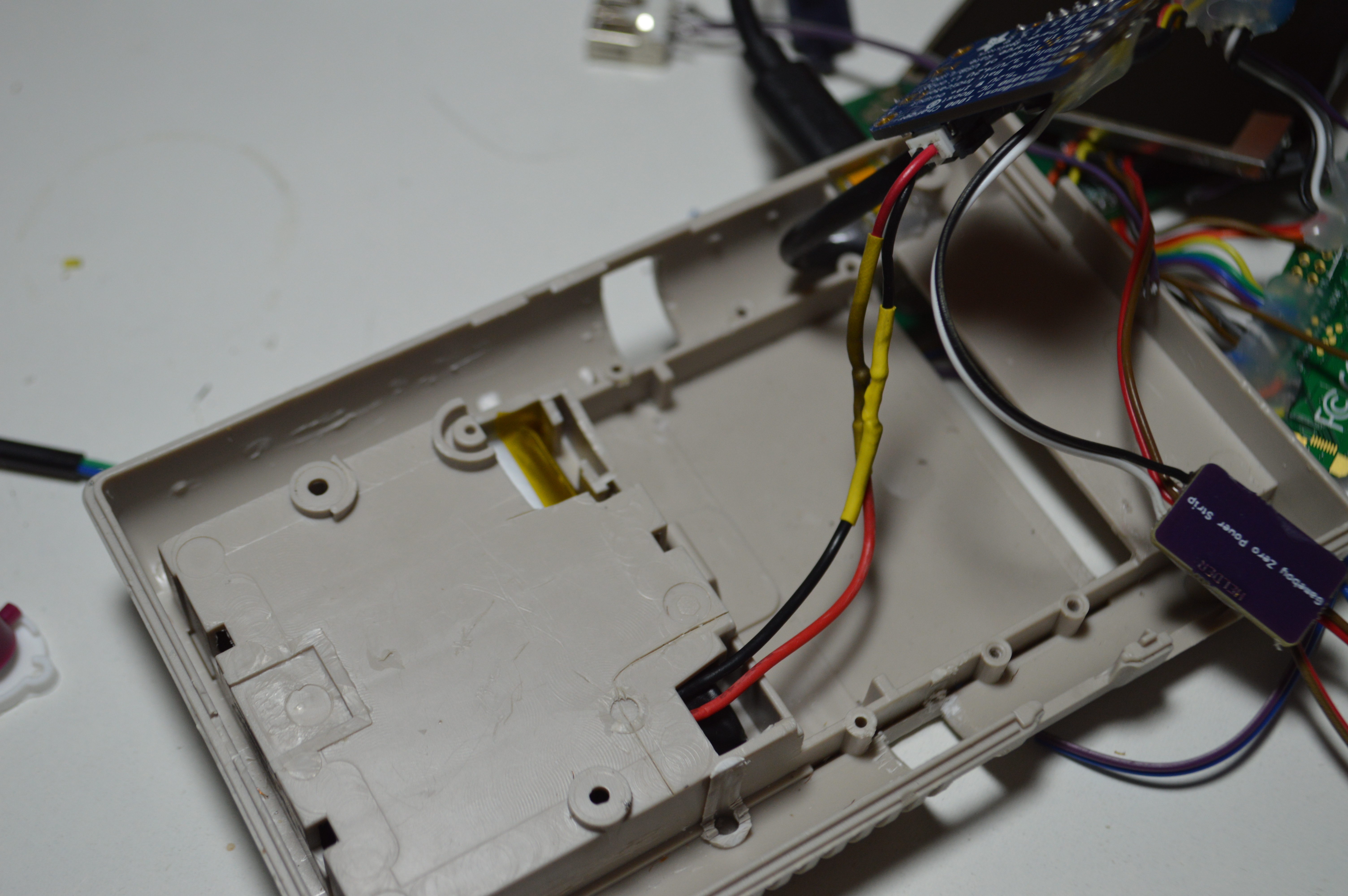

Okay! I got my battery today and immediately set to work on it.
Quick note, be EXTREMELY careful with the output wires if you get it, there is roughly one molecule of solder on the joints to the circuit protection board. I definitely didn't tear one off while stripping the end *cough* but I decided to do a little surgery and beef up the connections. Also, the leads are pretty short, only reaching about halfway up the case if you slot them through the existing holes in the battery bay, so I spliced them to a spare JST connector.

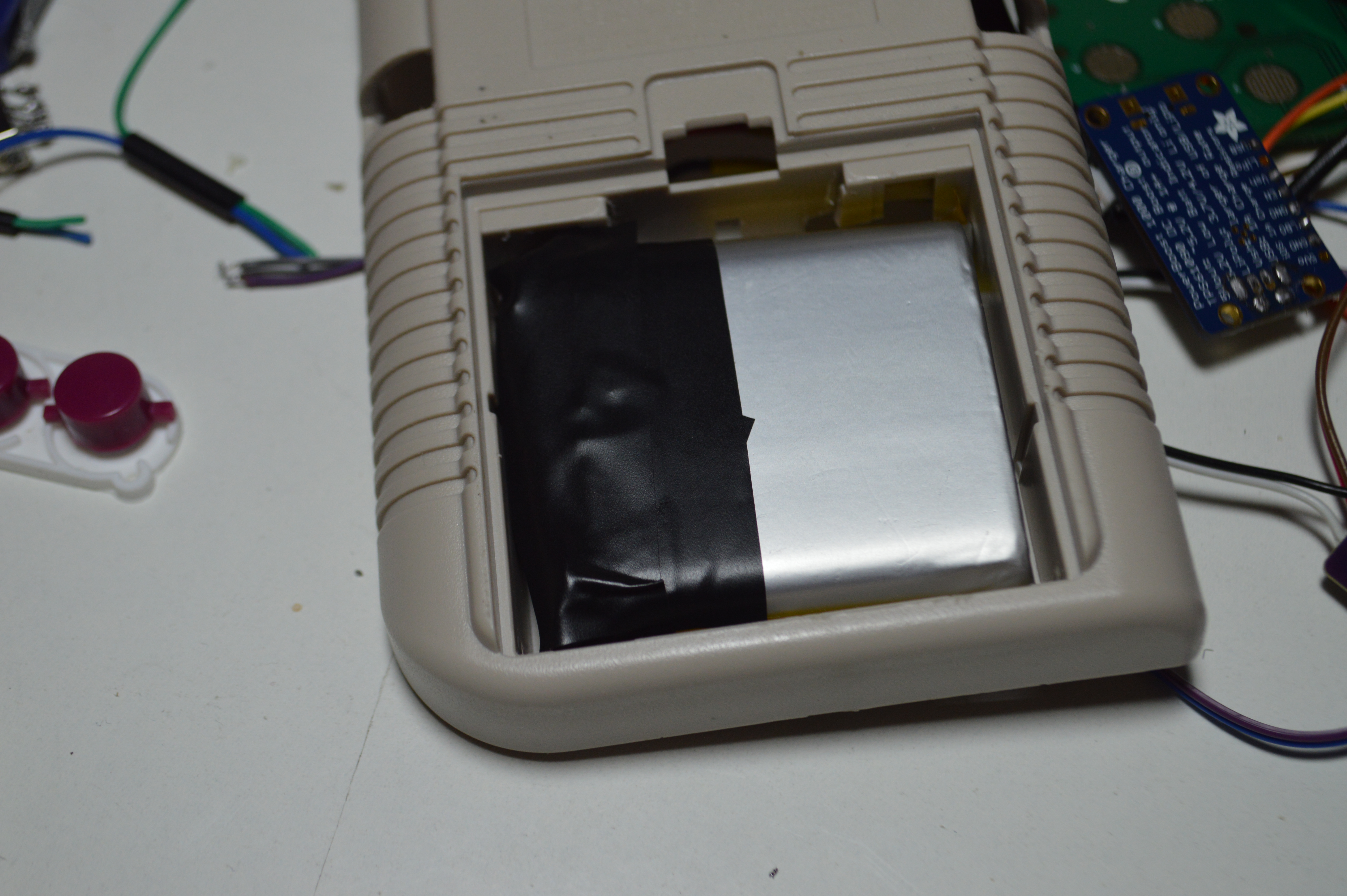

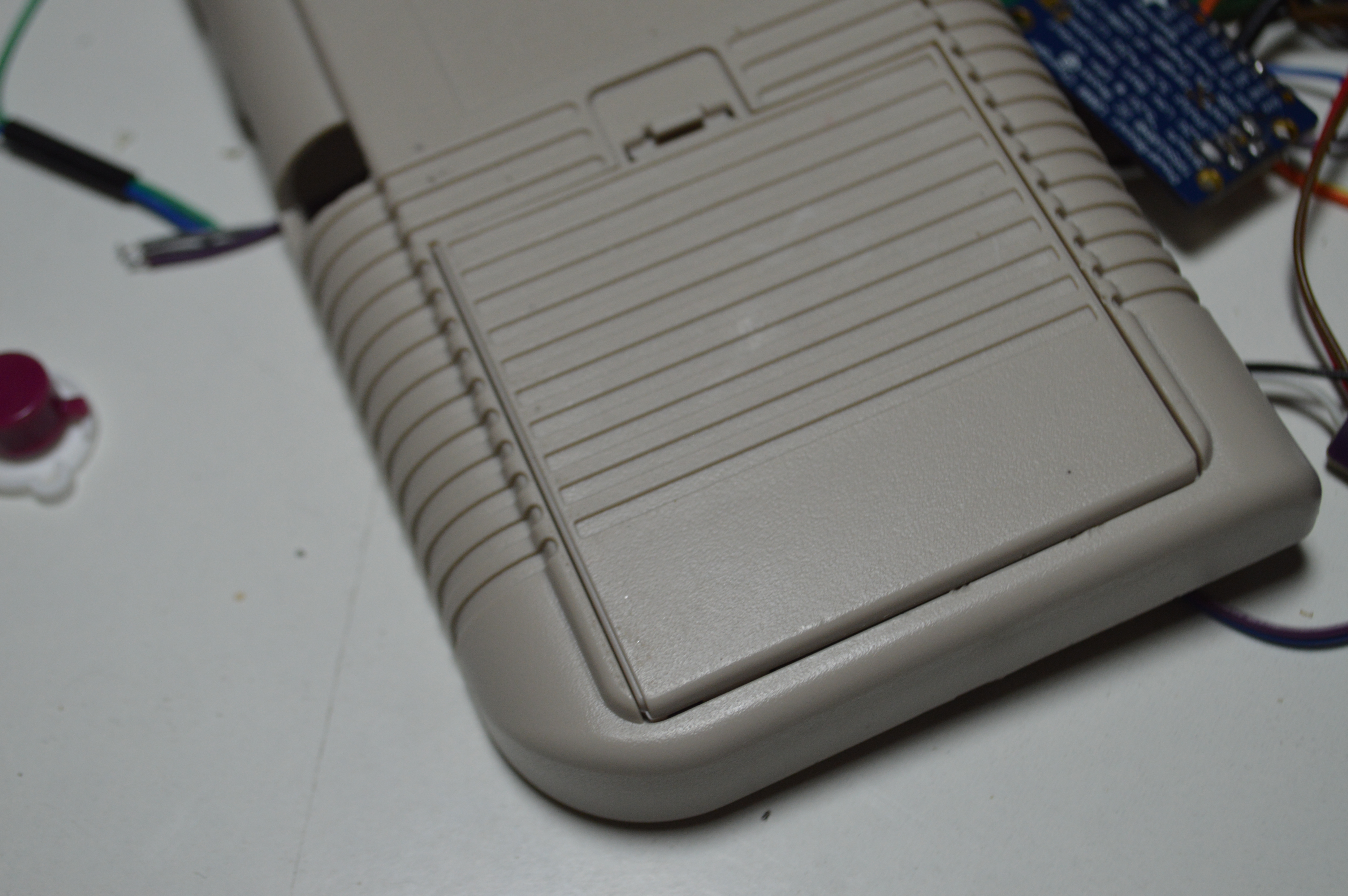

Good news! It fits absolutely perfectly in the battery bay. I preemptively carved out all of the AA dividers and the slots to hold the metal AA terminals so it wiggles a little, maybe 2-3mm vertically and another 1.5-2mm horizontally. I imagine it would fit without any modification, or maybe just the lower bits.

The battery came depleted, so I charged it up using my GBZ's Powerboost circuit and played for just over five hours before the PB low battery indicator came on. It was a combination of Gradius III, Chrono Trigger and Star Fox. I didn't test it to shutdown or failure, but when I get to my multimeter I may go and test the voltage when the indicator lights...if anyone is interested.

So there you go; if you're interested in a decent capacity battery for your GBZ that doesn't require modification to the DMG case and can fit in the battery bay, this is a contender!
