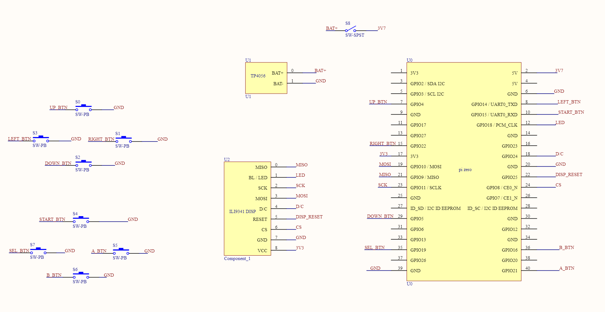

is it possible that you can post a video guide or wire diagram??
thanks in advance!

Here's a screenshot of my altium schematic that might help! A little late but just saw some of these replies
