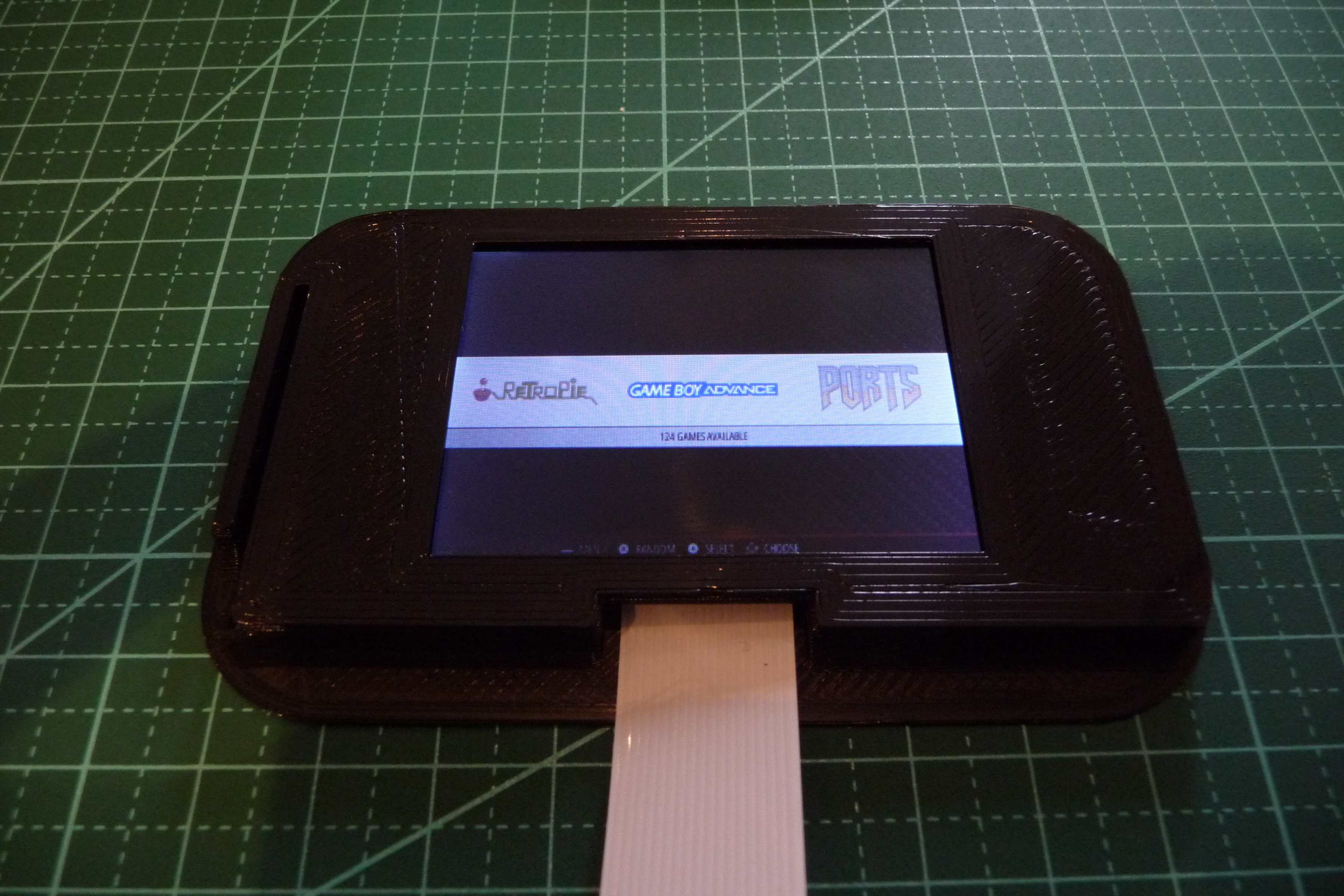

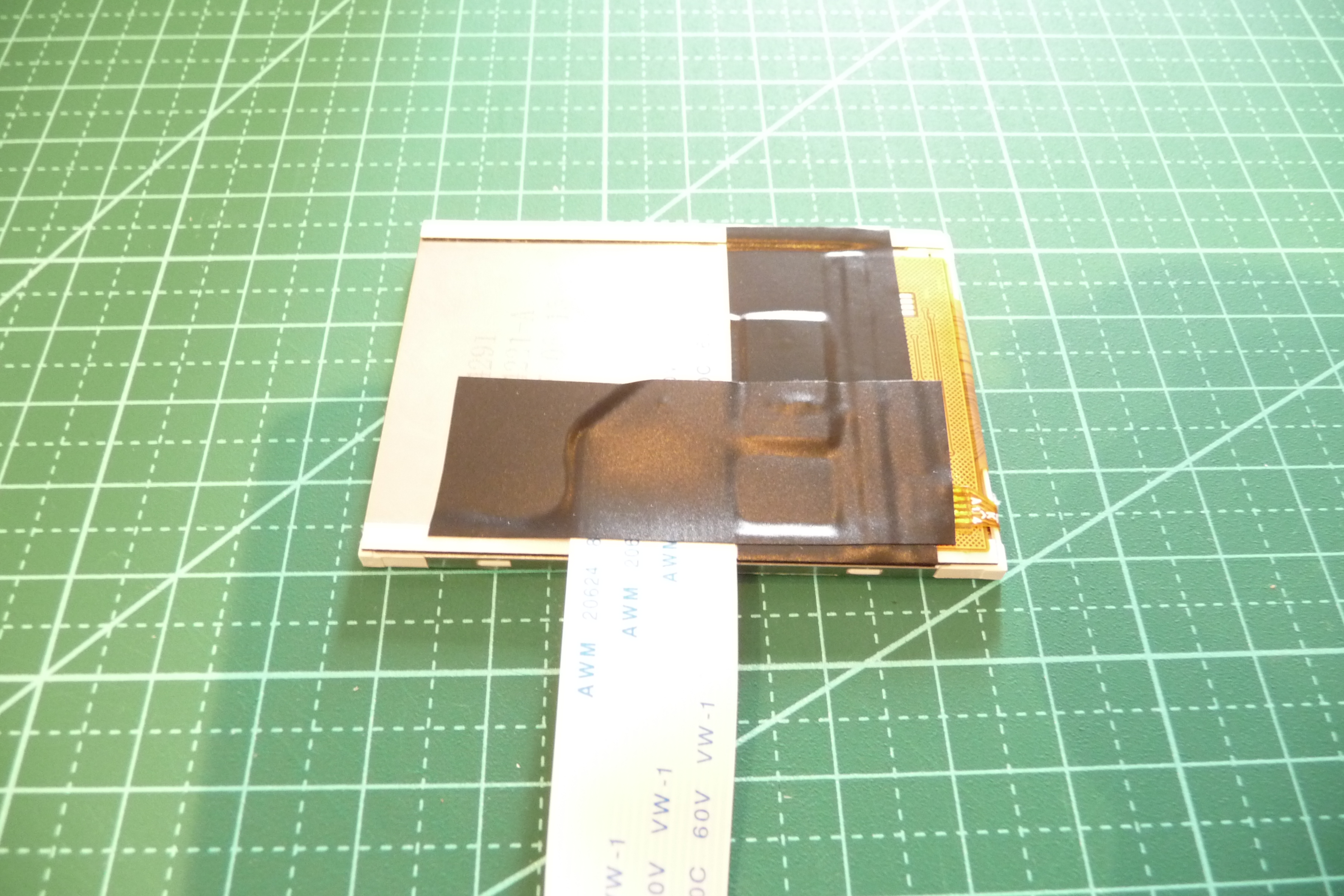

2017/12/01 The screen is finally working and connected to the Pi. Not an easy task to solder it for a starter like me. Made a mistake in the first screen so had to wait for a second one.
screen back
Screen front

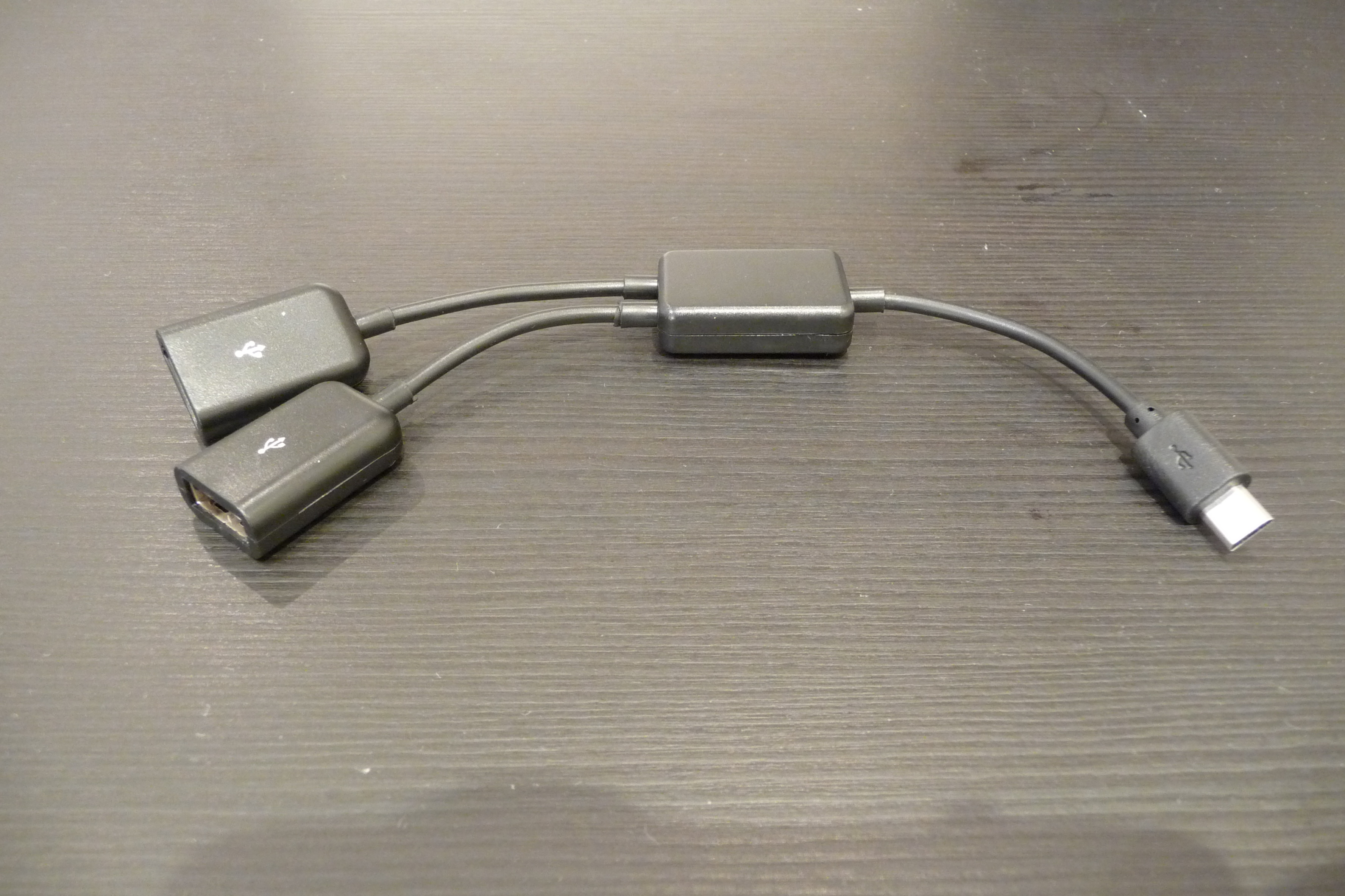

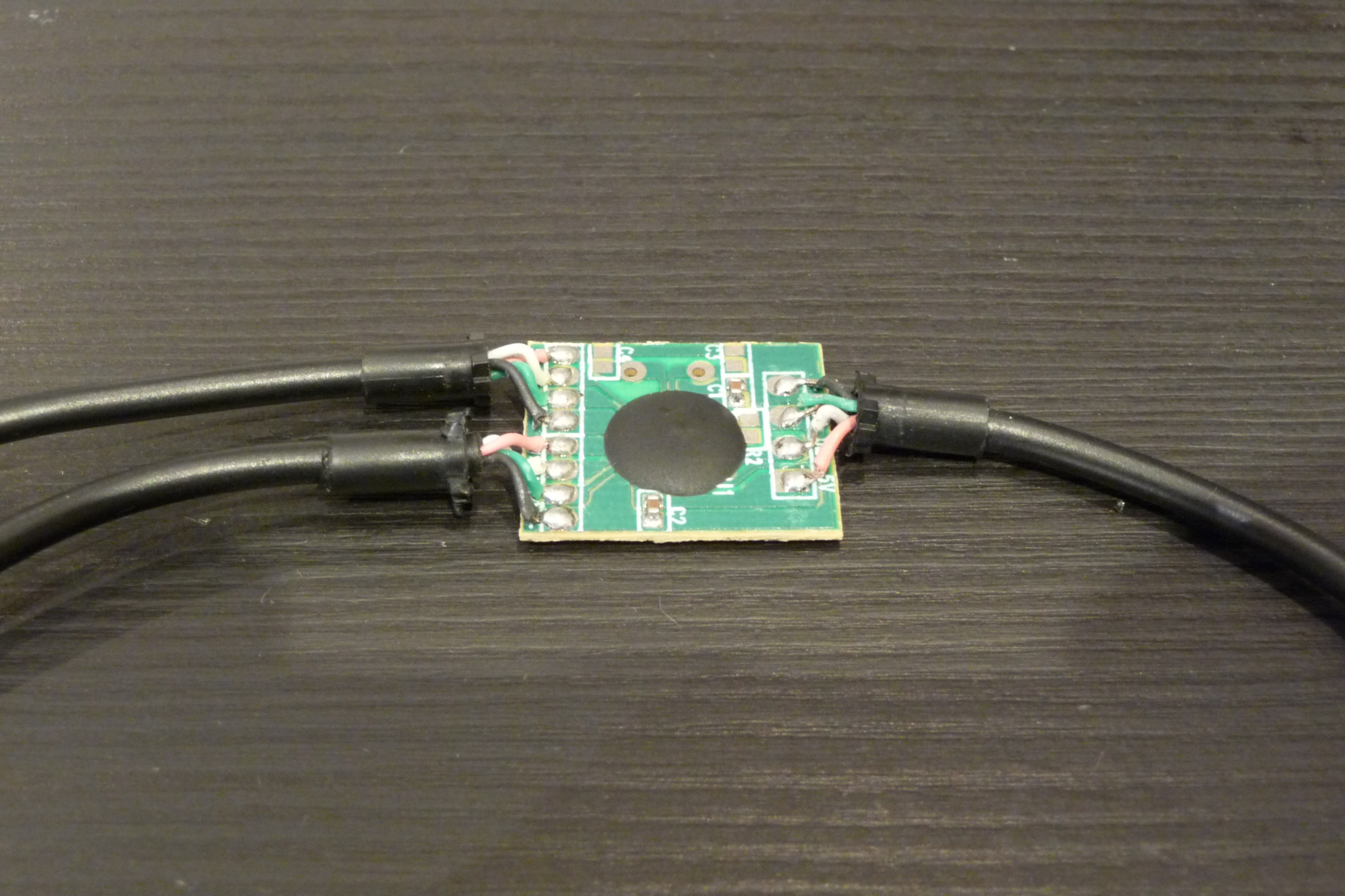

The USB hub I used was this one:
USB hub closed
USB hub open
Re: MintyPi with PSP joystick, stereo jack and USB port
Post by VeteranGamer » Wed Dec 06, 2017 4:01 am
joao wrote:
Wed Dec 06, 2017 3:27 am
does it work?.....
and do you have a link for it?.....
