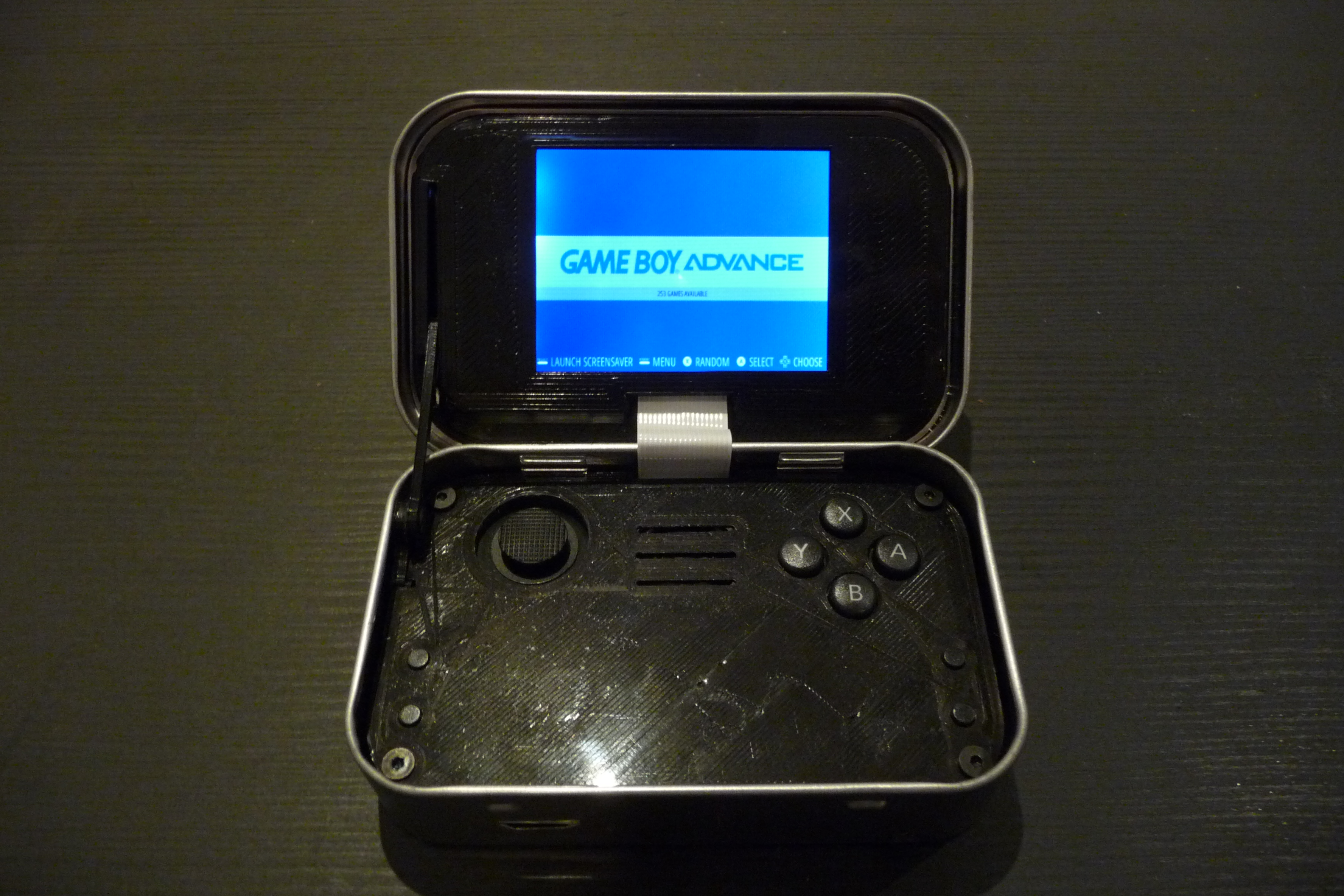

2017/12/08 Joystick is working. I've used the joy bonnet scripts from Adafruit with some minor changes. The problem now is the battery monitor. I've checked and it is possible to read the value correctly from channel 2 since 0 and 1 are being used by the joystick. When I try to change the battery monitor script to use channel 2 everything goes wrong, it seems that when both scripts are running at the same time they interfere with each other. Also I need to find out how to use the combo script with the joystick since I'm using I2C instead of the buttons.

Maybe swap the joysticks to Channels 1 and 2 and then the battery monitor to Channel 0.

I'll try that thanks, but to me it sounds that when both scripts access to the I2c it scrambles the all thing giving wrong values. Probably the best option is to include everything in a single script. When I use a simple script to read all channels everything seems ok.

The built is complete. Joystick, stereo jack and usb port working fine. Still need to do some minor adjustments in terms of battery monitor script so that it does not interfere with the joystick.
