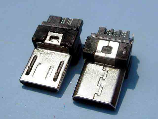

Could it be that the hub pulls the raspberry in otg mode and the 2 port switch doesn't?
Otg mode is enabled when the id pin is pulled to ground, this can be the cause of some devices working an others not.
Best is to find a micro usb connector with 5 pins out and simply connect the id pin to groun, this could be a solution.
Something like this one:
