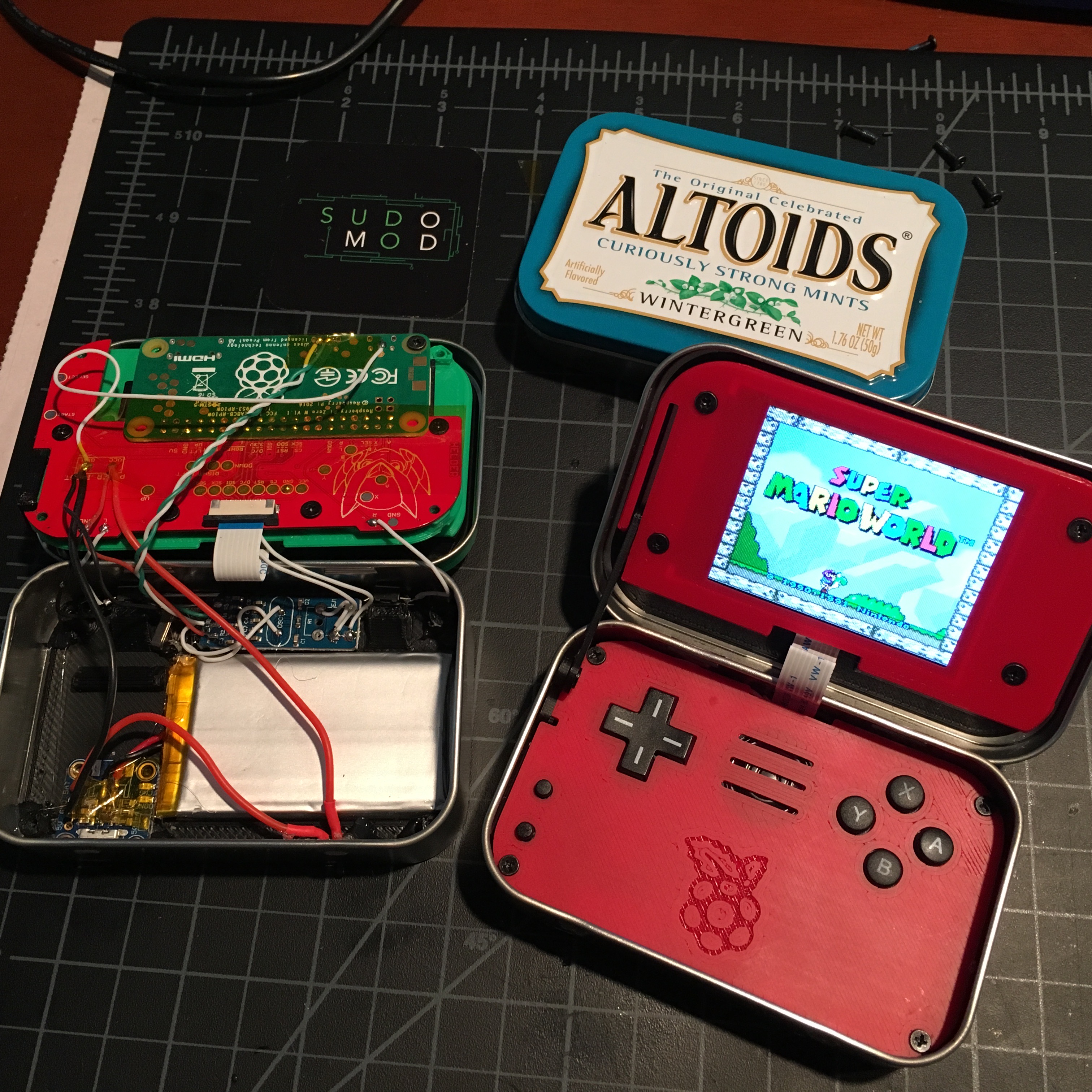

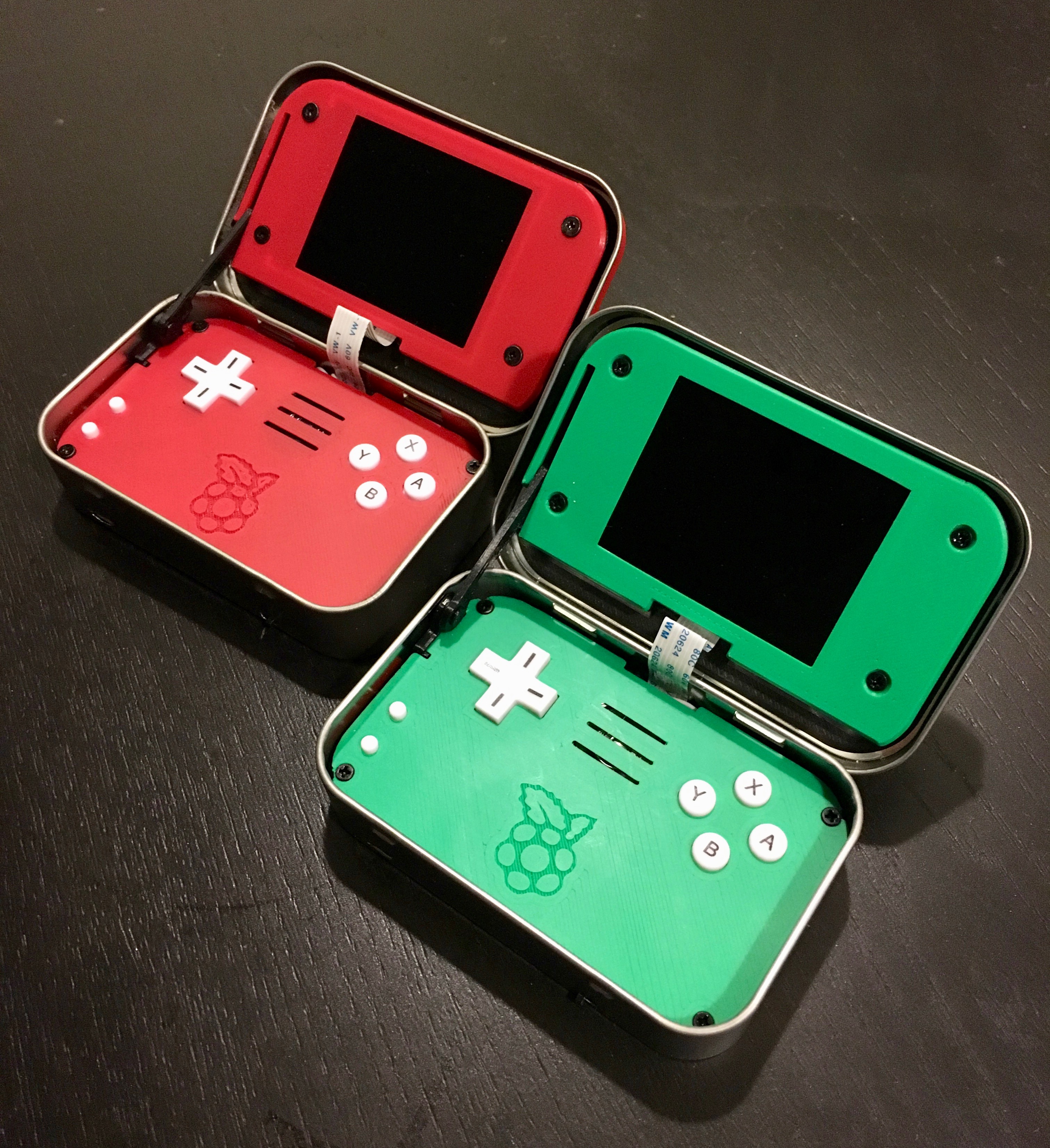

Wanted to show off my two mintyPi builds - Peppermint and Spearmint. I had a few challenges along the way but in the end they turned out great and I think I love them more than my GBZ!

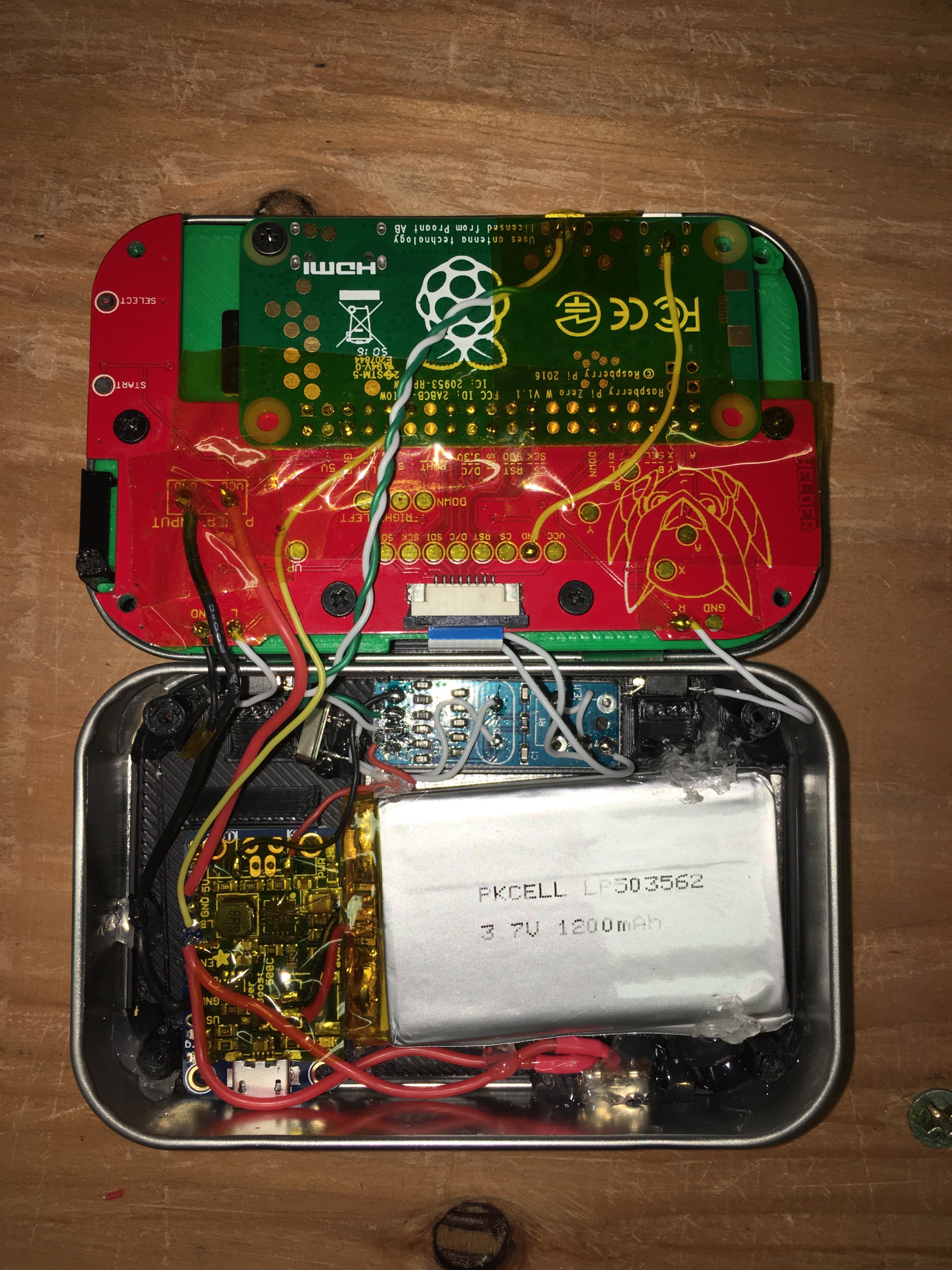

Here's a pic of the insides with the 500c in place (yes, I had to jumper one of the pins on the Pi as I couldn't get a reliable connection for ground :oops:):

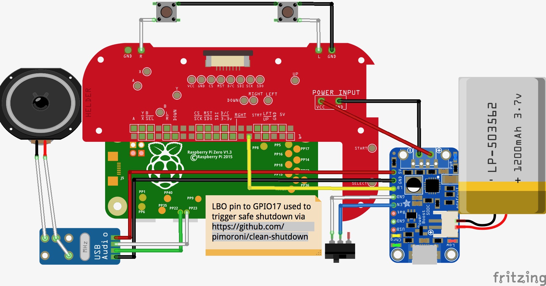

This is the wiring I used to connect everything up:

Re: djbriane's mintyPi's with 500c and Safe Shutdown
Post by Camble » Sat Sep 02, 2017 4:45 am
