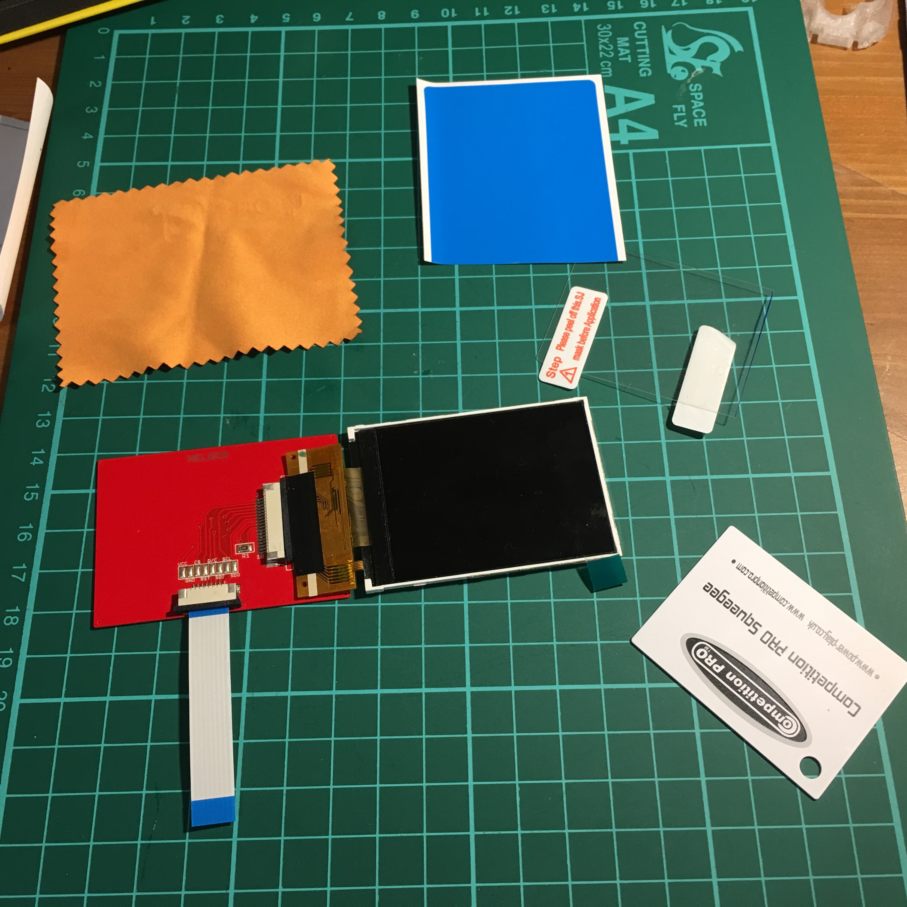

So I've got a compulsive desire to whack a screen protector on just about every piece of handheld tech I own. Whilst this project already offers some protection via its clamshell design, I tried looking around to see if any ready made protectors existed for the 2.4inch screen from Helder's PCB/screen combo.... and I couldn't find any.
The solution I resorted to was fashioning a spare plastic screen protecter down to size.
The exposed front pane of the screen component itself measures 40mm x 52mm, but when measuring the protector I'd recommend erring 1mm smaller for the above measurements so there's less chance of overhanging film. I used a pair of scissors to cut the protector, but perhaps a decent guillotine may also do the trick!
(Sadly I didn't take photos of the various stages of creation)

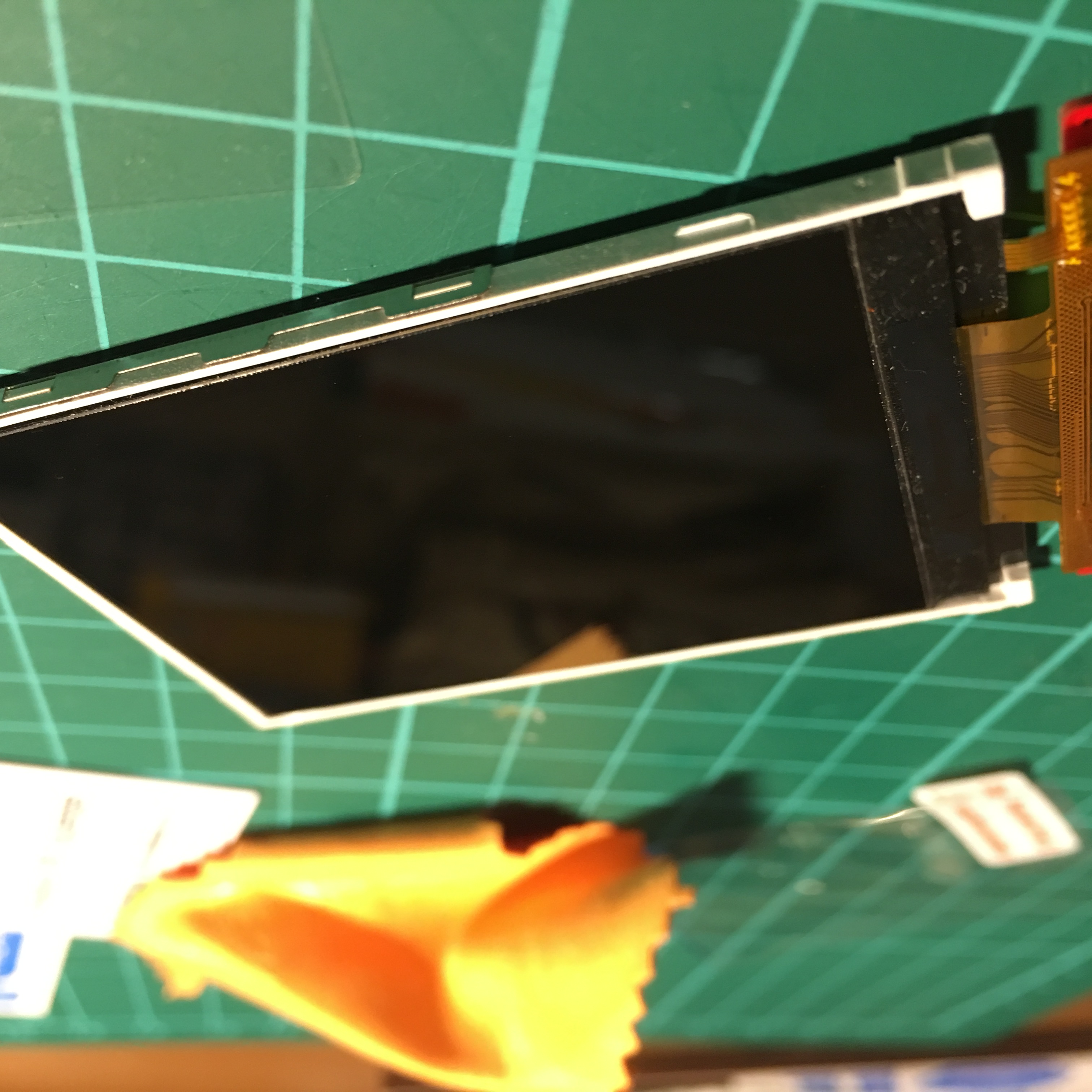

Before application. Clean, clean, then clean again.
After application (and basically after bullying away any air bubbles... try not to put as much unnecesary pressure on the screen via squeegee as I did). Happy with the lack of dust on the business end of the screen - ignore the adhesive portion on the left :-S

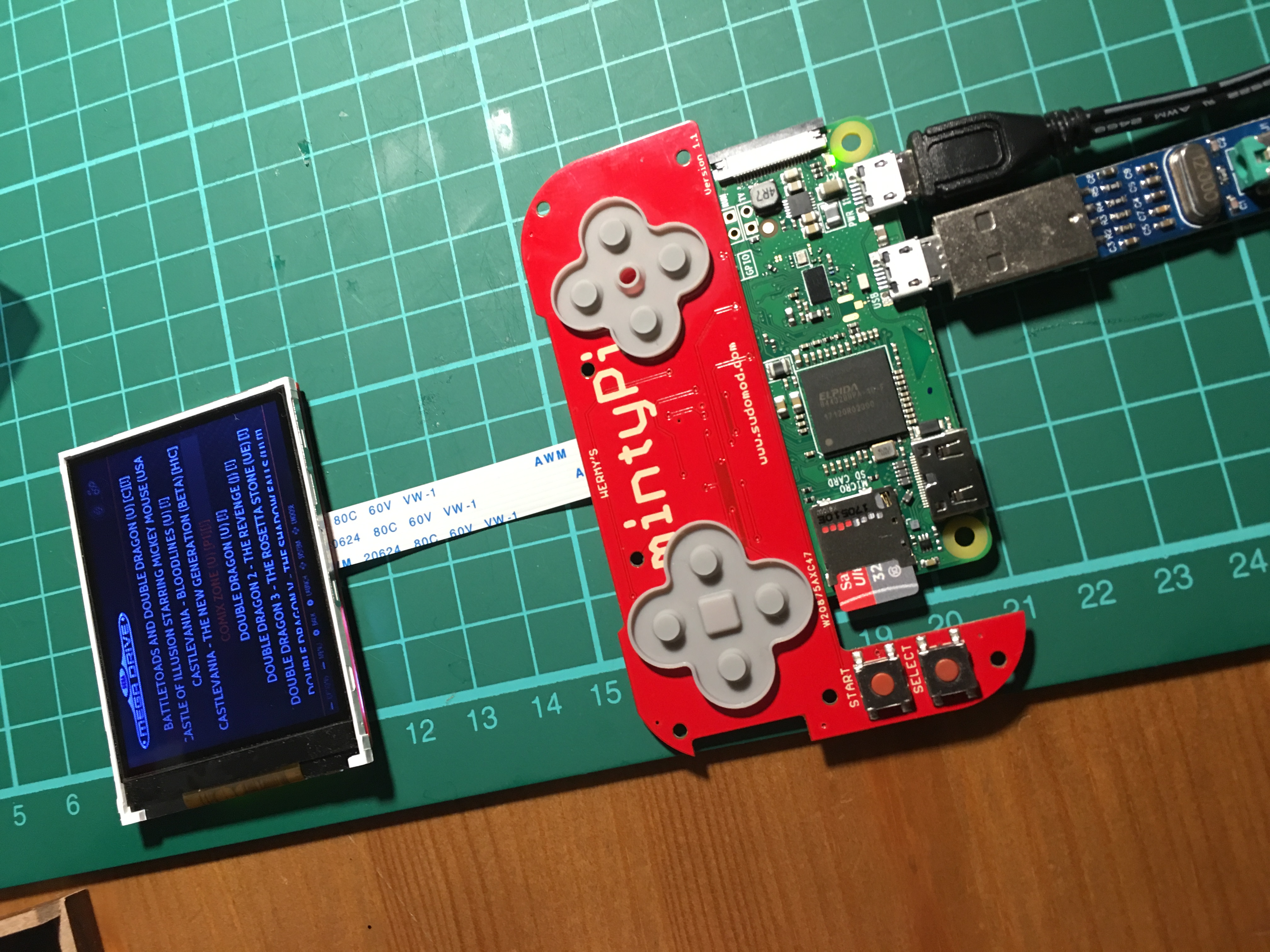

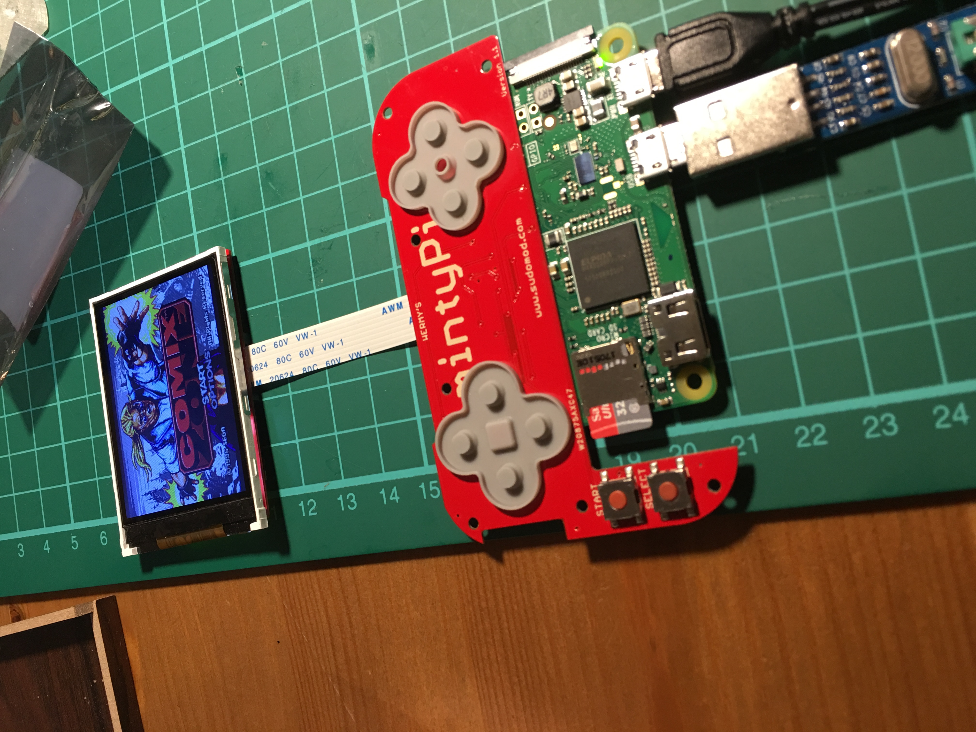

Testing the screen to make sure I didn't bust it
Success!

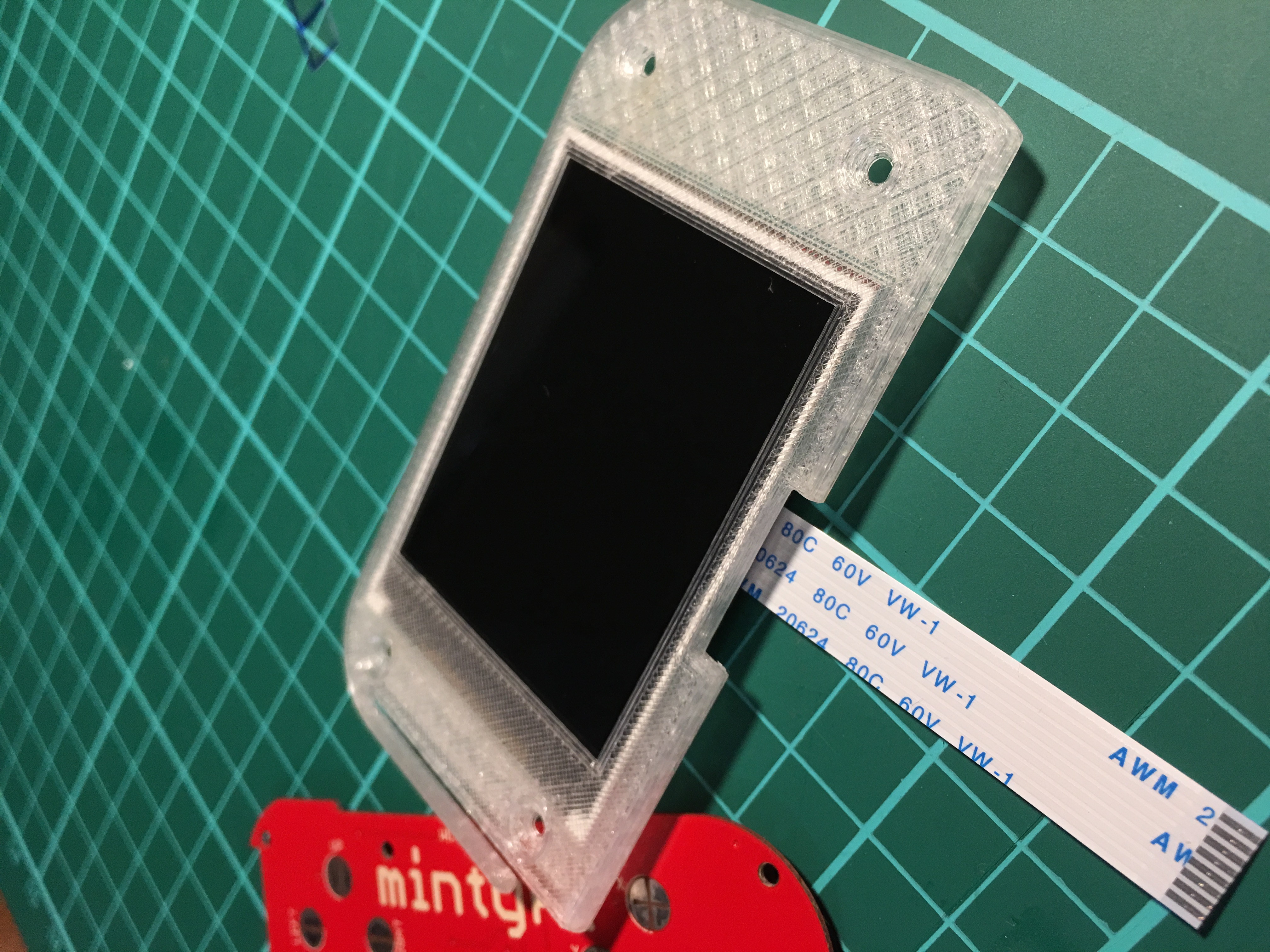

Now the bezel will actually cover a few mm all around the edge, so the protector doesn't necessarily need to cover every last square mm of the screen, hence its best to err on the smaller size when cutting your protector to size.
Alternatively, you could just measure the bezel and place an appropriately sized protector on after initial assembly.
