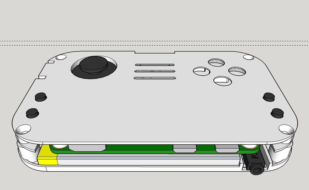

I wanted to do something different with my design so I went back to the 3D prints and made several changes.
Now that I have most of the pieces I need to build it I decided to do a log. Hope you enjoy it.

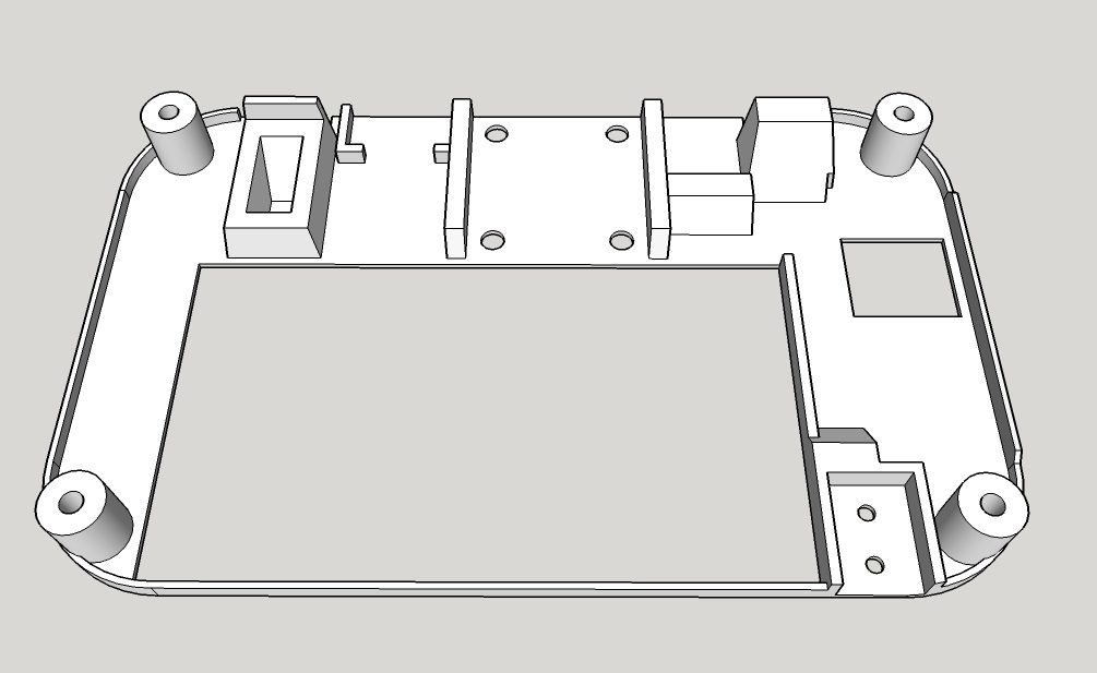

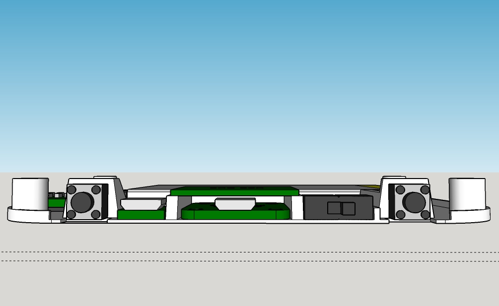

2017/11/16 - I'm still not sure if this new design will work but I'll start by showing the base 3D print.
The jack is a 2.5 switch jack PJ242, small enough not to take a lot of space but for regular headsets it will require an adaptor.
PJ242 https://www.ebay.com/itm/10Pcs-2-5mm-Fe ... 2749.l2649
2.5 to 3.5 jack adaptor https://www.ebay.com/itm/1Pc-Male-2-5mm ... 2749.l2649
On the right side is the usual usb sound card, since the base includes a hole for the chip it should be possible to mount it without taking out the crystal. To be checked later.

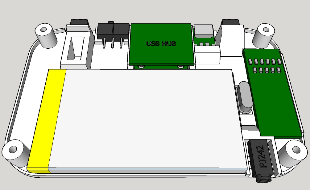

The battery is also the usual due to the dimensions. On the picture you can also see both tactical switches and power switch.
Now viewing from the back, on the left you will have an usb port, in the middle the Adafruit's microLipo, and on the top of the microLipo the usb hub.
Usb port https://www.ebay.com/itm/10pcs-MICRO-B- ... 2749.l2649
Usb hub https://www.ebay.com/itm/Micro-B-2-Port ... 2749.l2649
Missing on the picture is the ADS 1015, for the joystick and battery monitor, that I still have to figure where it will fit. Probably on the left empty space. If the pcb does not fit I will have to use only the chip (TI can provide it).
ADS 1015 https://www.ebay.com/itm/ADS1015-12-bit ... 2749.l2649

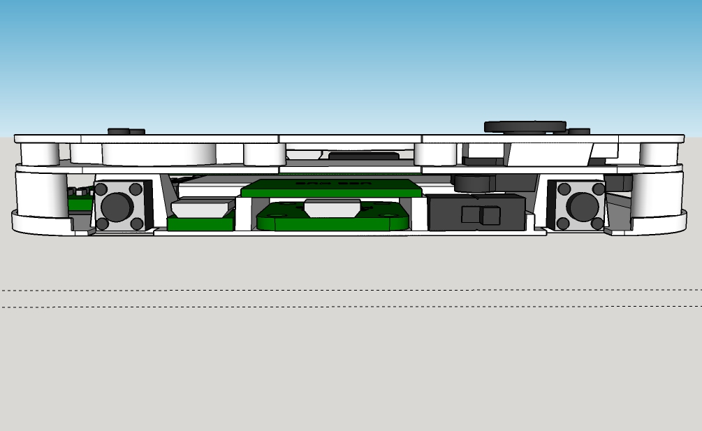

- Base with components back view
- project_C01_base_components_back.jpg (132.03 KiB) Viewed 12901 times
- Base with components top view
- project_C01_base_components_top.jpg (157.46 KiB) Viewed 12901 times

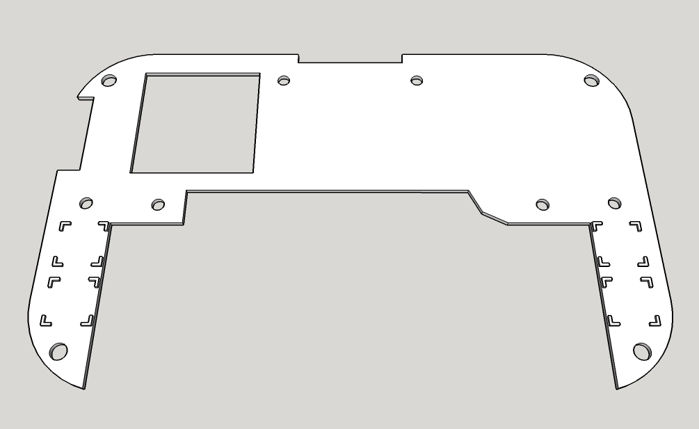

2017/11/16 Since my idea is to use a joystick I could not use Helder PCB. Also I needed the joystick to lower a lot so that he could fit with the screen and all. This is the reason for the square hole on the top left.
On the left you also have the tactical switches for start and select. On the right, for symmetry purposes you also have 2 tactical switches. At least one of those will be used as function button.

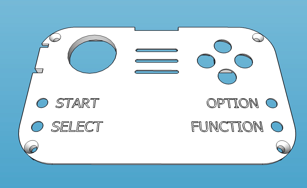

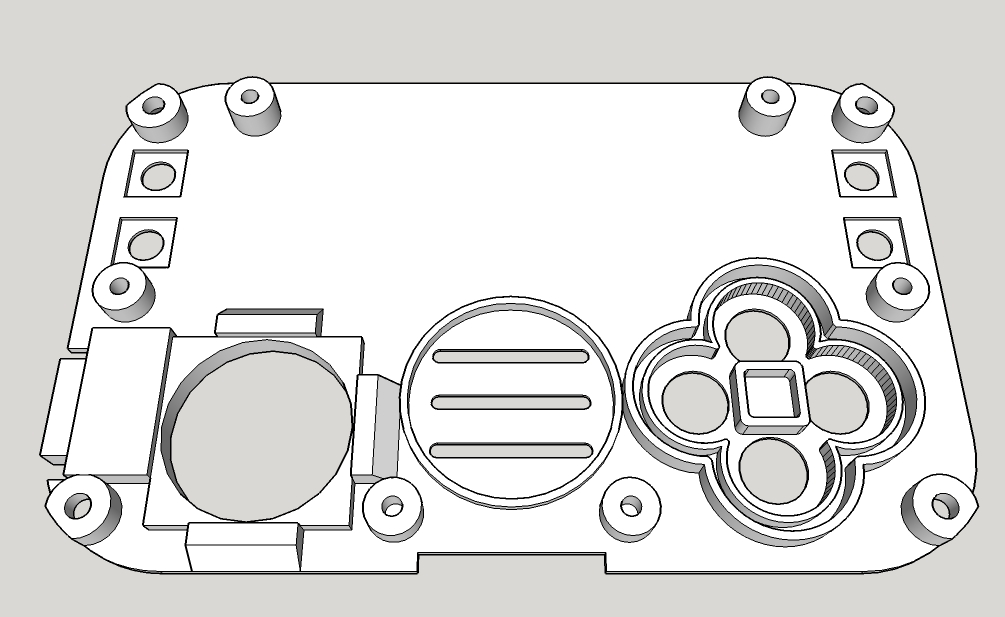

2017/11/16 For the face I added the 2 extra holes for the tactical switches on the right and I included the hole with supports around for the joystick on the top left.
I've tried to print the button name but with no success due to the precision of the printer. I will try again later.

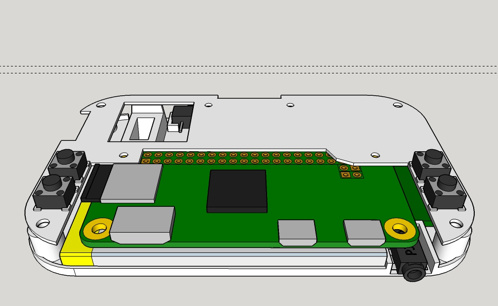

- Bottom part with components top view
- project_C01_face_top_components.jpg (126.26 KiB) Viewed 12896 times
- Bottom part with components back view
- project_C01_face_back_components.jpg (142.4 KiB) Viewed 12896 times

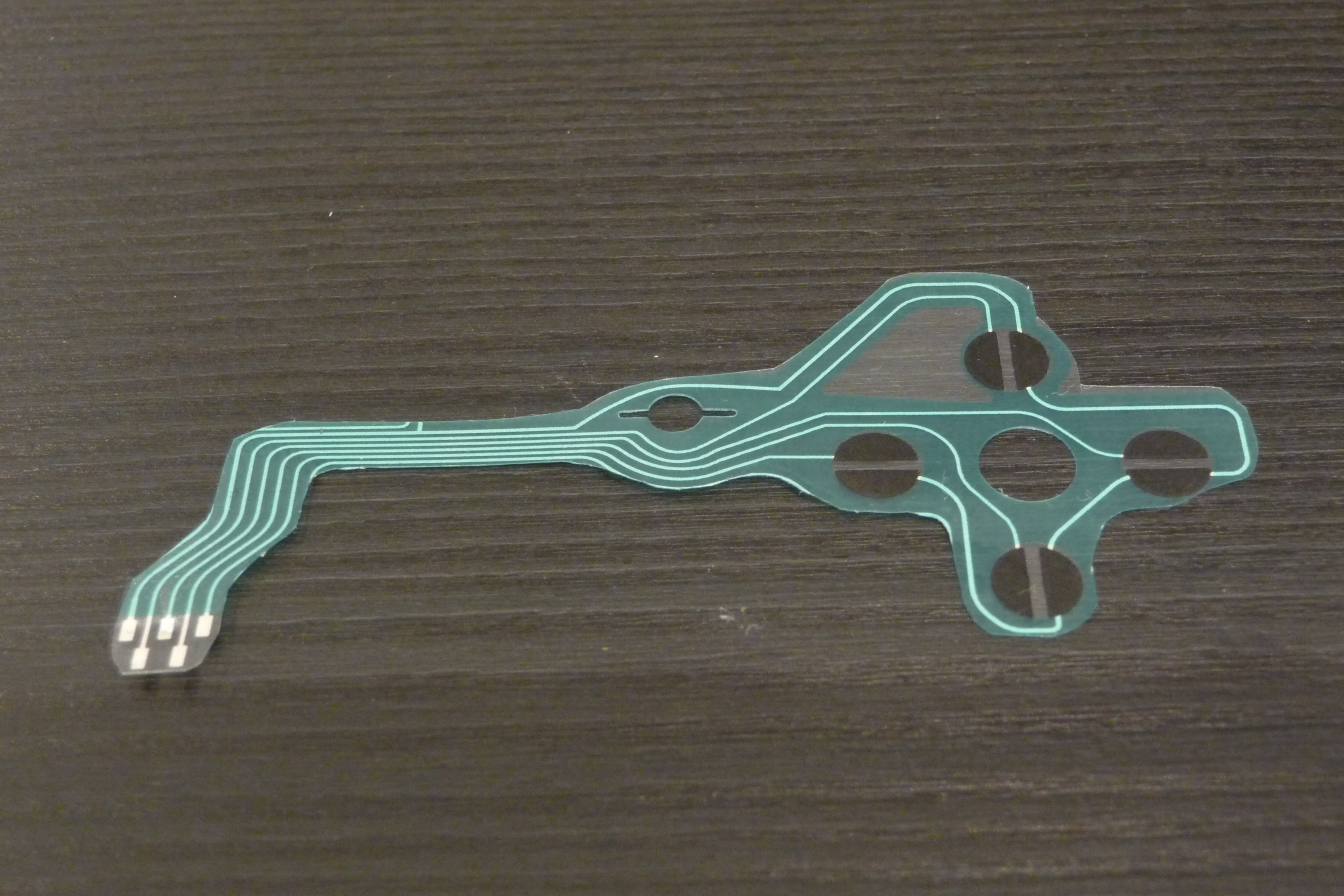

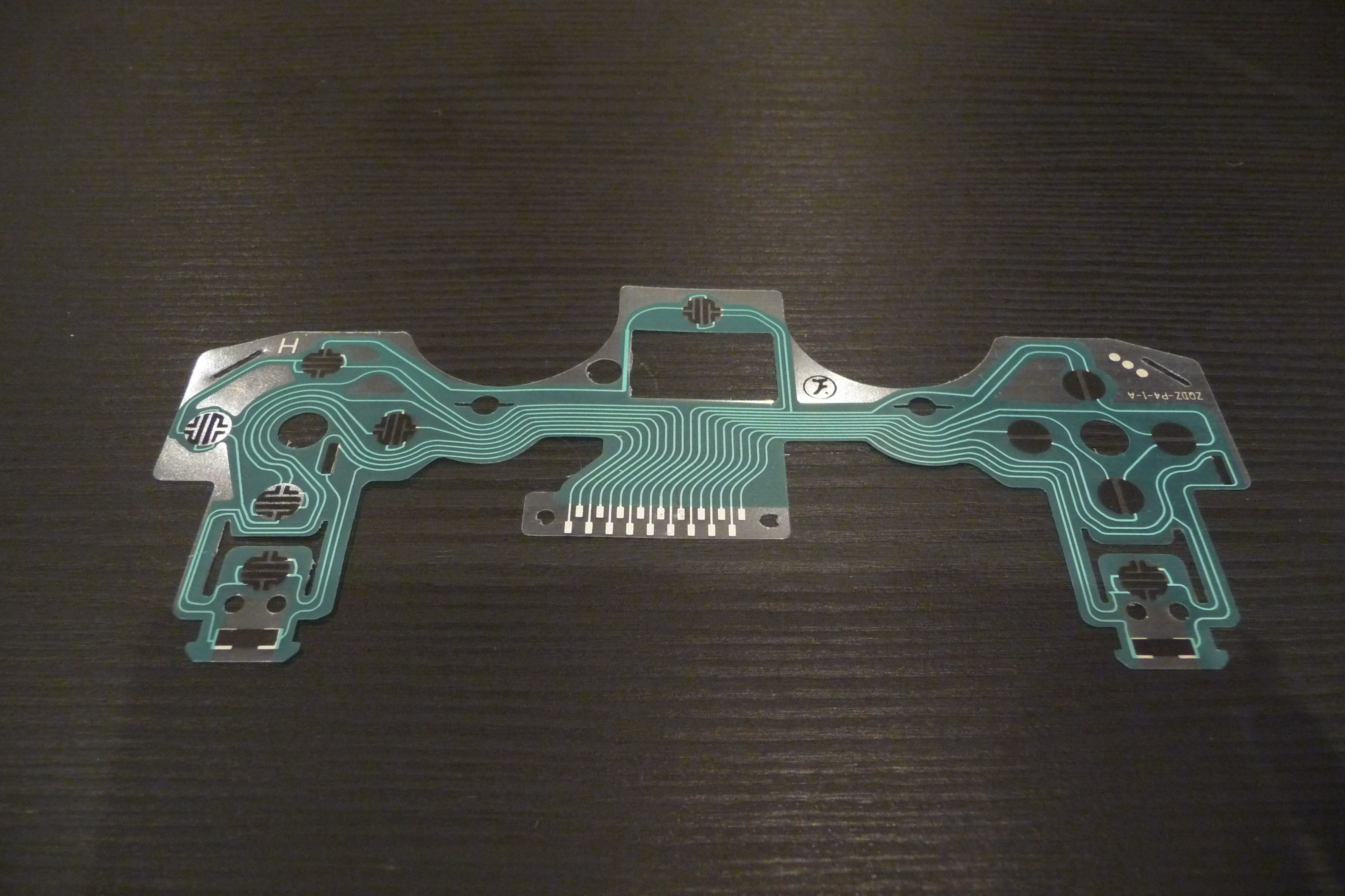

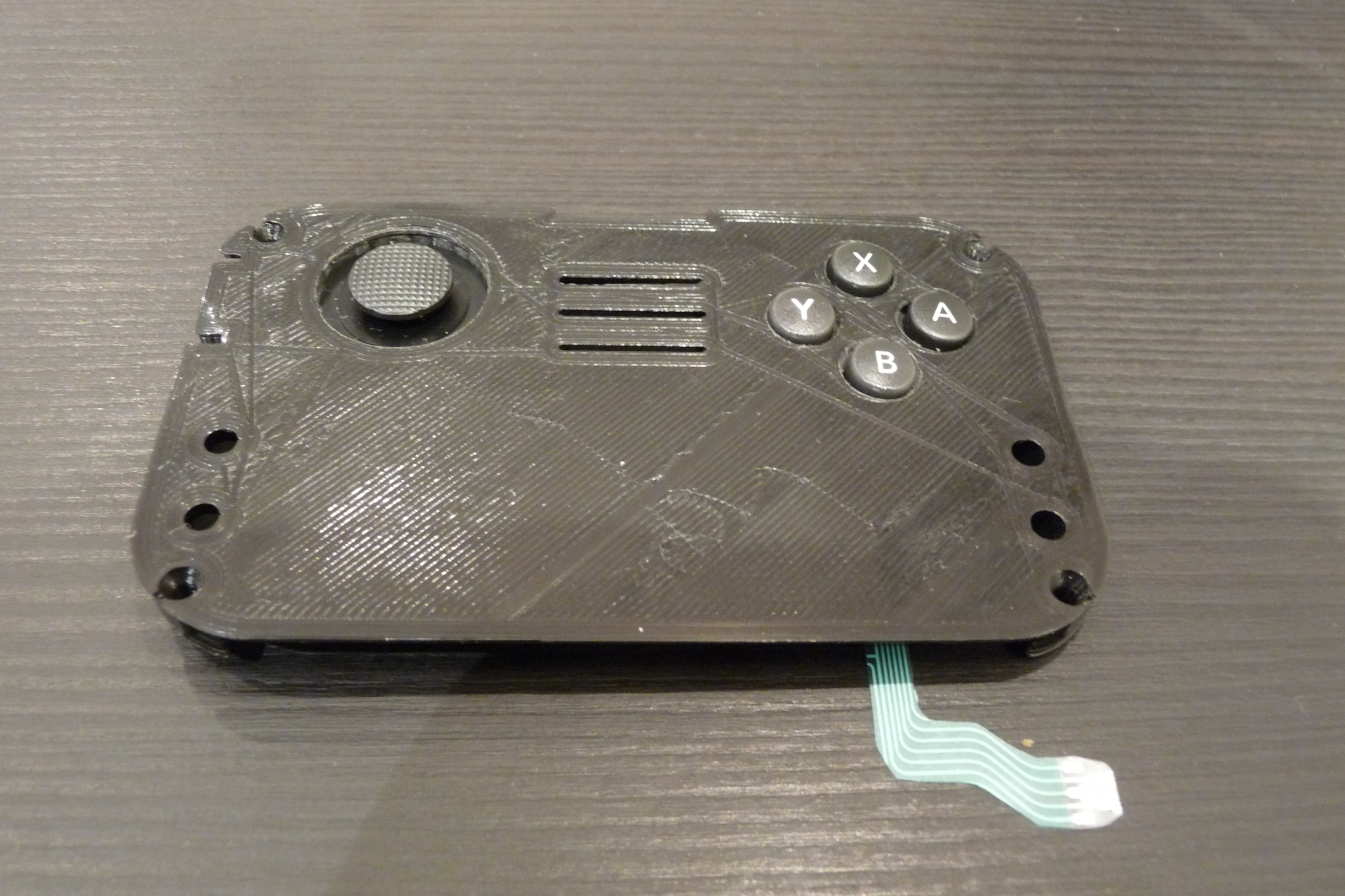

2017/11/18 VeteranGamer sadly I did not find those during my search so my option was to use this conductive film keypad for PS4 controller, cut it and used VHB tape to put it in place. Not the exact size for the buttons but I already tested the buttons and they are working.
Conductive film keypad https://www.ebay.com/itm/Conductive-Fil ... SwJ~RZr74b
