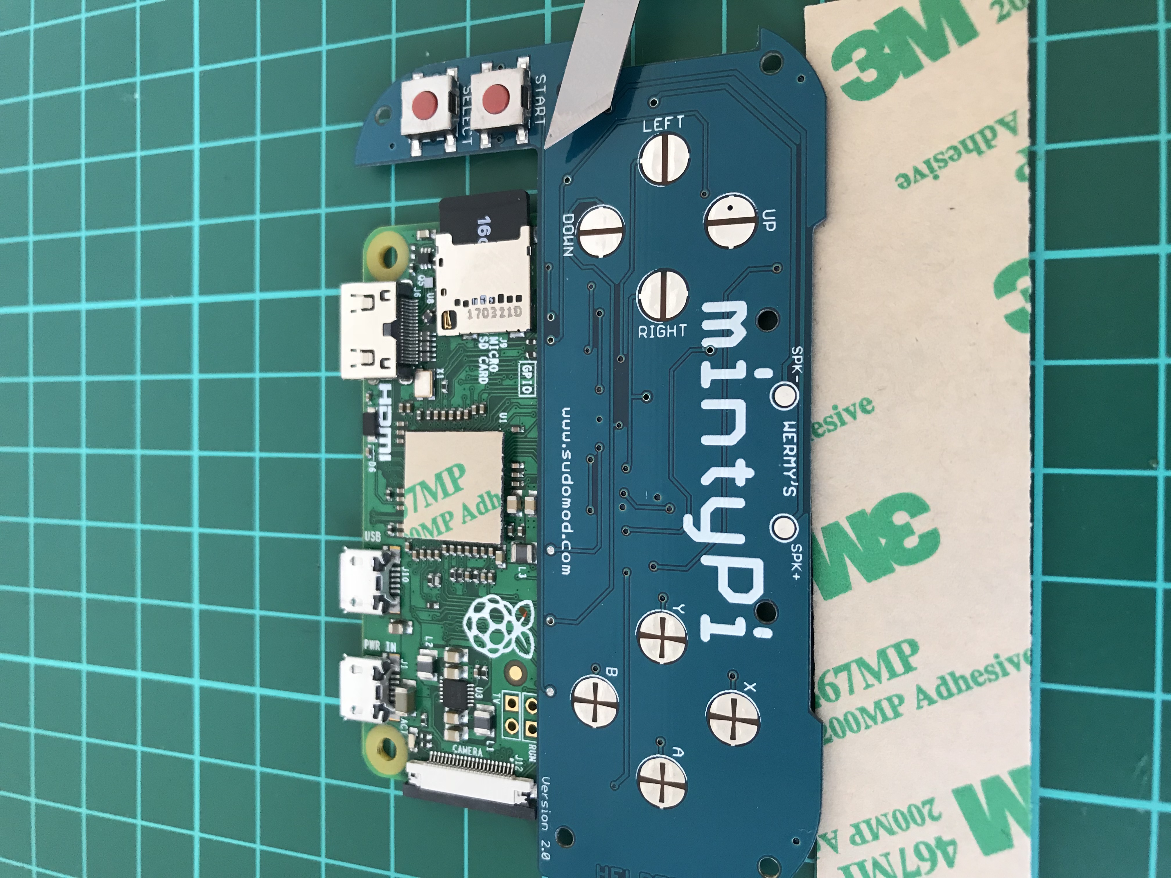

Nothing new here except that i have put a small copper heatsink to allow cooling, it's obviously not an extra efficient addition but it will help a bit.
The most difficult part was the tin drilling... The 3D guide helps a lot and i have only used a Dremel and worked very slowly to take small amounts at a time.
I am using 3M adhesive thermal pad which seems to be very efficient (bought on amazon and with very good feedback)
https://www.amazon.fr/gp/product/B00BMM ... UTF8&psc=1
I have used a small 15x15mm*0.1 pure copper plate bought on ali
https://www.aliexpress.com/item/10PCS-0 ... 23737.html
The result is perfectly aligned with the highest parts of the pi so closing the tin won't be a problem.
You can see with the face plate screwed down that i still have a slight space for ventilation, that's a good point.

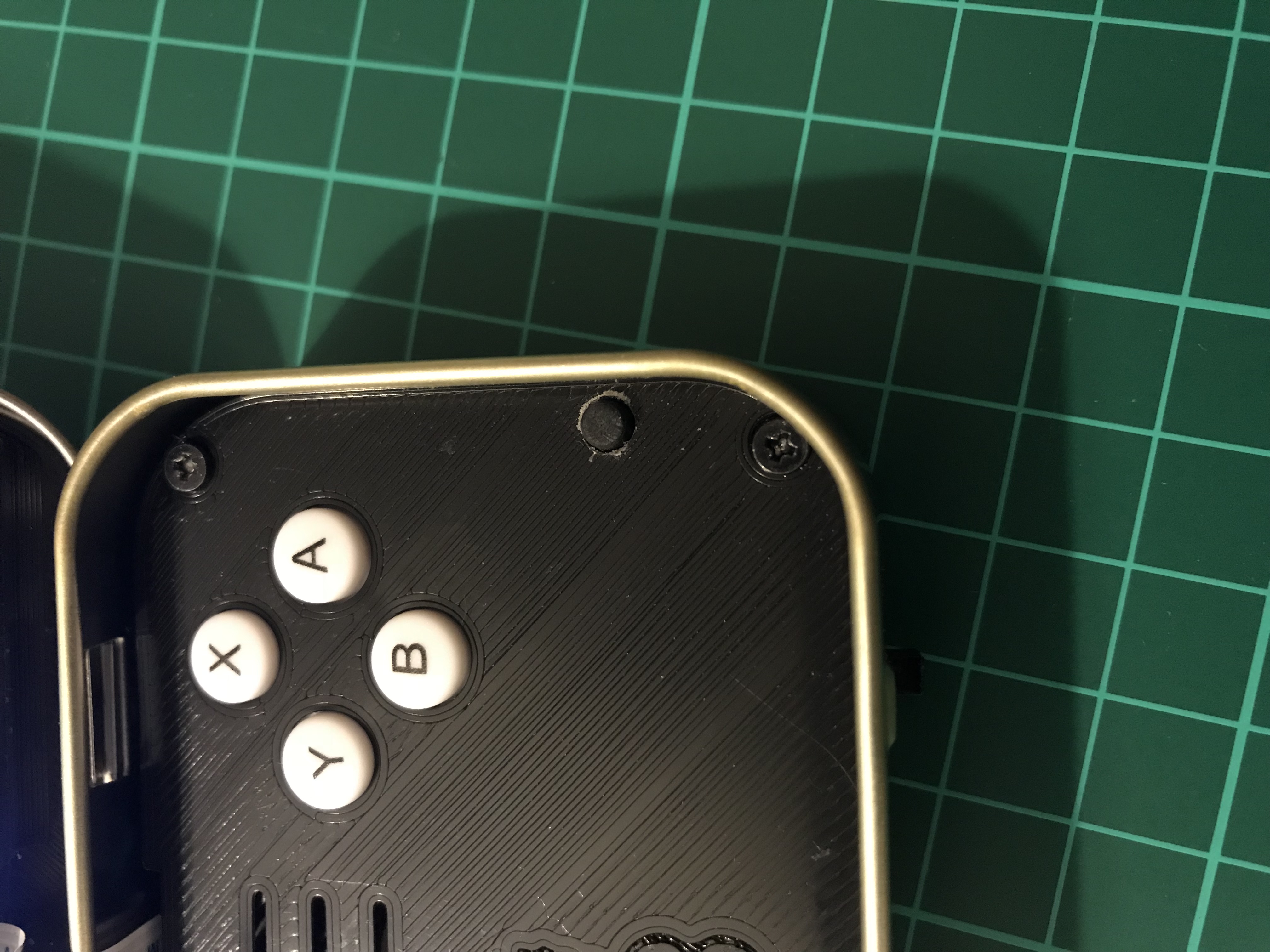

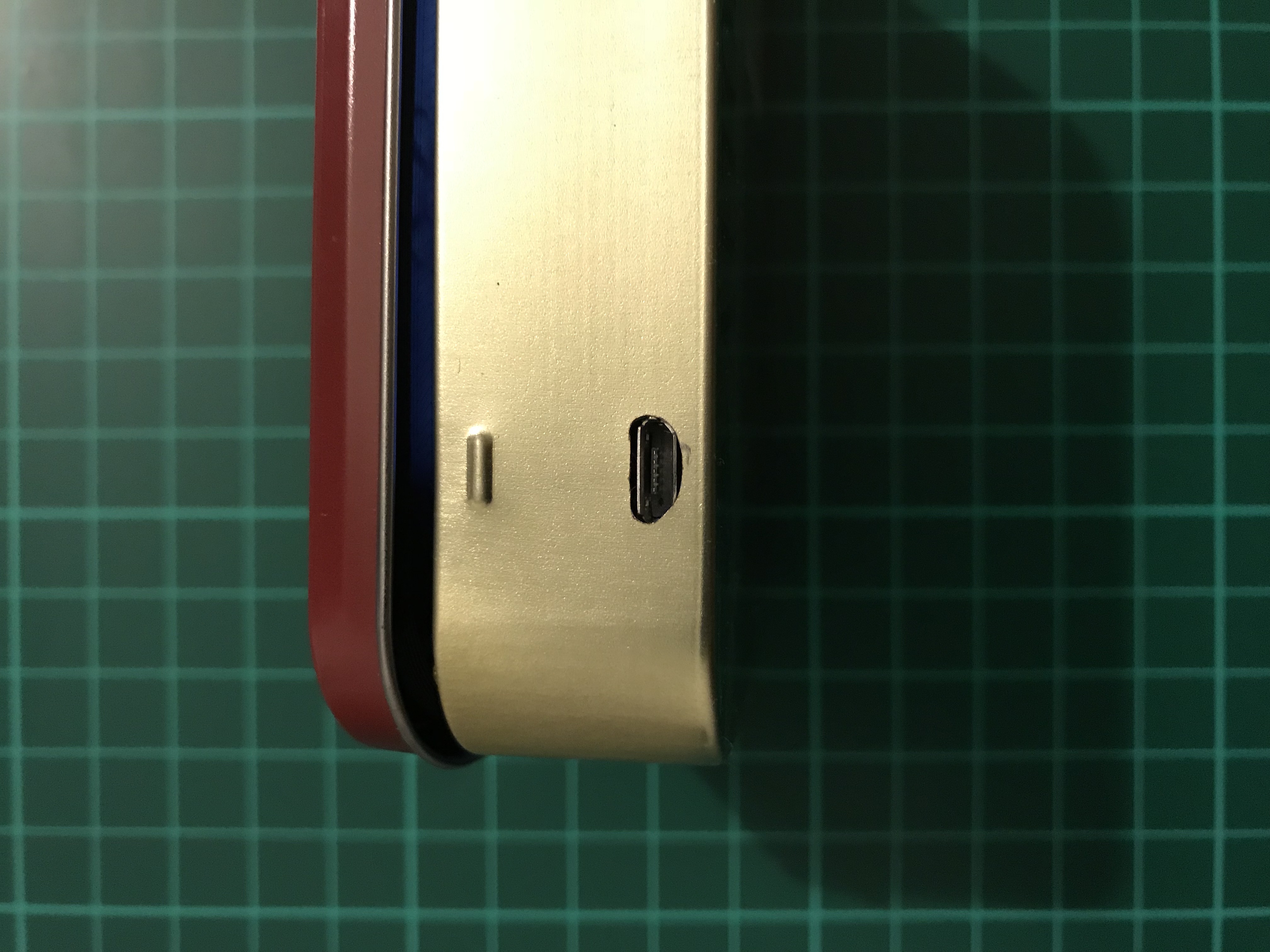

The holes
They are not very perfect and i am a bit disappointed despite of all the time i have token to drill them.
I have markup leftovers around the switch that i cannot remove, i will try some pure alcohol to try to remove them.

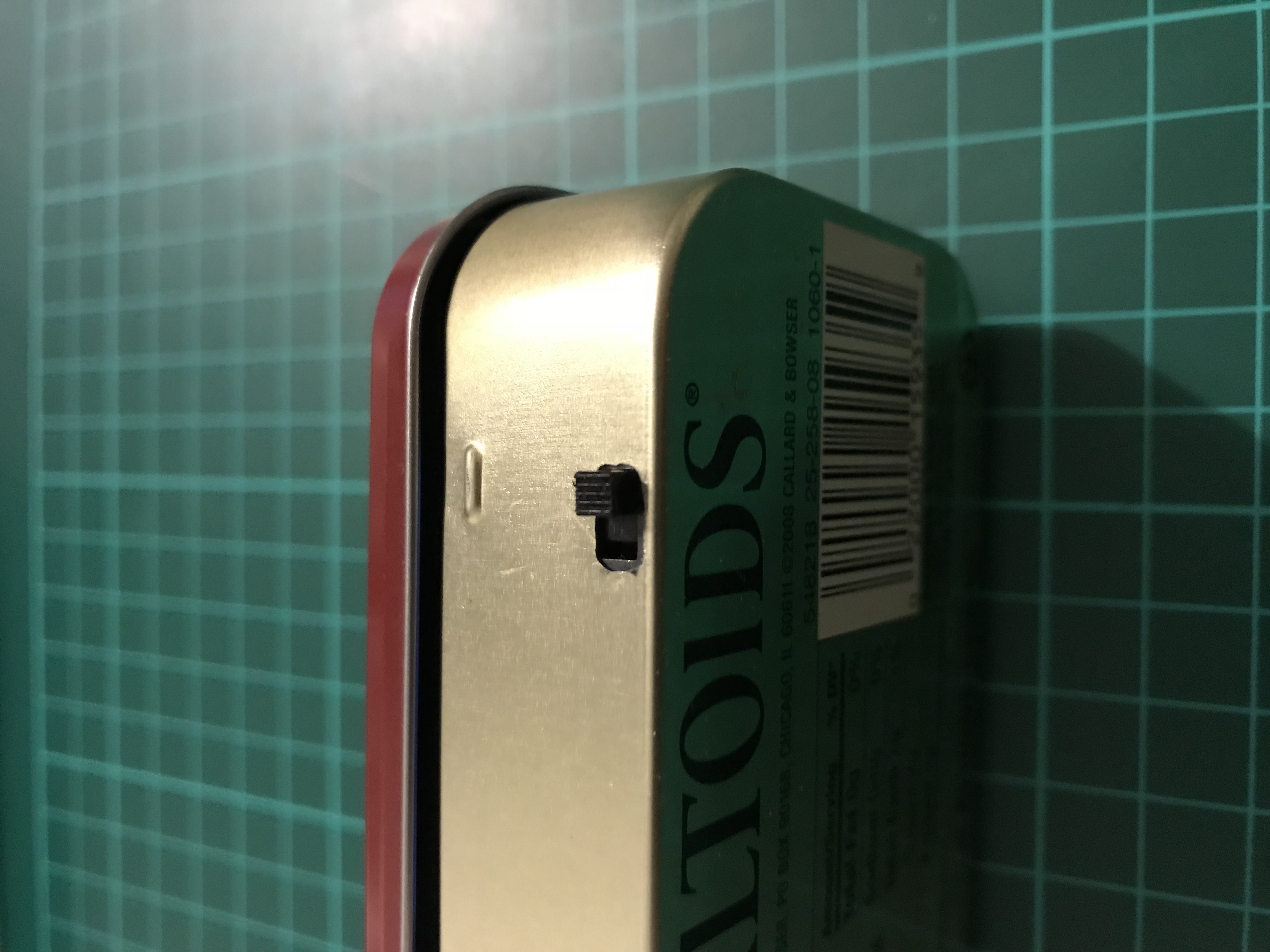

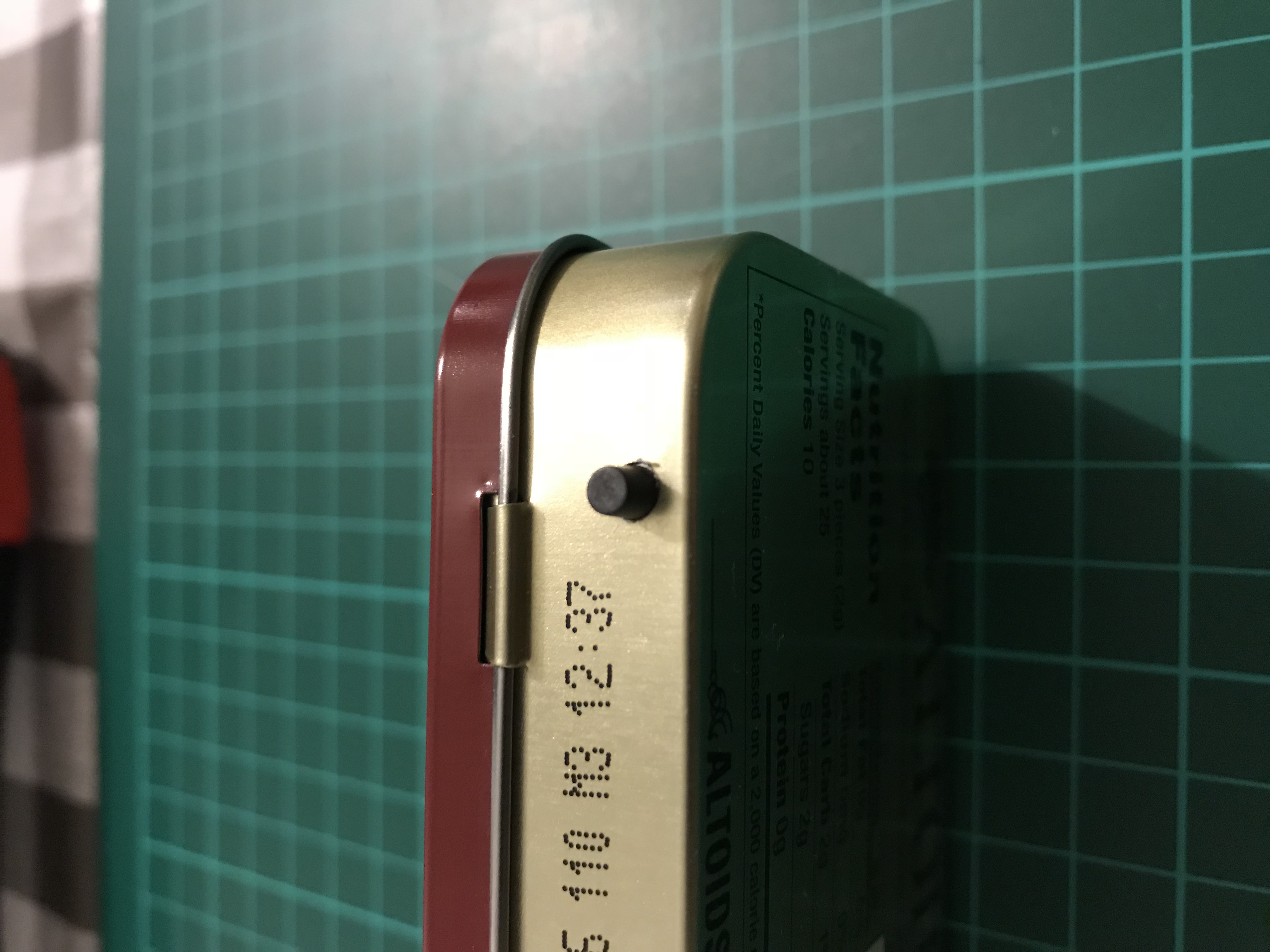

The mode button.
Made from a standard 6x6x9mm tactile switch leftover from my GBZ. I have cut the up of the switch to make it as flush as possible with the front plate but still usable.

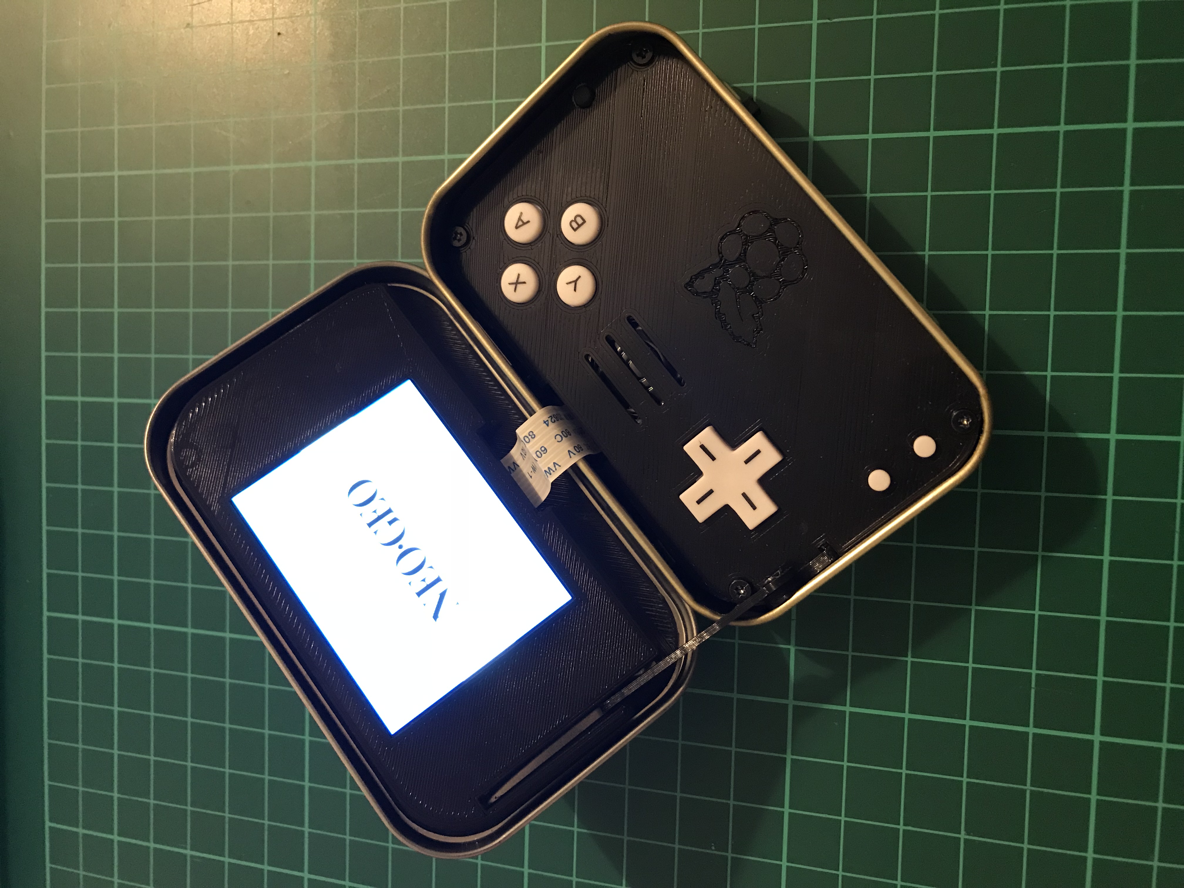

The finish product.
