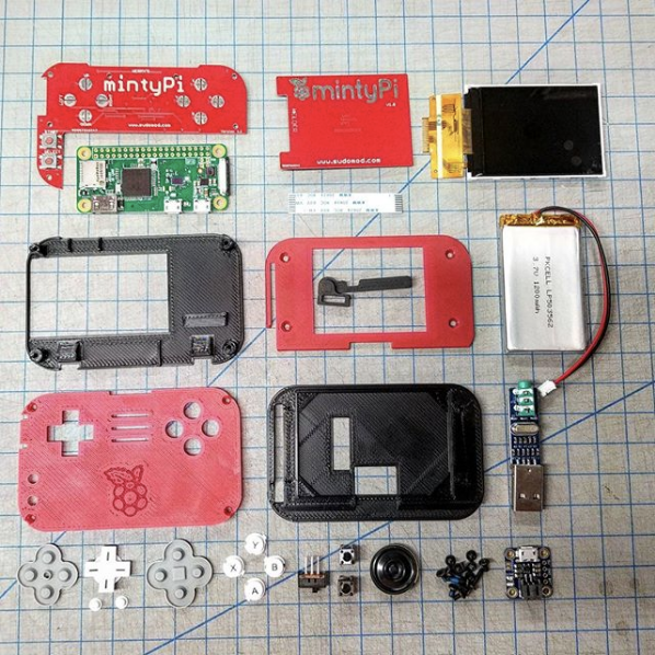

August 11th, 2017.
The parts are all here!

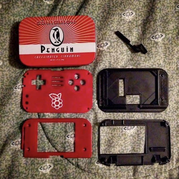

August 14th, 2017
The red and white Penguins Mint tin arrives. After bingeing on the mints I lay the tin down with the 3D printed parts. Yeah this is what I want... (Let's not fool ourselves... eating the mints is a serious perk in this project.)

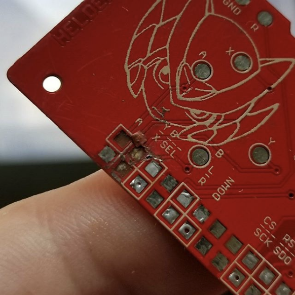

August 18th, 2017 Disaster strikes!
A friend and I watch the tutorial videos and got to work. After soldering the Pi onto the PCB, I notice something is wrong. We soldered the Pi on backwards! When we attempted to remove the pi from the board, a couple of the pads decided to stay on the pi and ruin the PCB. We quickly checked to see if there was more... but the V1 boards were all gone. When I posted this picture on instagram, Helder (or was it Wermy? I don't remember, its been a while) reached out to me and mentioned that he had a space screen. I missed his reply for over a week and by then, they were gone. :( It was time to take a break and wait for the V2 boards that Helder mentioned to come out!

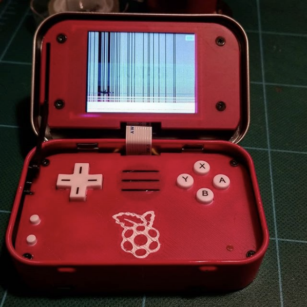

A couple of weeks before this, my friend and I took another crack at the Mintypi. We had the V2 boards since February, but life had conspired to delay our second attempt. We sat down watched the tutorials again and started. Our first attempt had us solder on the pi crooked... paying attention to the tutorial video would have been really useful here... we didin't use the 3D printed face-plate as an assembly jig. "Measure twice. Cut Once." should translate to "Watch tutorial twice. Solder once."
Even with this set back we were able separate the pi from the board and take another crack at it. The second time around... or would this be the third?... we got it right. So I got it home, put the mintypi image on the SD card, loaded the ROMs and started doing the final assembly when disaster struck again. While screwing down the face-place for the screen, I held the screen in place with my thumb. I repositioned the pad of my thumb for a better grip and in doing so, the pad of my thumb switch over to my thumb nail... I heard the tiniest of cracks. When I turned it on, I was greeted with this. SO CLOSE! Seriously, I was seconds away from being done! Of course the screen PCBs were sold out on sudomod. Discouraged I took a short break and then reached out to the forums for a solution. In the mean time...
5 May 8 2018.png (702.34 KiB) Viewed 10887 times

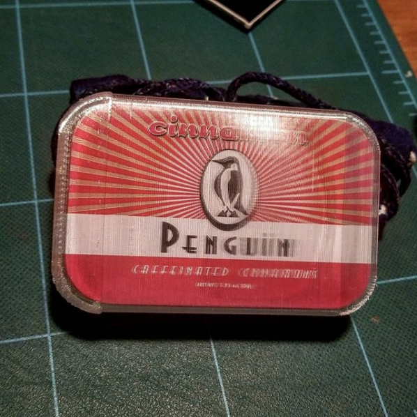

May 9th, 2018
Wermy's protective sleeve arrived in the mail. I had ordered this a few days before breaking the screen to celebrate the completion of my Mintypi. It was bittersweet to have it arrive the day after breaking it, but is sure did look cool protecting the tin!

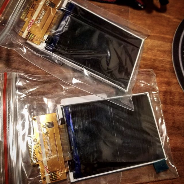

With Helder's help, I figured out which screen I should order to replace the one I broke. They took a little over a week to get here from China. I used the original screen to practice soldering to a test board and I had a spare screen in case I broke the screen again. The first time I tested the new screen I had soldered on the V2 board, I got a white screen. Something wasn't right... It was then that I realized that one of the pads had detached from the board when I took the original screen off. After panicking a little bit, I noticed that the pad didn't have a lead coming off of it... so I went back to my other connections and made sure they were properly soldered down. When I fired up the mintypi a second time... it booted up! (There may or may not have been a celebratory beer or two or three drunk at this point.) Later and after I sobered up a bit, I had to go back and cut a sliver off of the screen face plate so it would show the whole 2.4" screen. The V1 screen face plate was meant for a slightly smaller screen. I also had to cut out some of the plate behind it so the screen could fit in.

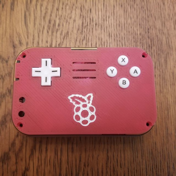

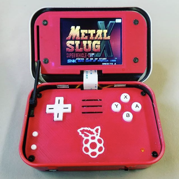

June 6th, 2018 D-Day
I had noticed that the Mintypi was taking forever to charge and after consulting with my friend we realized that we had forgot to put some solder on the little power board. Once I took care of that, the Mintypi charged up pretty quick. All the ROMs I wanted were loaded up and I was finally at a point where I would actually get to play some actual games instead of tinkering with it. Success! I'm pretty happy with my Frankenstein of a Mintypi. The V1 3D printed parts, the V2 boards, and the non-standard screen give it a character that's all its own!
8 June 6 2018.png (762.89 KiB) Viewed 10887 times
