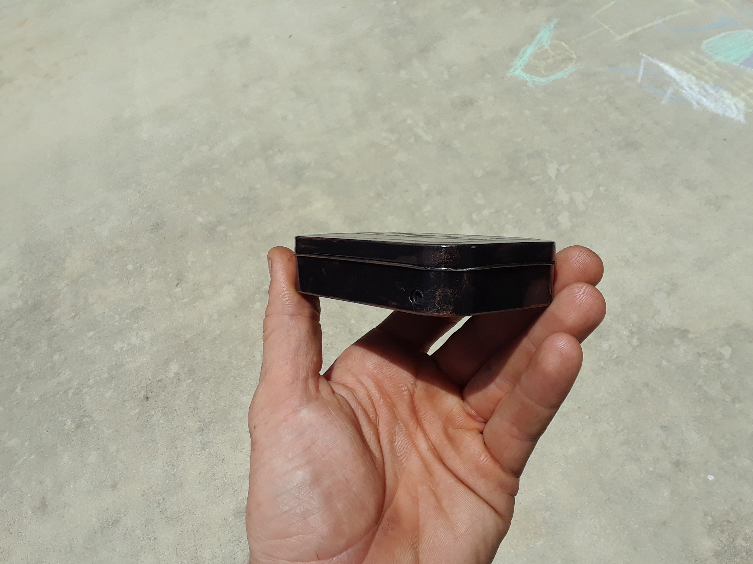

I must say, this build was a little more challenging than I expected. All in all, it was a fun learning experience and a nice little bit of soldering practice.
It's a standard kit, so there's not much here out of the ordinary but i would like to share a few custom elements that make it unique.

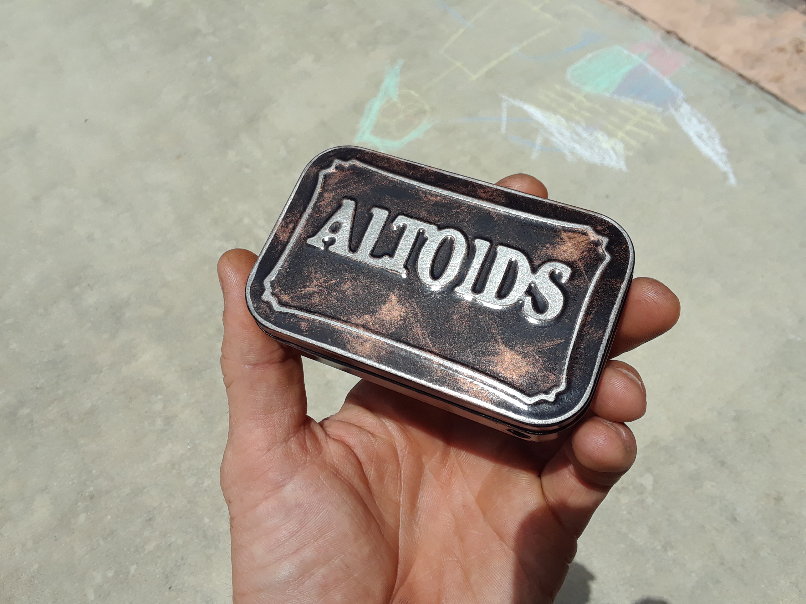

The first and most obvious change is the tin itself. It's a standard Altoids tin with a paint job. The tin was sprayed with a flat black enamel, then dry-brushed with copper paint. I sanded the edges and logo to add a little contrast and the whole thing was sealed up with multiple coats of clear enamel.
painted tinShow
outside
outside
outside

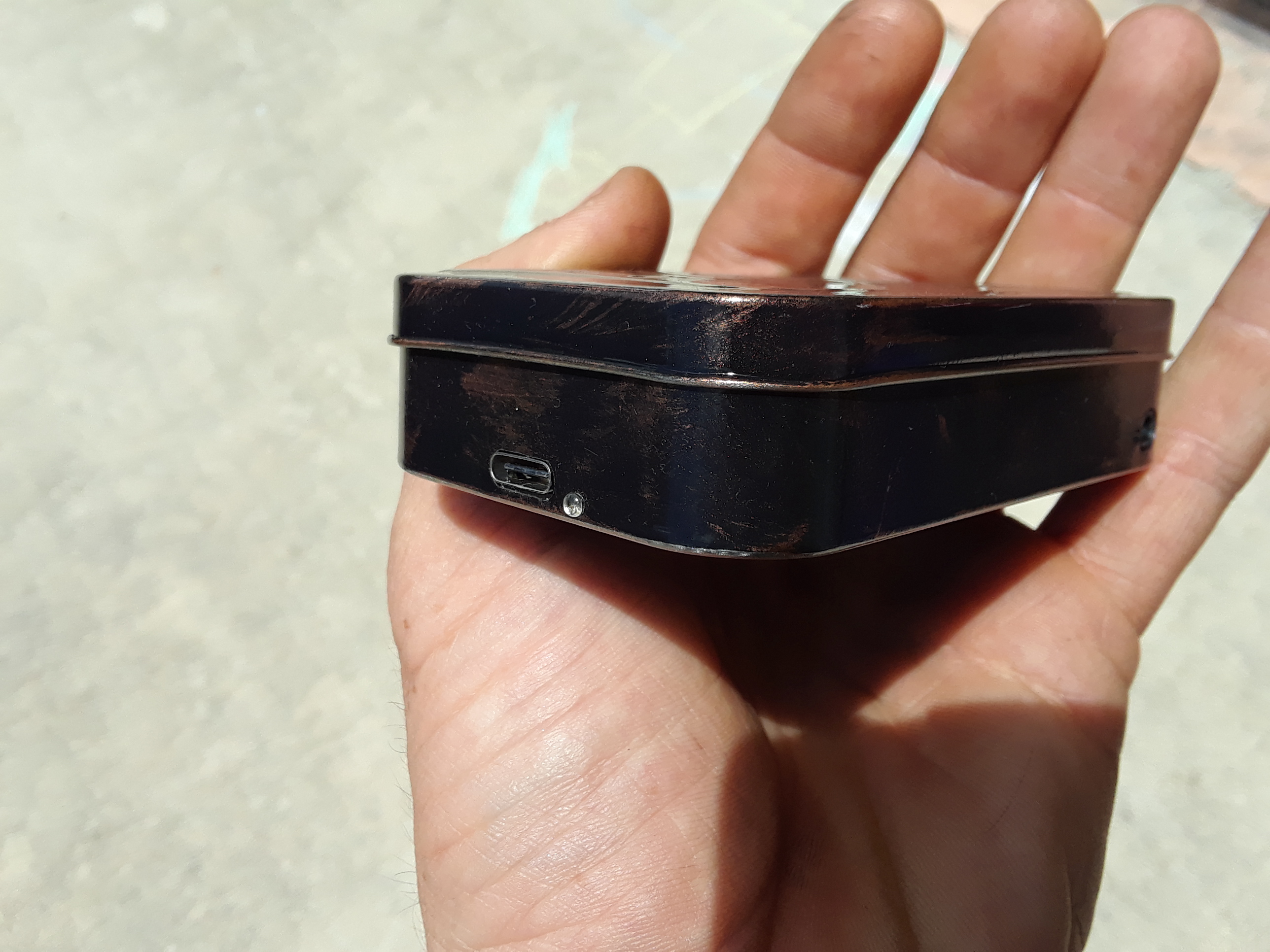

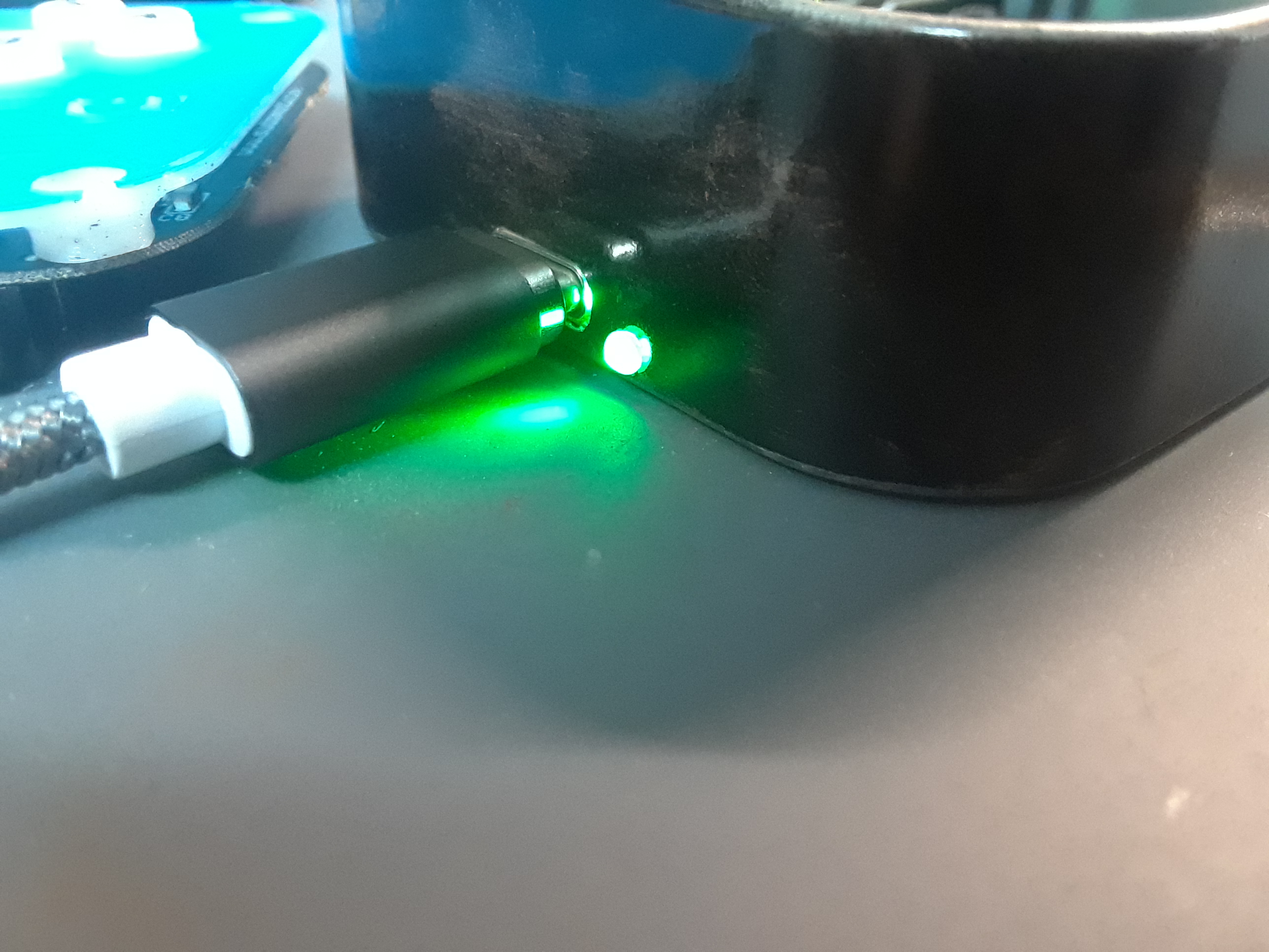

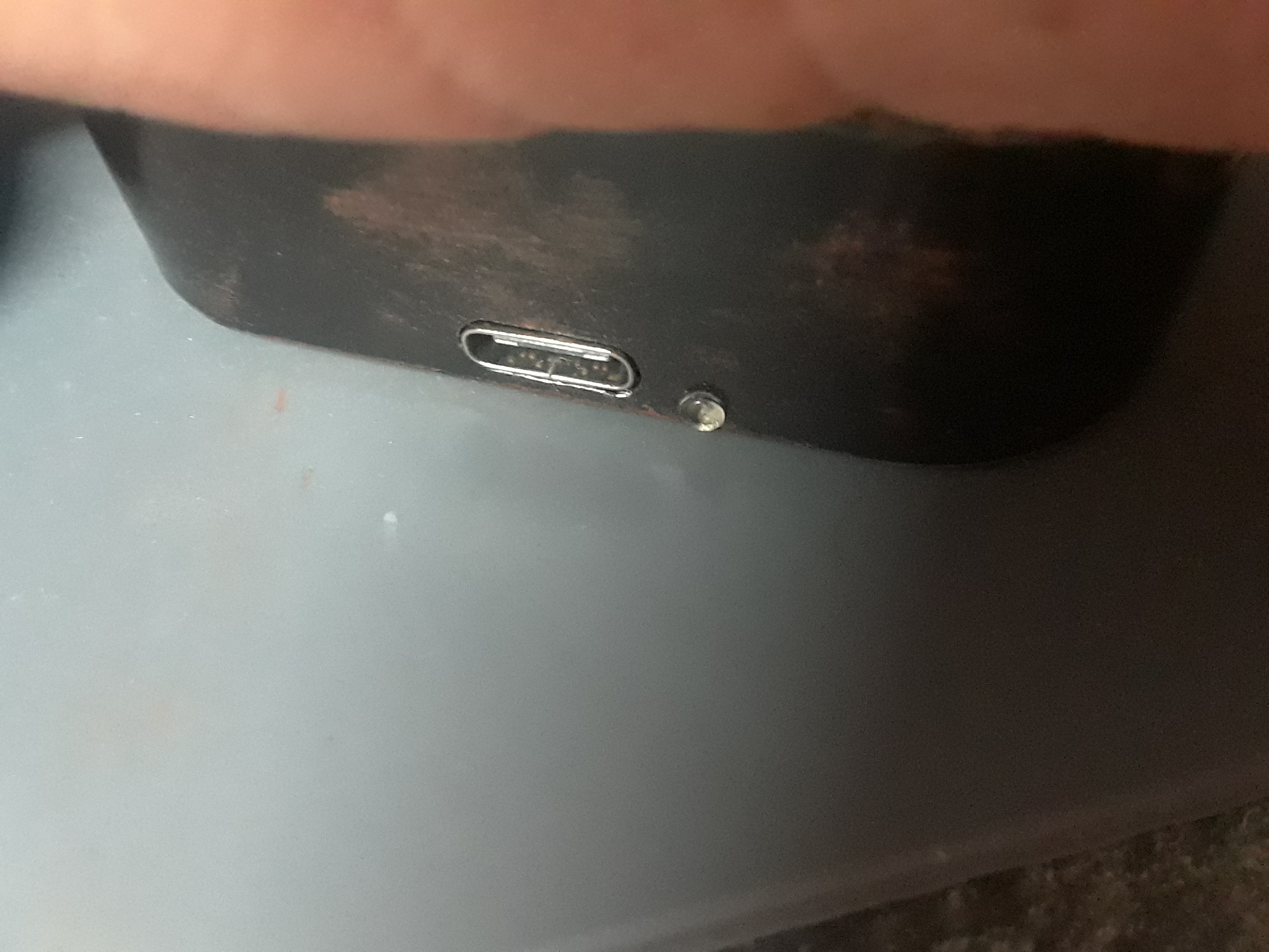

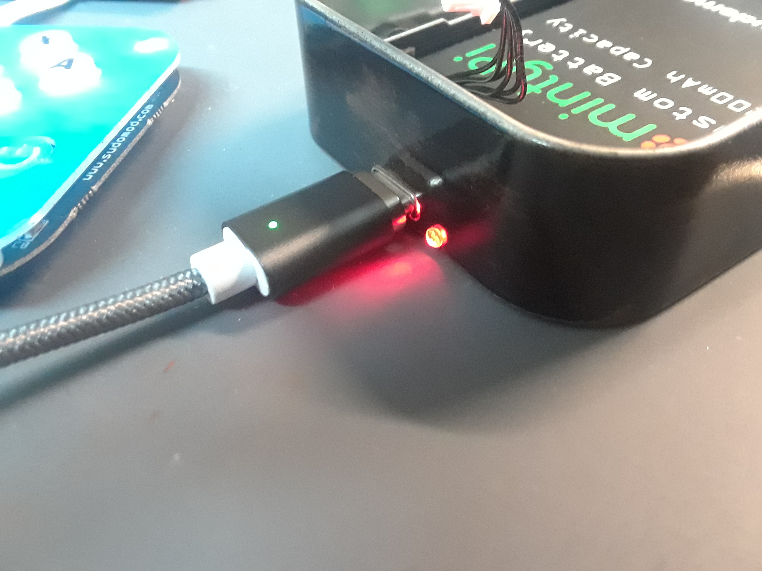

One small addition I made was to the charging indicator LED. The hole was drilled out just big enough to fit a small piece of clear PETG filament. The filament was then carefully heated on either side of the tin. The result being a "bulb" with the light visible at all angles.
charging light "bulb"Show
Charge Light Off
Charge Light Red
Charge Light Green

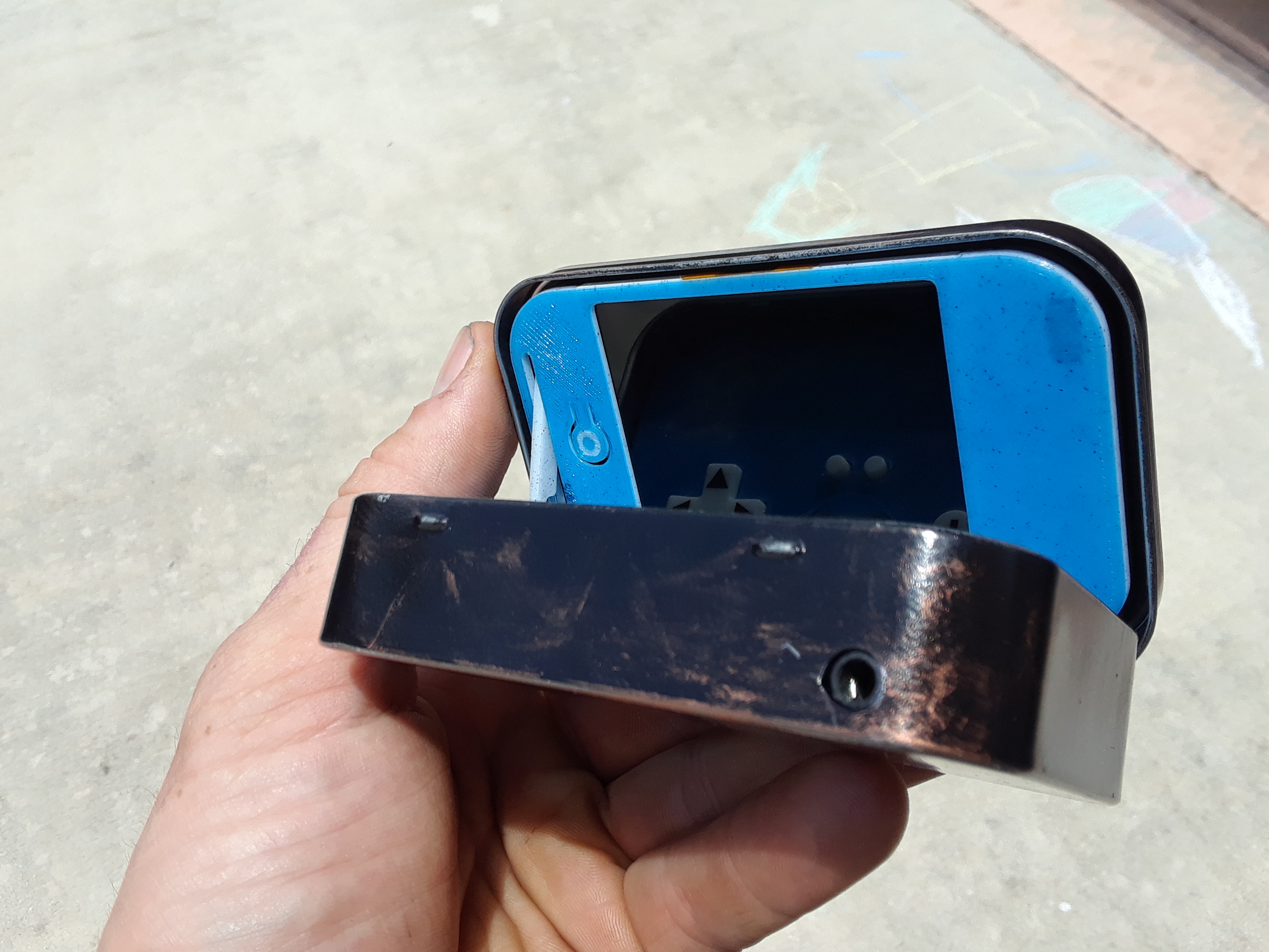

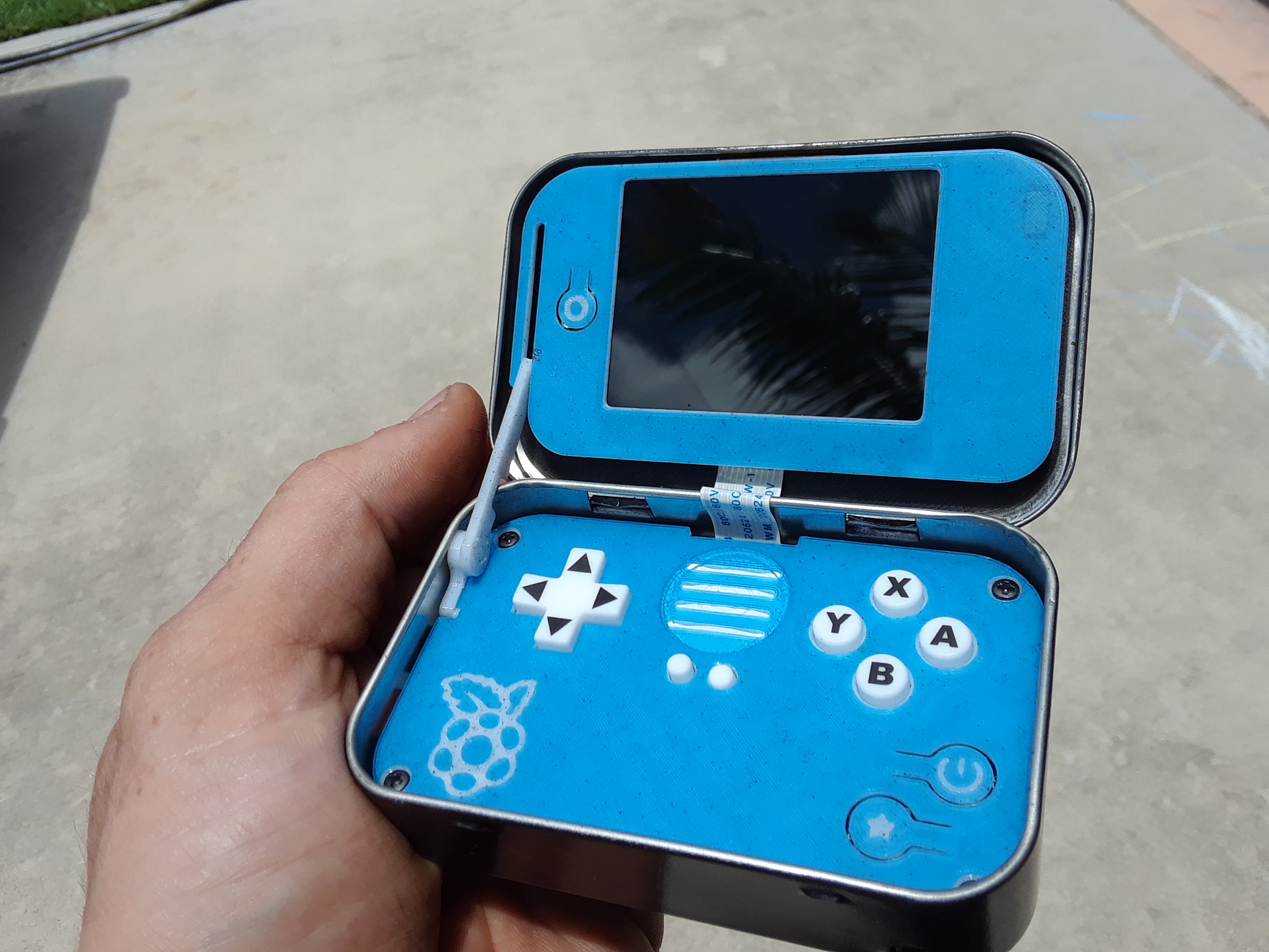

The final custom pieces are no more custom than choosing crayons for a coloring book, but the added contrast to the outside of the tin made it feel a bit more unique. Wermy did the real work on the STL files and was kind enough to share them with us, so a huge thanks to him. The fist layers were printed in a clear royal blue PLA, the rest of the print was a marble PLA which really lightened up the blue and added a little texture. Also, the black speaker stuck out like a turd in a punch bowl.... so I lightly sprayed that with a flat white to match.
printed partsShow
inside and out
inside
inside

The white speaker is a nice touch! Looks great!

Very nice build! I like how you did your dual color printing. I am guessing paused at layer height to change your filament?
I also like how the arm is also white and not black. I think I am going to print a red one for mine!
Again, I like it and nicely done!

Post by DieselDummy » Wed May 22, 2019 7:32 am
LilTrublMakr wrote:
Wed May 22, 2019 4:56 am
Yes and no. I did not manually pause it but I used the prusa control program to add a color change at a certain layer height. It's a very useful funtion

The clear PETG idea is genius. I've been wanting to order some for a while and this is making it hard not to pull the trigger. What did you use to heat it?
DieselDummy
Posts: 197
Location: Florida, USA
Has thanked: 80 times
Been thanked: 92 times
Re: DieselDummy's MintyPi v3 - #1
Post by DieselDummy » Mon Jun 10, 2019 8:45 pm
Broomhill wrote:
Sun Jun 09, 2019 9:51 pm
Honestly, I just used a regular Bic lighter. Patience is key....little bit of heat, wait, repeat... until you get the desired effect. Be careful though, I did it on a couple test pieces first... it burns easy.
Edited side note: I imagine some clear PLA would work fine, too. PETG was the only clear I had on hand, so that's what was used.
nexus23k
Posts: 63
Has thanked: 24 times
Been thanked: 19 times
Post by nexus23k » Sat Jun 15, 2019 5:55 pm
Really nice. I like the used rat look!
