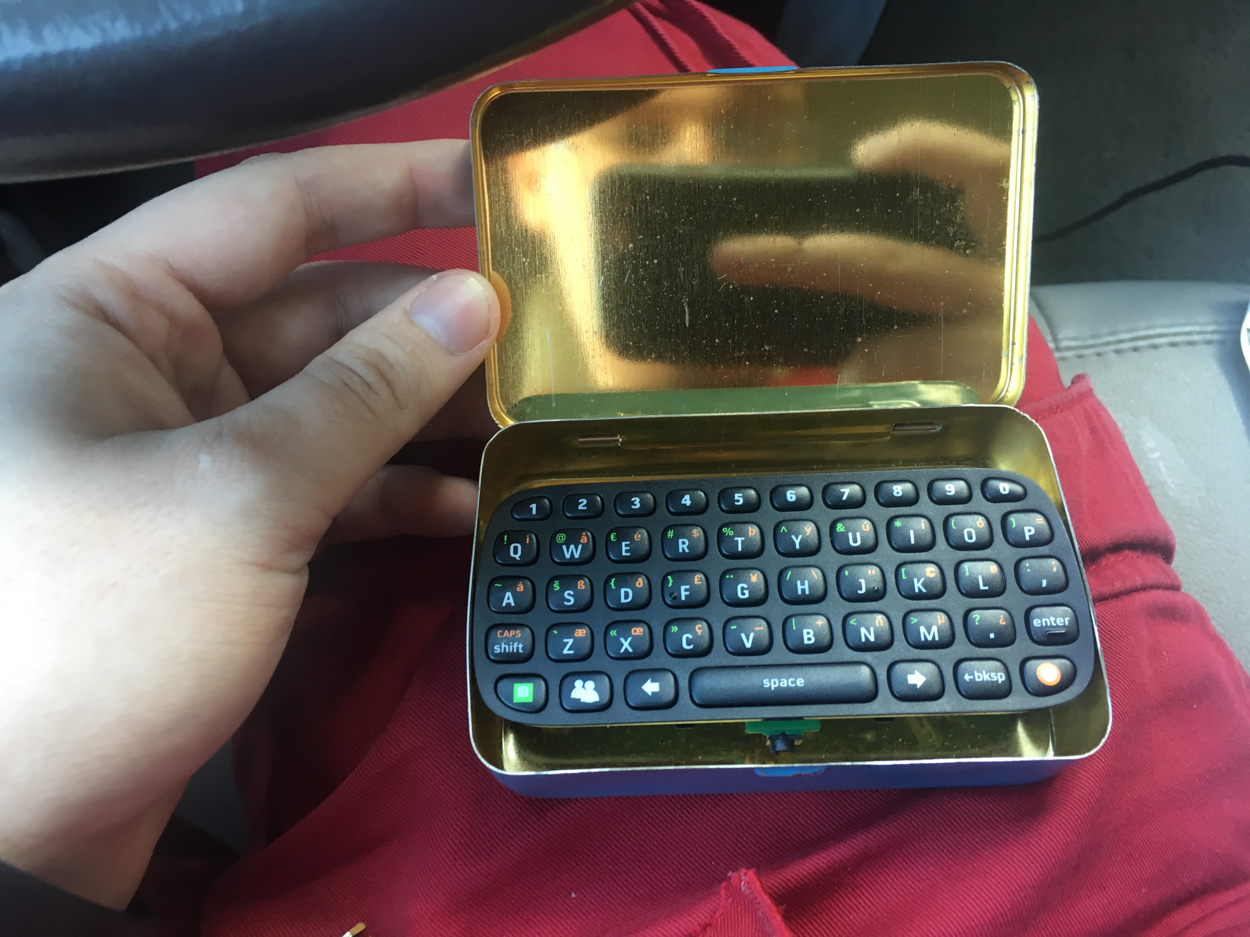

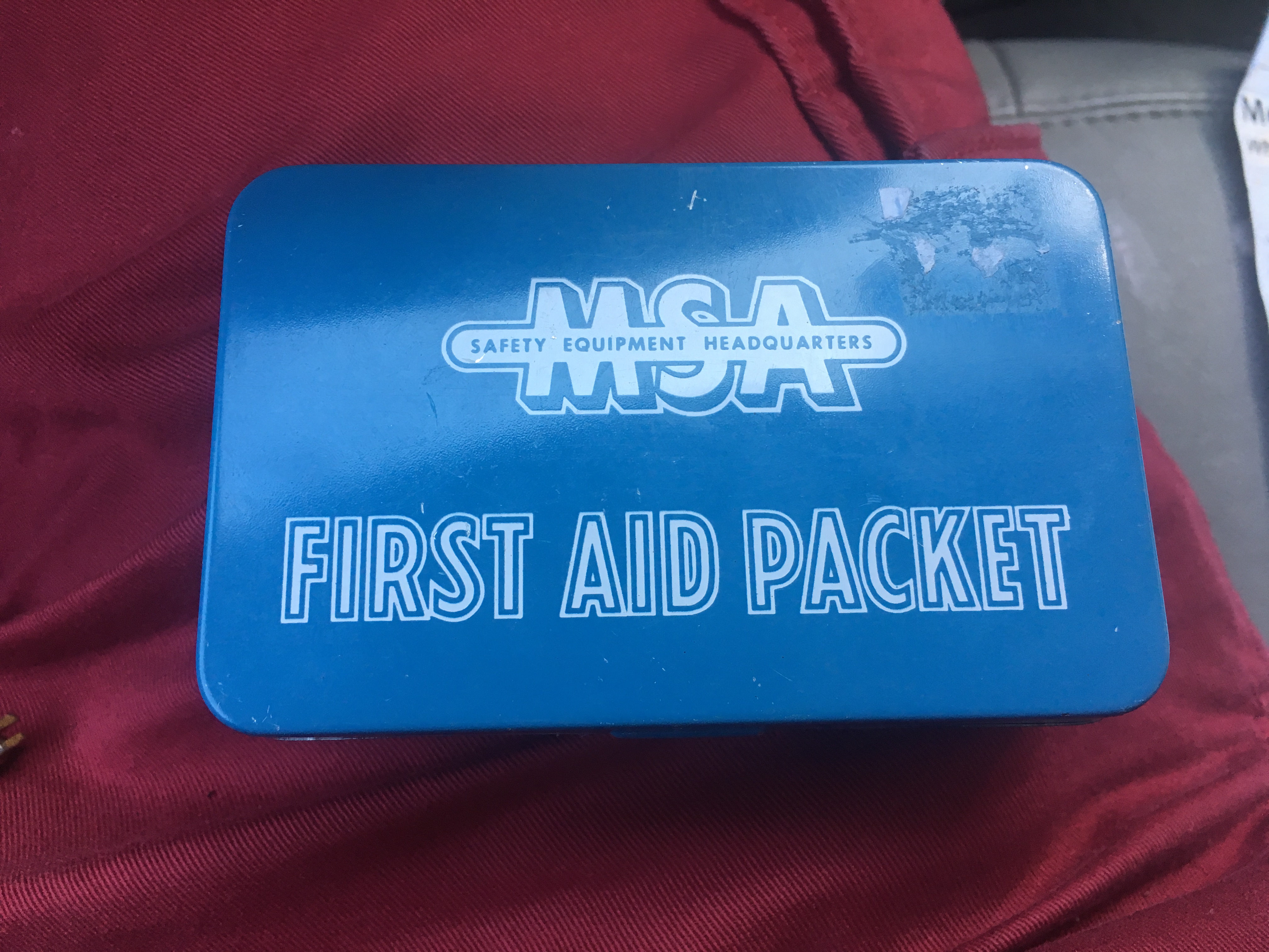

I want to chime in a little late but the XBox 360 chatpad is probably the smallest usable option you’ll have, an you still can’t use an Altoids tin. I’m making my own pocket PC using one, using some kind of rolling tobacco tin that’s 2.5”x4”, and that provides plenty of room. I also have this vintage first aid tin(pictured) that’s iirc 2.5”x3.5” and it spreads the sides a bit to put the keyboard in.
The only other keyboard option I can think of would be a derivative of @moosepr’s Pi0cket Click keyboard with its snap domes on a custom PCB that’s mintypi sized. I’d buy such a pcb if you make one.
