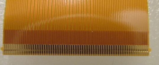

Ribbon dimensions you need are as follows:
The ribbon needs to be 9pin 1mm pitch and between 70mm to 90mm in length.

Same side will work but reverse side will be more ideal for this if you can find it.

hopefully they may be able to supply
whats the ideal length
https://www.aliexpress.com/item/CUSTOMI ... 0128&tpp=1

80mm is the best bet for a little slack and just the right length.

What exactly do you mean by ribbon cable?
Like so:

2Show
Screen Shot 2017-04-26 at 4.38.03 PM.png (23 KiB) Viewed 13908 times

Like so:
1Show
2Show
3Show
VeteranGamer posted a link to the ribbons above but it's like number 2.

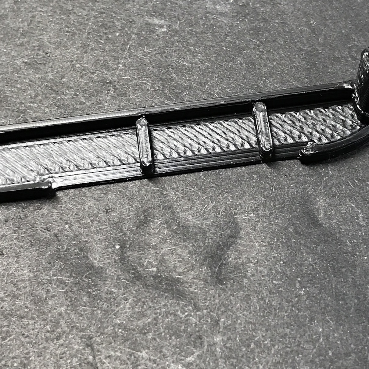

What specific part will you use for the on/off switch? Mini SPDT slide switch?
Posts: 1346
Has thanked: 620 times
Been thanked: 1322 times
Re: mintyPi 2.0 News & Updates
Post by wermy » Wed Apr 26, 2017 8:41 pm
rednakes wrote:
Wed Apr 26, 2017 8:12 pm
Yes exactly. Any tiny switch will do, all it does it put the enable pin on the powerboost to ground.
The 3d-printed part gives you about 11.5mm x 6.5mm to work with. If the switch you get is wider than that, I made it so those two posts that hold the switch in place are easy enough to break off cleanly with some pliers. Not a whole lot I can do about the depth though - so there's about 6.5mm to work with. :)
