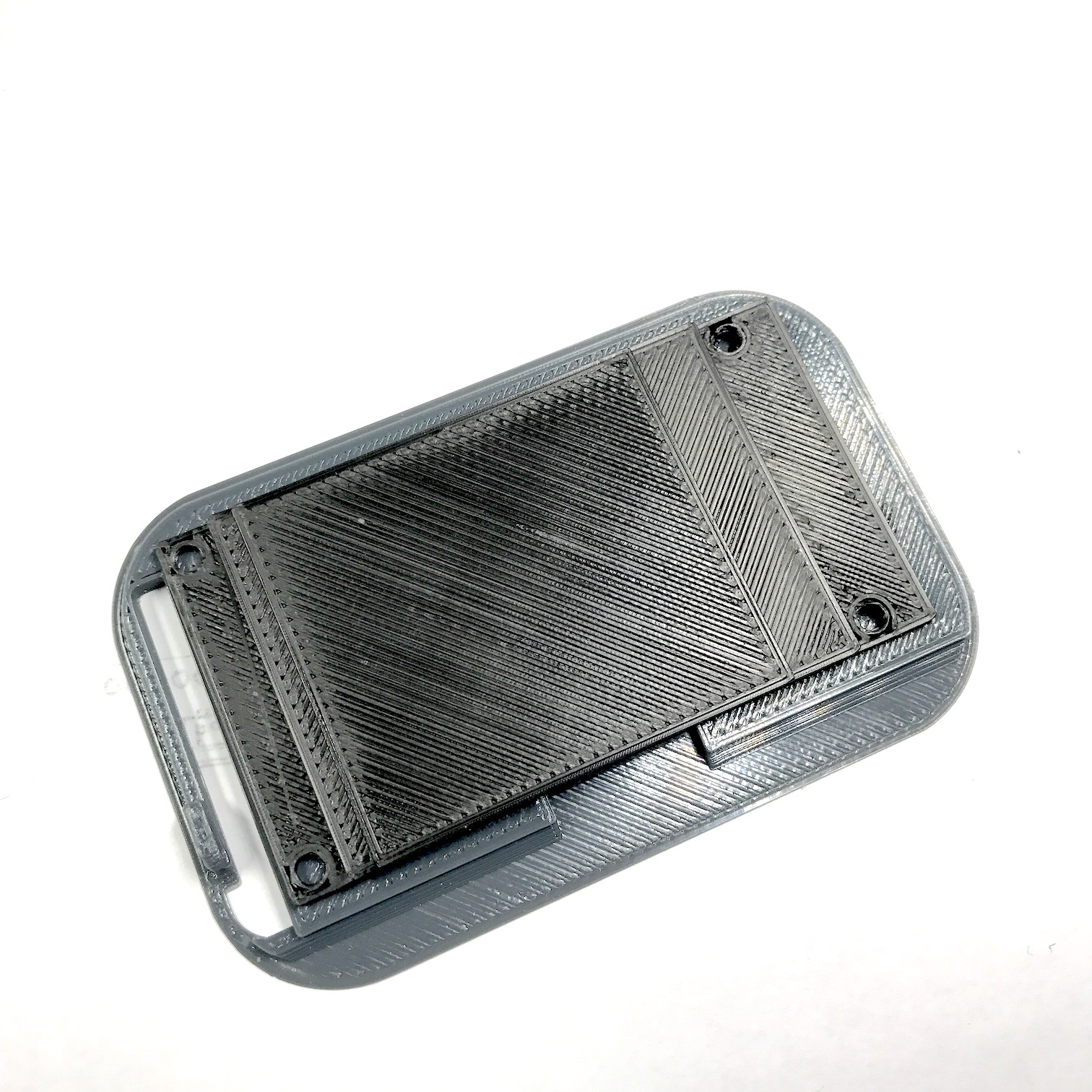

Alright, so I took the schematics for the 2.4" screen, made a quick mockup model of it, and printed it out:
You could probably get it to fit, but just barely and the screw holes wouldn't be symmetrical, and the screen would be off-center. :\
Helder and I are looking into the option of using the bare screen (which are still widely available and would easily fit in the center of the case), combined with a tiny custom PCB. That would let us use the 2.4" screen (so a nice bump in size) with a ribbon cable that would connect it to the button PCB we're making, which is connected to the Pi. So it should be very clean and easy. :) The only downside is that it will take a little longer to get all this ready. We have some screens on the way and have reached out to a supplier for a quote on buying some screens.

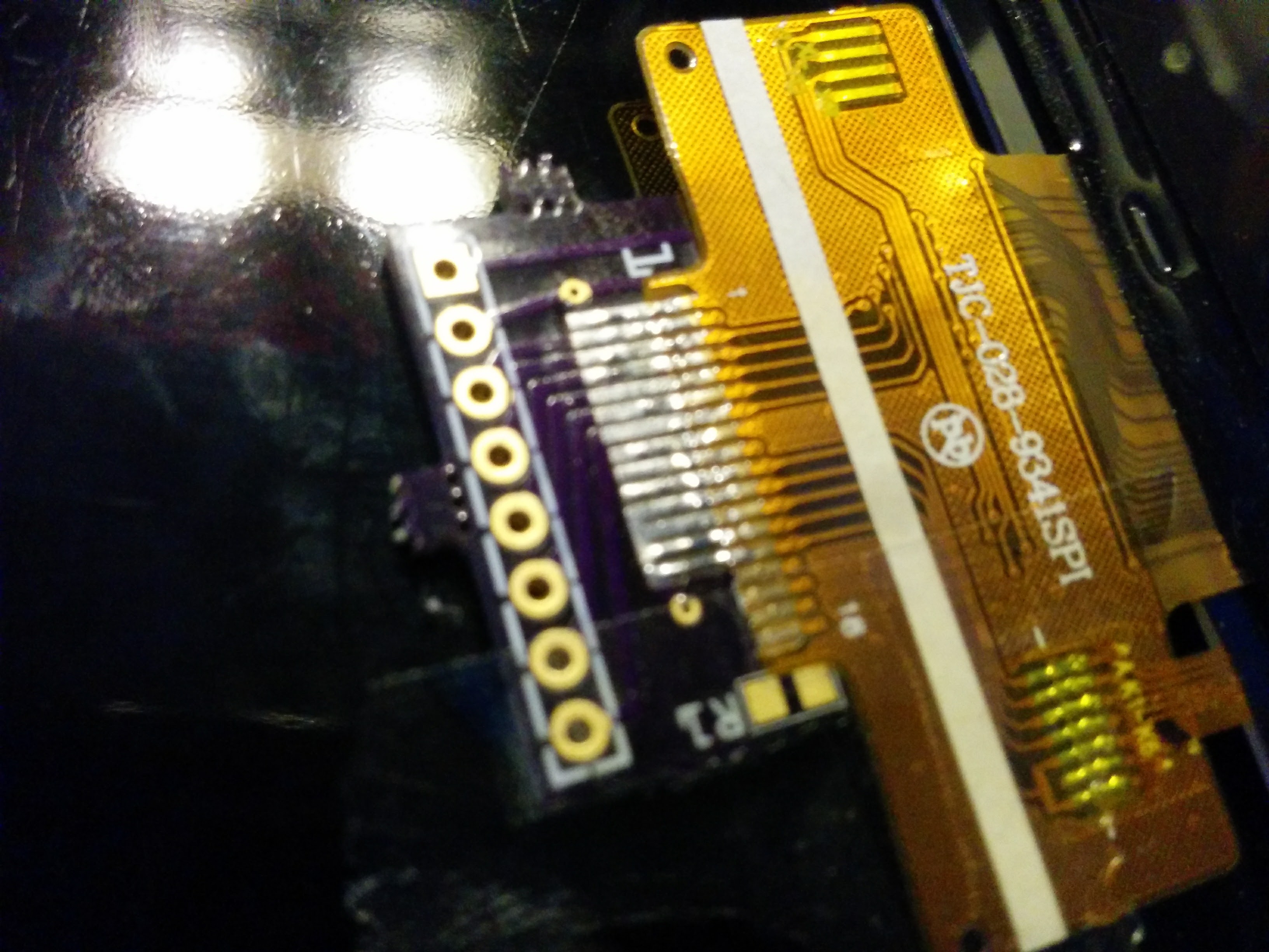

Was just about to ask about that. :) Could we just solder to the ribbon if you decide not to do the custom PCB? They do seem to be more readily available, and they're a lot cheaper than the screens with the shield PCB. I don't know about everyone else, but I'd rather have the bigger, cheaper screen if it's doable.
Which also makes me wonder, if we do go with just the bare screen, is there space to cram a 2.8" in? :D
you may even be able to use the stock screen/board... if you carefully round of the edges where the pin headers are, this will move the screen over a couple of mm.... maybe making it more central...
care only really needs to be takren around the vcc pin header as the other end is for the touch
just an idea, trying to avoid extra cost and hassle
as it seem that the 2.2 is a no option (99% certain)
you could try soldering to the ribbon if you like, but they is super tiny!!! 0.8mm pitch
