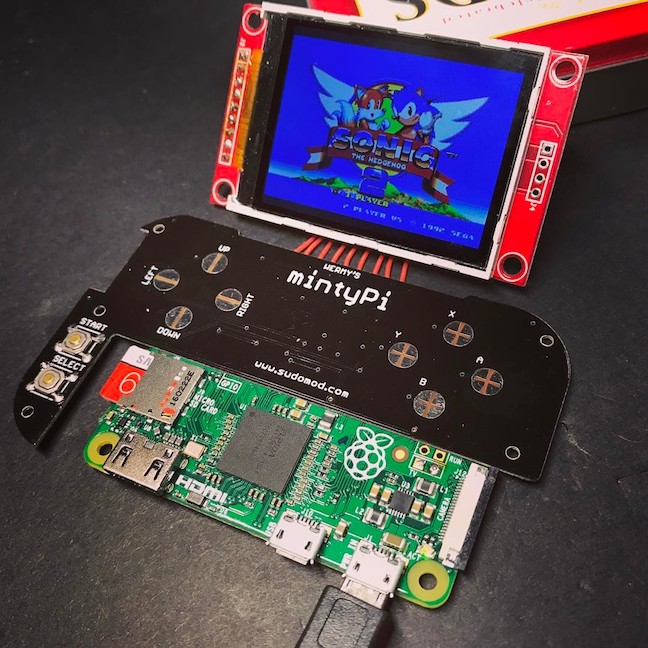

5-5: Button PCB samples got here and they are a perfect fit! Now just waiting on screen samples and the accompanying board for it that Helder is working on.
5-9: I meant to post this on here too but I guess I forgot: tested the button PCB out and it worked great! Soldering the pi to the board is actually very easy with the 3d-printed parts - I'll of course show how to do that in the guide. You can see below that things line up perfectly: just enough clearance for the camera connector and some other components on the board. :D Note that the tactile switches there are not necessarily the ones I'll recommend getting.

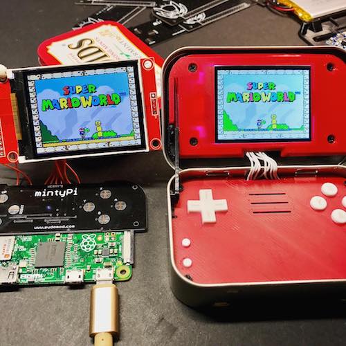

5-18: I got some 2.4" screens in the mail (both bare and on boards). That extra 0.2" makes more of a difference than you might think (pic below)! I really don't think the on-board ones you can find on ebay will be an option with the 3d-printed parts. The only way you might be able to make it work is by cutting the corners as much as you can, and having the screen off-center (bleh).

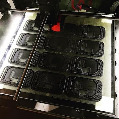

As for an update: I'm cranking out 3D-printed parts as fast as I can and waiting on screws to arrive. :)

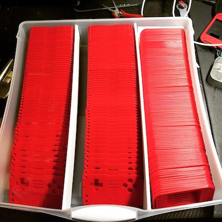

Nearly done printing the red/peppermint pre-orders. :D (waaaaay more black parts are off-screen). Also Hoolyhoo pointed me towards a script/app you can install on the pi to enable/disable wifi/bluetooth. Idling in emulationstation, a Pi Zero W with a USB keyboard plugged in went from ~35-36mA to ~31-32mA after disabling wireless. Not too shabby! I'll have an option added to the retropie menu in emulationstation for turning on/off wifi easily.

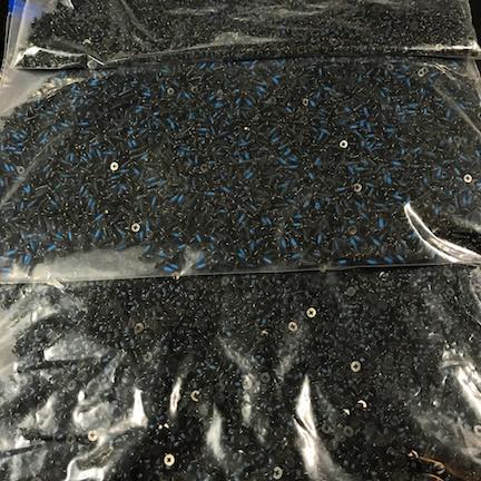

Should be finished printing pre-orders early this next week. There were two shipments of screws on the way, one arrived today, the other is hopefully no more than a few days behind it. Once I have all that I can start packing/shipping pre-orders in the order they came in (finally!). Helder's expecting to have his stuff next week sometime as well, so once I get my hands on some of the final versions of those parts I can get busy on a guide (the final parts are slightly different [they have some test pads that people can use to make sure their soldering is correct, for example], so I wanted to wait for final ones before doing that). Getting so close!
I've also about finalized the setup script, which now sets up the enable/disable wireless menu options in retropie for you. I'll put that up for public scrutiny soon. :)

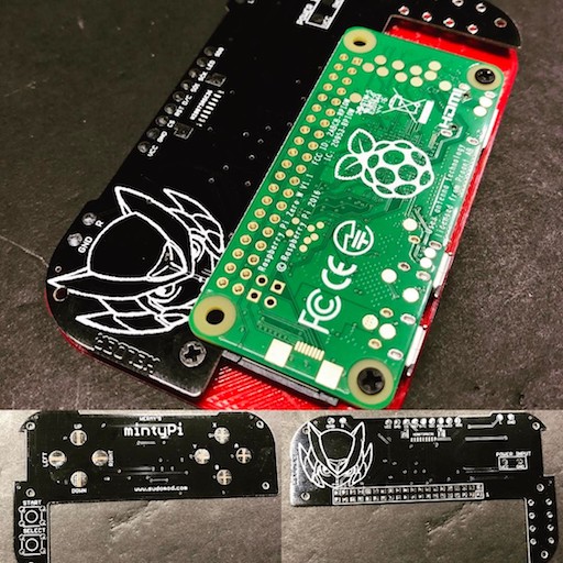

Final mintyPi board images:
Test Pads
LCD Boards
