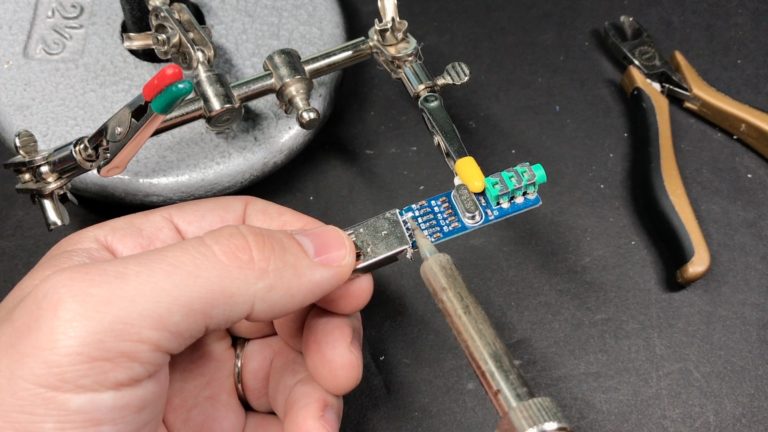

In the mintyPi guide, I see that wermy's helping hand has little rubber nubs on the end of the alligator clips. Does anyone know what those are called, or where to buy them? I've seen them other places, but without knowing what they are called, I can't buy some for my own setup.Image

Thanks to /r/whatiisthisthing I think we have an answer: Look up "vinyl bolt caps" or "vinyl thread protector"

I had been using the sheath from ethernet cable in the past, but tonight I stopped by Lowe's and picked up these screw protectors. They fit pretty well on my cheap Harbor Freight helping hand. Not super snug, but they look close to what wermy's setup has, and the rubber is thicker than the ethernet cable sheath or the heat shrink tubing I tried. At 92¢ for a 4-pack I think they're worth trying out. If they end up being too floppy I can try out the next size smaller.

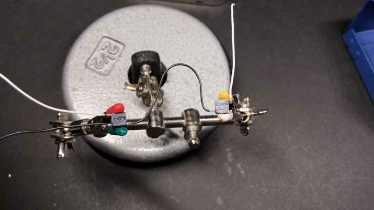

I also put a small 2.5lb weight over the base of mine. Super helpful, it holds it in place nicely:
Great idea! I think I'm going to pick one of those up. That helping hand flops over all the time.
