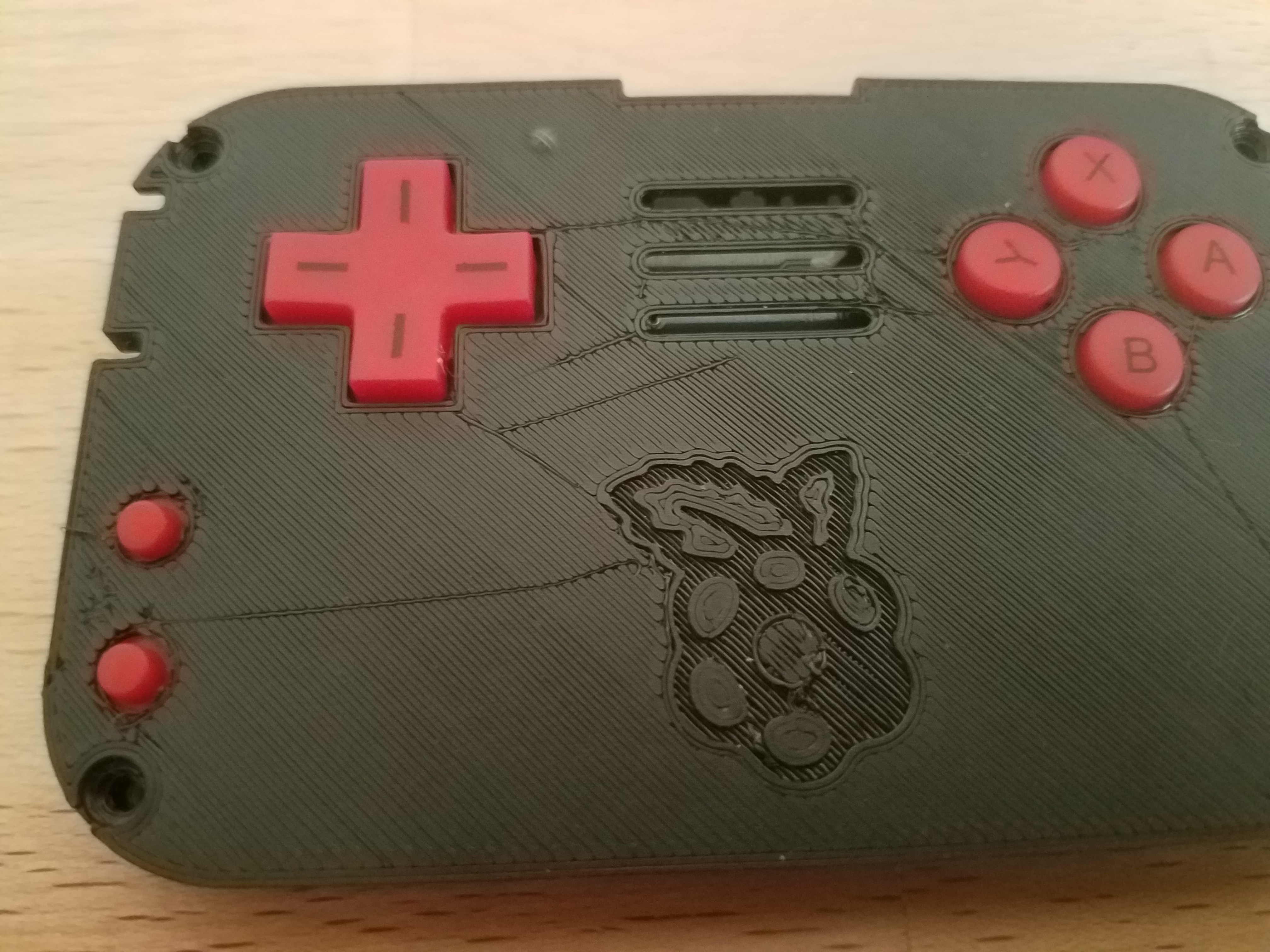

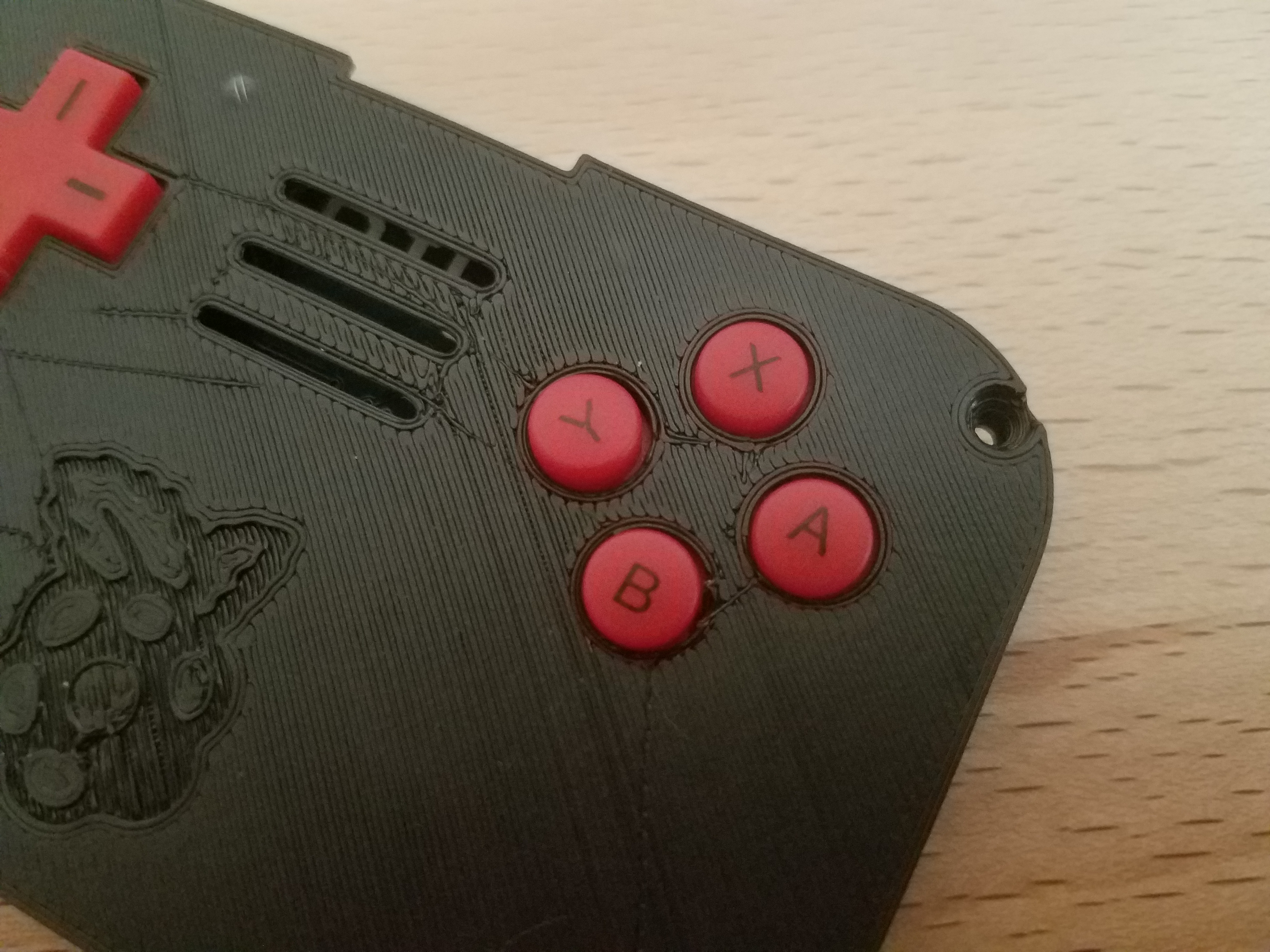

Sorry, i mean they rotate not flip. Here are the pictures, it looks to me like maybe my wall thickness is to thin.

Alrighty, quick update. I printed this one again but with a higher wall thickness, buttons fit much much better and the print came out much nicer. Getting this printer dialed in now:)

It looks like your prints aren't adhering to the bed surface properly for your first layer. Are your sure your nozzle is low enough?

All my other prints came out perfect, but this one gave me a few issues. On top of adjusting my wall thickness, i slowed the printer down and increased the bed temp. Came out much better and everything is fitting great. I'm using the Monoprice Mini and bed leveling can be a pain to get right
