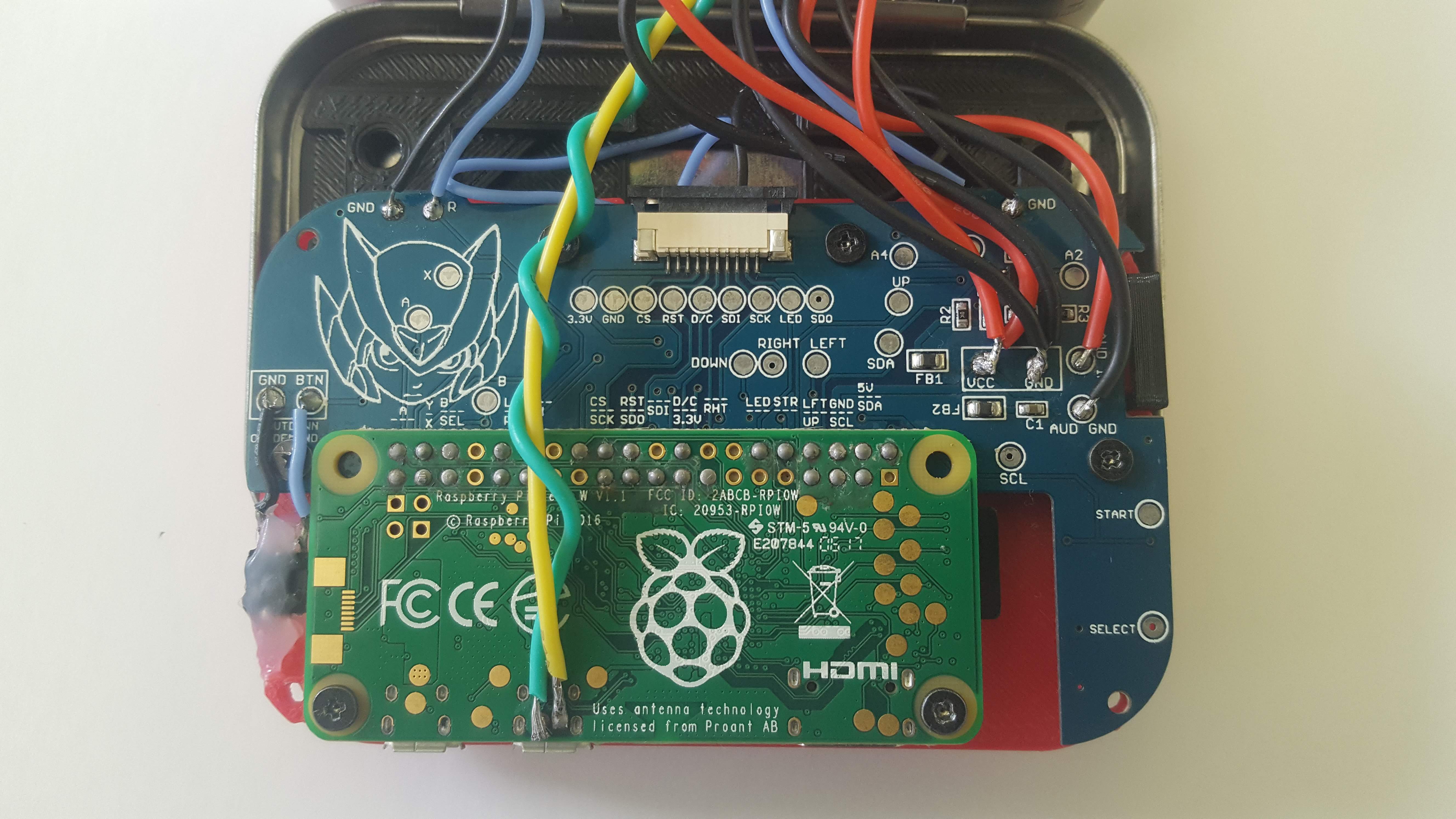

Here's a picture of the soldering for reference:
The only other recommended solution I've come across was to add solder to the ribbon connector pins on the PCB and LCD screen. This was a daunting project for my first soldering job. Before I break out the iron again, is there anything else I can try to resolve the issue?

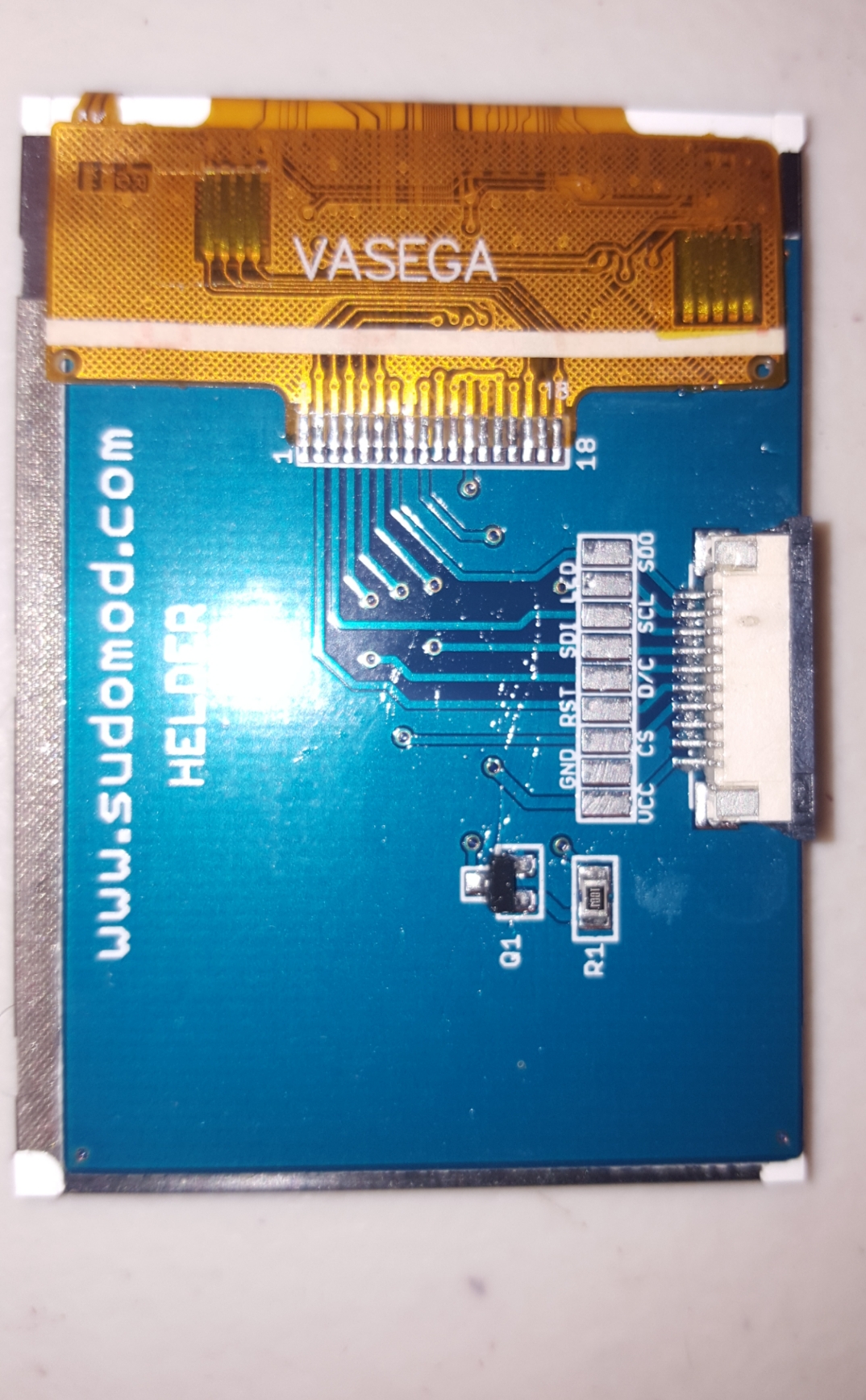

After adding more solder to the screen and PCB ribbon connector pins, and swapping out the old ribbon cable with a spare, the screen got all the way to the emulation station menu before cutting out to white again.
I swapped the screen with a brand new one from a second mintyPi kit and it seems to be holding out with no issue, so the problem may lie with the original screen.
Here's a picture of the original screen's connectors for reference:
Just to clarify, should the solder be added to the 18 pin ribbon, or the 10 pin connector?
Thanks again.
Re: White Screen
Post by Helder » Mon Jun 04, 2018 2:26 am
10 pin connector, the 18pin looks fine but doesn't hurt to reflow it.
