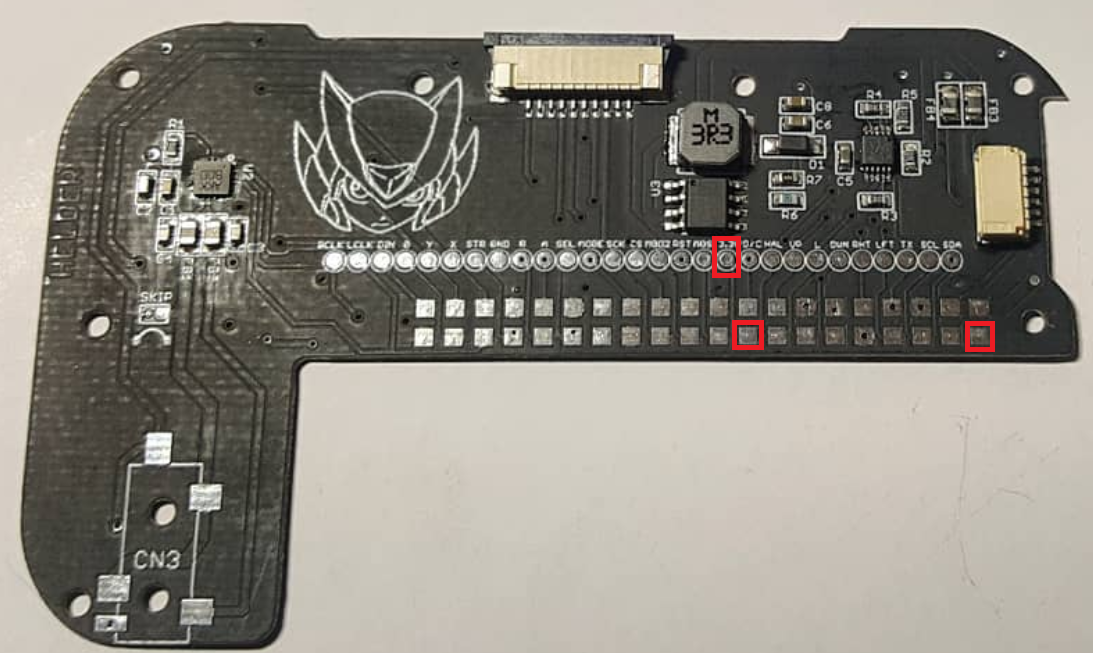

Should I have 3 pins with continuity with the 3.3v test point? Should all of the unassigned pins be connected to the ground?

There are 2 that are 3.3v and 1 that gets 3.3v but only when turned on. There shouldn't be any other pin with 3.3v.
No sound means no 5v, check 5v to the D1 point if you haven't done so.

Have you checked all the pins with each surrounding pin to check for shorts? Like this? Nothing should have continuity unless otherwise noted.

I did was was in the gif and nothing was shorted but these pins had continuity. The two 5v pins had continuity with D1.
- Untitled.png (846.97 KiB) Viewed 4636 times

Test continuity from the screen GPIO to the LCD test pads to be sure you have continuity going to the LCD board for all connections. No LCD lighting means that 3.3v or GND is bad or the LCD might need a reflow which is unlikely needed for the batch of kits you got but if all else fails it's something to look at.
Just use this here to see what GPIO is what and go test the continuity from these points to the labeled points on the back of the LCD.
