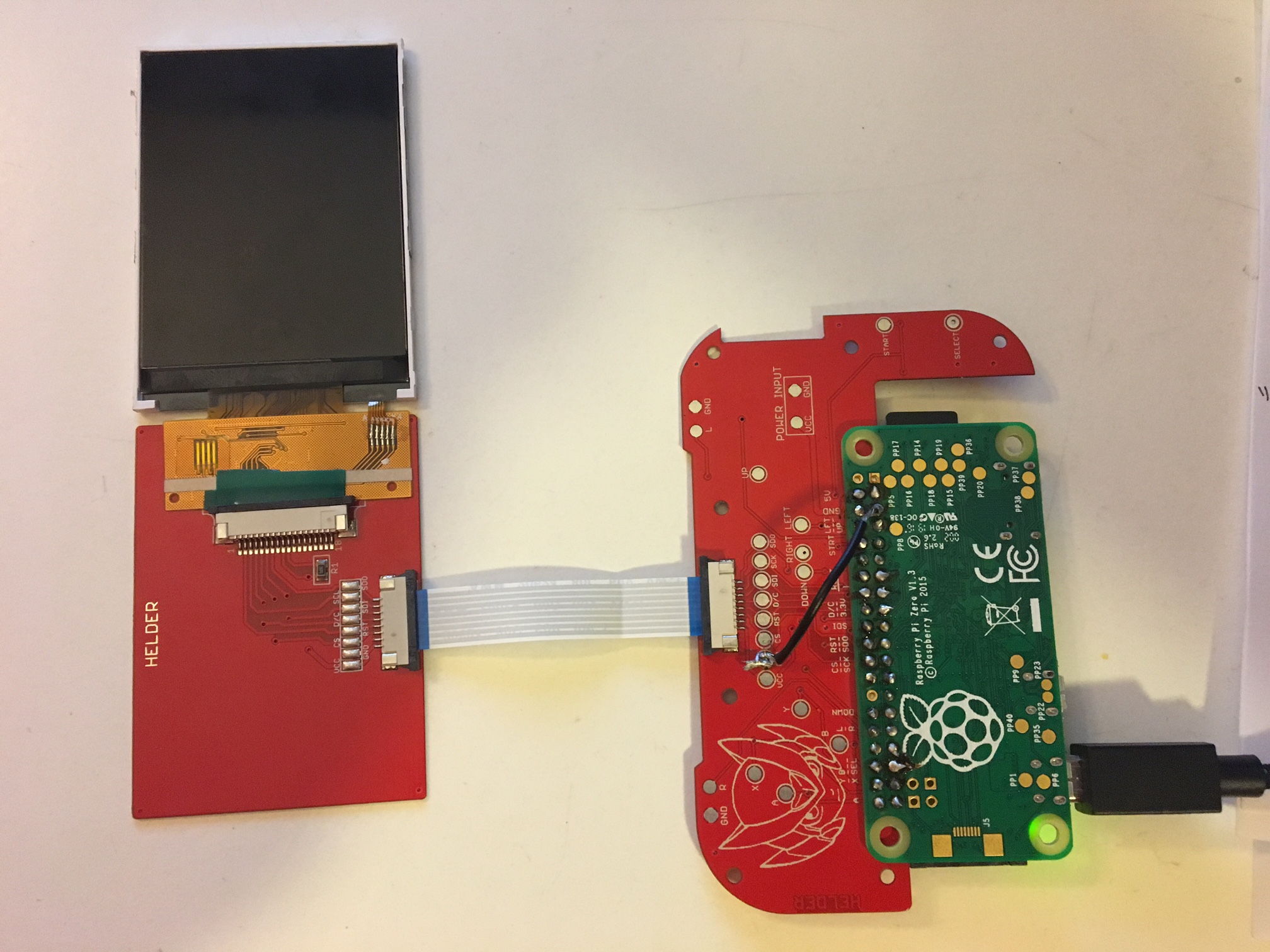

Made a nice straight cut. I'm in the testing process now but it doesn't seem to be working. The screen is completely black. A pic of the full setup complete with a ground wire per Helder's advice is attached.
- IMG_5582.JPG (802.76 KiB) Viewed 7510 times

Re: Need Some Help with a screen
What a your voltage reading from the VCC pad on the screen backboard while the unit is powered on?
I'm assuming you can't get continuity on your Pi GND pin hence the wire. Run that wire to the main GND input to right of board instead.
That isn't even a GND pin on the Pi that is one of the i2c pins.
Did you see if there is voltage on the VCC and GND pads?
Good spot, if your soldering has no continuity to GND or 5V that screen aint coming on!
