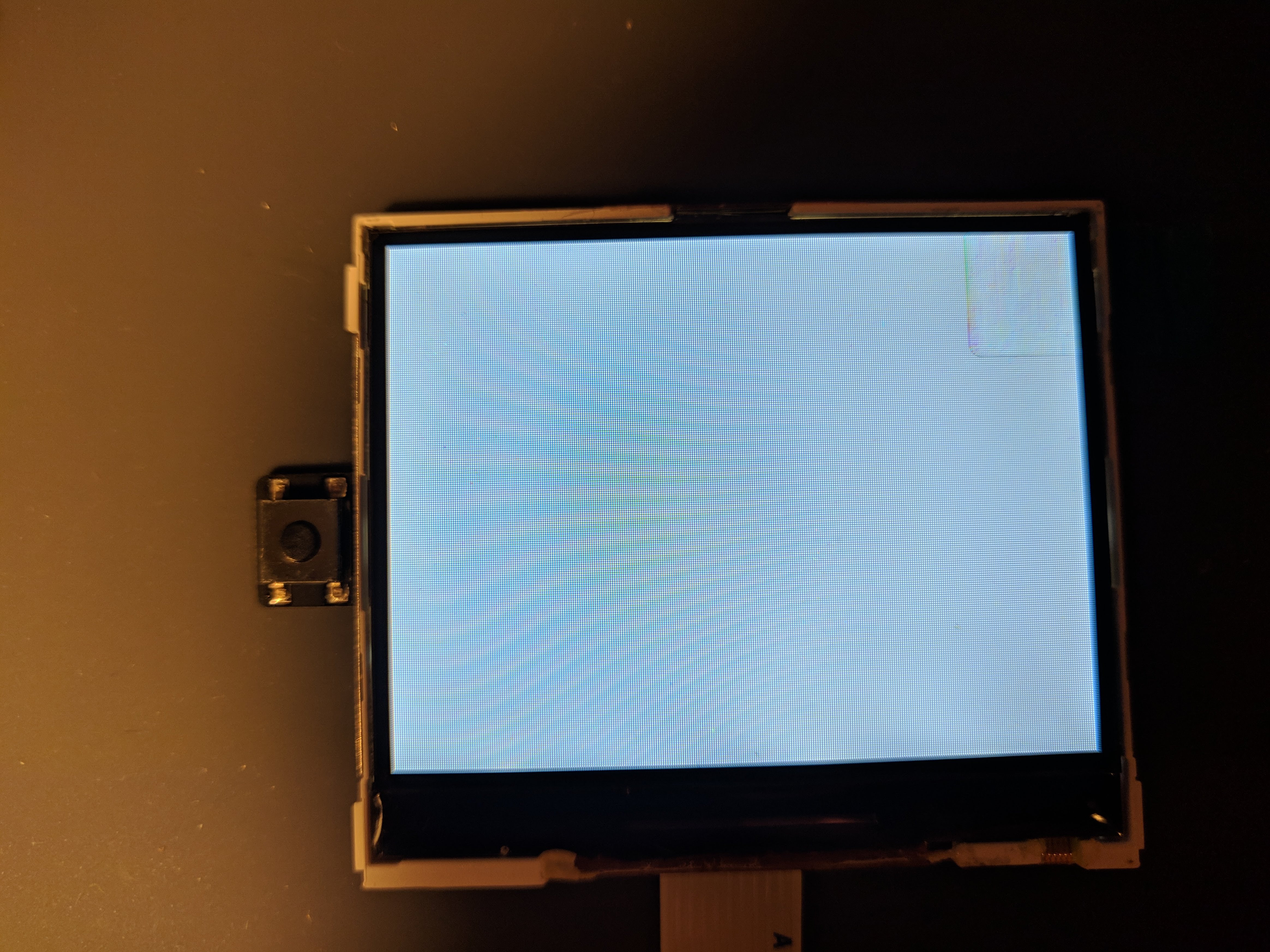

Hi,
I have an issue with my screen, a bit different of the one which appears in the first post, but as it is called "V3 screen issues" I think I don't have to open new topic. I you think I should open a new one, tell me please.
When I plug my mintypi the screen looks good and completely white, but when it boots and when is already booted, a line appears from top to bottom. I attach some images so you can see it.
Any idea why this is happening?
Thanks.
Re: V3 screen issues. How to fix them!
Post by Helder » Wed Sep 11, 2019 9:59 am
It's a damaged vertical line, I can swap it out for one without it. Send me that LCD in a box or a very well packaged envelope.
