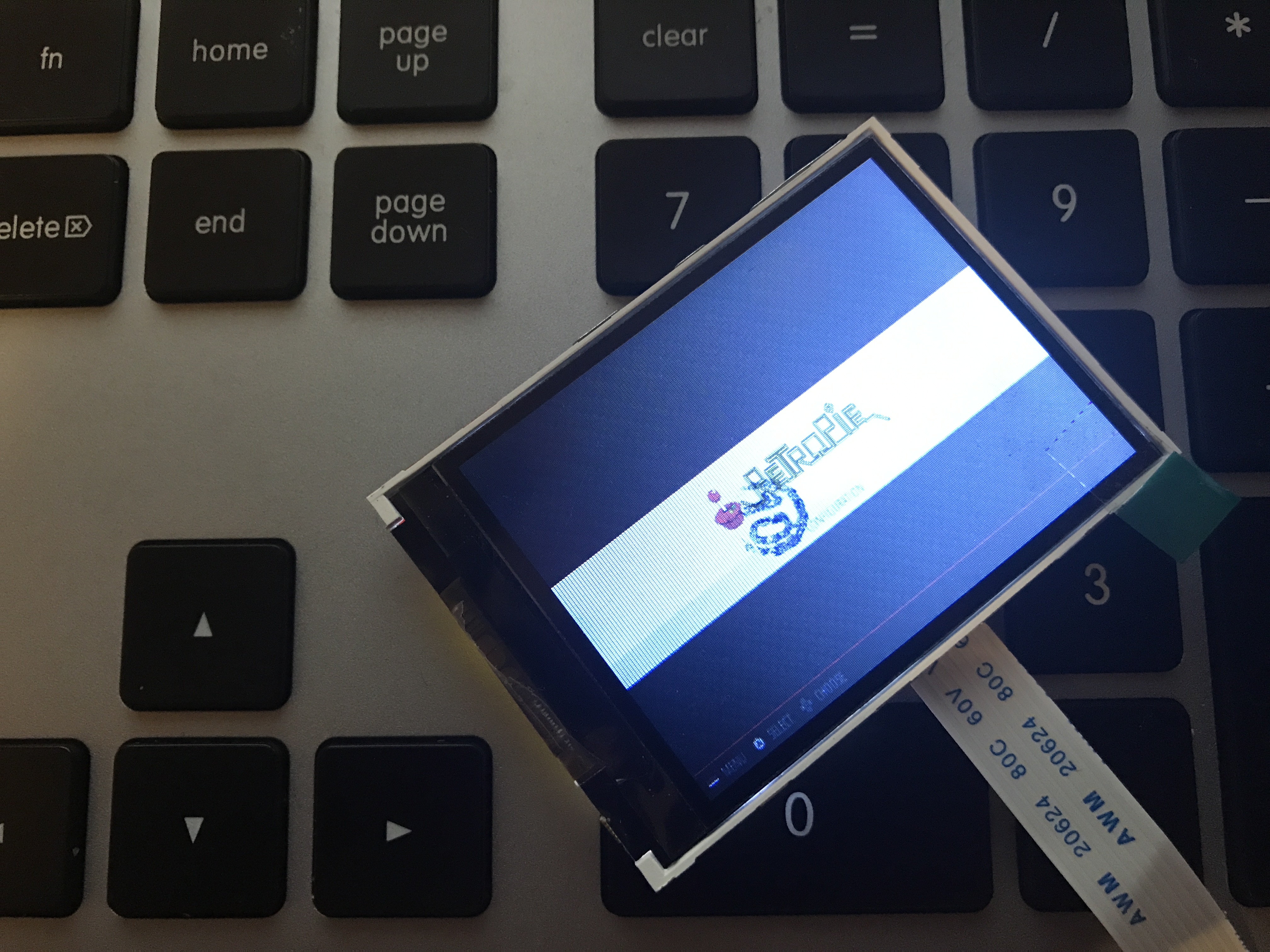

Thanks for the offer, but I was able to rework it using copper tape and some deft soldering. Those ribbon cables are incredibly delicate.

After reading all the forum posts, taping / re-taping, trimming, and re-checking all the solder points, the screen remains black with no response. Messed with it so much the clip on the connector snapped off. Tired and frustrated, I'll be ordering a second one and try again. *sigh*

So no backlight? Did your continuity test work for VCC below the 8pin connector with the 3.3v GPIO? That is what powers the screen and did you make sure the gold fingers on the ribbon face down when inserted into the connector? Did it ever light up at anytime?

It didn't do anything - no backlight, no video, nada. The pins were facing downward. That was made clear given the pin number markings and that it would sit really weird in the tin if it flipped. I metered the voltages and the it was clear the pi was reading the card. It was just the display that was entirely unresponsive.

Please post images of your ribbon and it also inserted into the socket and you also used tape to thicken it up right?
Re: Bad Display Cables/ LCD Ribbon
Socket latch broken as per my first comment. [edit for clarity] The taping* looks similar to the image on page one of this topic. Posting pictures won't accomplish anything. I'll just wait until a better option or replacement screens are in stock. I mean, your desire to help is appreciated, but it's a fragile solution on a 1.0 release.
