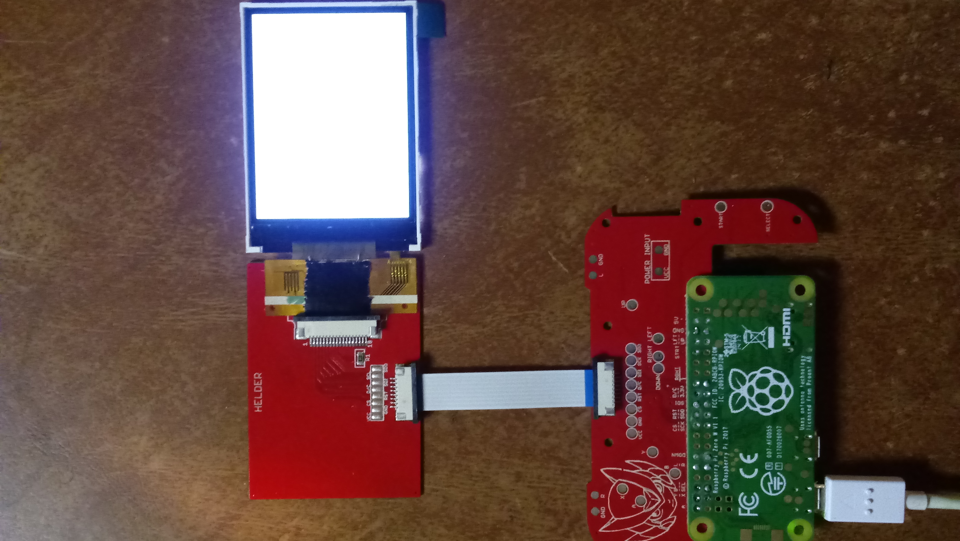

Hey Guys, I have searched the forums for a solution to the white screen problem and tried to troubleshoot the problem on my own with no success. I checked to make sure the GPIO pins were consistent, I have the masking tape on the screen connector, the pins are properly aligned, and I have rewritten the retro-pie image multiple times. Any help would be appreciated.

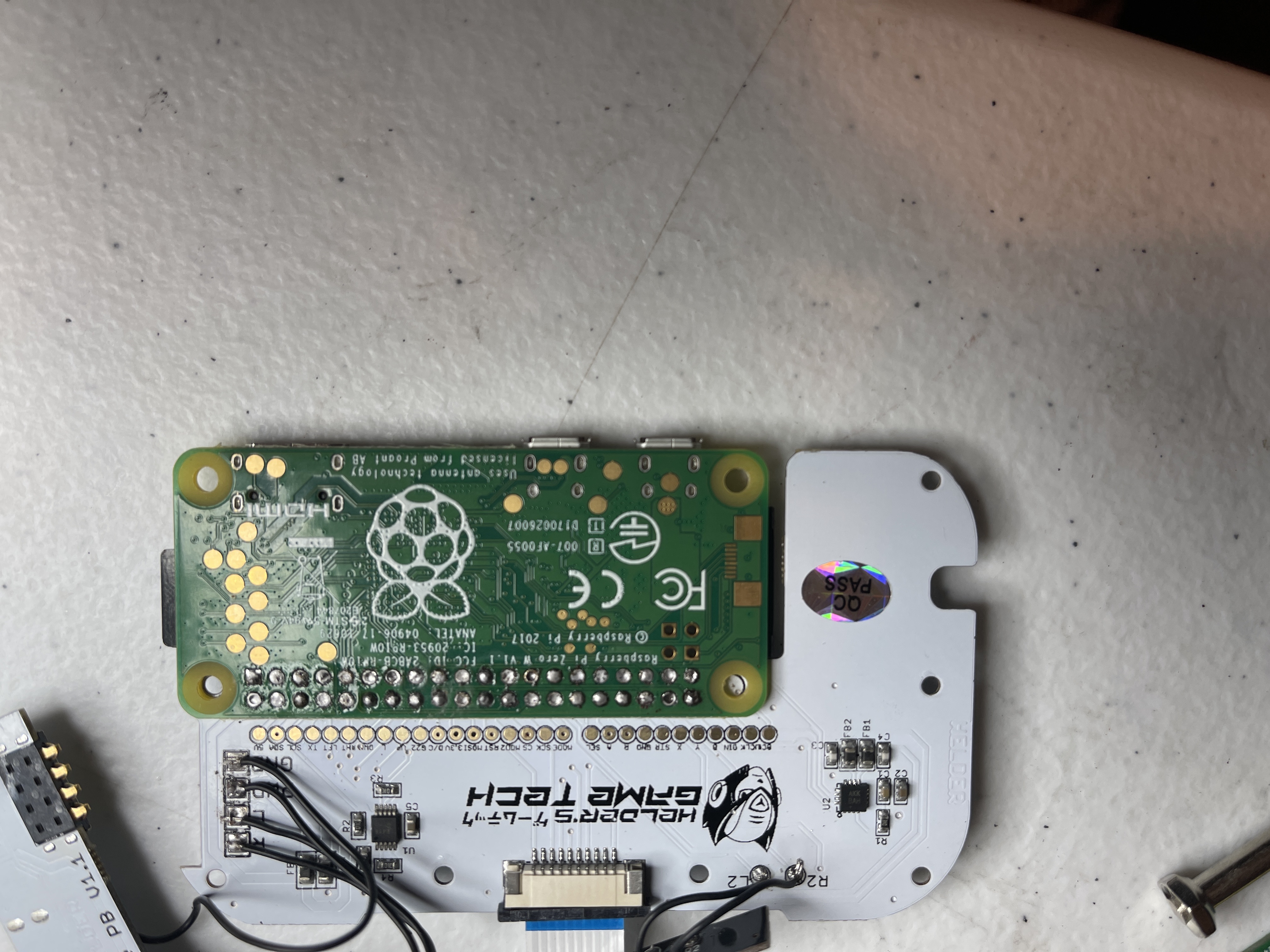

Can you get a closer picture of the gpio pins?
Nowhonda
Joined: Thu Sep 07, 2017 12:17 am
Re: White screen

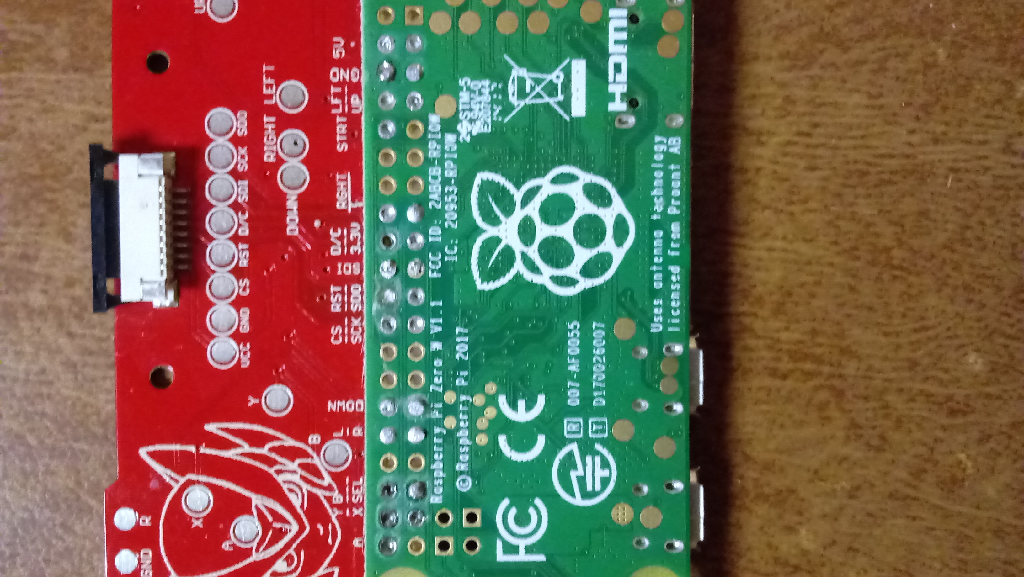

Post by Nowhonda » Tue Oct 10, 2017 11:37 pm
Its not pretty, but there was continuity.
J-Malice
Posts: 55
Joined: Fri Jun 02, 2017 2:40 pm
Has thanked: 33 times
Been thanked: 8 times
Re: White screen
Post by J-Malice » Wed Oct 11, 2017 1:43 pm
DC looks like it doesn't have enough solder. Did you see my last post on the previous page? Check the 4 gpio that I mentioned. My screen was exactly like that until I made sure to press the soldering iron deep into each opening and apply a *very* little bit more solder to each.
Edit: also, you have no solder on the A button gpio.

This seems like a continuity problem, are you checking the corresponding GPIO to the test pad under the 8pin socket?

I got it to work and it was a continuity issue. Thanks for the help and please forgive the simple solution. I really did think the continuity was fine before I tried it again.
