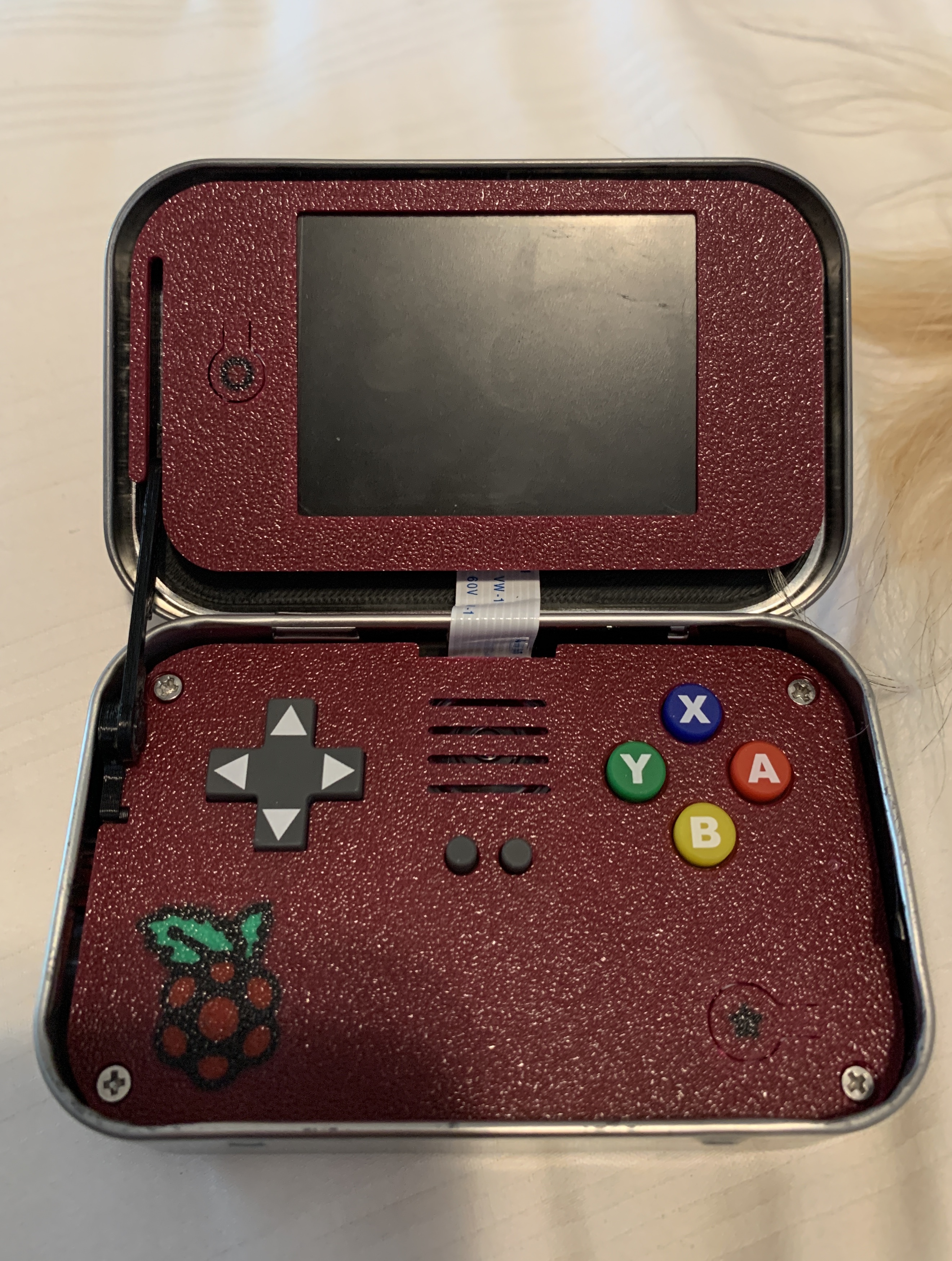

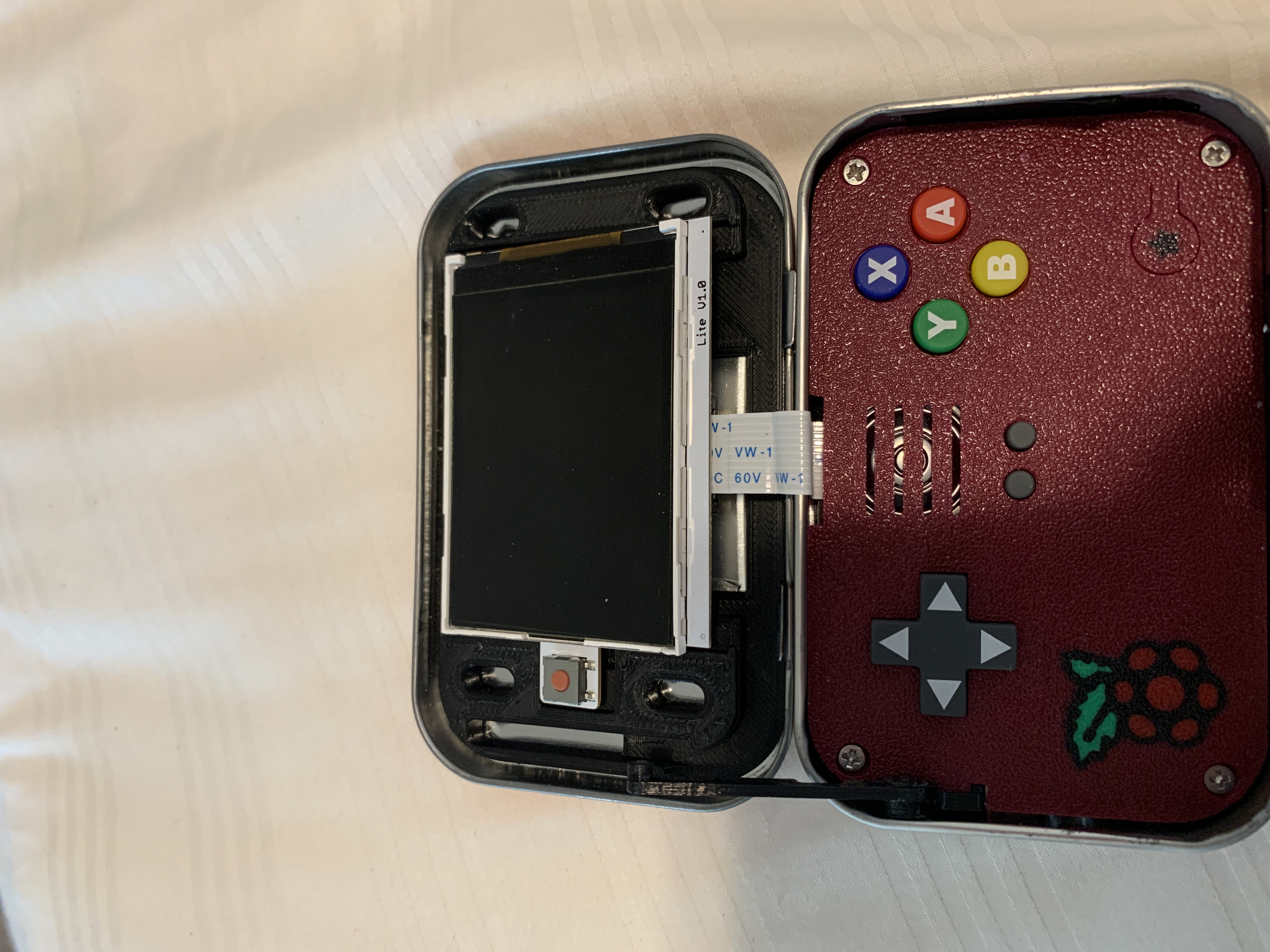

Post by hwhitted05 » Mon Sep 21, 2020 10:43 am
I checked many times so I’m pretty sure it was in the 3D printed part all the way. Here are the pictures with and without the bezel attached

Post by Bush Master » Mon Sep 28, 2020 9:19 am
The right looks like its in but on the left, the actual screen and not the board is hanging over a bit. It could be that. I know I had to wedge my screen in kind of like that.
