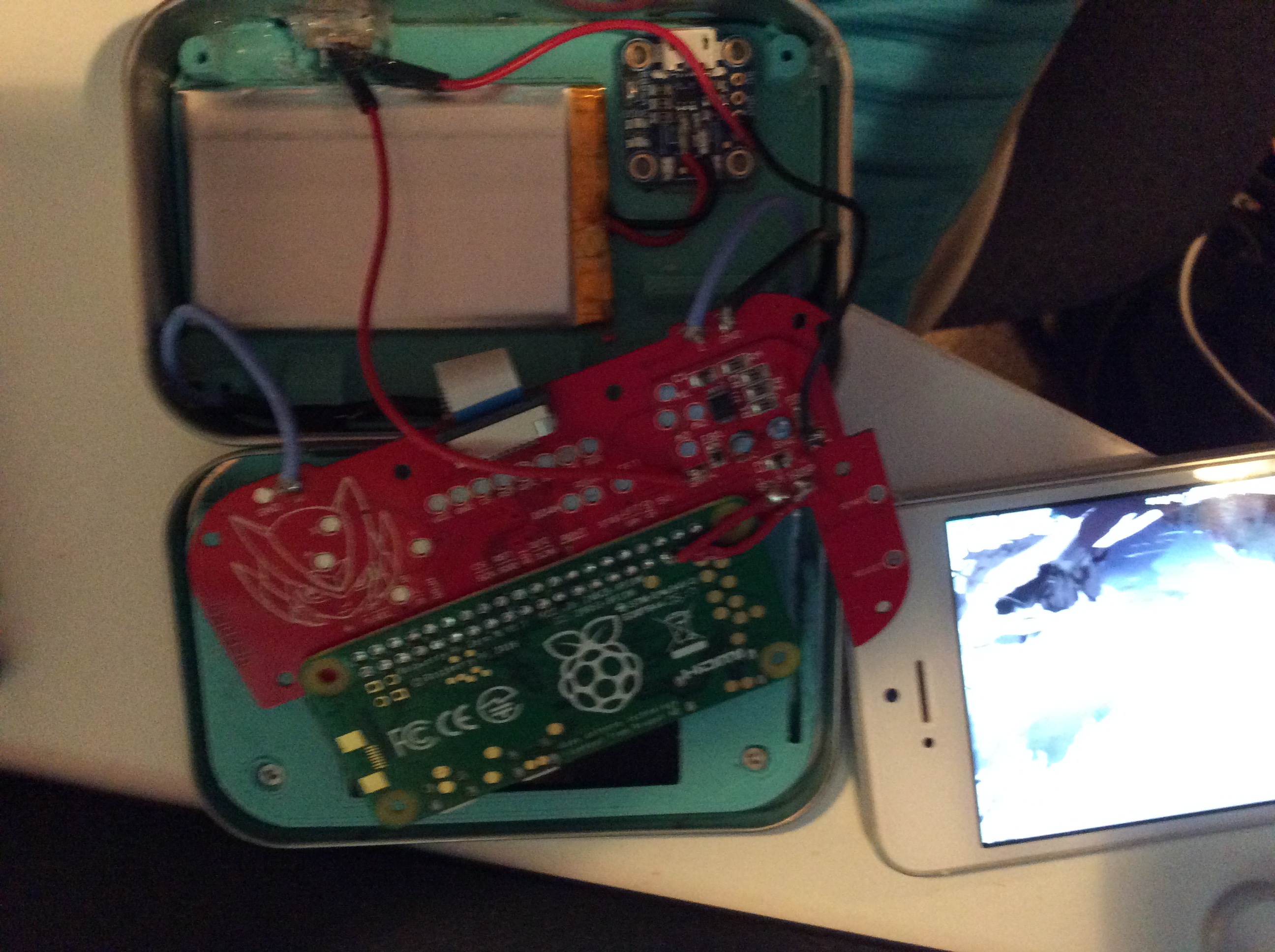

Post by peeweejedi » Thu Aug 24, 2017 6:11 am
here is the photo
IMG_0322 (1).JPG (921.07 KiB) Viewed 8482 times
Re: pi problems
Post by rodocop » Thu Aug 24, 2017 8:31 am
Hard to tell from the picture. Have you tested continuity between the GPIO pins and the corresponding test pads, I would start there. Likely an issue with bad continuity between the GND, 3.3v VCC and/or 5v VCC pads.
Does the pi actually power on? But the screen doesn't? Did the screen work before at some point? You could also check the screen ribbons connector connections. make sure things are seated properly.
Re: pi problems
Post by dryja123 » Thu Aug 24, 2017 8:50 am
I'm not seeing an SD card installed. Could be because the photo is blurry.
Re: pi problems
Post by rodocop » Thu Aug 24, 2017 9:13 am
Definitely need an SD card with the proper image. And yeah, looks like there is not one inserted in the pic.
peeweejedi
Posts: 26
Joined: Wed Aug 09, 2017 5:00 am
Re: pi problems
Post by peeweejedi » Fri Aug 25, 2017 5:10 am
Ecther says it gets corrupted
