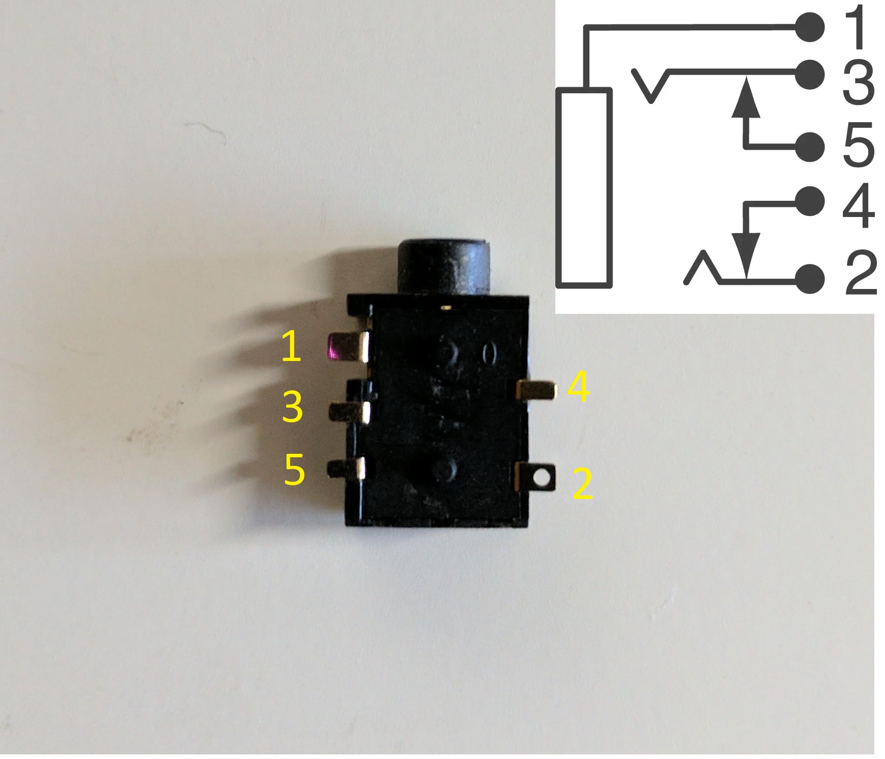

I've linked up the sound card to a switching 5 pin audio jack and attempted to convert the output to mono on the speaker.
I'm guessing this is the pin configuration based off what the manufacturer sent me, though I've never done this before and could be mistaken:
Jack raw Numbered.jpg (324.96 KiB) Viewed 9063 times

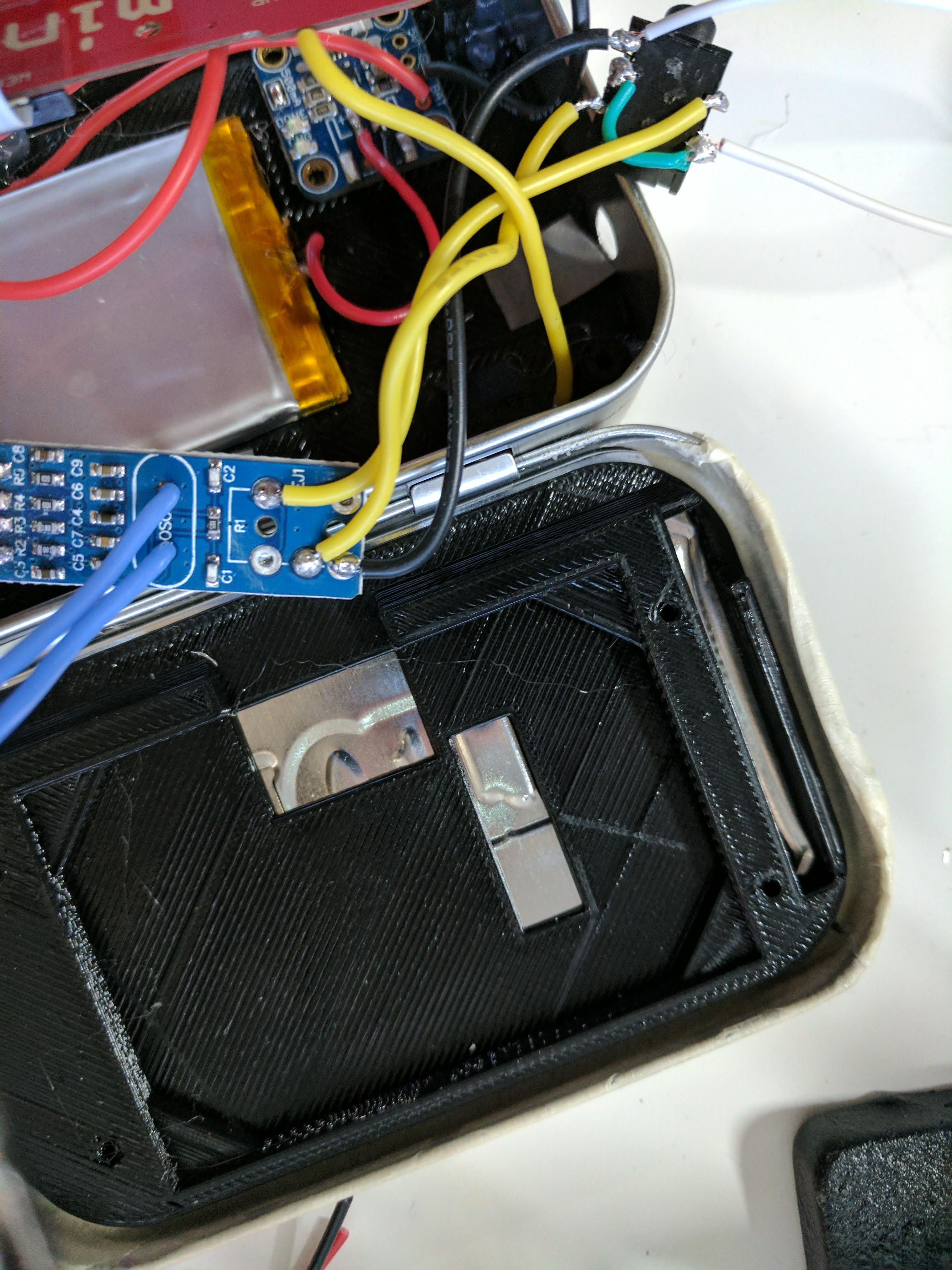

This is what I came up with as a guess on how to wire it:
Here is an image of how I'm wiring it to the sound card:

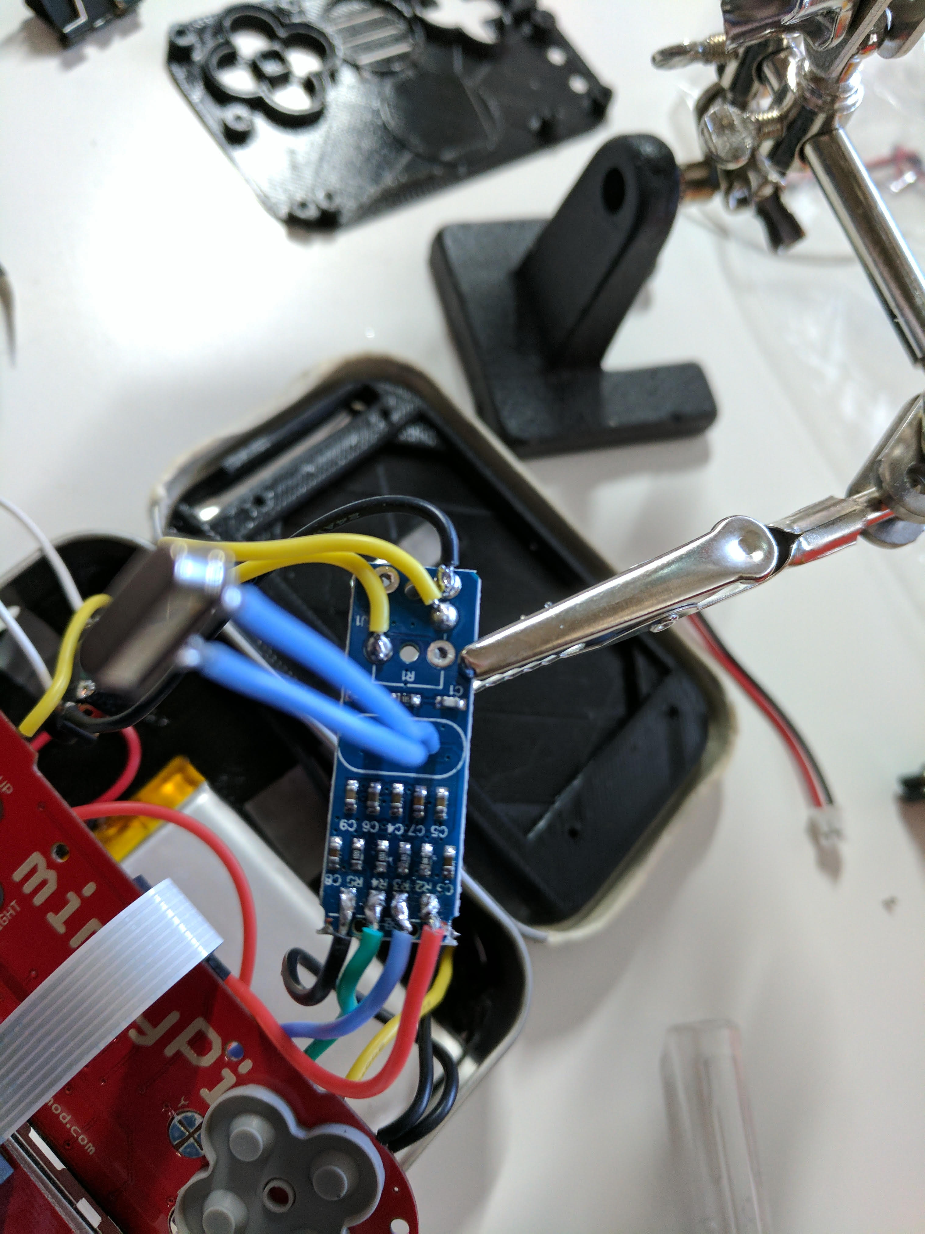

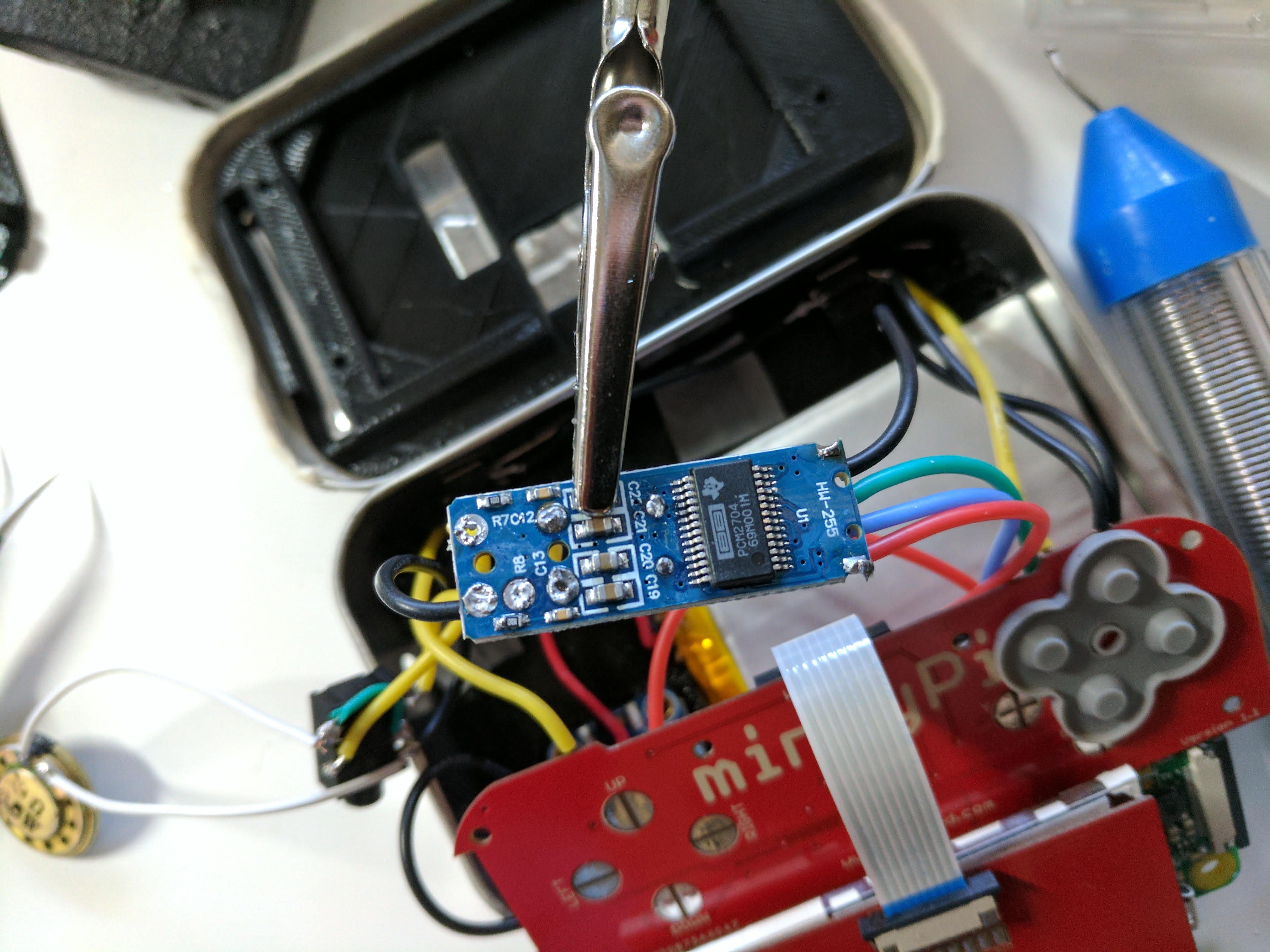

Here is the front of the card and the back of the card:
Front of Card.jpg (749.52 KiB) Viewed 9063 times
Back of Sound Card.jpg (796.19 KiB) Viewed 9063 times

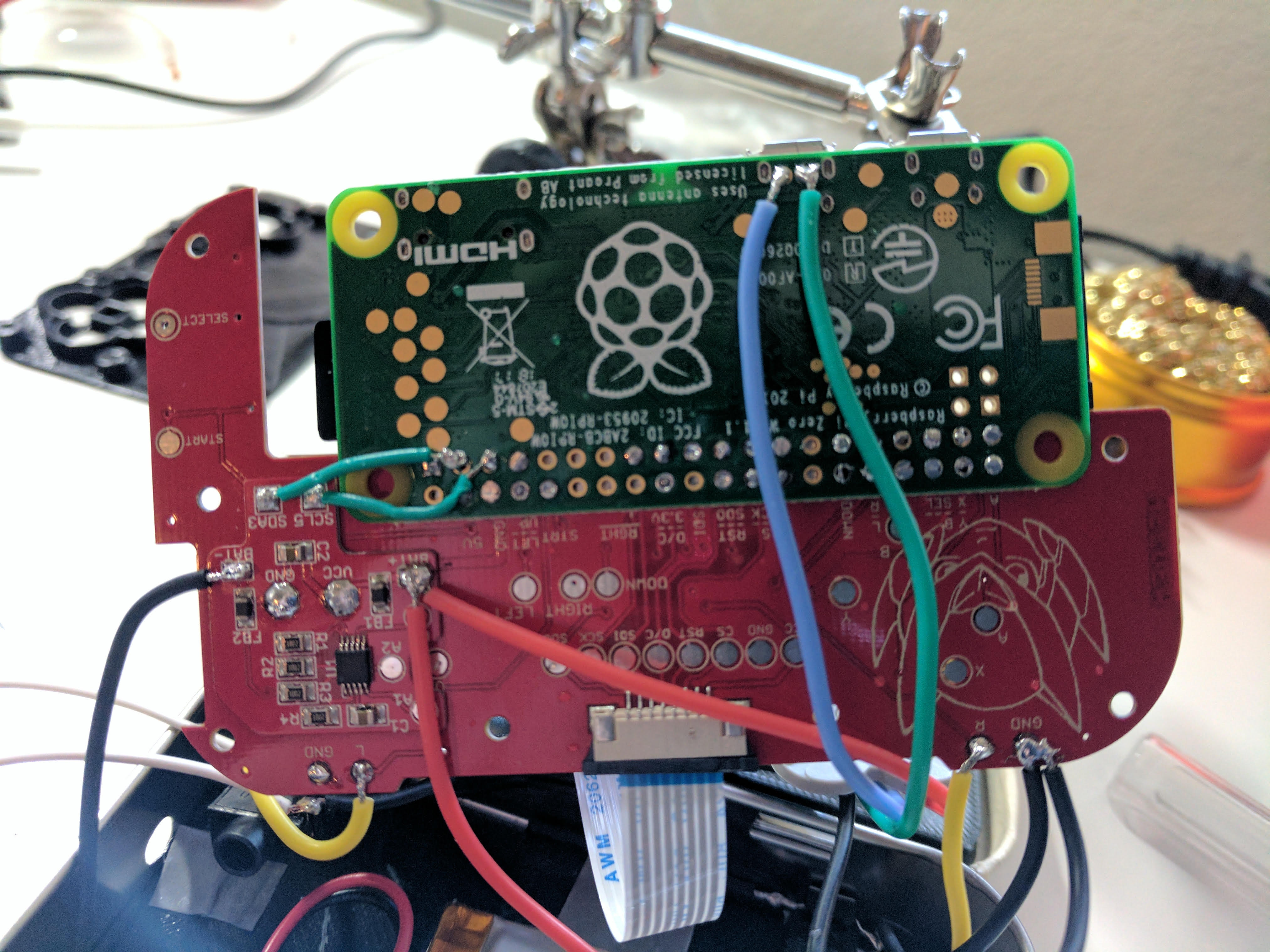

Lastly, here is how I'm wiring everything to the Pi:
Back of Pi.jpg (961.36 KiB) Viewed 9063 times

You're assuming your wiring to the socket is correct but without a datasheet you can only take guesses to what pins are what. I would wire up the GND to the socket then the L/R to their pads and use headphones to see if it's wired right, if not redo them and if it is then play with the speaker connections.

Still no luck on getting it working. I'm starting to think the board is dead or potentially a software issue. I could get dead white noise on the headphones but no real sound. I'm assuming the noise means that power is getting to the board, but maybe not any usable data.
I did some preliminary measurements and this jack should fit (very snug) in the case. I may have to make additional modifications to the 3D printed base if addition of the wires makes it too tall (i.e. cut it off and have the jack resting on the tin). As for Akari_Enderwolf's question, this jack is the SJ1-3515-SMT-TR jack that can be purchased by Digi Key. I think you are correct in that someone else linked it earlier.
Update - I potentially have bridged my data connection. I'm getting connectivity between the data + and data - when they are connected to the pi. Uncertain if that is normal or not. My guess is probably not. Will continue to investigate.
