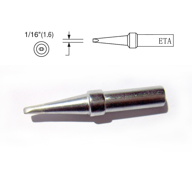

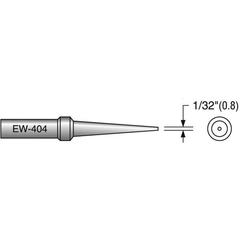

My iron is the Weller WES51 and I switch tips based on what I'm soldering. If I need to get into a GPIO, like in the case of the mintyPi, I use a long fine ETO tip. For everything I use a thicker conical tip like the ETA. I use .021 63/37 solder at 550 - 600 degrees fahrenheit.
ETOShow
ETAShow
Lead-Free-Replacement-tip-for-Weller-ETA-Size-1-6mm-Chisel-Used-with-weller-WESD51-WES51.jpg
Lead-Free-Replacement-tip-for-Weller-ETA-Size-1-6mm-Chisel-Used-with-weller-WESD51-WES51.jpg (143.83 KiB) Viewed 11754 times
Edit: Just wanted to add a little bit on moosepr's recommendation. When soldering wire to the board, like L1 and R1, tin the pad and tin your wire. It really doesn't take much effort to get the solid connection on those pads if you tin everything properly.

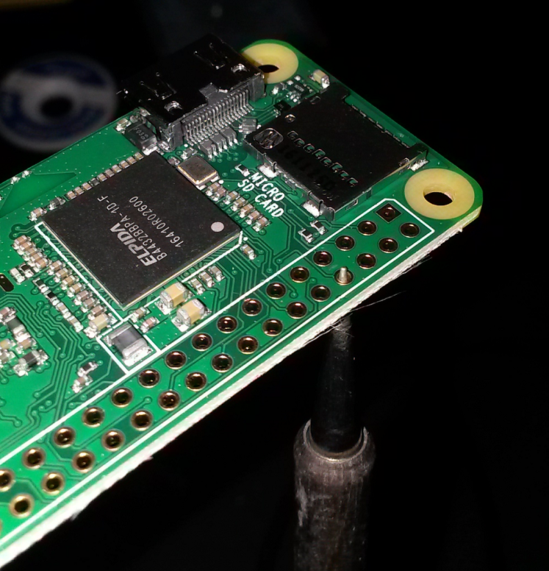

ilike56k
Posts: 8
Joined: Sun Aug 06, 2017 3:33 pm
Re: Proper Soldering Iron Tip to Solder the Pi to PCB
Post by ilike56k » Fri Sep 29, 2017 12:19 am
Thanks, Helder! I'll have to get that tip.
The Tip I used (Which was a T18-BL) works, but has such a fine point that it isn't able to make very fast heat transfer at the very tippy-tip (at the PCB pads themselves).
