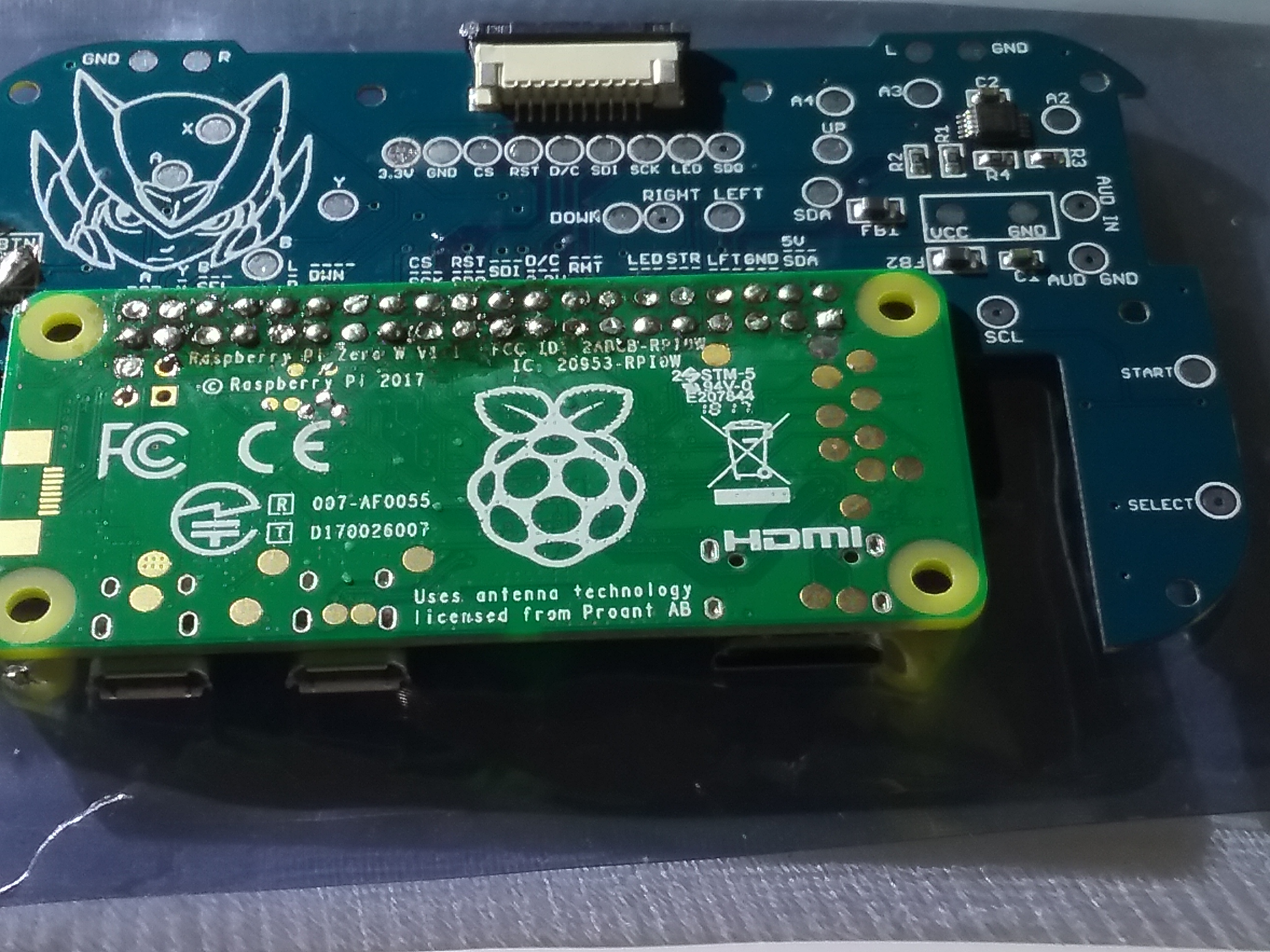

I checked the continuity between the pi and the pcb. I also updated to the newest minty pi image. The screen and the pi work but the screen just shows white. Could someone please help me on this. Thanks.
Re: Screen not working
Post by dryja123 » Sat Nov 04, 2017 9:10 pm
Could you post pictures of your soldering? Also, you have solid continuity on all of your screen GPIO ports? Which version of the PCB Combo are you using?

Post by T DogZ » Sat Nov 04, 2017 9:24 pm
I am using the newest PCB and I do have solid continuity.

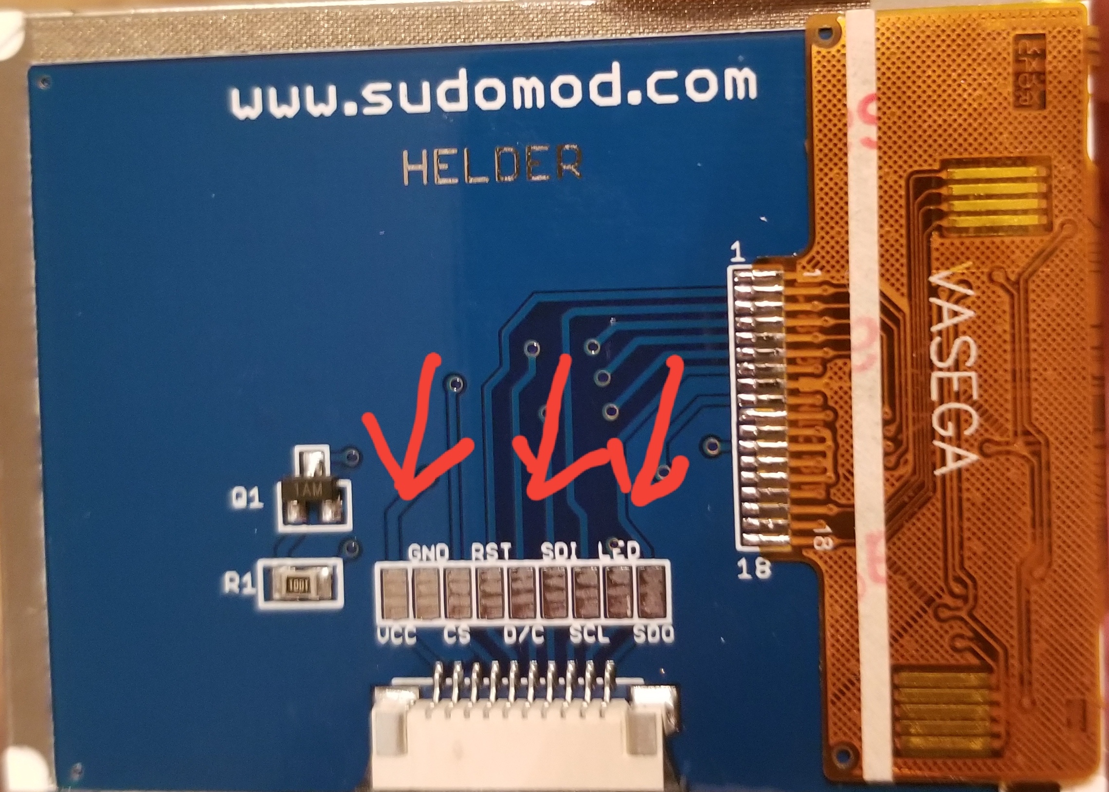

Test continuity from the test pads on the bottom of the ribbon connector to the LCD board test pads.

Post by dryja123 » Sun Nov 05, 2017 4:27 pm
When you have the ribbon that connects the LCD board and the button PCB, you can test continuity from these LCD pads to the test pads on the button PCB

I have the same problem and i tested the pads under the ribbon connector and found that VCC and SCL did not have connection. Is this something i can fix?

Post by rodocop » Thu Dec 21, 2017 7:32 am
daniel_lm98 wrote:
Wed Dec 20, 2017 11:20 pm
Always good practice to re flow the joints to see if you can get continuity on those specific points. If you cannot get continuity you can add a jumper wire from the pi's GPIO's to the test pads on the main PCB.
