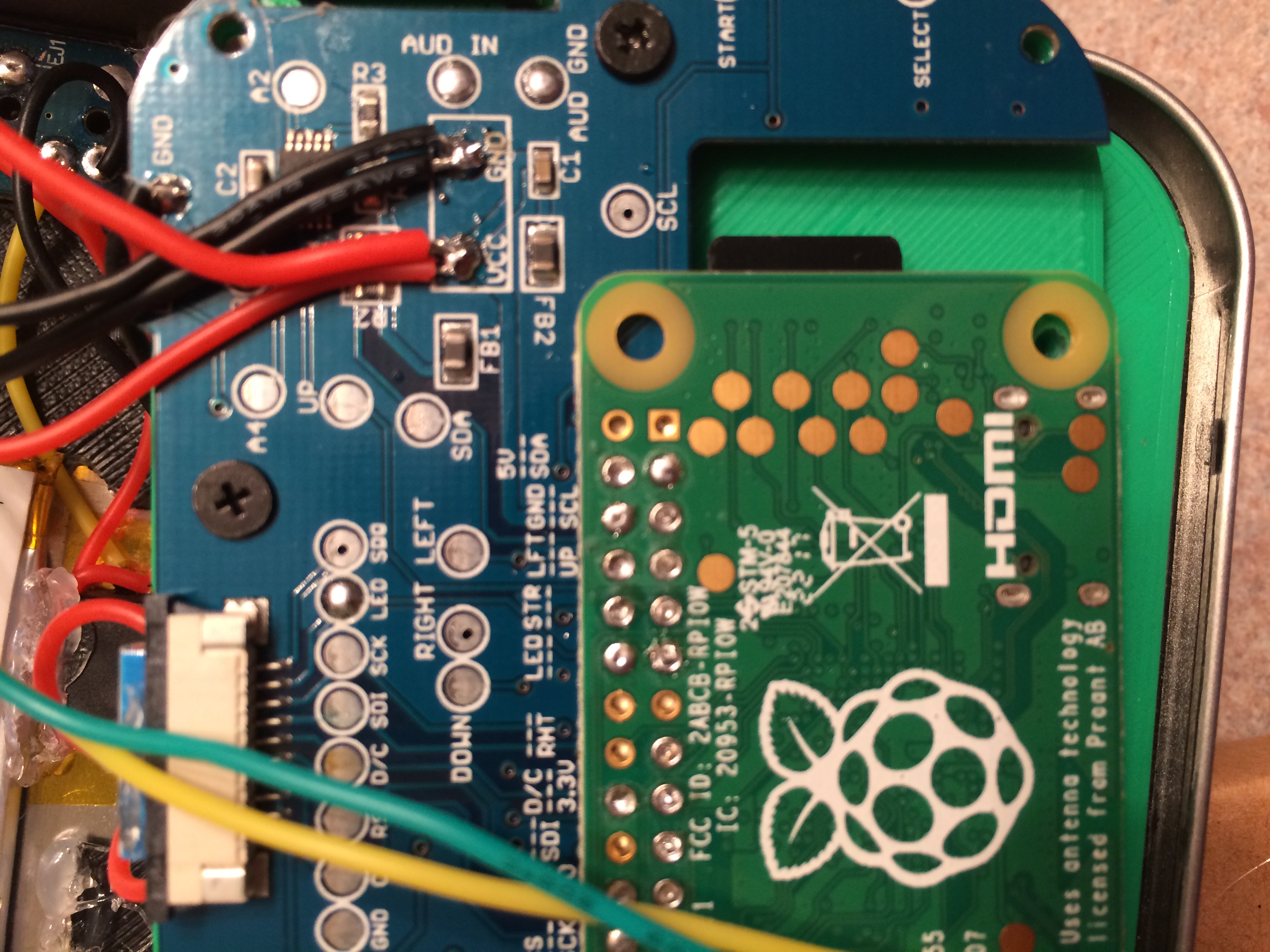

Here’s a pic I got:
Everything checks out with my multimeter’s continuity tester.
I forget to take a pic of my mode gpio but it’s the one to the left of the CS pin

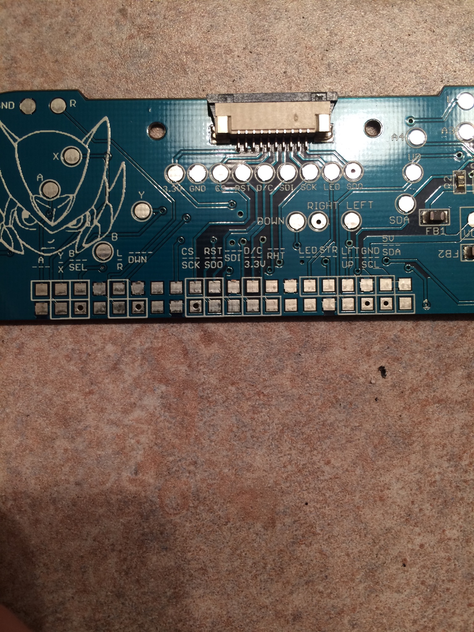

Just found this on my phone... I think I was supposed to solder the pin on the bottom row all the way to the right. I’ll try that and post results
Update: it did nothing

Why are you sure, that this is a hardware issue? Did you check the script, which Displays the overlay? This evening I will check the sources to point you to the right folder.
Re: Battery monitor not showing
Post by Helder » Sun Feb 11, 2018 9:46 am
Also check continuity for the SDA and SCL to GND and possibly VCC since it's close by, you might have a short.
