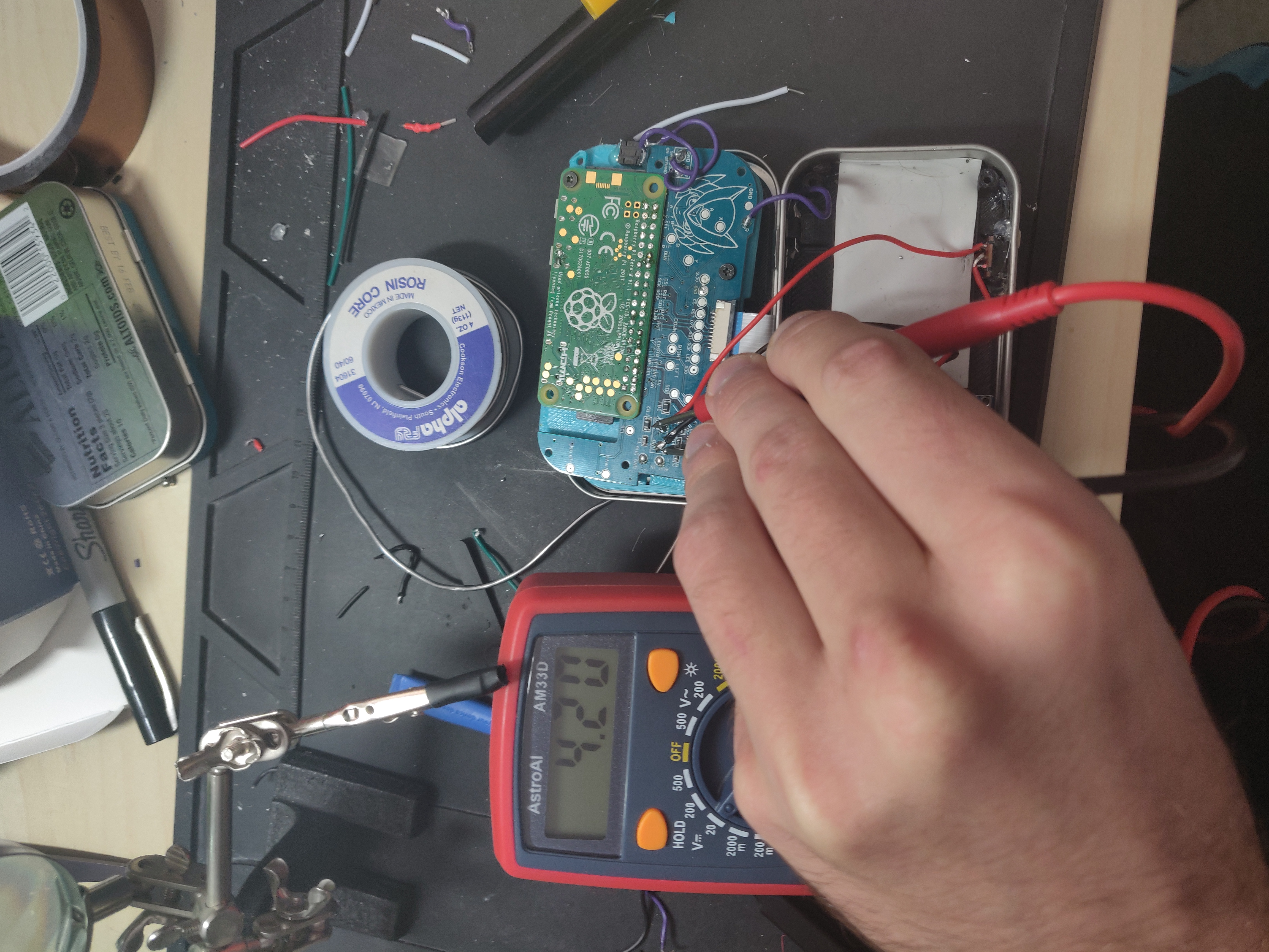

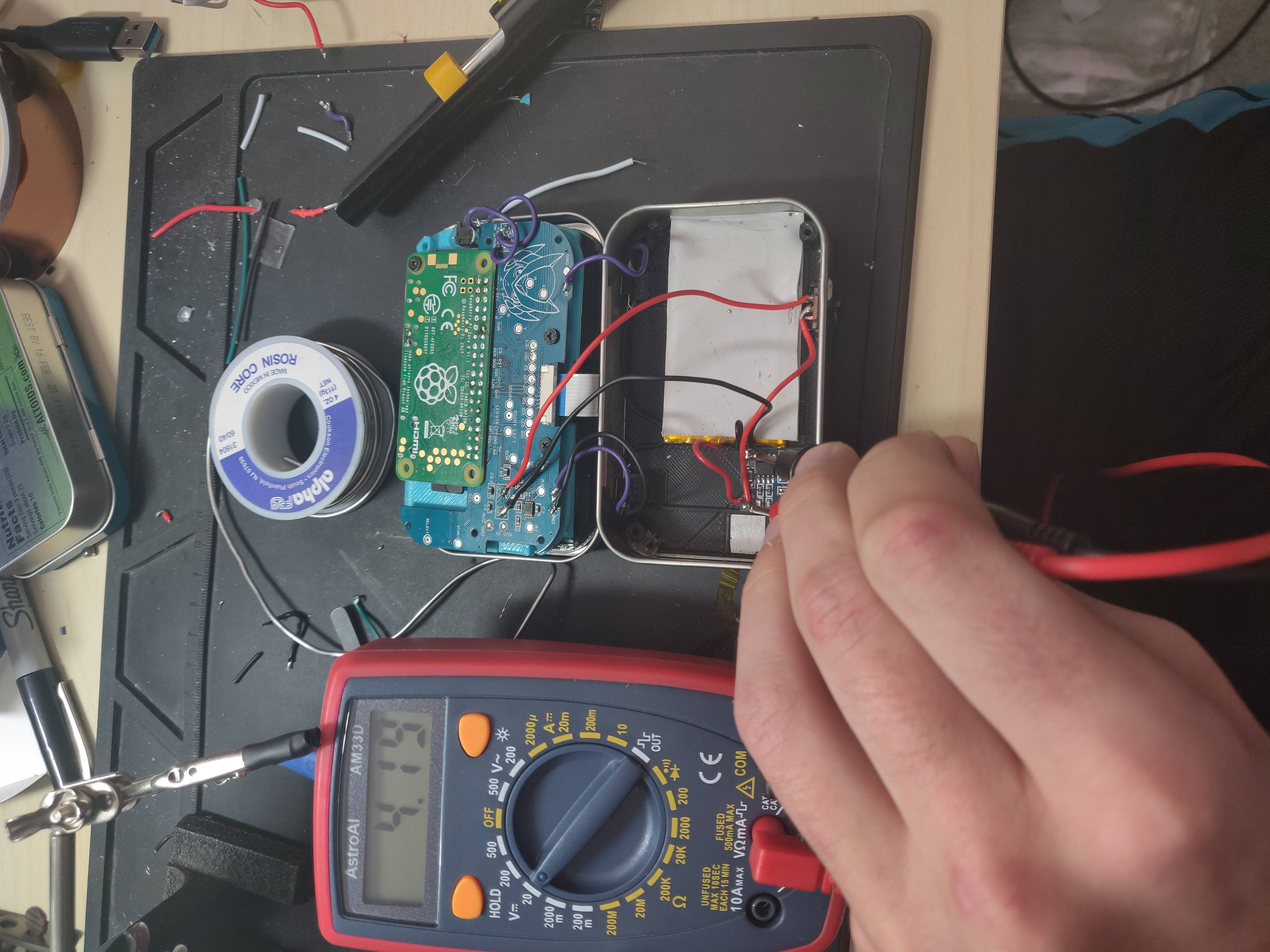

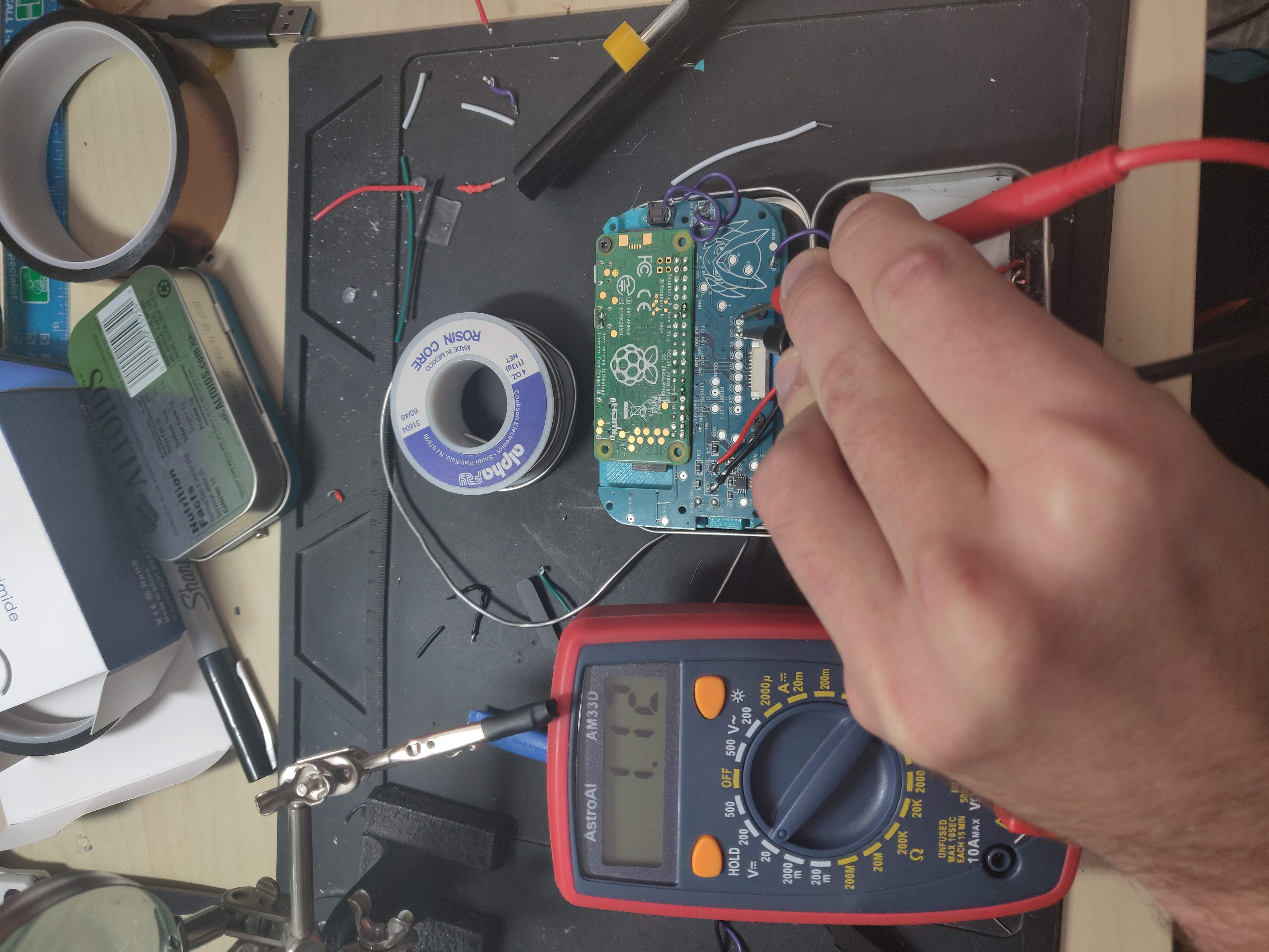

Post by Bluebomber » Sun Nov 18, 2018 11:50 am
Here are some images of my multimeter readings. I should also note that I did replace the charger board but sadly did not make a difference
