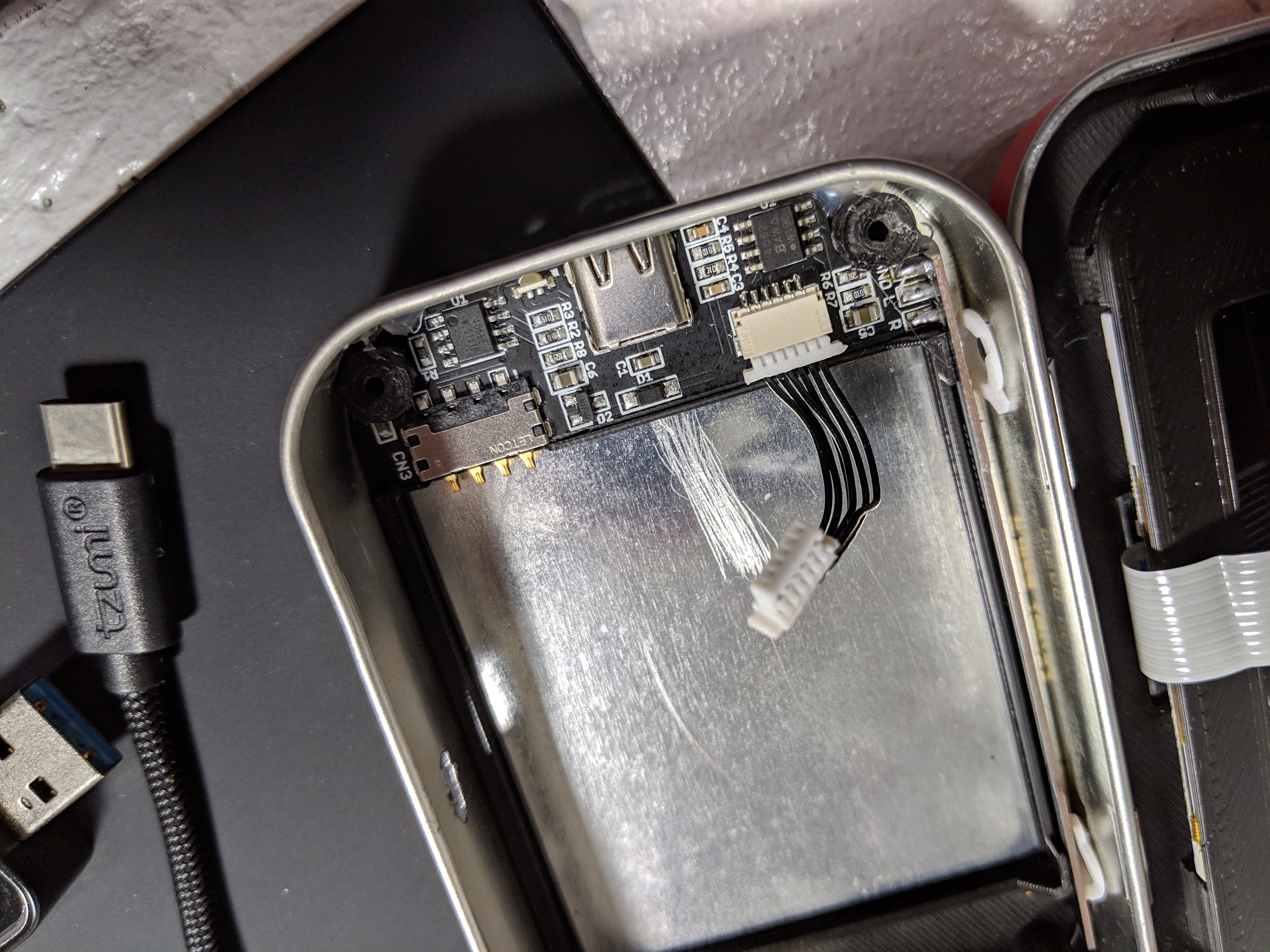

2 I have a new power board, that has all the fixes already
New power board

Well that is a fixed board and has the correct mosfet chip so that is good.

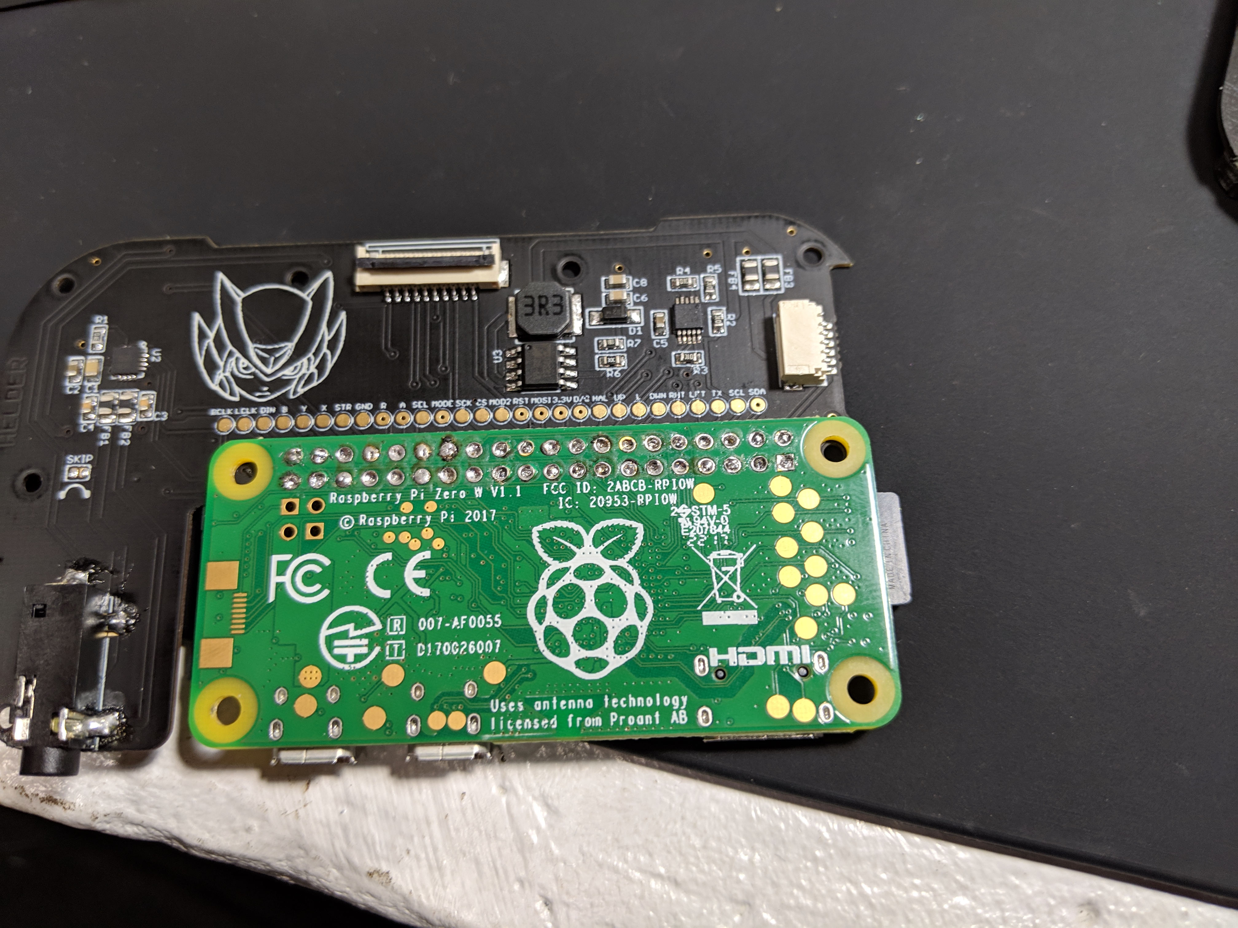

Have you check for continuity between the pins on the pi? I am currently repairing one where there are bridges under the Pi that is making it do the same thing of getting very hot very quick. With the Pi soldered on, the only 2 pins that should have continuity are the upper right pins outlined in red in the image below.
Can we see a picture of the controller board? The back side (opposite side of what the buttons are on) of the board is what I am more interested in.

I checked everything before firing it up the first time and everything was good. But who knows maybe a couple cycles heated things up. Well you are absolutely correct And funny enough when I looked at it I was like I thought I had more in there. It's actually all over the place continuities are are bad. It's crazy I clamped everything down and took my time.

It happens. I am pretty sure Wermy goes through it in the build video but it is very important to check between GPIO pins as well to make sure nothing is bridged or bad things could happen. I will probably make a short video of how I do it just to give people an idea.
