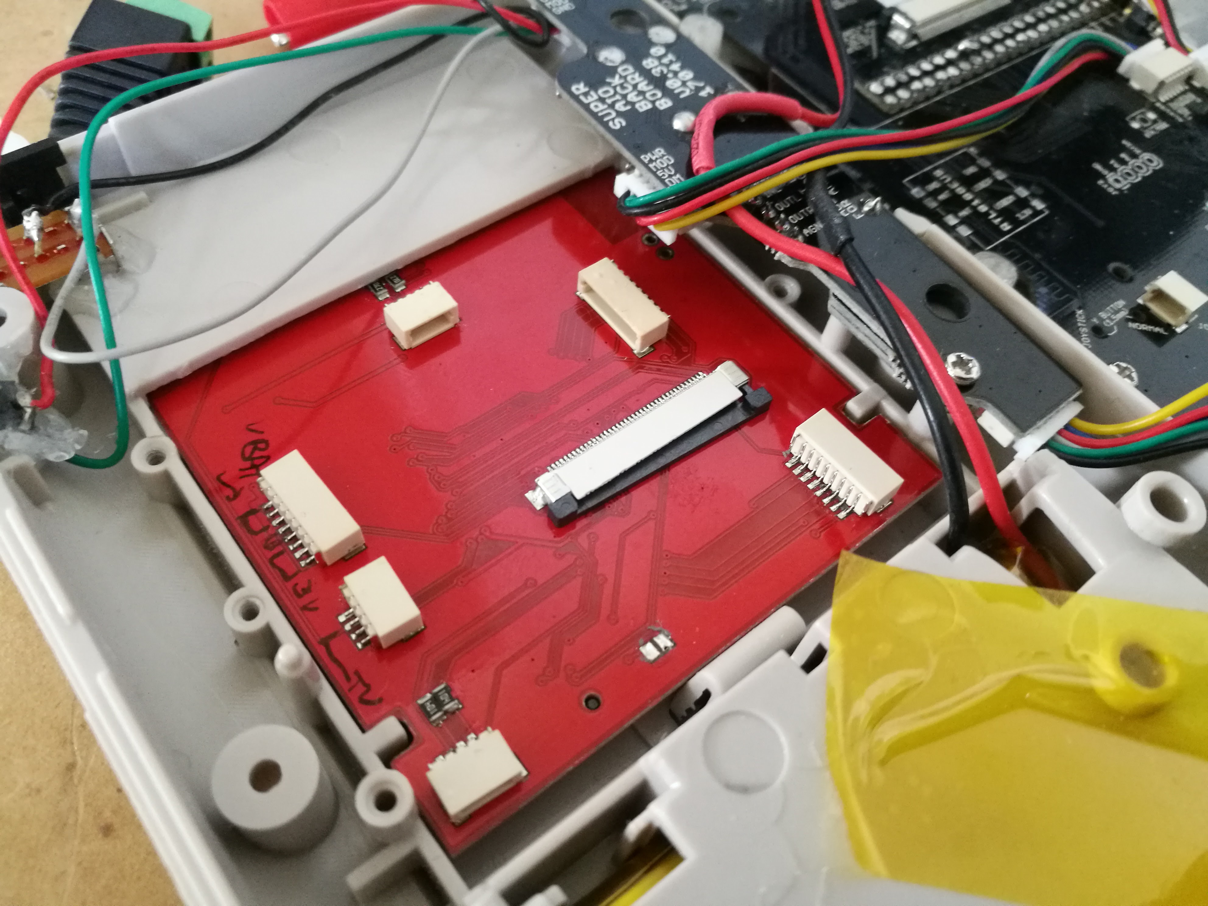

I've got my boards in! I assembled them yesterday and they look really nice. My silkscreen didn't end up on the board due to some file back and forth I was doing with the manufacturer, but I made it by.
Some of the little bits were hard to get proper connections with by hand, even with a hot air gun. I ended up taking about 1 hour testing all 200 pins two by two along the SODIMM connector.
My intention was to provide a solder bridge that skipped the reg if you didn't need it, but the way I routed my 1v8 reg is that if the 3v3reg wasn't there it wasn't getting any power. That's why it's completely removed in the picture here. On a Helder build you'll need it and on a SAIO build it's unnecessary. On a SAIO build you'll route both 5v and 3v3.
I'm really happy with the form factor of this guy. It fits in just perfectly and slides in the back with all the components on. All the cables are much more nicely routed inside, and the FPC cable is especially happier. You'll notice that it's all JST cable connections now and no more soldering holes. The exception to that is the Wi-Fi USB data lines if you're running a Helder build.

The pictures of the red PCB above look like it won't fit on top of the cartridge bay anymore, but has to be put into the cartridge bay. Am I wrong in this?

As I understand from pictures, this board uses all space from cartridge area - so you'll need to cut your cartridge and keep only front and top areas. Check other builds which use RPi3 - almost all of them are in the same way.
@inches, I have one question.
As I already said, your board uses all space from cartridge area, and some space below. Does this mean that I can't use some boards for L&R buttons which usually locate right above battery bay?
