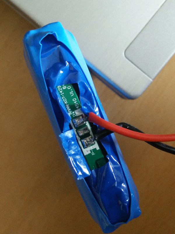

I have an issue where one of the soldered leads for the battery pack came off. I'm fairly new to soldering, is there anything I should be aware of when soldering the lead back on to the pack? I am kind of worried about having a high temperature soldering iron next to a lipo battery, any tips you might have would be useful.

Mine was the same. Actually one wire was completely disconnected when I opened the light. The second is hanging on by a thread. Yeah you have to be super careful soldering next to a lipo. In and out quick smart😉.
I haven't attempted mine yet, but I will soldering it outside.

Yeah I had few reports about a wire getting loose and battery manufacturer and light manufacturer were notified about it to keep an eye on it during battery handling.
The thing isn't all that hard or dangerous to fix since you'll be soldering on protection pcb and not actual battery.
Just take a scalpel or sharpie and cut through blue tape on side where wires come out to expose wire connections and solder it back. You can then cover it back with some kapton tape.
