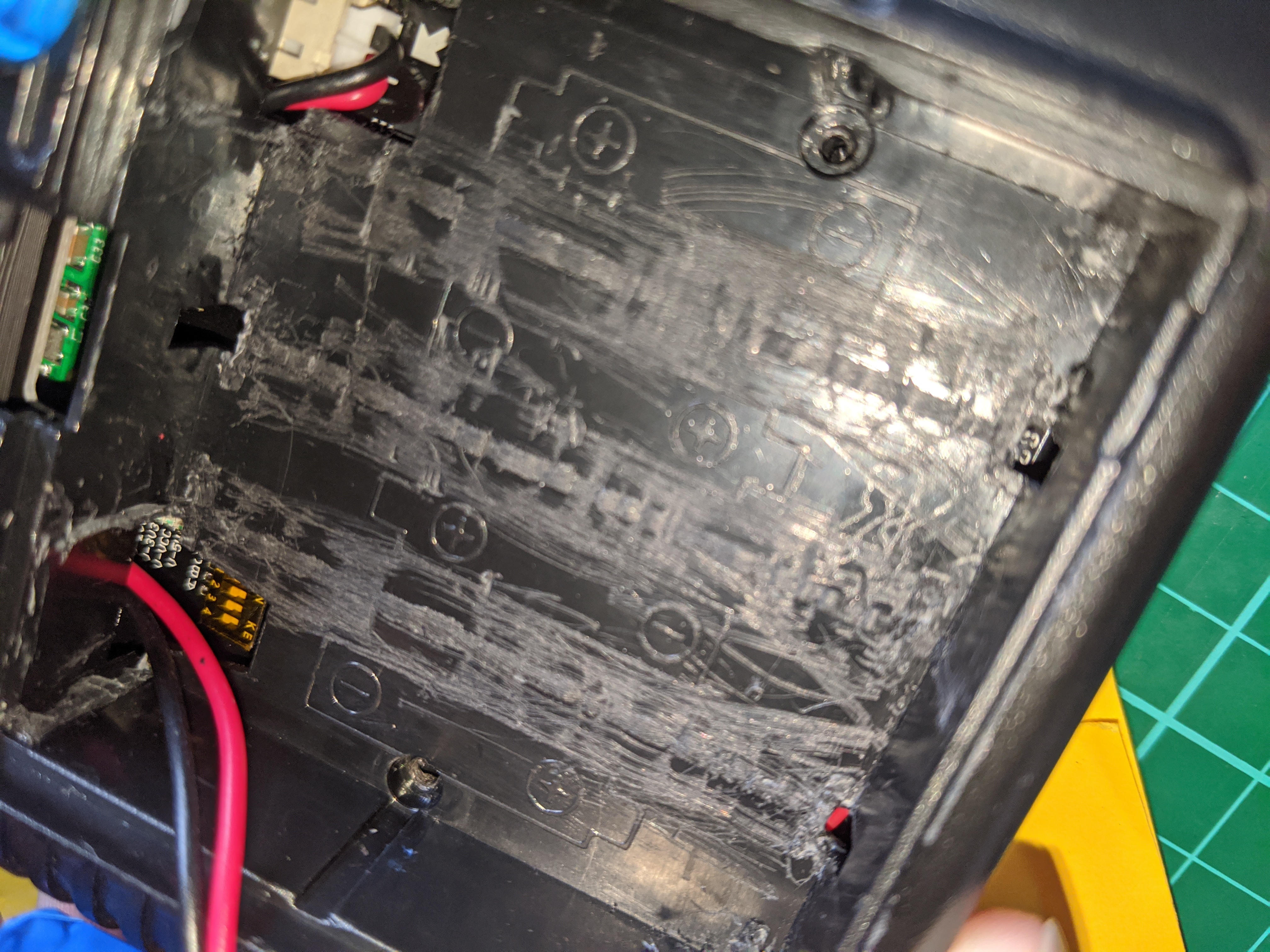

Hi,
I ordered this battery and it's looking great.
I took out the battery separators and such in the compartment but the door won't close
Does the door need shaved back a little ?

SmiddyJR wrote:
Tue May 19, 2020 8:49 am
Hi,
You might have to. Also the wires coming from you battery connector could be a little flatter, it looks like they stick up above the connector. In my build I routed them the same way you have, but I brought mine into the battery compartment a little ways before turning them around to go back out. This way they lay flat.
