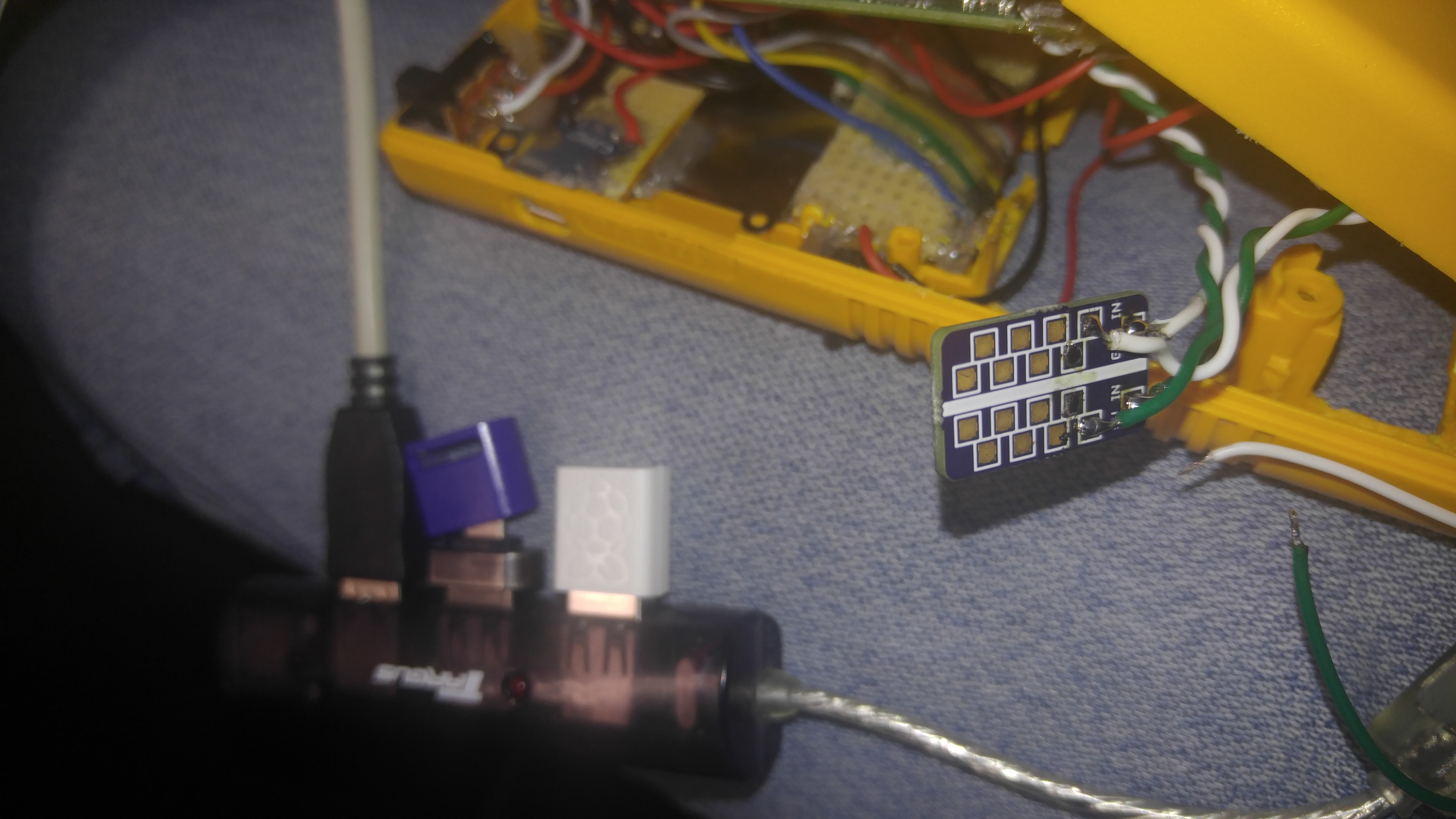

Hey @prerunnerseth I was curious what those other solder pads are for on the "left" side of the pcb? Are they for adding custom components or future addons? Would be cool if a wifi module or antenna would fit inside

Sparx52 wrote:Hey @prerunnerseth I was curious what those other solder pads are for on the "left" side of the pcb? Are they for adding custom components or future addons? Would be cool if a wifi module or antenna would fit inside
They are for adding extra components... whatever you want. In the graphic showing where to wire the Cart connector i show which pins they connect to.

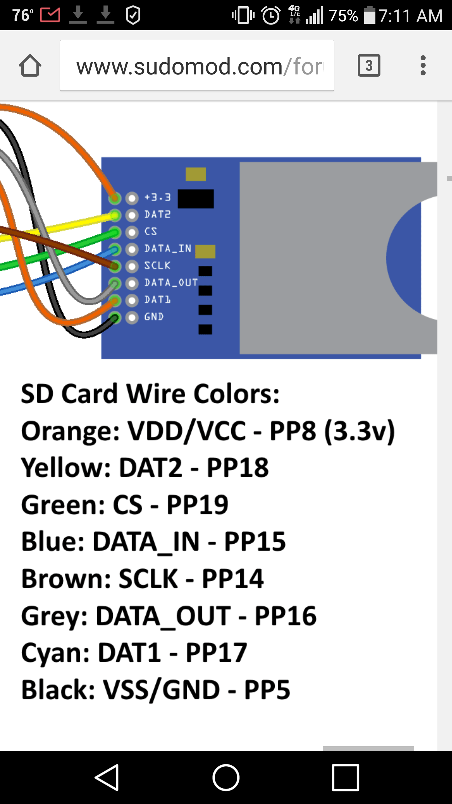

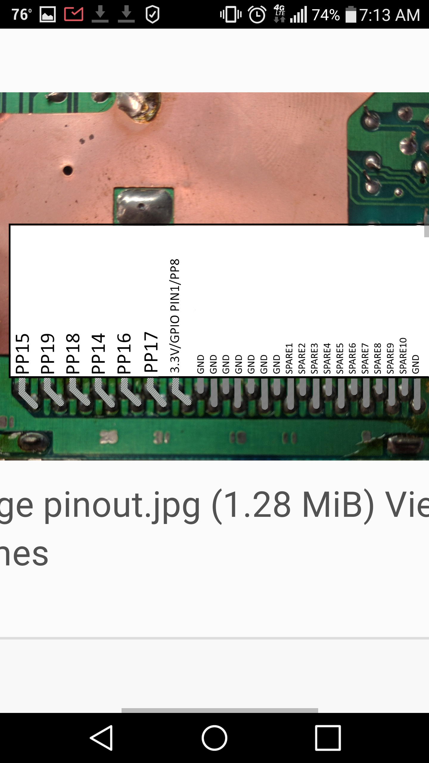

Is there a wiring diagram anywhere on how to connect this to the pi zero via the DS-Lite GBA cartridge reader?

bananaman wrote:Is there a wiring diagram anywhere on how to connect this to the pi zero via the DS-Lite GBA cartridge reader?
[spoiler="this question mark"]Image[/spoiler]

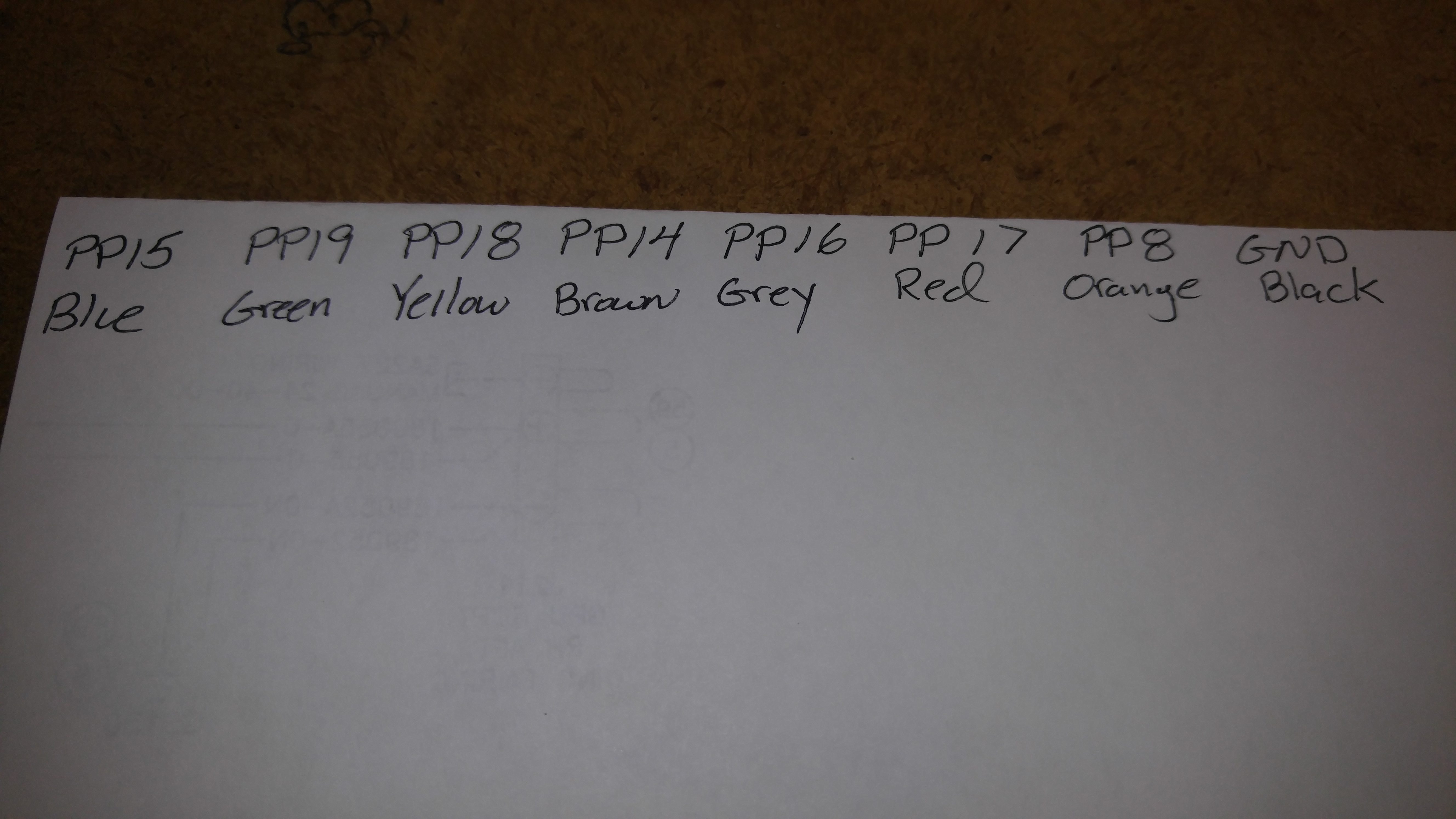

Looking from inside the case the hookup is blue on the last pin on the left(call it pin1), pin 3 green, pin5 yellow, pin7 brown, pin9 grey, pin11 red, pin 13 Orange, pin15 black. Just start on the far left and skip every other pin.
