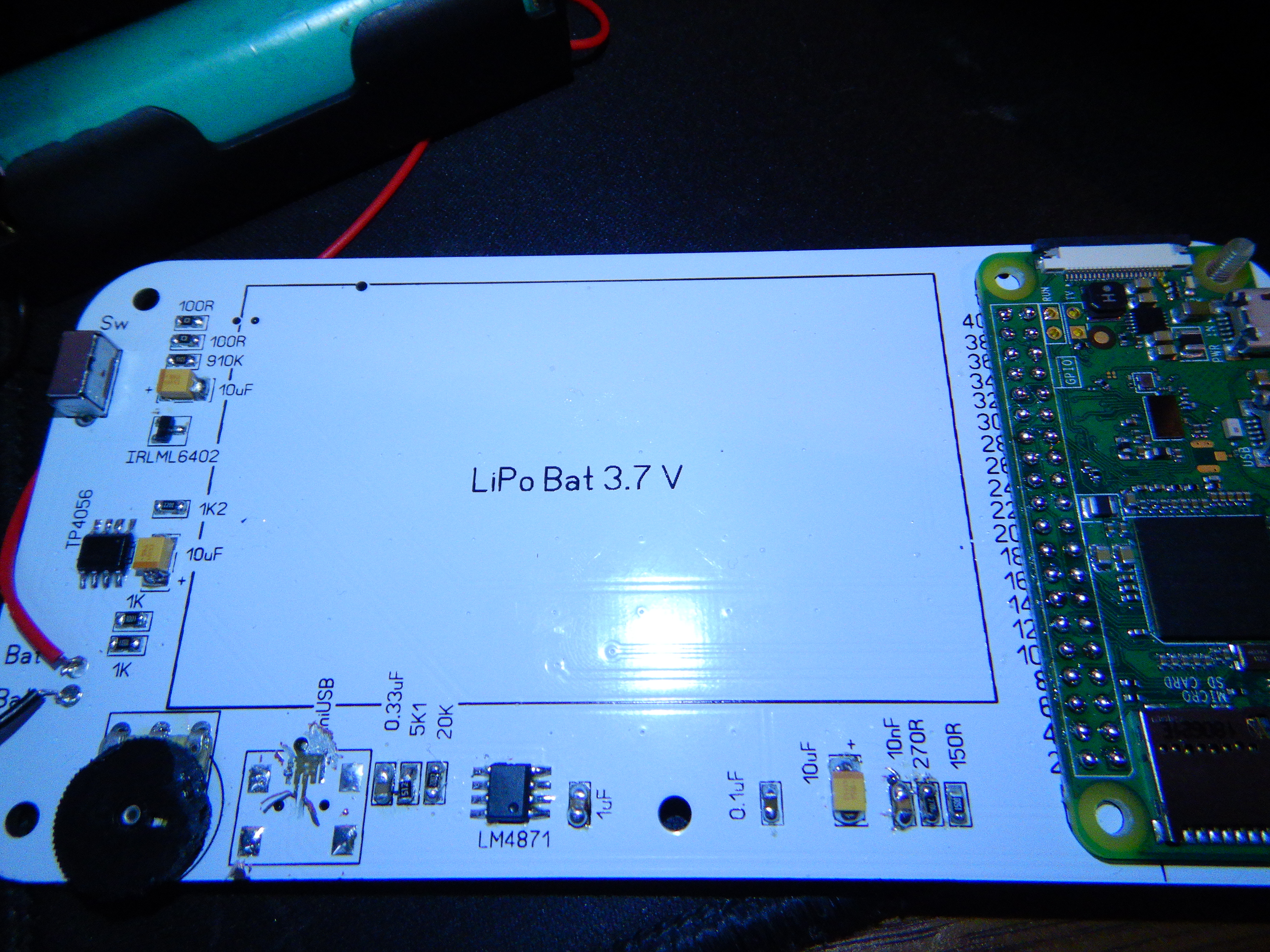

When soldering I messed up the mini USB port. the copper has lifted from the PBC and when I put it on the on position the blue light just blinks and nothing else. I have very basic skills in soldering. The copper has lifted off the PBC in one other place too.

I don’t know how to help you. I can send a new one the PCB. Do not heat the soldering iron above 350С.

You still have the 4 mounting points for the socket so you can still get the socket attached to the board. You've lifted the traces but it looks like there are only 2 of the 5 pins needed. If you follow those traces, they might end at something you can solder to, so you can run wires from the legs of the socket directly to where they need to go. If you can't connect wires directly to their destination, you can scrape off some of the soldermask and solder to the existing traces along that bottom edge.

I never knew that I shouldn't have the temperature above 350, I guess its common sense, but I was using like 480. if I do need a PBC I'm not sure how I will get the raspberry pie out too
