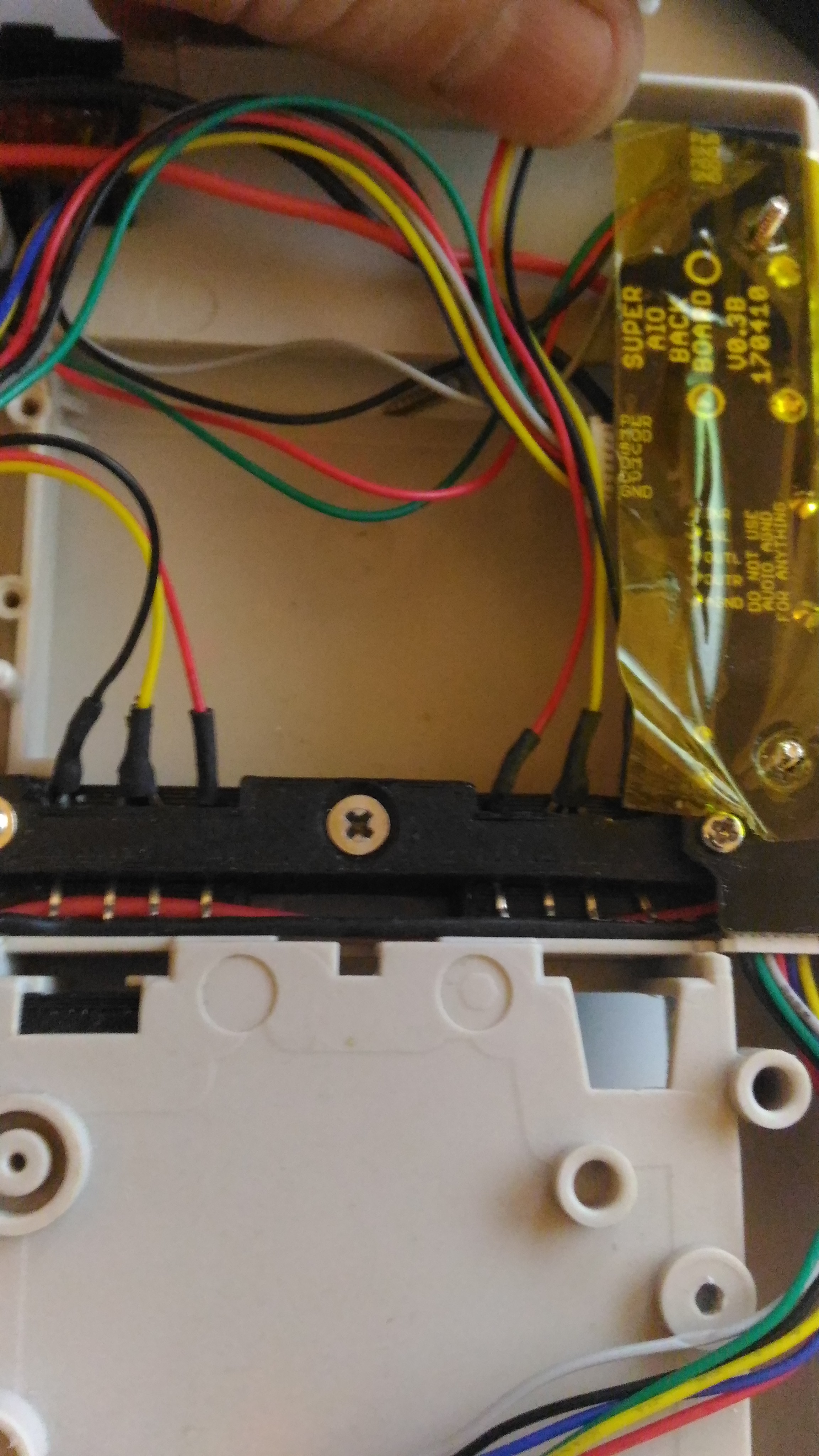

Solder 2 which are closest together and use this as GND :
Hope it helps as because of this I dissasembled ny GBZ :D
