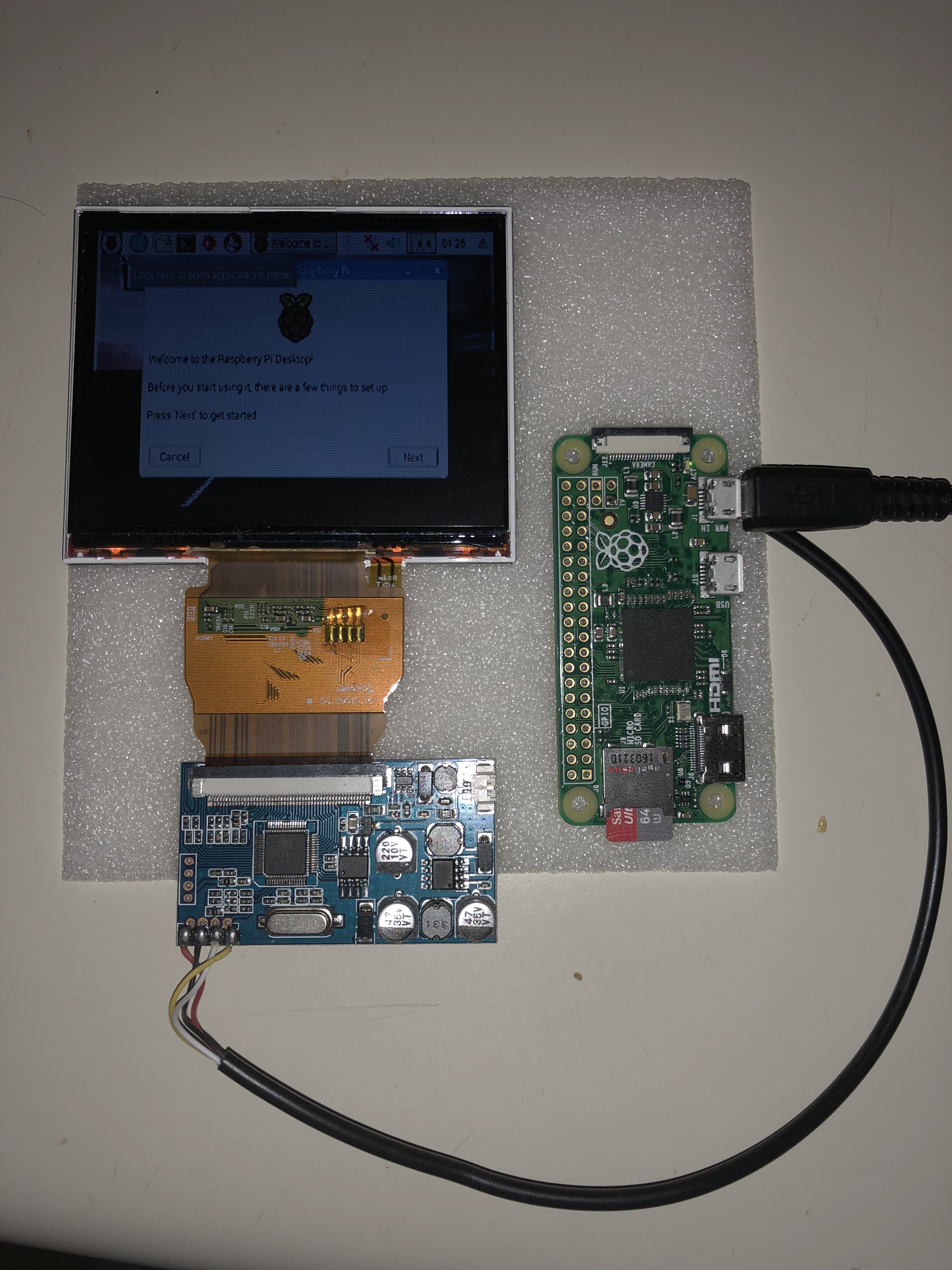

No worries...it must be on my end somewhere. It looks like the board just lights up for a couple seconds - no boot screen with the raspberry. I gave it a good 25 minute wait this last go around and didn't see anything happen. Is that long enough - I know it's a large file? Tried an HDMI image just to see if something would display - only worked with a Raspbian/Retropie OS.
What is the small resistor you mentioned? I haven't seemed to use one of those on other builds. Picture is below of what I am working with, currently just trying to get the image to boot to the screen (USB mouse/keyboard are here but not plugged in if that matters)

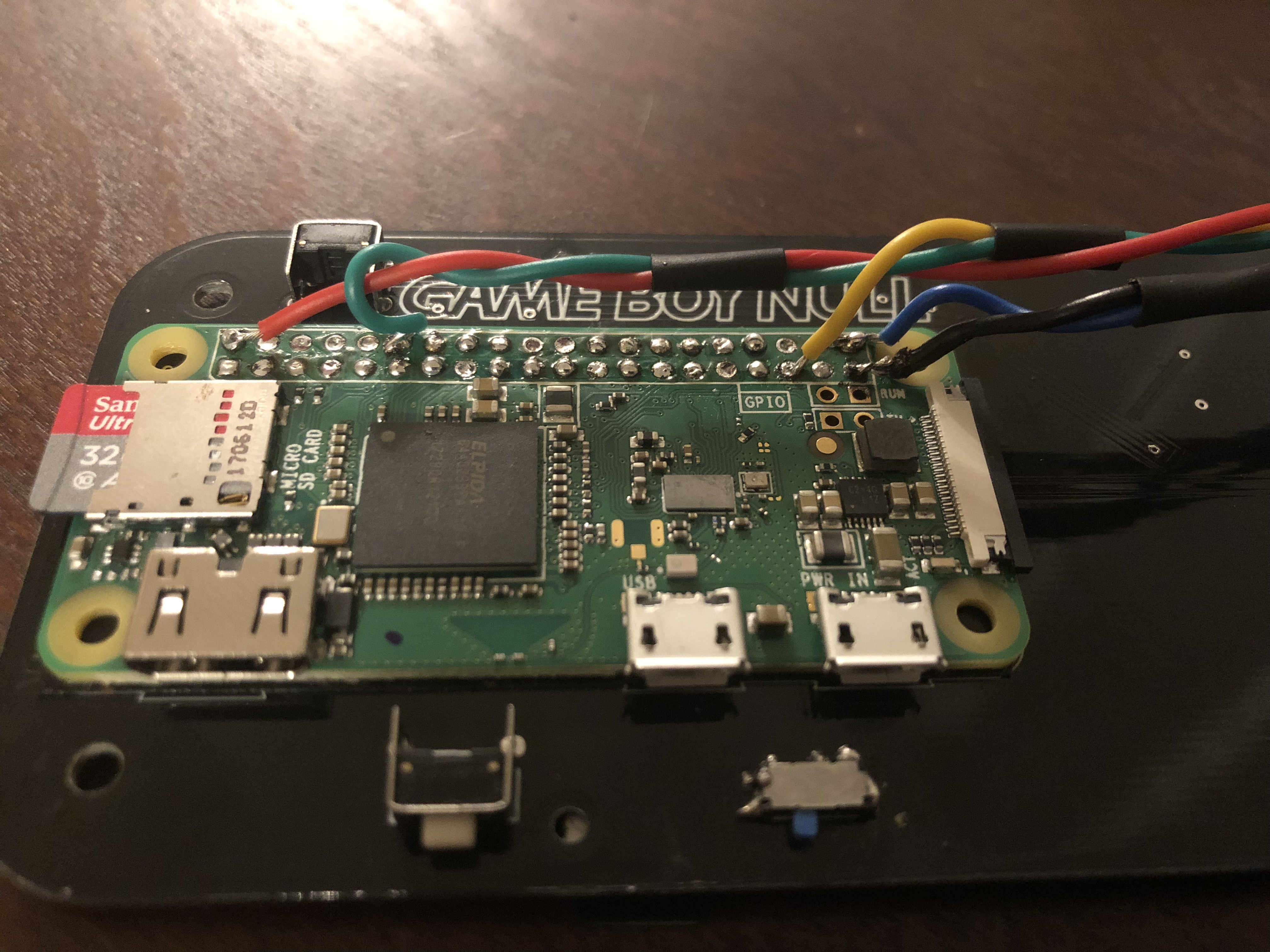

- w/ Raspbian OS
- IMG_5824.jpg (2.64 MiB) Viewed 12925 times
- w/ GBN OS
- image1-2.jpeg (511.76 KiB) Viewed 12925 times
I can always wait for the kit and give a try...just had some free time this weekend and was thinking it through on the audio side
[/quote]
I thought you had an actual built one
That’s the wrong kind of screen. The HDMI port also won’t work. Gb null uses the GPIO to connect to the screen.
There’s a small resistor in the kit that’s needed for the backlight of the screen.

Copy that and thank you! I knew it had to be something simple... I was just going to mess around and confirm that the pi puts out good sound vis I2S amp. I thought it would be nice to have the image already configured so when I got it, I could put the kit together and be playing. Pictures are always worth a thousand words.

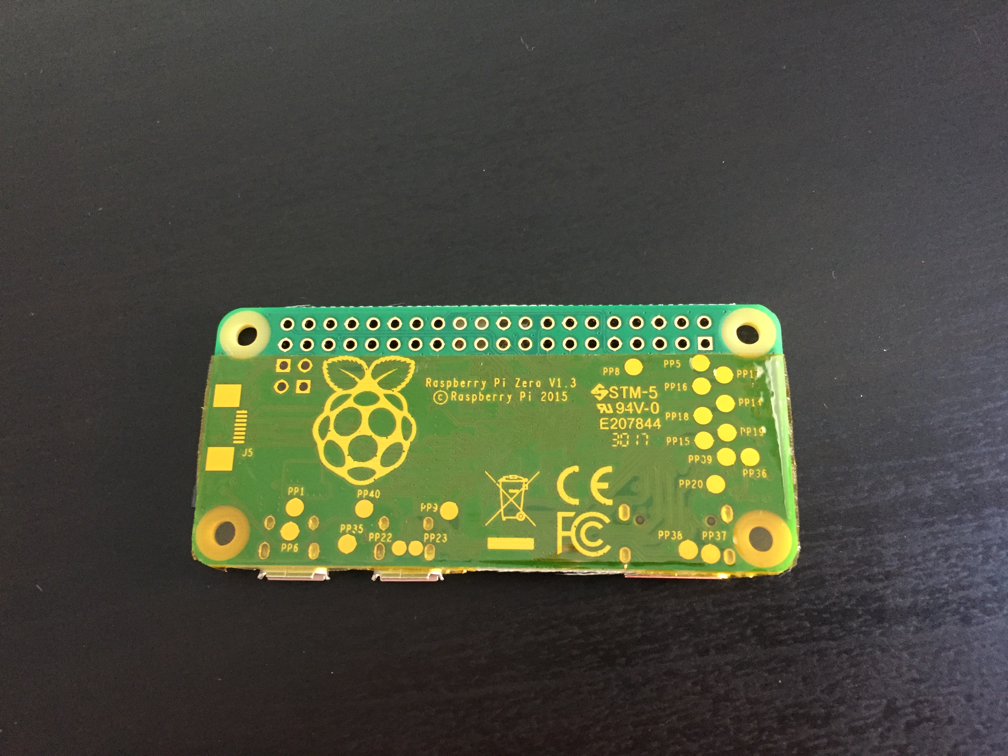

ATTENTION
When making a kit, put kapton tape across the bottom of the Pi to ensure that none of the other pads are connected.

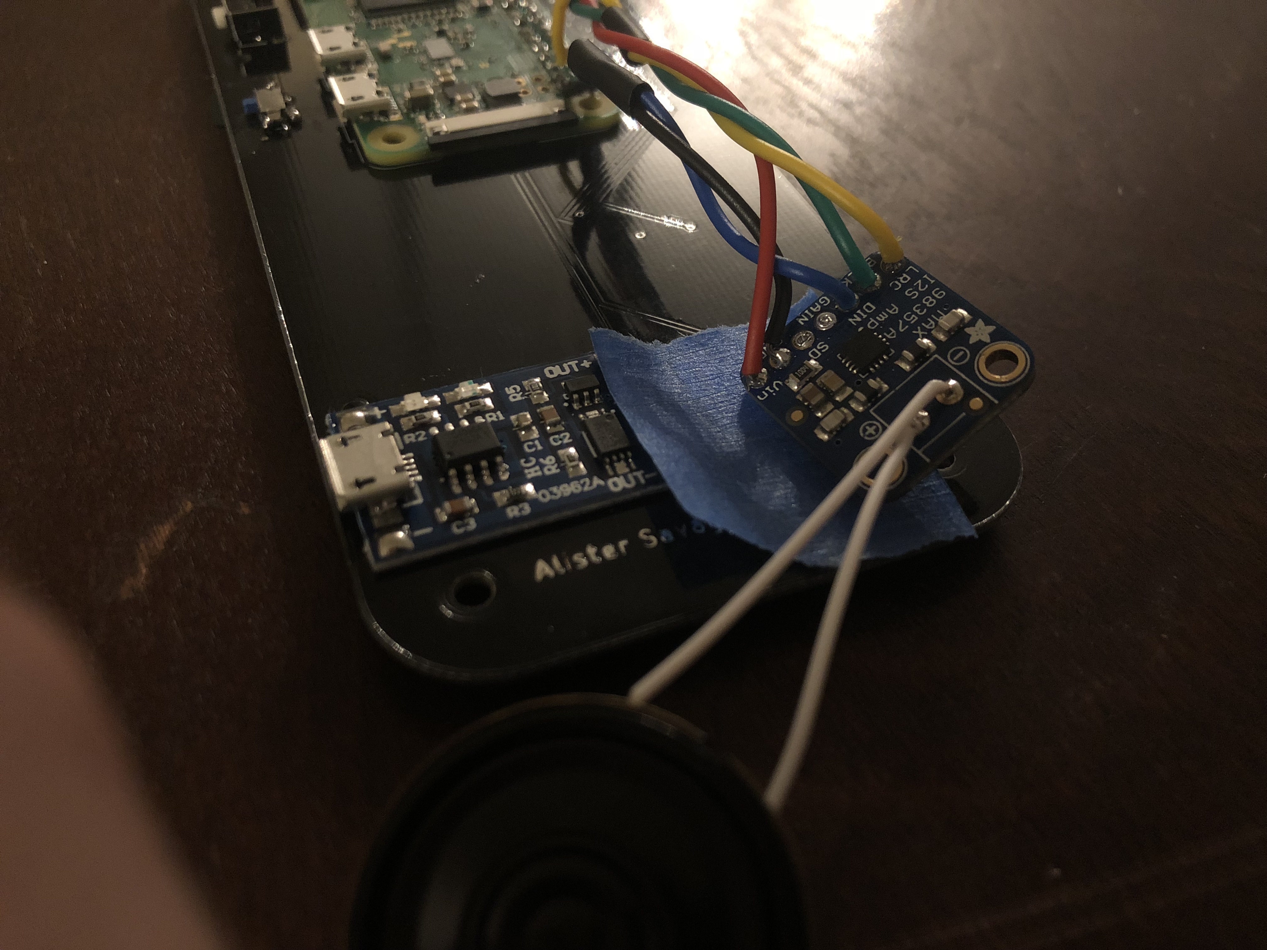

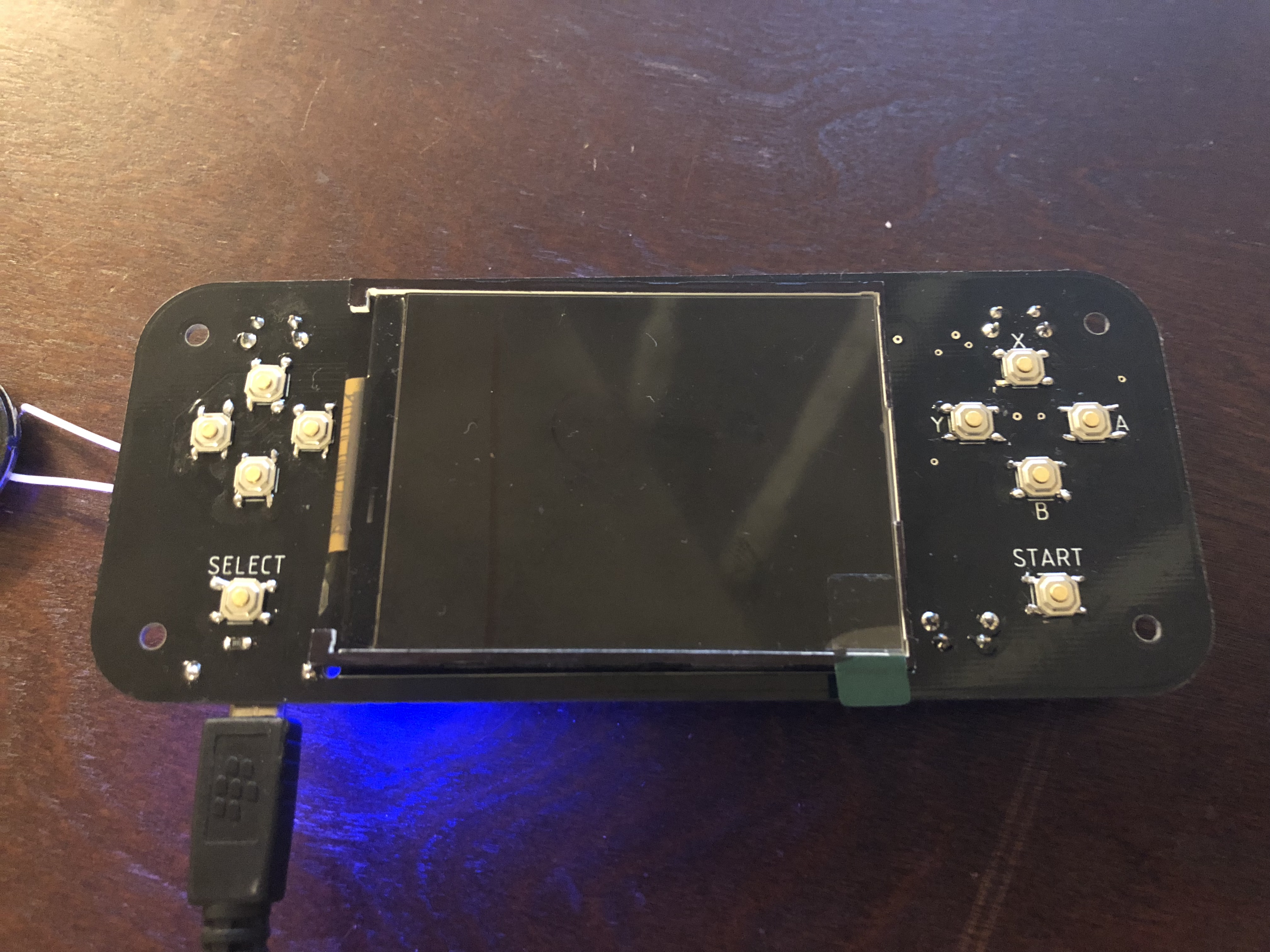

Ampersand...this is one awesome kit! Thank you! I have just 2 things...
1. What is the correct shut down procedure? When I hit the off switch, it does it reboot and not a shut down / power off
2. Sound works like a charm!!!!! I posted a few pics and a quick video below to show how it looks. My plan is to make some really slight modifications to the case and make a little bracket to raise the audio amp off the board. Otherwise...this is going to be an awesome emulator to play!
