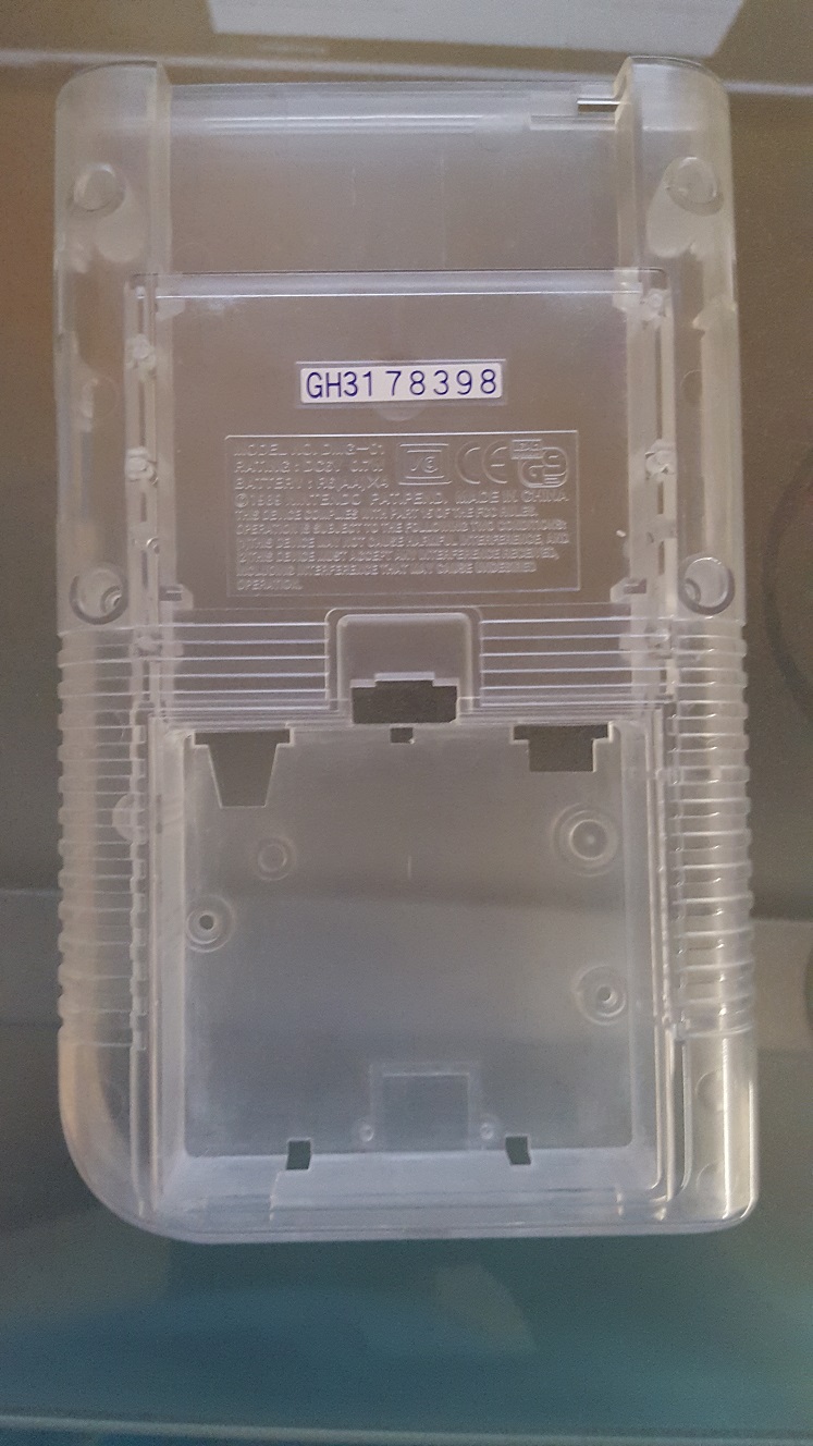

How do you get such clean cuts on the clear shell?
I am working on a transparent green one and am having issues of colour change from the plastic stretching and warping.

Post by KonnorJ » Thu Aug 09, 2018 6:34 am
Kubino uses CNC which is controlled by a machine so cuts are perfect and precise. Try a slower speed on your cutting tool if things are warping sounds like too much friction and heat is being generated.

Post by kubino » Thu Aug 09, 2018 6:49 am
Moonsword wrote:
Thu Aug 09, 2018 6:28 am
in fact it looks super clean only when wet, otherwise its little matt (but still looking very nice). But I believe it can be polished to original look. I'm using feed 800mm/min and around 12000 RPM, should be even nicer with higher RPM or higher feed rate. Still need to experiment here ;-)

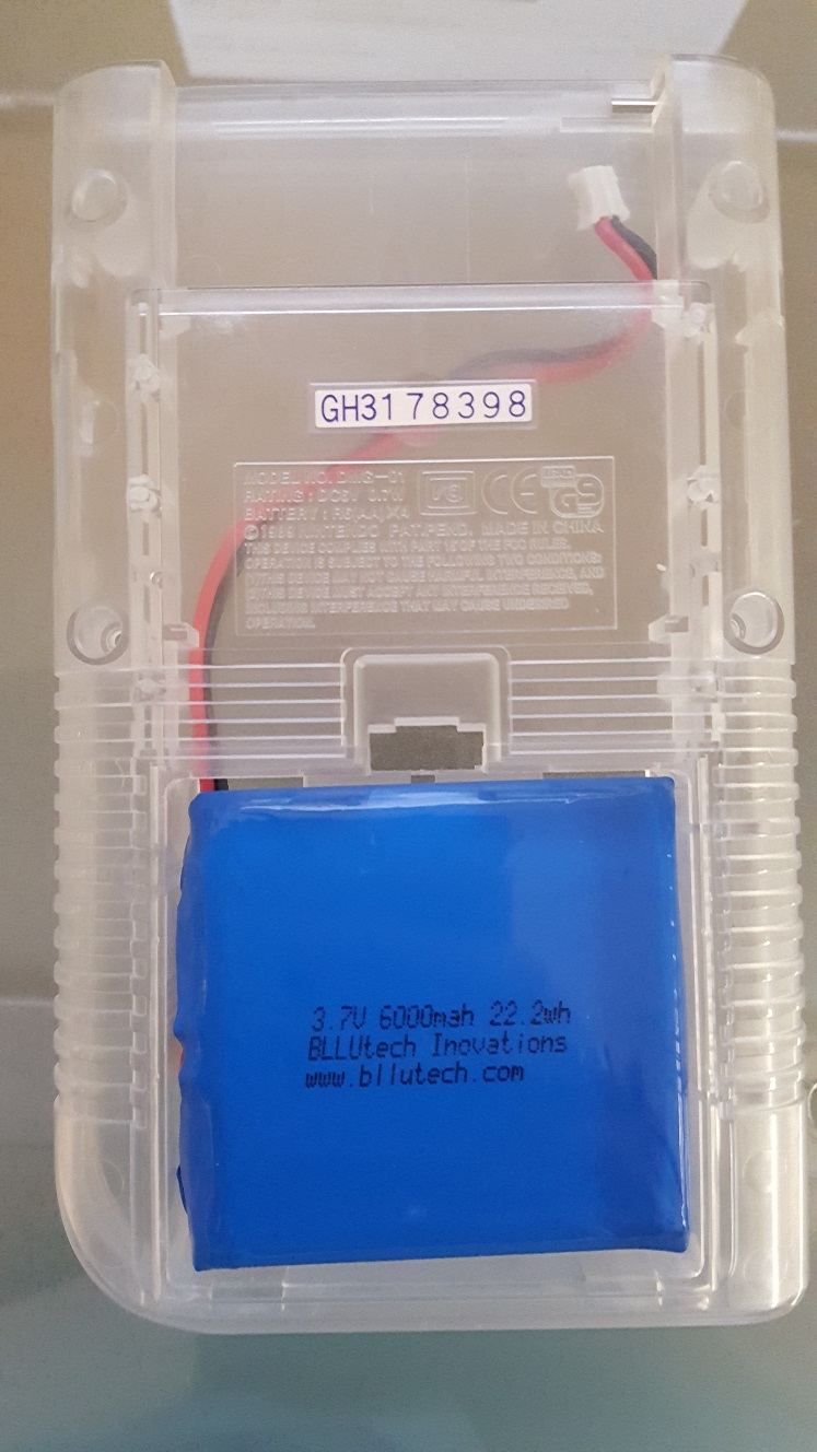

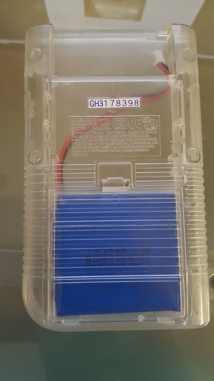

Post by FireFoxGR » Tue Aug 21, 2018 2:41 am
I would like to thank Kubino once again for the help and his amazing work :)
This is the first batch of Dextech's battery (6000mAh) which fits perfectly after the cleanup. The 5200 one's will fit and even have a small gap..

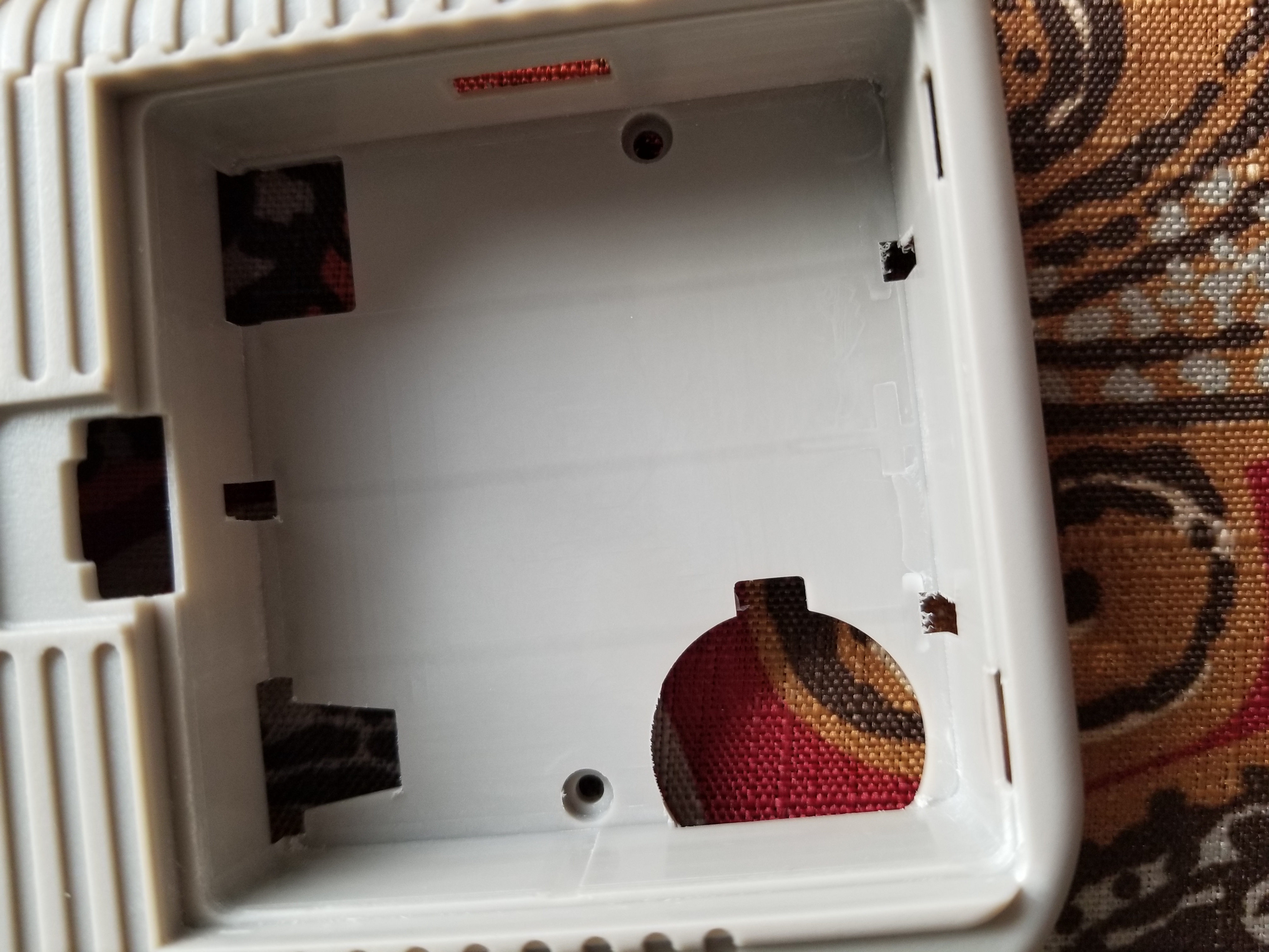

Post by dryja123 » Tue Aug 28, 2018 9:45 am
Brag0n wrote:
Tue Aug 28, 2018 8:24 am
Kubino: Have you tried it on a white or (classic) grey case yet.. if so, what does that look like?
Or does it just look the best on the clear case?
Here's a classic gray that Kubino cut for me. I'm using a 6000mAh battery from Dex and it fits perfectly.
