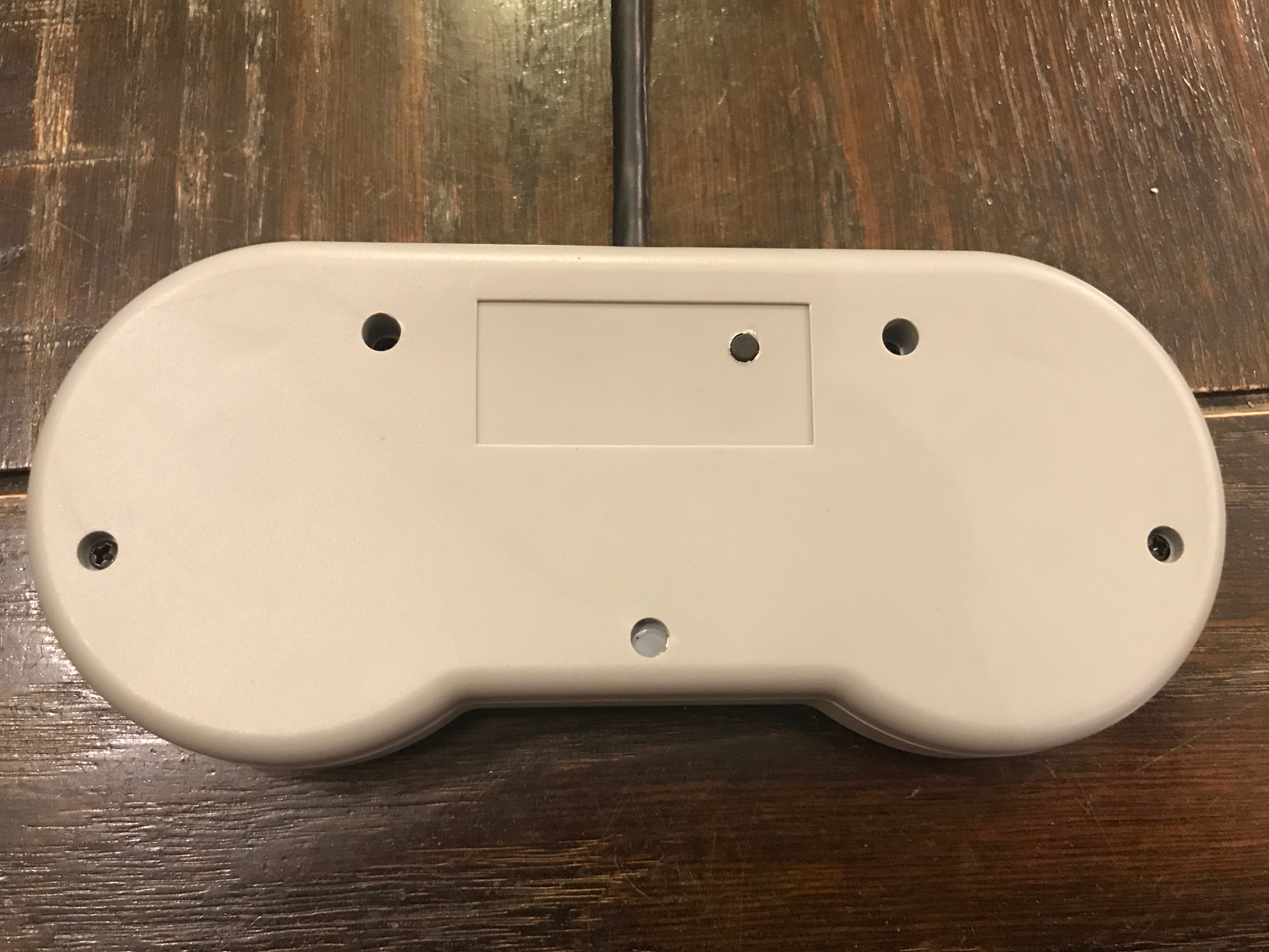

I actually bought a cheap nameless SNES compatible controller. The inside of it is obviously different from the build images but it was very easy to accommodate all of it inside. Had to desolder and resolder new wires for the L and R buttons. They were very different and short for the board, but that was not too difficult.
Also, while I was at it, I added a small tactile switch at the back of the controller (hot glued it), soldered to pins 5 and 6 on the pi, and using 8bitjunkie's install (http://pie.8bitjunkie.net/retropie-shut ... e-easy-way) to add a soft shutdown and on switch. Could be a nice addition to the next version of the board to have easy soldering pads on the board for these two pins.

diko_d
Posts: 33
Joined: Mon May 08, 2017 5:18 pm
Has thanked: 27 times
Been thanked: 18 times
Re: [For Sale] PRS-Tech SNES-Zero. Complete retro gaming in a SNES Controller
Post by diko_d » Thu May 18, 2017 3:52 pm
Info for "8bitjunkie's install to add a soft shutdown and on switch."? Sounds like a cool mod.
I edited my post to include the pic and a link to 8bitjunkie's page on it.
